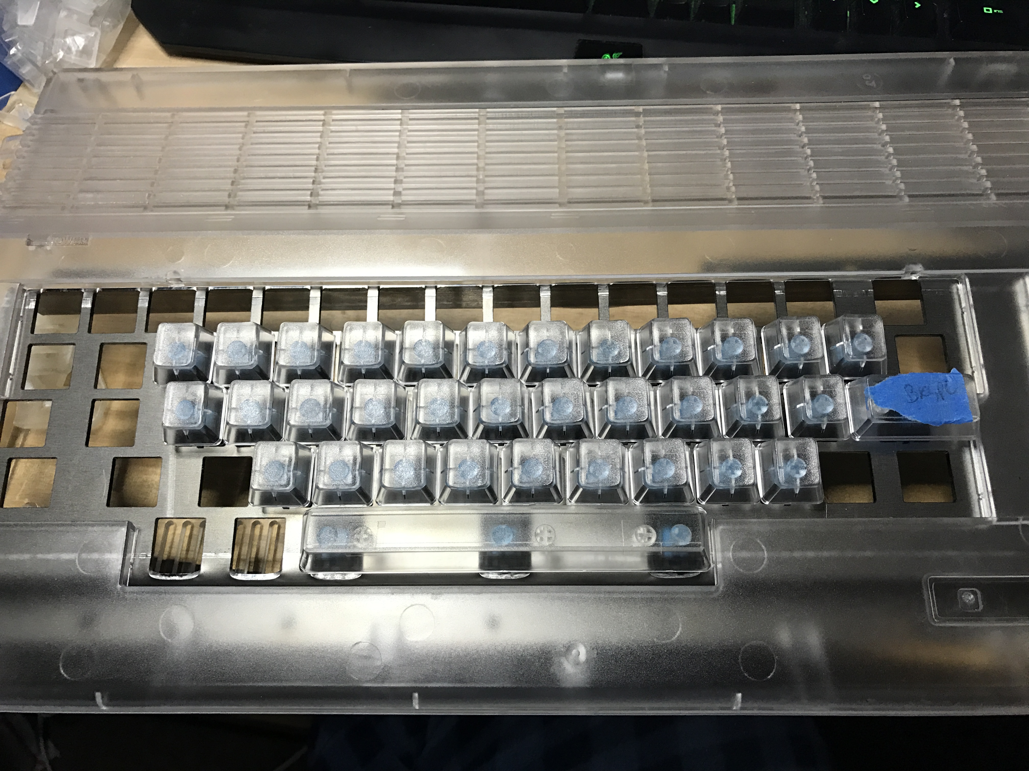

Here's a picture of the mount with more keys and case.

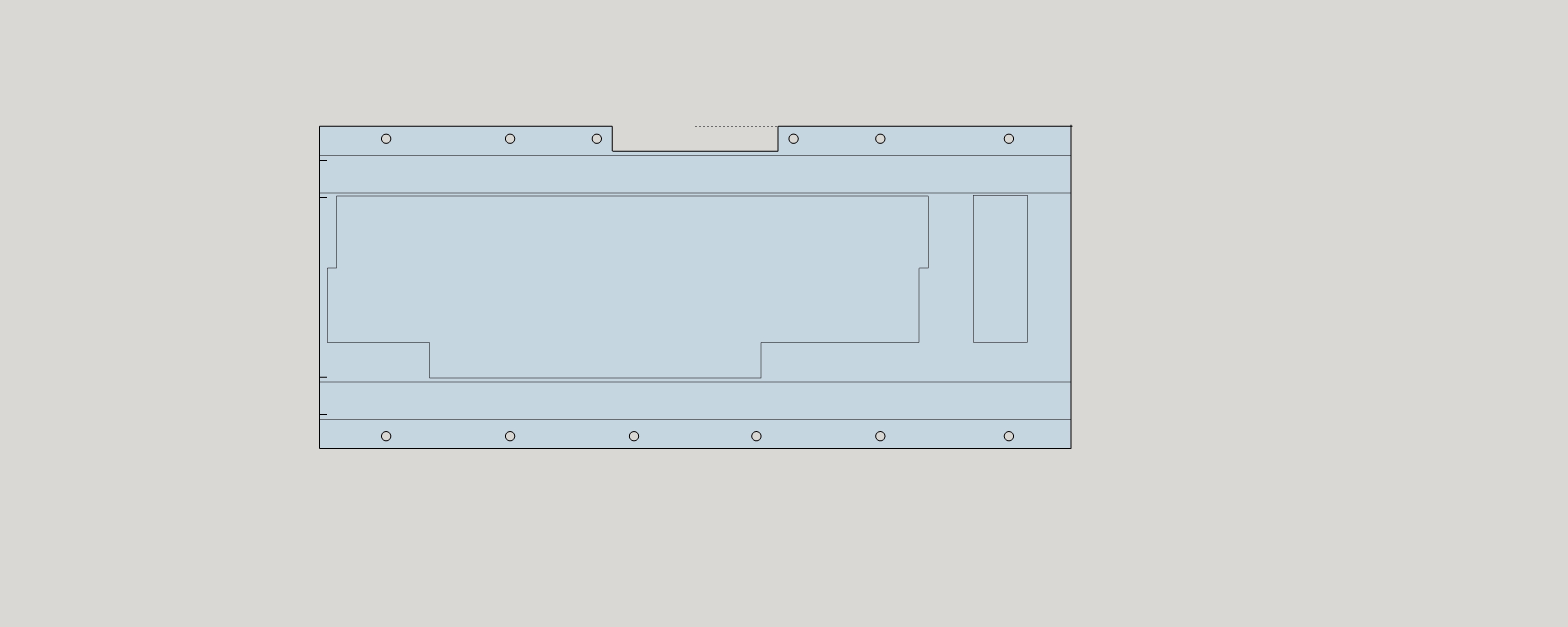

08 Feb 2017, 05:04
iceberg wrote: That is something I meant to ask, it is even possible to use the original C64 keys and layout with yours or it it too different?
Hi iceberg,
Oh it absolutely is possible. As a matter of fact, the original key layout is what I used as a reference for how much space I would have to lay out the new keys. It all came down to everything fitting properly inside of the case cut outs if that makes sense. In other words, if you take the dimensions of the original C64 keyboard key layout, my keys fit the same area :) I'll attach an image of what I'm describing.
The attached image shows the workable area that one has to layout whatever key hole configurations you want. This is accurate to about 100th of a millimeter.
iceberg
08 Feb 2017, 06:34
Nice.
