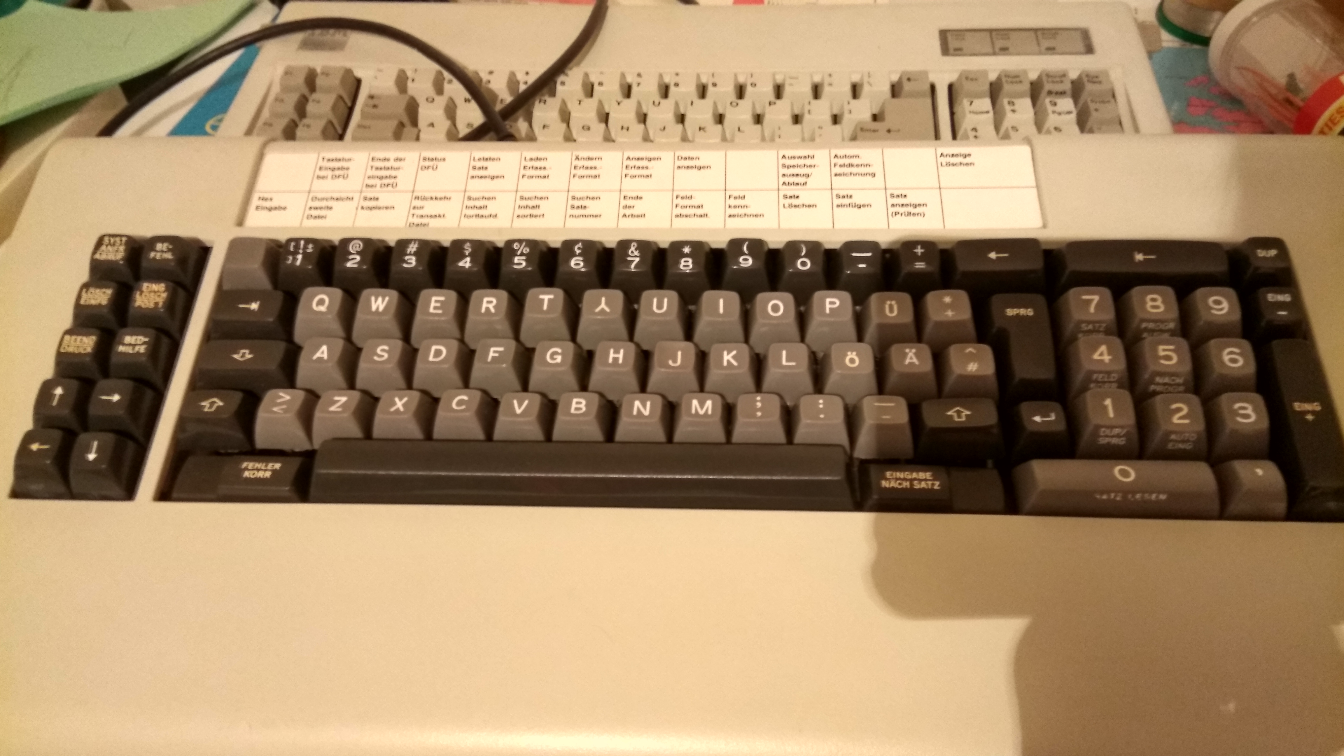

Is it possible? They seem to fit but I can't get them to stay on stable. They rock forward really easily and don't stay on, but the fit seems to be fine. I've also noticed that the selectric ones have the stalks without the gap in the middle.
Really don't want to use a German layout lol

You can use mx caps . Just jam on them a bit they will fit.

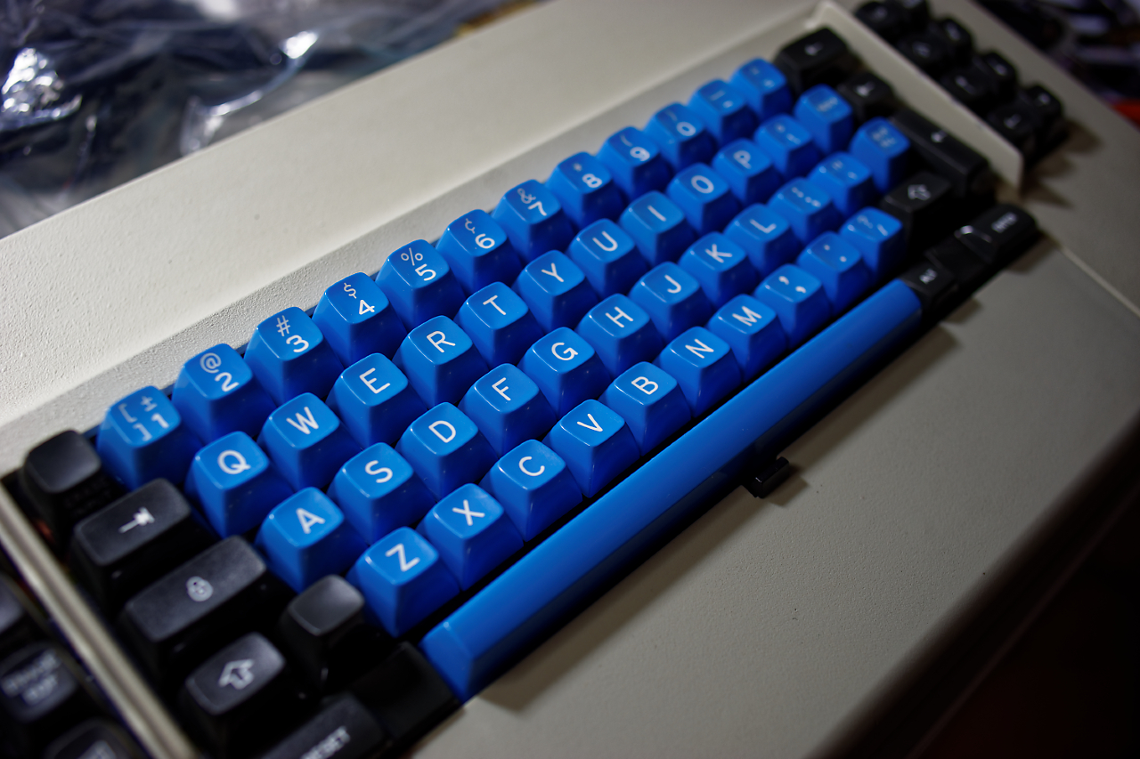

Anyhow this is the result of cannibalising a selectric 2:
Note the inverted y because sculpted profile lol
24 Apr 2017, 14:42
LOL
Looks cool tho .

I thought Selectric 1 keycaps were supposed to be tight on beam-spring mounts, maybe it is different for selectric 2. Something you can try is a thin sheet of rubber like the keyboard had originally.
kuato
25 Apr 2017, 16:13
Early selectric caps fit tight on bs stems. They're kind of a pain to remove from the typewriter so you have to be very patient not to brake anything.
25 Apr 2017, 18:33
Holy shit that looks cool.
Madhias
BS TORPE
25 Apr 2017, 18:56
andrewjoy wrote: Holy shit that looks cool.
Yes, that blue is amazing!

kuato wrote: Early selectric caps fit tight on bs stems. They're kind of a pain to remove from the typewriter so you have to be very patient not to brake anything.
A 3278? Nise! Where can you find those blues?
Perhaps there are DSA's that look like that? It looks charming a n d classy

A Selectric lol. Cindy had one a while ago and I saw one on eBay once.
kuato
26 Apr 2017, 14:03
Bruh
that's a 3276. I bought a blue keyset from Cindy a while back and sold it to a friend last year. These came from a spare blue selectric that I found locally, but these show up on eBay every once in a while.
