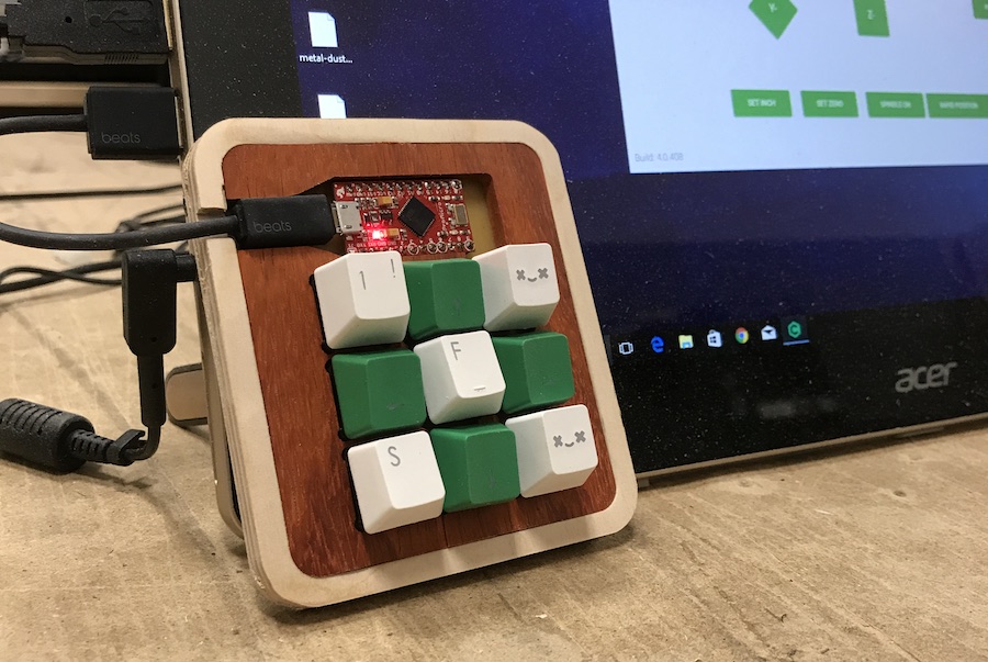

instead, i decided to test the waters by making a 9-key programmable keypad. I used MX Blue switches and some spare keycaps I had around the shop.

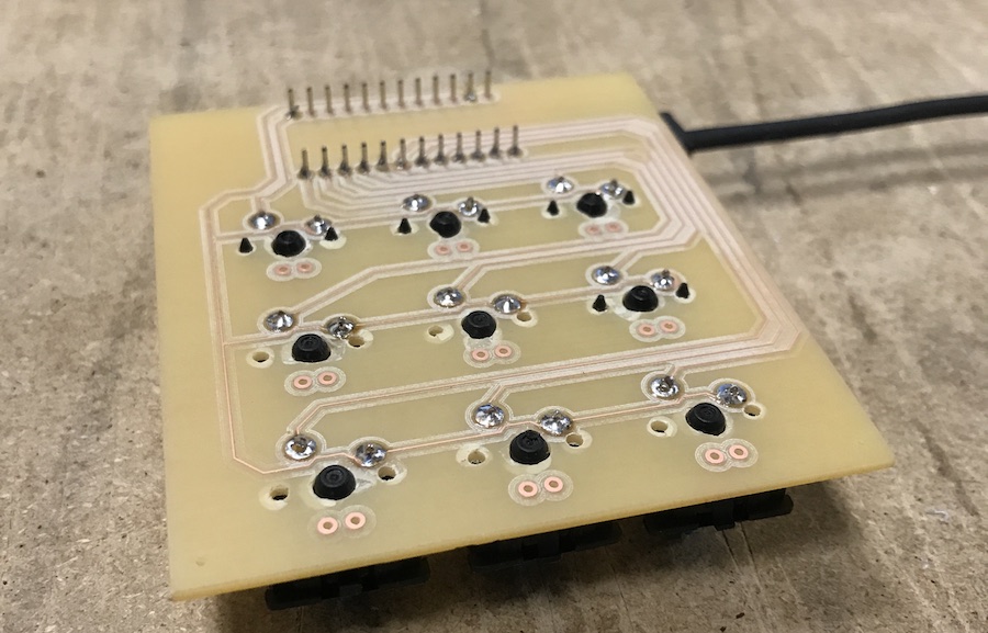

I used a promicro for the controller, but because it is only 9 keys I just directly mapped each key to a pin instead of doing a matrix. Right now the 'firmware' is just an arduino sketch which looks for the button press, then sends out the appropriate ASCII code.

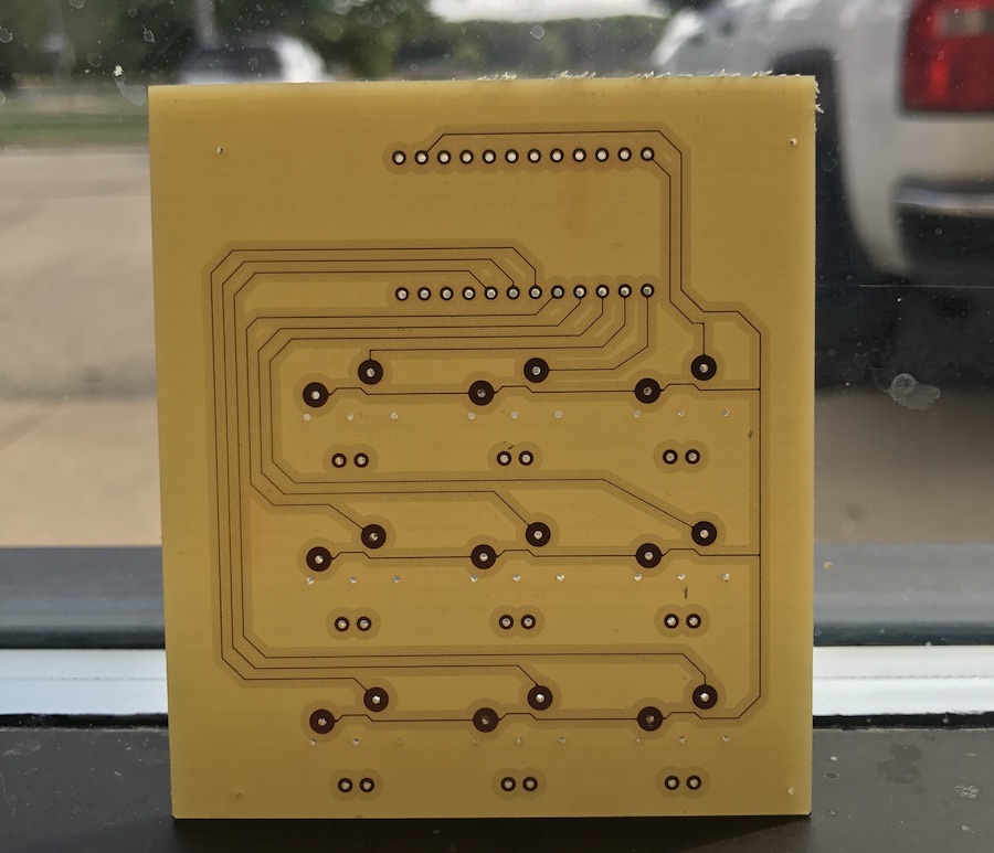

The PCB design was pretty straight forward - I wanted to keep everything in a small footprint, but I also wanted it to be a single sided board so I could cut it on my CNC without worrying about locating for a flip, and keeping everything lined up. All in the board was 2.75" x 3.125" and I managed to get all the traces on one side without growing it too much.
I used my CNC to cut the cover from mahagony and the bezel from a piece of 9mm baltic birch. everything snap fit nicely together. Although, I may switch out baltic birch bezel for a piece of aluminum to give the whole thing some weight.

That's very cool! Very nice looking case and I love the PCB. I'm unfamiliar with actually making a DIY PCB - what did you use to lay down the traces?

I used a program called Eagle - it's pretty popular in the PCB world, was bought by autodesk about a year ago. There is a free version that lets you make boards up to 4"x6" (single or double sided) - beyond that you have to pay the subscription.
The software is not the most intuitive thing in the world (think mid 80's autocad style UI) but it works and has a lot of libraries baked in, so selecting components (like the arduino and the mx switches in my case) is no more than point and click and place.
