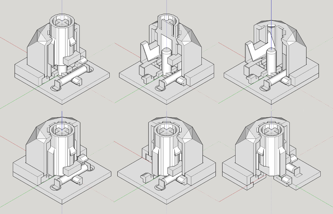

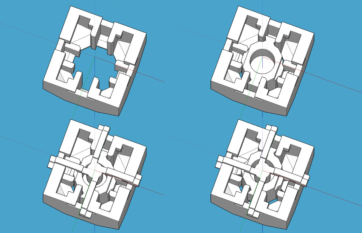

First let's look at what it looks like:

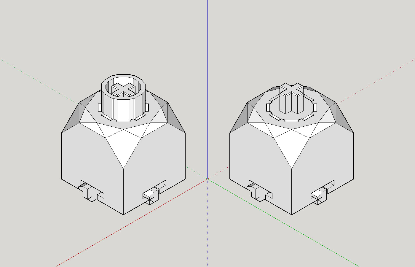

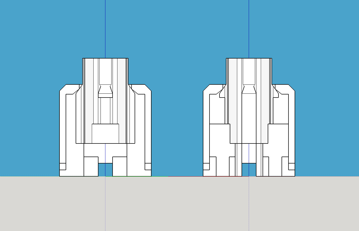

This image shows how it looks in general and 2 slider variations. I'm not sure which one will feel better or smoother, but I know that artisans with THICC stem will not fit the walled version, and the walled version may provide extra stability with SA caps. The main housing is 14mm x 14mm x 14mm and the total travel is 4mm. It is designed from to ground up for enthusiasts, meaning, I'm not trying to design the 'best' switch in any category in particular, but I want it to feel great, easy to customize and create variations, a joy to work with, and allows for simple and high quality keyboard designs. It is not MX compatible except for the keycap mount and spring. I tried making it completely MX compatible at first, but in the end it greatly limits what I originally wanted to create, and I don't even know if this thing will go anywhere more than a few 3d printed fidget toys sitting on my desk, so why not try going all-out crazy first 8-)
Here is the exploded view:

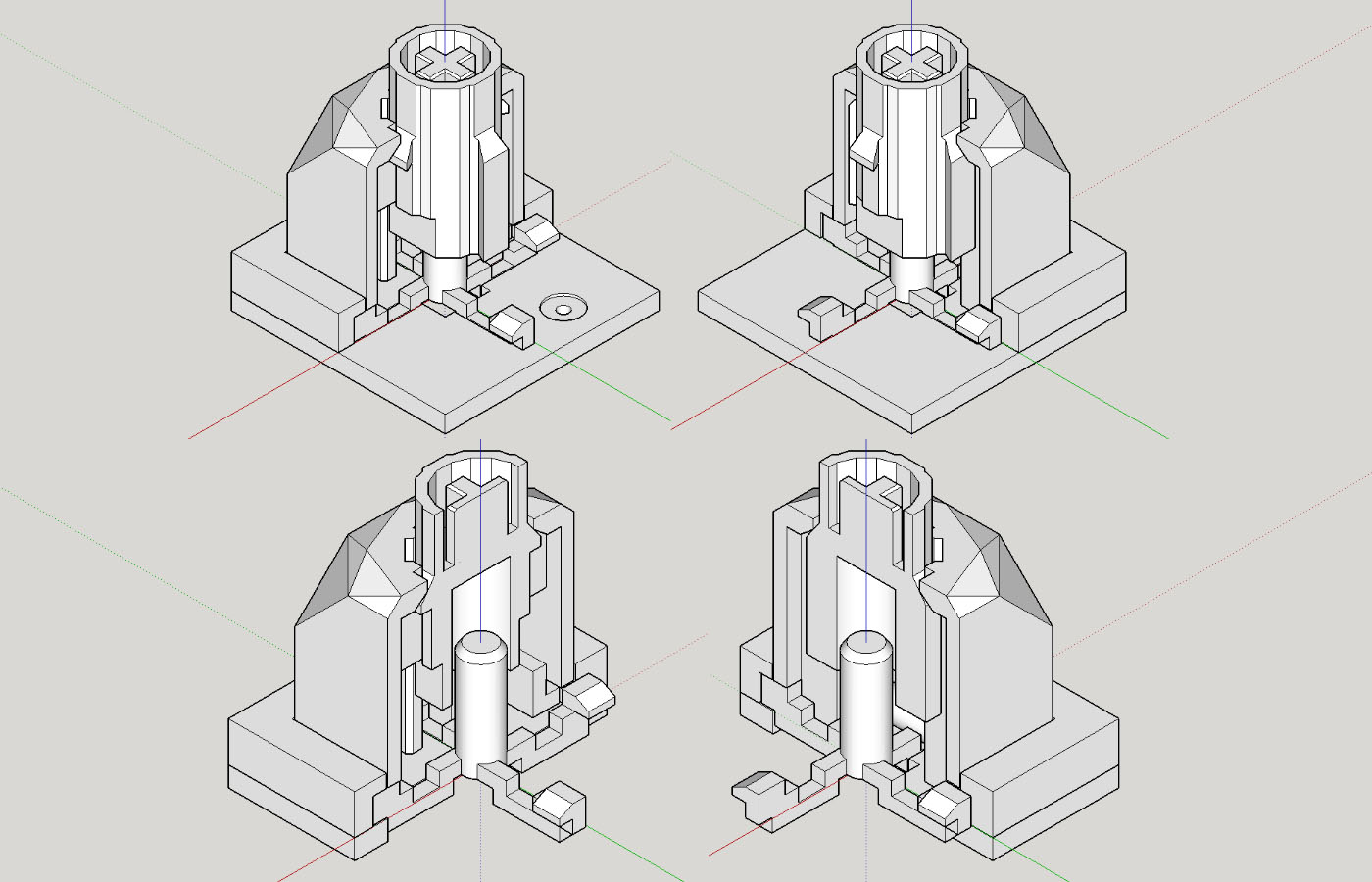

The spring and contact are not shown here, just the slider and housing. I've designed it so that any MX spring will fit, and you can probably see where the spring will be, so I didn't bother drawing it. As for the contact, there are plenty of space in the housing, so there are many options, we'll get to that later.

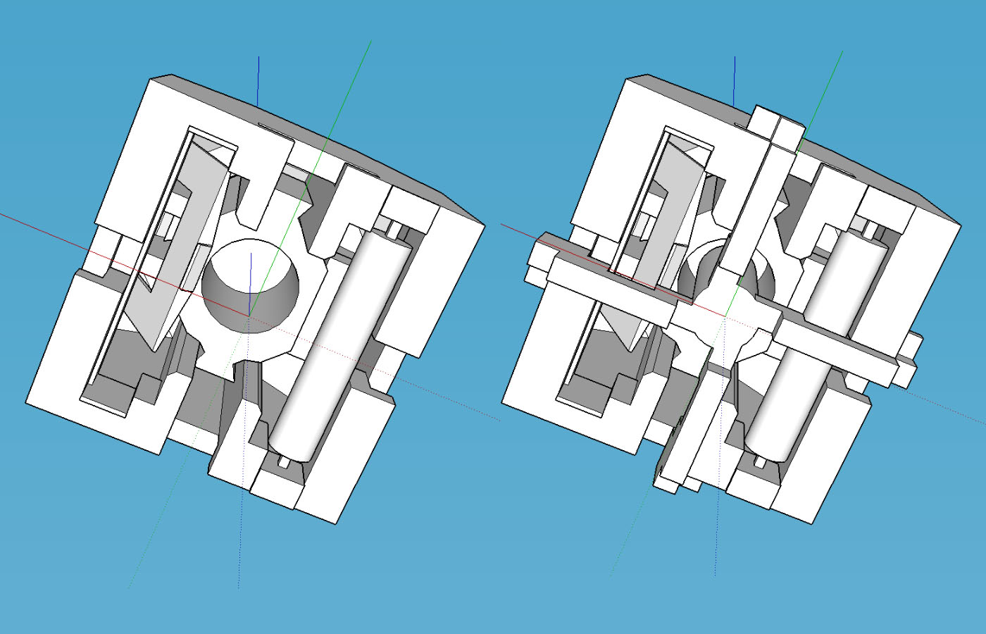

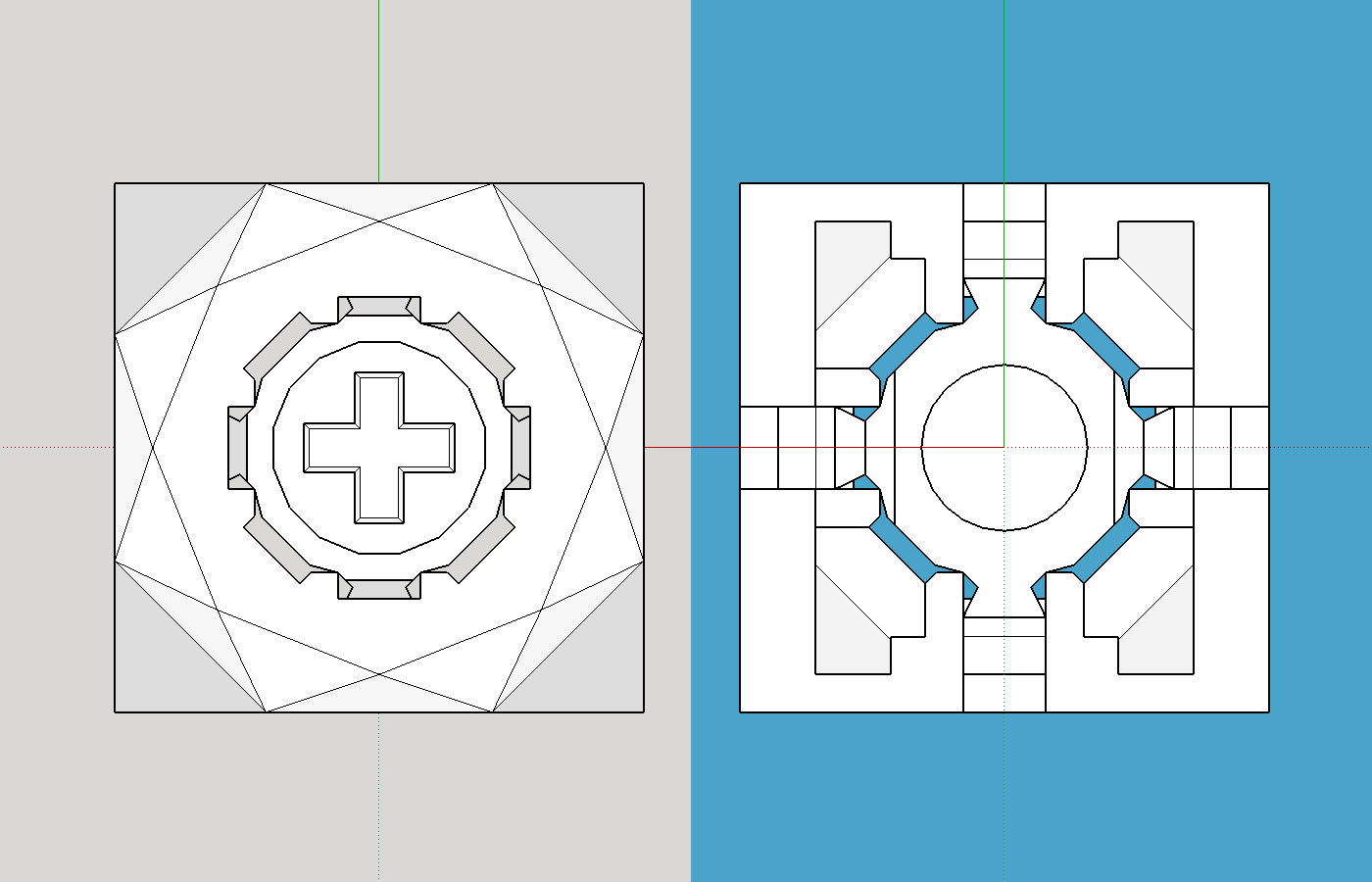

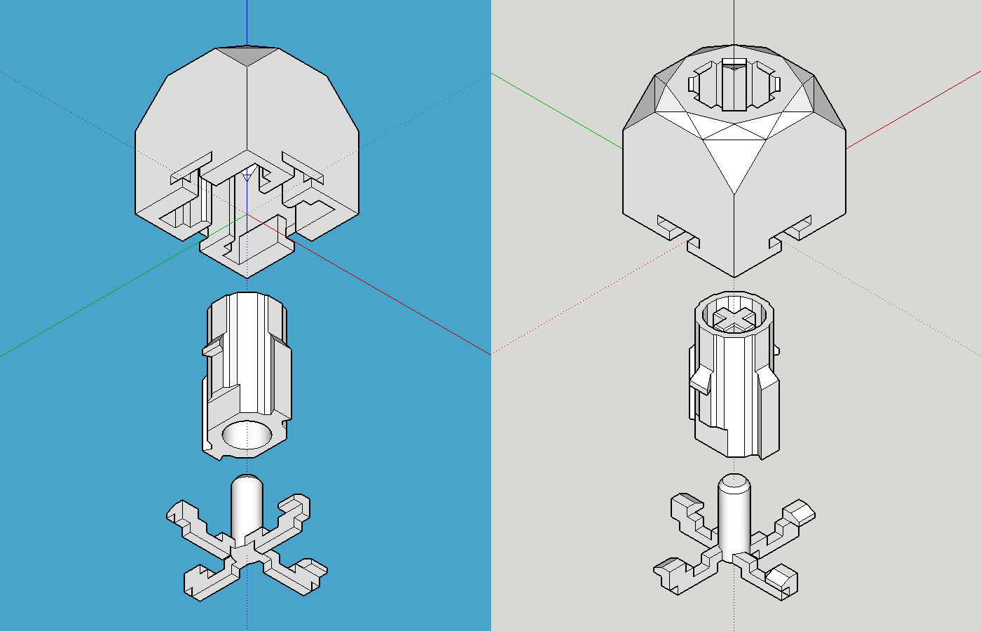

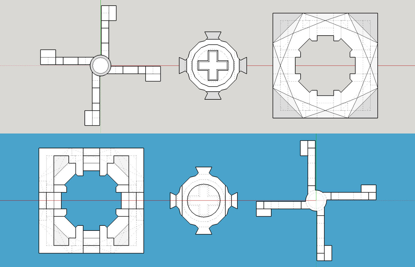

At this point you might be wondering about the cross-shaped piece that hold the spring. There are reasons why it look like that: First, it allows for an easy way to open and close the switch without any tools while still securely holds everything in by clipping to the main housing with the notches on all 4 sides. Second, the cross act as mounting, holding the switch to the pcb without any tilt. Third, dust can be blown out of the switch without disassembly. And finally, light can shine through the switch directly from bottom-center (we'll see where to put the LED in a bit).

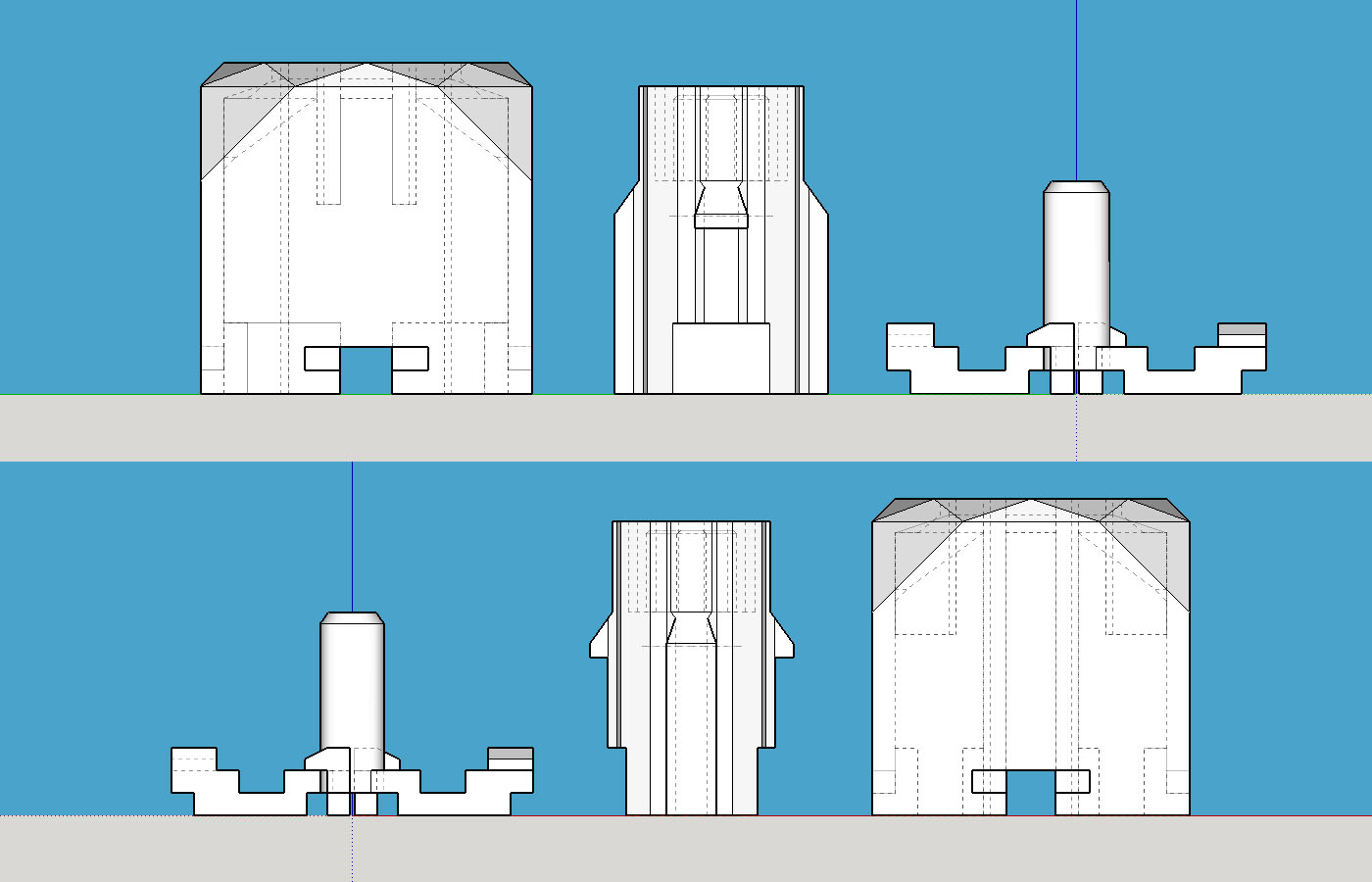

This view from the bottom gives a better view of how the housing, slider and the cross fits together and a better view of how the slider is held inside the housing:
Here you can see the grooves on all 4 sides that are keeping the slider as vertical as possible while sliding. You can see 2 of the 4 grooves extends all the way down to the bottom. The longer grooves are what mainly keep the slider on its axis, pretty common stuff, many switch have something like this. The shorter grooves are there meant to provide additional stability while still give enough room to add the mechanism for contact and tactility.

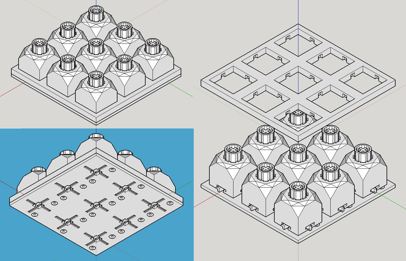

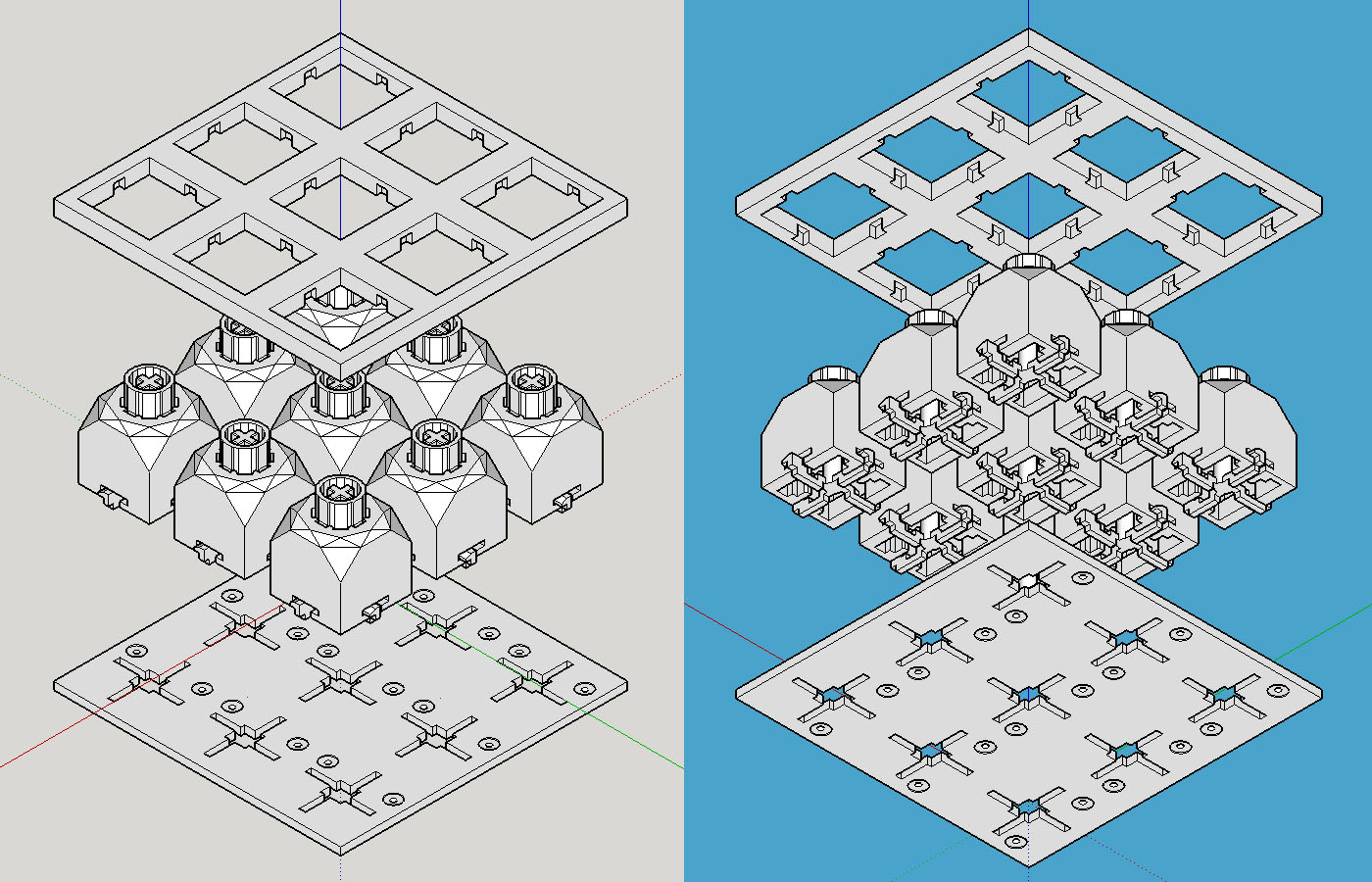

Here is how the switches are installed on the pcb and how they are held in place:
The bottom rectangle that the switch sits on is the pcb, here you can see how the cross piece mount onto the pcb and how it can keep the switch from tilting. The top rectangle is what I call the 'retainer'. It is meant to sandwich with the pcb by screws and keep the switches in place by holding on to the notches on all 4 sides of each switch. The retainer is not meant to be the 'plate' or part of the case, it should be inside the case and made of non-conductive material. Solder is not needed as the switch should make a firm contact to the pcb from the sandwiching of the retainer and the pcb.
If this design works out, assembling switches to the pcb will be very simple, add switches, screw in the retainer, done.
Here you can also see the how the holes on the pcb can allow LED to be placed on the bottom side of the PCB, and still shine through the bottom-center of the switch, allowing the same LED to be used for both under-glow and switch backlit. You can even use separate led strips for each row instead of soldering all LEDs to the pcb.
Now let's talk contact, here is where I get a little crazy... But first, let me say that I intentionally design the switch so that it has plenty of room for contact mechanism, not nailing down the contact for this switch. But because the contact is kind of important for a switch, and a switch is not a switch without the contact, so I still want to give my idea of the contact that I would like to see the most :D
Sorry, it is kinda hard to find an angle that can explain it visually. But for those who can make out what it is... Yes! It is a reed switch! The tube in the picture is a reed switch, the rectangle block above it is a magnet, and on the opposite side is a click-leaf similar the ones in the beloved Alps switches. The size of the reed switch tube is 10mm, although not the most commonly available types, I was able to find several suppliers through a quick search, so at least it's out there. If the reed switch idea turns out to be a bad idea due to cost, availability, or other reasons, the space could fit anything from: a magnet for hall-effect switch, an Alps-style switch plate, an optical switch sensor, etc.

This sounds very very intriguing! I like the shape of it. Haven't seen a switch shaped like that.
zslane
07 Mar 2018, 19:52
Nice work!
The one thing I would urge you to consider in the design is internal dampening. There is nothing worse than bottom-out and upstroke impact noise. I hate that manufacturers like Cherry and Gateron have treated internal dampening as an afterthought, only now getting around to producing them (and they are so uncommon that you don't see many keyboards built with them).
In terms of the contact mechanism, there is nothing smoother or more reliable and long-lasting than Hall Effect. Just something to consider.

The switch seems to be all about stability. It's hard to say but it looks so fit that it might need lubrication. Also it might transfer a lot of reverb onto the PCB ending up in not the most pleasant sound/feeling. Lastly, I don't think the reed switch is a good idea if only from a costs standpoint. Anyway this is the first reiteration, keep going! I have a quality 3d printer, let me know if you want to do some prototyping.
mustcode
10 Mar 2018, 13:35
matt3o wrote: The switch seems to be all about stability. It's hard to say but it looks so fit that it might need lubrication. Also it might transfer a lot of reverb onto the PCB ending up in not the most pleasant sound/feeling. Lastly, I don't think the reed switch is a good idea if only from a costs standpoint. Anyway this is the first reiteration, keep going! I have a quality 3d printer, let me know if you want to do some prototyping.
Thanks for the feedback! I'm a fan of your designs and it's great hearing your feedback. :D You are absolutely right that I put quite a bit of thought into making sure that the slider can only move up and down. One reason for that is because a few of my earlier 3d printed prototypes can get stuck on the way down on off-center presses. Initially I wasn't sure if the problem was due to design or low quality prints (or both), so I made my next few prototypes from Shapeways's SLS printing to see if the result is any different. Shipping wasn't cheap but I eventually solved the off-centered pressed problem and what you see here is the result of those tweaks. Here are better shots of how the slider make contacts to the housing:
As, you can see, I tried to minimize the contact surfaces while trying to keep the slider straight by not having flat surfaces rubbing against another flat surface, only edges rubbing against flat surfaces. However, I couldn't verify the smoothness because the surfaces of the 3d printed prototypes are quite rough, and if I try polishing it, I'll just messed up the accuracy. Sound is another thing that I obviously have no clue how to really design for, if you can explain a little more about your concerns, I'll be sure to think about how to improve it.
And yes! If you're interested in helping me prototypes, that'll be really awesome. I live in Bangkok my access to good 3d printers and manufacturing tools is quite limited. I can pay you to make 3d printing, and you can just take pictures and tell me if it's working, no need to ship the prototypes to me. :)

hey @mustcode, what's the intended width of that switch? the stl has it at about 0.6mm which I suspect is not accurate
mustcode
11 Mar 2018, 05:13
__red__ wrote: hey @mustcode, what's the intended width of that switch? the stl has it at about 0.6mm which I suspect is not accurate
Oh, really? The converter I used must have messed up the unit. The switch housing is supposed to be 14mm x 14mm x 14mm. I'll double check the stl and fixed it as soon as I get back to my pc.
mustcode
11 Mar 2018, 06:57
Oh, I see. I just checked and the size seemed to be correct, but I think you might be getting the unit reversed. 14mm is around 0.55 inches, may be that's the why you're seeing it as 0.6mm?
-[°_°]-
11 Mar 2018, 11:19
are you working in inches? the switch unit must be multiplied by 25.4 to get the actual size.
