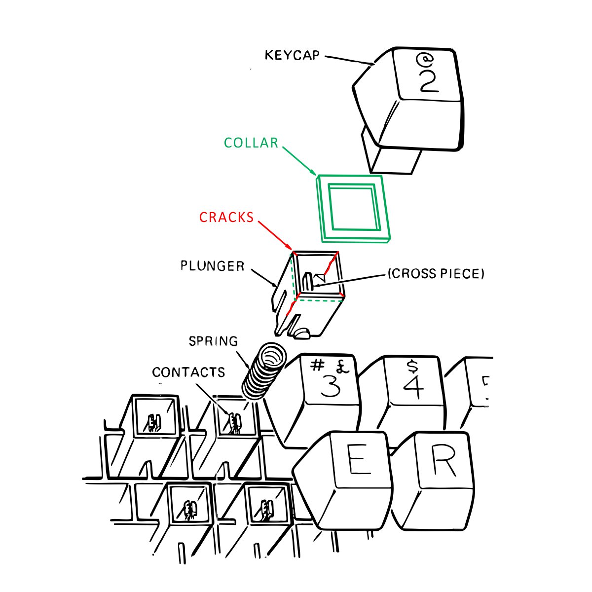

I'm restoring my Hazeltine terminal, which has Hi-Tek High Profile keys which are known to be fragile. And I think I've found a good solution on making these cracked keys work with a small modification.
Here I posted my illustrated story on how to fix them: https://imgur.com/gallery/lgZZZJ5

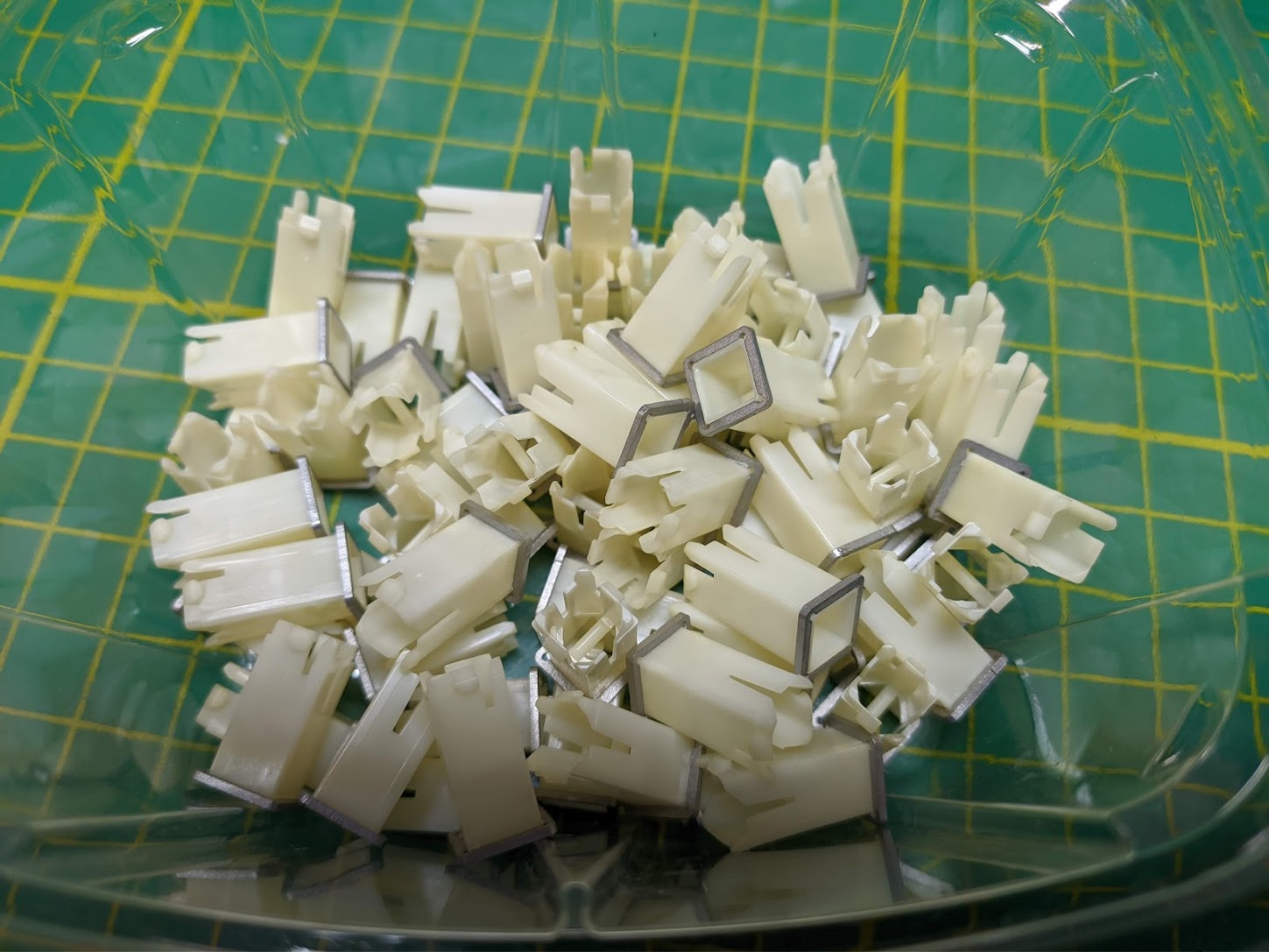

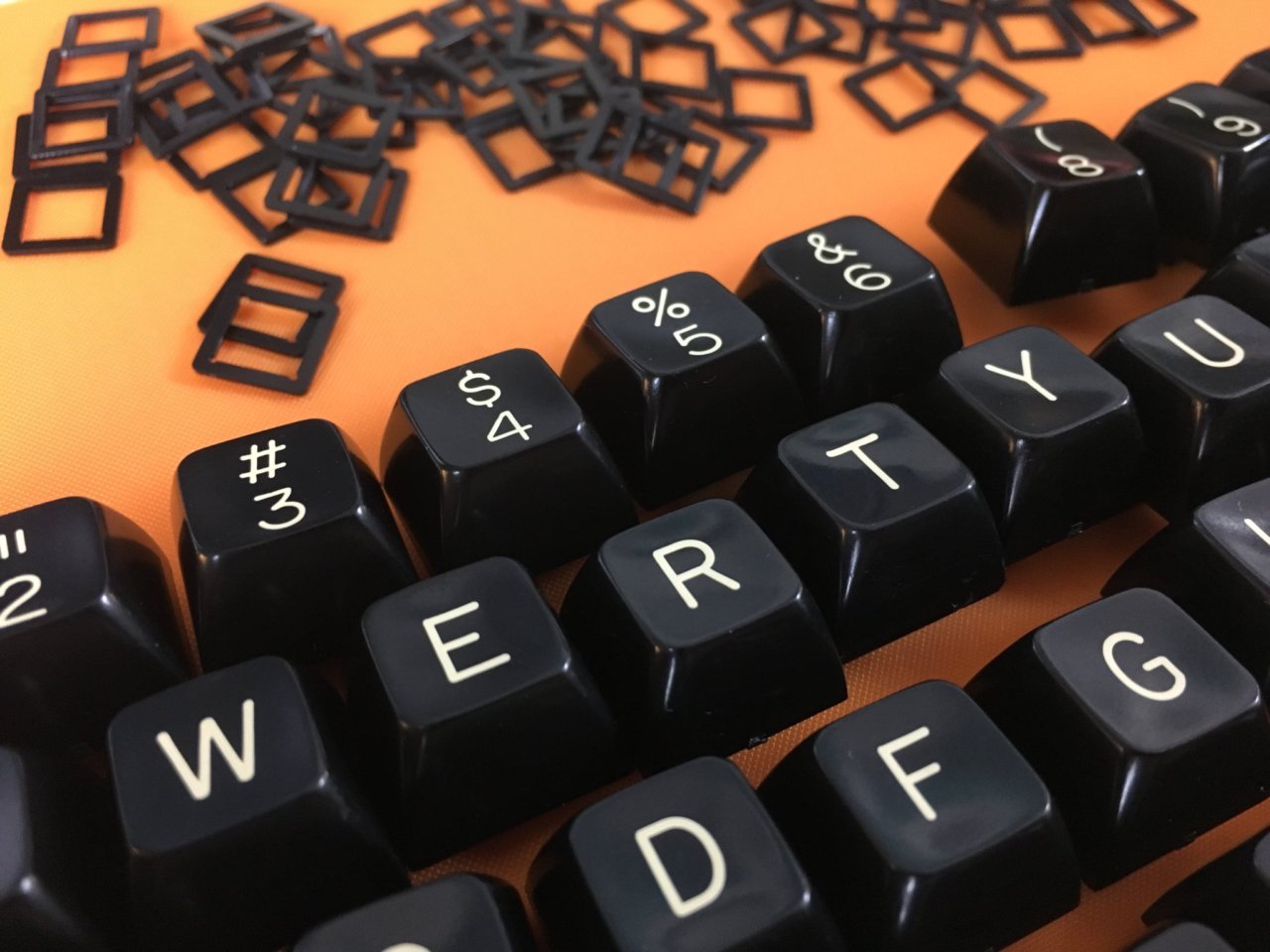

Just a quick update: after picking the right size, I ordered a full set of laser-cut collars for all the keys, and had the keyboard fully restored. The process of installing keycaps and collars turned out to be a very easy one, and I was spending just 10 seconds per key (to put the collar and install the keycap). I did have to remove the top part of the shell to work with the keyboard and then put it back on.
The keyboard now works flawlessly. I'm very pleased with the result and with the fact that you can fix even severely cracked key sliders with no keyboard disassembly and without using any donor keys.

I ended up just gluing the collars in the proper position with loctite plastic bonding system. A pain to do, but it actually did work. While the collars weren't exactly perfect for some keys, once held in place they still do the job keeping the crack from opening, and voila- no sticky keys.
I actually like the reduced travel of the keys, makes for easier typing on the vt100 keyboard.

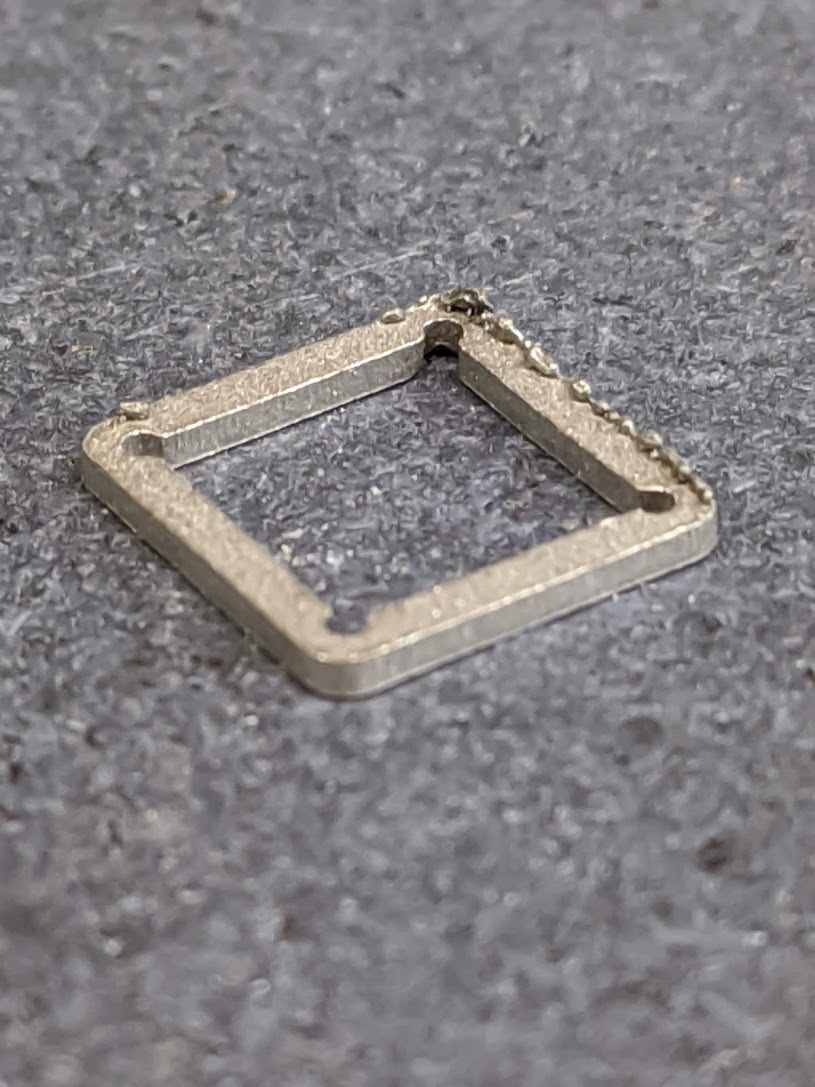

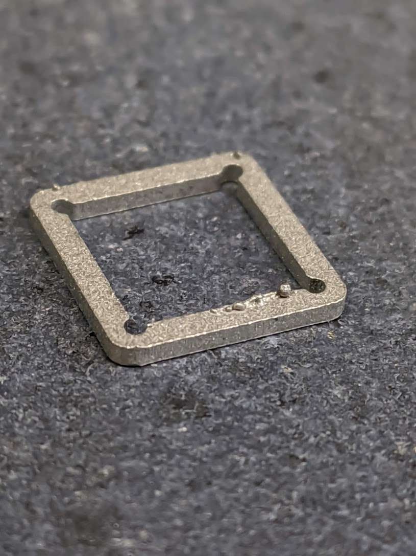

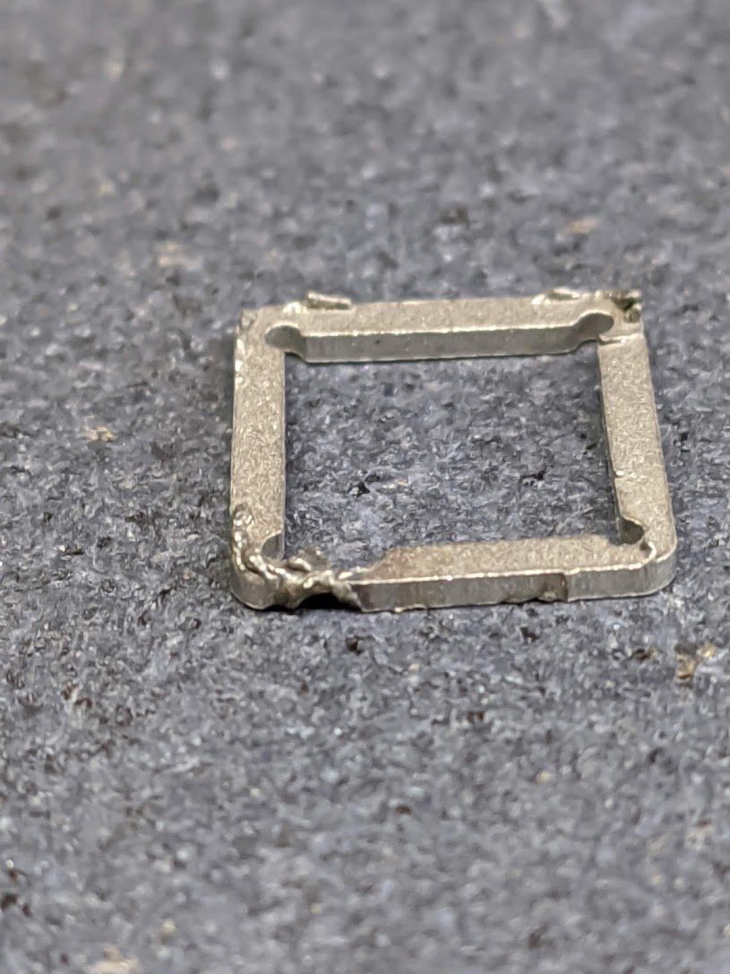

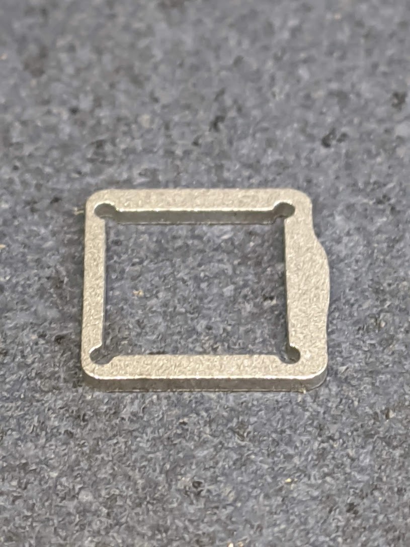

A while back I remade this design in Autodesk Inventor and had them cut from 316 stainless with Laserboost. Price ended up at about $0.23/piece shipped. They work great but they're insanely loud. I chose 1mm thickness which has noticeably less travel. If anyone's planning on doing the same I'd recommend choosing a bit thinner material. I went with 8.07mm which ended up very snug but they still fit the particular variants I have.
There were a few that came out a bit weird but the vast majority of them were fine. Pretty sure LB sent me extras anyways.

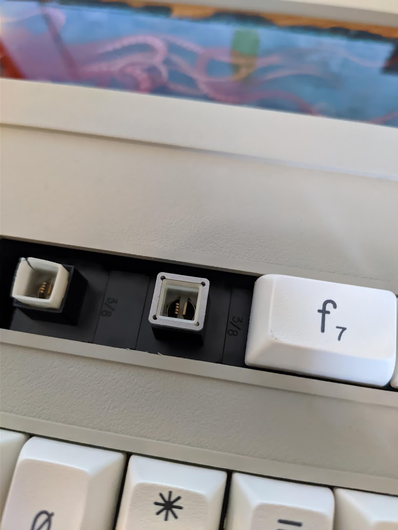

HUGE shout-out to @afan for helping me get my DEC VT100 keyboard in tip-top shape!! I can't thank him enough. It had a half-dozen sticking keys because of the cracked corners of the plungers.
I used his Fusion 360 sketch for the Hi-Tek plunger "collars" to make the 3D printer .STL file I needed. The exact outside dimension of my plungers was 8.1mm square, and I used a thickness of 0.8mm. I used a Creality Ender-3 S1 printer, with PLA filament, 60 degree bed, 225 degree nozzle, 50% speed, and printed it with 0.12mm layers (highest "quality" setting in the slicer).
The collars were nice and snug, no slipping once on the plunger, and now the keys all work great!!
