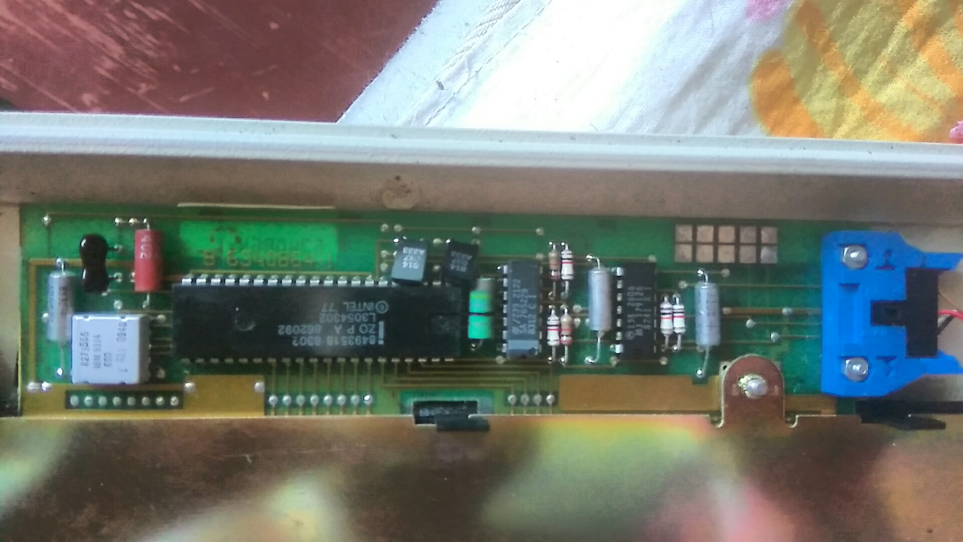

First thing I'd try is connecting the keyboard to another computer. You mentioned Windows: check the Device Manager for an entry for the USB device that is the Soarer's Converter.
If you do open it, perhaps you could post some photos of the controller hardware. It's possible a capacitor has failed or something like this.

I'm don't see a visually any deviation on controller.

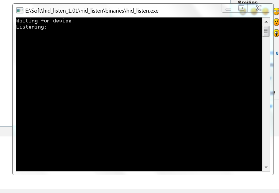

If the converter is a Soarer converter, it should be able to probe the keyboard’s internal controller using hid_listen

hid listen ? How uses this command?

Here's the link for HID Listen: https://www.pjrc.com/teensy/hid_listen.html
If you use Windows, click on "Windows executable."

hid_listen don`t finding anything.
What`s i have done wrong? Do I need to put some more software for Soarer`s?
23 Aug 2019, 13:40
Looks like a fried Teensy.
Your Soarer’s converter was working before. Now it’s not even responding to hid _listen. Bad sign!

Try hid_listen on those computers. Does it ever see anything?
Soarer's Converter runs on a small piece of hardware: a Teensy or clone. (The Atmel processor is very small and some modders (like Orihalcon) can even fit the converter inside a cable.) This converter hardware could be broken.

No. Both don`t see.
24 Aug 2019, 09:25
The converter is dead. Or just the USB cable.

The converter is not responding to hid_listen therefore the converter is broken.
