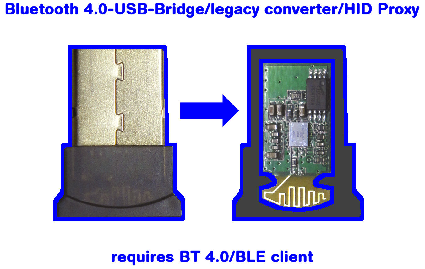

Not sure if a lot of people will find this useful, but I've been offering these for a while on Ebay and recently a buyer suggested I blow the horn about it on the forum to give it a little more exposure. The price is 20€ + shipping.
BT-USB bridge / HID proxy dongle
IN HID PROXY MODE, THIS DONGLE WILL ONLY PAIR WITH BT 4.0/BLE HID DEVICES, I.E. IT WILL NOT RECOGNIZE A BT BR/EDR 2.0/3.0/4.x/5.x KEYBOARD/MOUSE. THE CRUCIAL DIFFERENCE IS BETWEEN THE BT BR/EDR PROTOCOL AND THE LOW ENERGY PROTOCOL EXTENSION. MAKE SURE YOUR CLIENT DEVICE IS COMPATIBLE BEFORE PLACING AN ORDER. THANK YOU.
In case you're looking for it, here's the link to a Github repo I created for the CLI: https://github.com/chancefavorstheprepa ... irings_cmd
The dongle has two modes of operation: HID proxy mode and HCI mode. In HCI mode, it acts as a regular BT adapter controlled by the operating system's BT stack. In HID proxy mode, it acts as stand-alone single-mode BT LE adapter. The mode of operation can be switched by software, too, if necessary (Windows, Linux, Mac OS X).
The default boot mode is HID Proxy mode.
Note 1: In stand-alone BT host operation, the dongle will appear as a regular USB composite device (HID keyboard+mouse) to the host system (Windows, Android, Linux, Mac) - NOT as a BT device.
Once a BLE compatible client device is recognized, the dongle will handle pairing and bonding automatically and doesn't require any manual configuration steps. That way you can connect a BT keyboard to any (legacy) USB-compatible host system (including the BIOS) without any additional hassle.
Note 2: The BLE client device must support 'just works' as a pairing method, since there is no display and no keyboard to enter pairing codes manually on the dongle.
So, in other words, this dongle will let you connect your BLE keyboard/mouse to any USB-compatible system. You will not need to configure anything to connect your device. You can also carry your keyboard/mouse together with the dongle from one computer to another computer, plug in the dongle and use your keyboard/mouse right away without having to re-pair your keyboard/mouse on the other computer because all the pairing data is stored on the dongle.
This dongle will also let you connect a BLE keyboard to a TV or other devices that only support USB input devices.
Note 3: After pairing the module for the first time, the pairing data will be stored and henceforth the dongle will only connect to the paired device. Before a different device can be connected, the old pairing data must be deleted first by running a command line interface.
