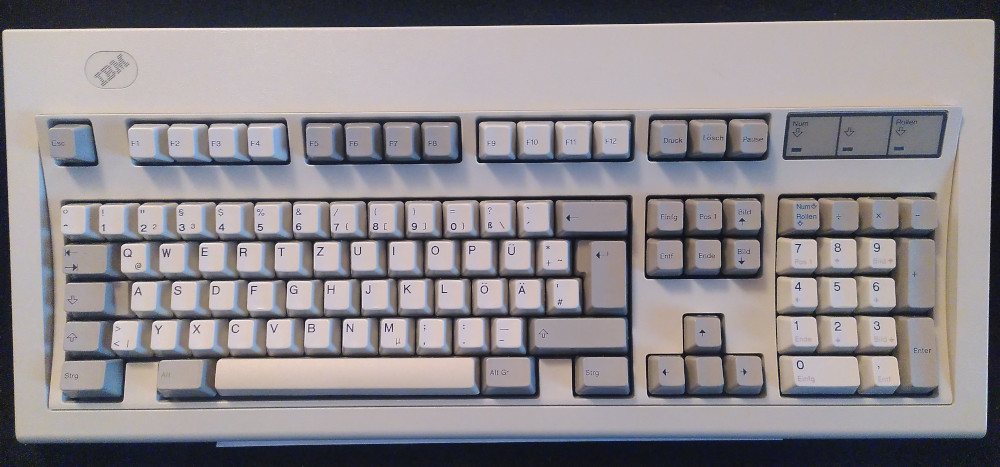

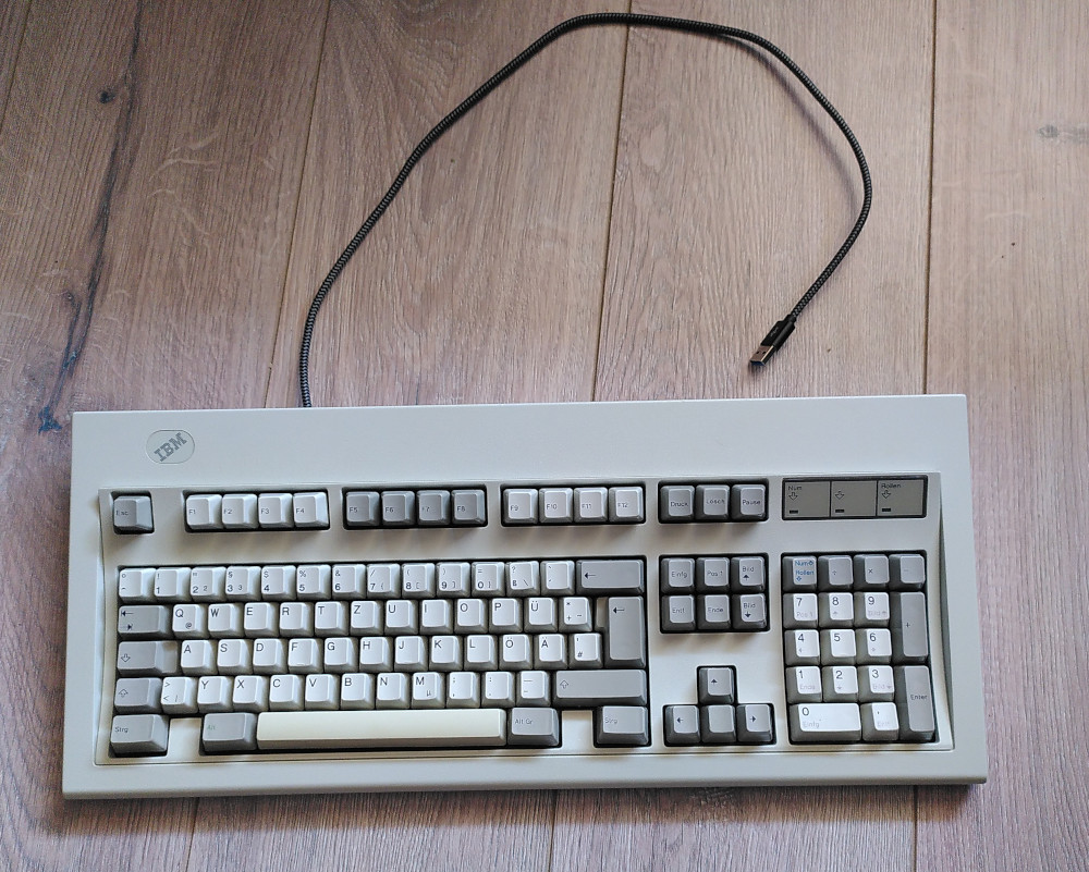

Restoring a Model M “Battlecruiser” (122 keys, ISO German) from 1999
tobe_b
05 Jun 2023, 21:08

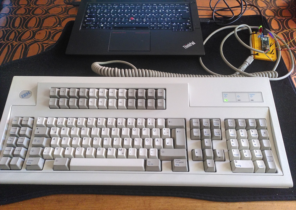

For my first post on the forum, I thought I’d share how I got back into buckling spring keyboards. I bought a “Battlecruiser” (P/N 1397003 from 1999) on eBay in 2007, being fascinated by the number of keys and wanting to experience the typing feel (I forgot where I read about it, but at that time it was only talked about in some very niche corners of the internet). This terminal keyboard is a bit of a weird one, it uses the set 2 protocol (I cannot find a switch or jumper to change it) and has a detachable SDL <-> PS/2 cable. It is called Type IV here: https://sharktastica.co.uk/topics/m122_diffs#Type4. For several reasons the thing ended up stored in my parents’ attic: The F12 and F24 keys would not “click” anymore (it arrived like this), and while the letter keys and F1-F11 worked normally the rest was not recognized (correctly) by the OS. Finally, my new PC did not have PS/2 anymore at some point. I have another, more standard Model M that is fully PC compatible, but without USB and Windows keys, I found it increasingly impractical. I switched to Cherry MX Blue based keyboards and accepted my fate.
A few weeks ago I randomly learned that Soarer’s converter exists! I immediately went to find the 122 key keyboard and opened it up. [Sorry for the image quality of the photos, I only have a phone with a crappy camera here.] Here’s the label:

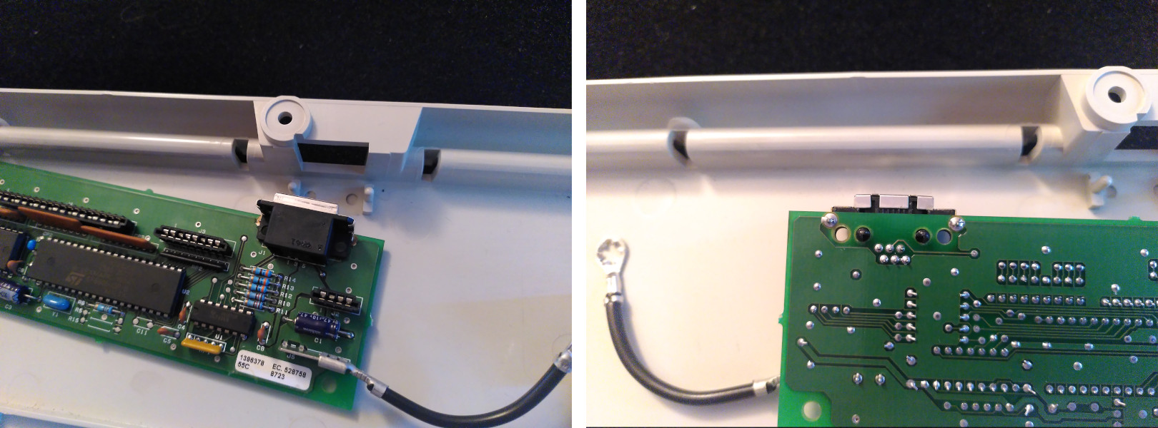

The plastic rivets were broken and the F12/F24 flippers were stuck at a weird angle.
The keyboard was a bit dusty, but apart from the broken rivets it is in quite pristine condition. No idea if it was even in use for a long time. Key soup:

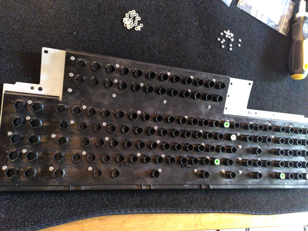

I decided on a nut and bolt mod after cleaning the parts.
Afterwards, all keys worked immediately, emitting nice, satisfying clicks. (Yes, I did record it, but you have heard it before so I’m not attaching the sound file.)

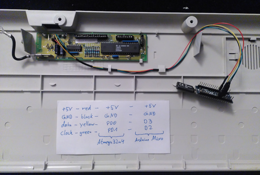

Now to connect it to a modern PC... I used an Arduino Micro (the official Arduino one, not Pro Micro) that I could source easily. These have an Atmega32u4 chip and can be flashed easily with the Soarer firmware. Here is my glorious converter in action. A good tip is to first try with a crappy rubber dome keyboard to check if the PS/2 wiring is correct (luckily the passive USB to PS/2 adapter worked):
After this pointless USB -> PS/2 -> USB conversion, I could finally connect the real thing:

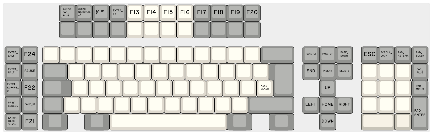

It seems that the correct scancodes are not floating around on the internet (or I could not find them), so I’ll post them here. First the codes, then the names in the Soarer firmware. I only included the non-standard ones, the empty keys are just the ISO layout defaults:
You can see that the codes are strange and seem nonstandard. I even had to use some deprecated codes in the Soarer firmware that seem to have no non-deprecated replacements listed in the docs (not a problem, since they still work just fine, but the codes seem to be very rarely used).

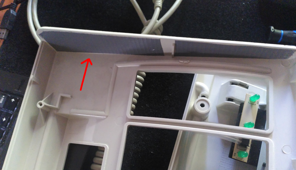

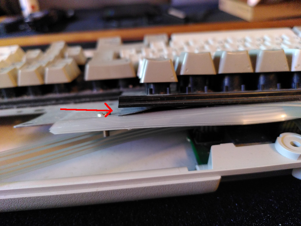

Finally, I was annoyed that the top of the case had a bit of wiggle room to the left and right. A quick application of tape stopped that nicely.
Currently, I have disassembled the keyboard again, because I used M2 bolts but only drilled 1.5 mm holes. Now I worry that that might put too much stress on the plastic and am thinking about widening the holes.

Re: the ISO Return key. Is there a stabiliser insert correctly installed? It should be a 'vertical' one, like the numpad Enter key; not a 'horizontal' one like all the other stabilisers on your board. They're slightly different and a mistake would surely mess up the action.
tobe_b
07 Jun 2023, 19:36
Thanks for the hints and the warm welcome.
The German ISO layout including big, fat Enter keys is unfortunately(?) imprinted too deeply into my muscle memory. Typing on anything else drives me crazy now :D
I checked that the stabilizer is correct and correctly installed, I think otherwise the key wouldn’t really work at all. I switched the numpad stabilizer and the main Enter stabilizer (turning them 180°, of course). I also switched the keys with my other Model M. That helped a bit, maybe just due to reseating everything. I think I’m just too picky… No problems with the function at all.

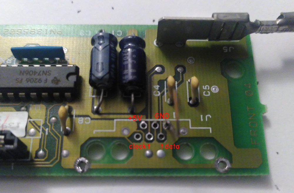

For the USB connector, I can’t really fit an internal SDL connector. I would have to move the PCB away from the cutout on the back of the keyboard, where it is normally installed. That would also mess with the membrane connectors. In your case, dotdash, it looks much easier because there’s an internal connector between the SDL socket and the PCB. For me I would need to get an SDL plug installed internally and either sacrifice a cable (I don’t really want to) or get a brand new SDL connector (either impossible or very cumbersome here in Germany). The SDL connector is also quite big and might not fit.

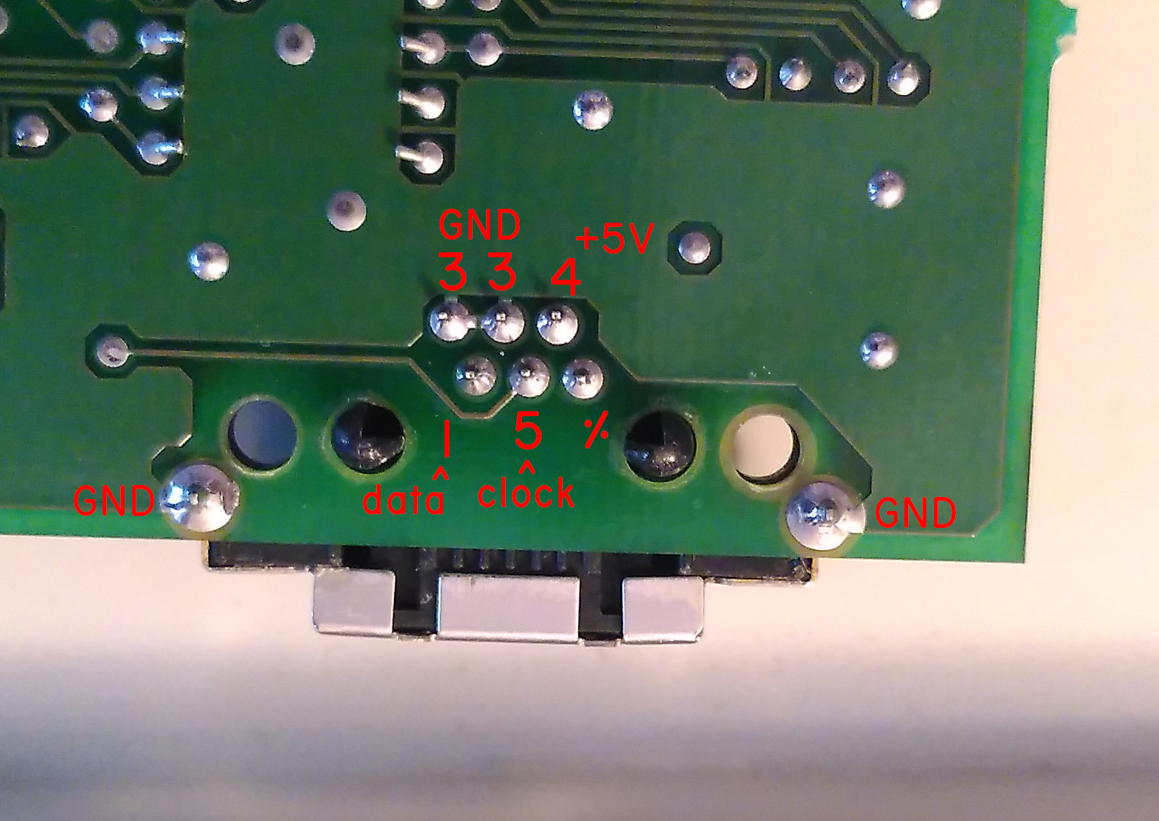

So I’m still thinking about it. I already used my multimeter to find which pin on the board belongs to which PS/2 wire (numbering follows the standard PS/2 connection numbering). The lower right one is not connected to anything as far as I can see and the two top left ones are soldered together. No guarantees, this is untested:

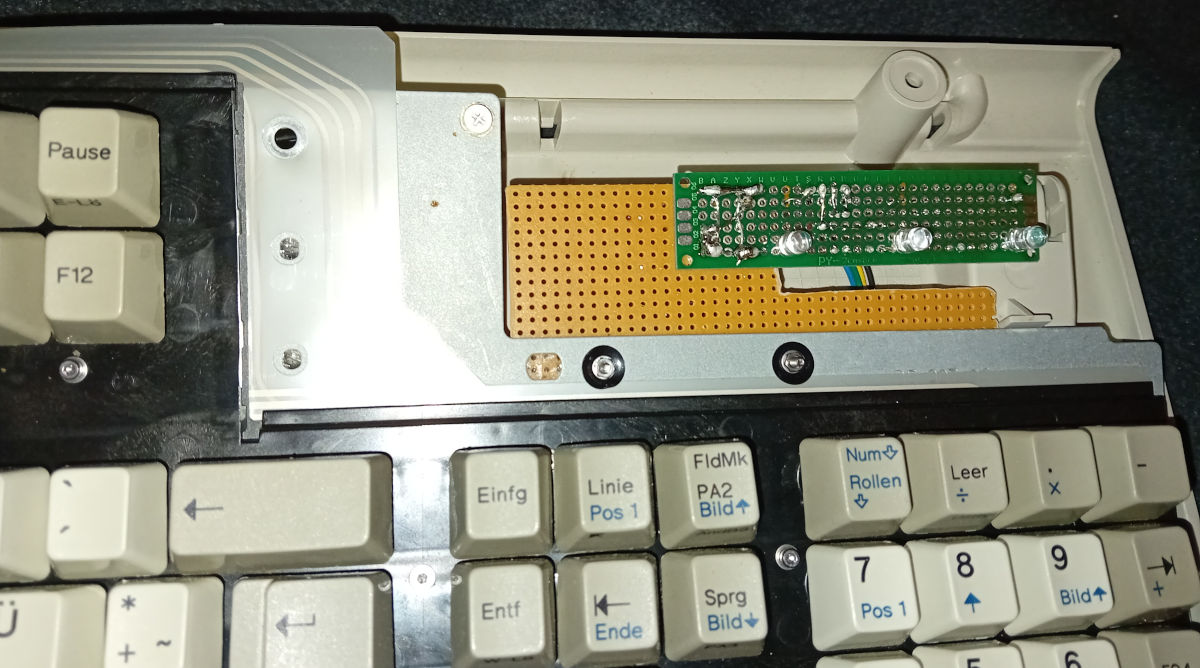

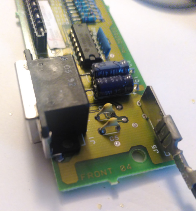

So, I finally had some time again. After looking at the issue in more detail, I came to the conclusion that I needed to desolder the SDL plug. I am somewhat sad about it, but the old detachable PS/2 cables I have are quite stiff and unwieldy for my desk. I also feel that their plastic is somewhat brittle. So I really prefer a modern USB cable.
I am however not ready to work on the 122 key terminal model M. I also have a 102 key model M, so I decided to try this one first:
Here’s the controller board before…
…and after (pin usage indicated):
You can see a bit that one of the metal pieces of the SDL plug is still stuck in there. A victim of my rudimentary desoldering skills—I cannot get it loose. I think there is solder on both sides of the PCB and the heat transport is so high that I can only melt one side at a time. For now, it is not really in the way (it’s a ground pin and there’s two of them).

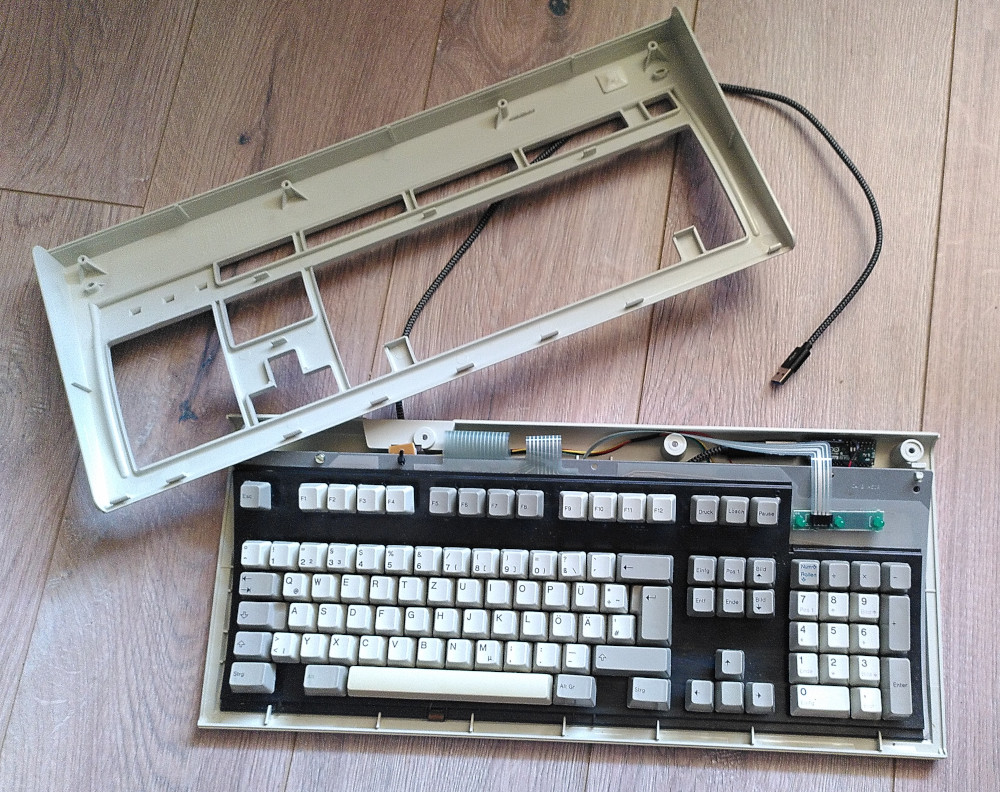

It is a bit tricky to position the Soarer converter in the chassis. Here was my first idea, but it becomes impossible to assemble when the cables to the Soarer converter are fixed to the bottom of the chassis. I also put a little cheat sheet inside in case I need to work on it again.
I ended up just putting the converter in the top right, relying on the stiff USB cable to keep it in place. Note the hacky cable strain relief. But it seems to work.
I just need to get a longer USB cable:
I’ll see how I like this before doing more work on the 122 key M. For that one, I think I have some more space to install the Soarer converter (the original controller board is installed differently and the back of the keyboard is higher). I have some quite short USB C male/USB A female adapters that I could then let hang out of the keyboard to have a detachable USB cable.

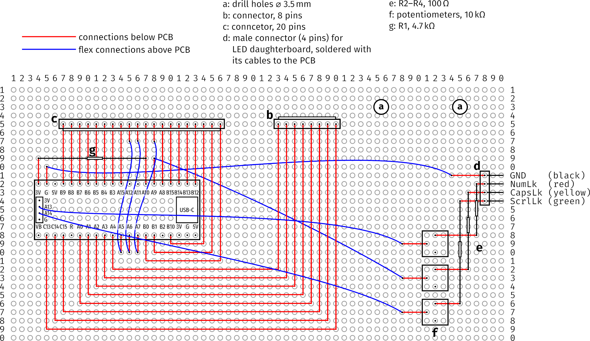

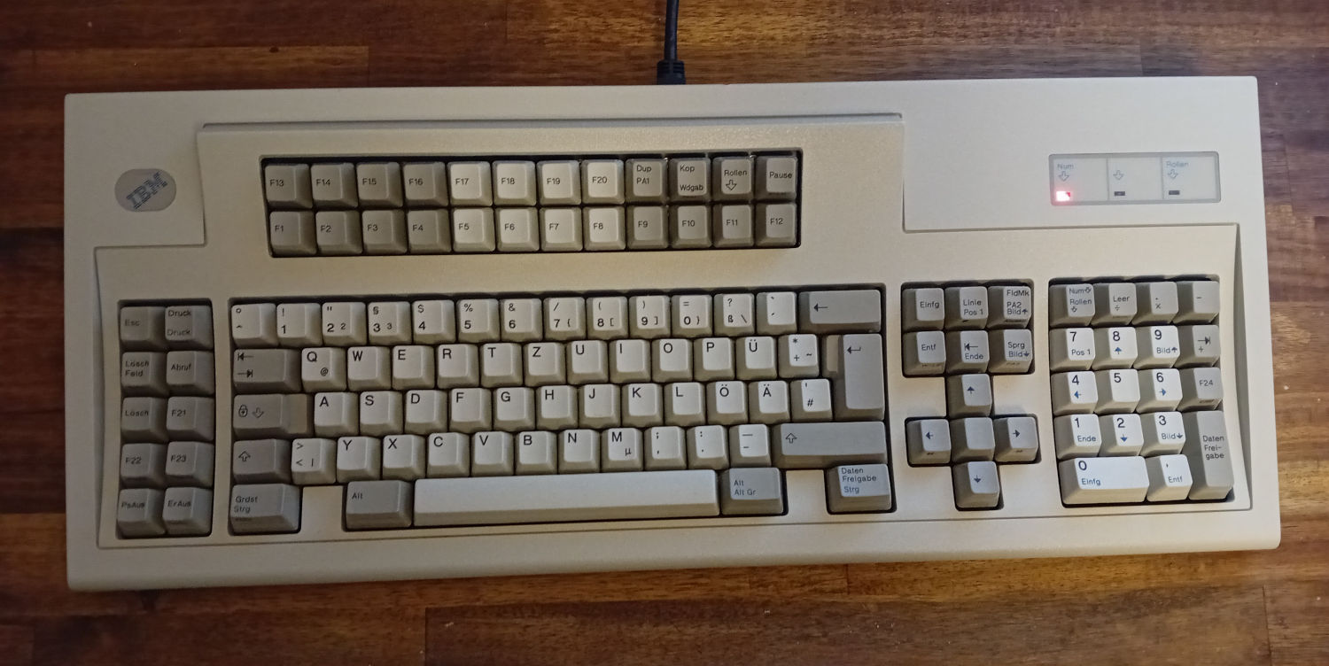

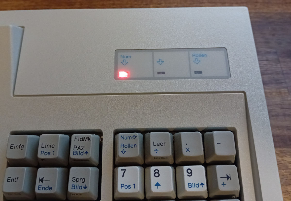

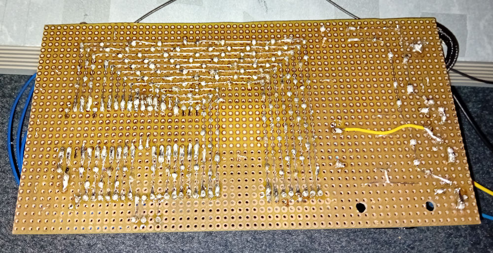

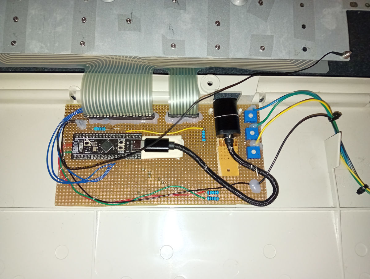

OK, I finished my replacement controller for the battleship. Hooray! The Blackpill-based setup works. There are some hurdles, but they can be overcome.
If using GPIO A10 for the matrix, it needs an additional external pull-up resistor. This has already been planned into the schematics for the replacement controller I based this on (https://github.com/jmaynard/tronguylabs-m122-blackpill), so no problem. Just put 4.7 kΩ between A10 and +3V, for example.
For the indicator LEDs, some non-optimal GPIOs must be used. I finally chose A9, A13, and A14. A13/A14 would be used for debugging, but are not required at all. A9 has an internal pull-down resistor, forcing me to connect the LEDs between the GPIOs and ground, lighting them with a high signal. No problem, except that the original LEDs are connected to +5V and light on a low signal. They are thus installed the wrong way around. This means that the original LEDs are not usable with this new controller. That meant installing my own replacement LEDs (pictures below, it looks like a hack when the keyboard is open, but when it’s closed no one’s the wiser).
I decided to hand solder onto one of those epoxy boards with premade hole grids and copper contacts (no idea what they are called in English). Here’s the rough plan:
I also fixed a short male USB C to female A cable on the controller board and thus had to rearrange the parts for the LEDs on the right side. Improvised it a bit:
I did install potentiometers for the LEDs to be able to control the brightness to my liking. I also used 100 Ω resistors as fail-safes to avoid burning out the LEDs if turning the potentiometers too far (that did happen to me more than once on different projects).
I used some spare parts to make the LED “daughterboard”:
And when it’s closed, you can’t see the mess anymore 🙂:
Since I had to use replacement LEDs anyway, I went with red for the novelty. I also made daughterboards with green, yellow, and blue LEDs so I can change this if I feel like it later.
