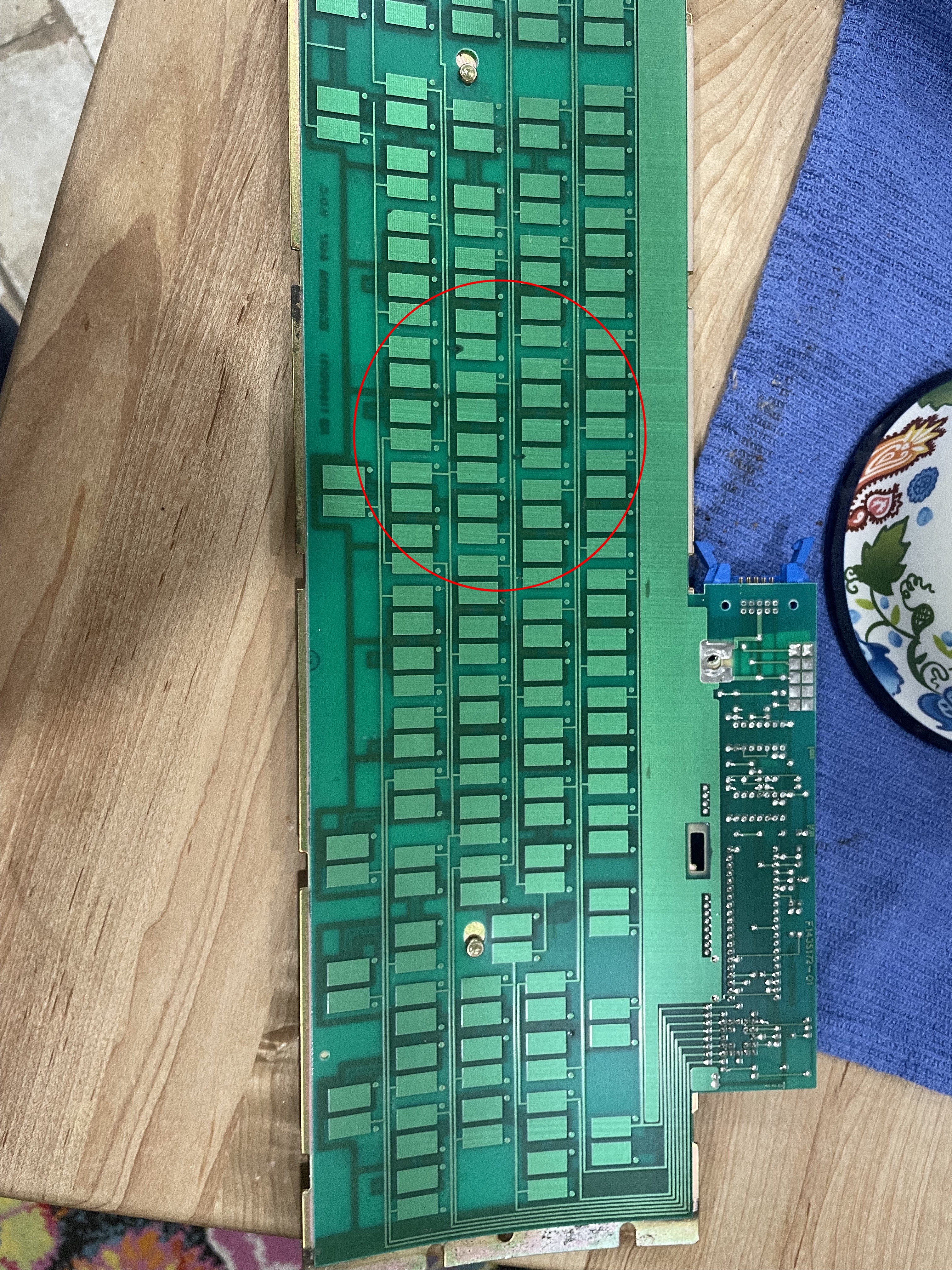

I traded a bunch of old Macintosh computers for two model F keyboards. I got an AT and an XT out of the deal. The AT works fine and was really clean. The XT on the other hand was quite dirty, but still looked to be in better shape than those on eBay, at least on the surface. While disassembling to clean the keyboard I found what appears to be PCB damage. I have no way to test if it works, but judging from the PCB I don't think it will. Can these traces be repaired with something like copper tape, or is this just a 7lb brick?

That's some really *specific* damage. The pads and traces aren't up on the surface, but beneath a protective insulating "solder mask", if I’m remembering the term correctly. So you can't likely just pull out a multimeter and check for continuity.
You're right that those are crucial to the keyboard's function. Those two keys could be disabled, and quite possibly their whole rows if the horizontal lines are broken. The only way to know if it's a problem is to hook it up to an XT computer, if you happen to have one lying around, or more likely a Soarer's converter. The keyboard would need re-assembled with the barrels, springs and caps on.

That's a quick fix if you have a reasonable soldering setup.
  1. Scrape off the solder mask using a pick
  2. Use flux to etch whatever metal remains
  3. If there's still a layer of copper there, just tin it with solder and move on
  4. If there's no remaining copper, use some 30ish AWG wire to redo the trace. Keep it out of the way of the flipper and follow the original path.
  5. Clean well with iso or flux remover and a scrub brush
  6. Coat the surface with some conformal coating or solder mask

Muirium wrote: 26 Oct 2023, 09:42 The only way to know if it's a problem is to hook it up to an XT computer, if you happen to have one lying around, or more likely a Soarer's converter. The keyboard would need re-assembled with the barrels, springs and caps on.
The keyboard is reassembled to prevent further damage, and I currently don't have a way to test it. I'll have to get a Soarers converter to try it out first, and if it doesn't work I'll try repairing it with the steps suggested by jsheradin. Luckily the F AT I received in the same deal works wonderfully with a passive ps/2 adapter. I only had to replace the F and J keys with single-piece model M ones (with the bump) to make typing a bit easier.
