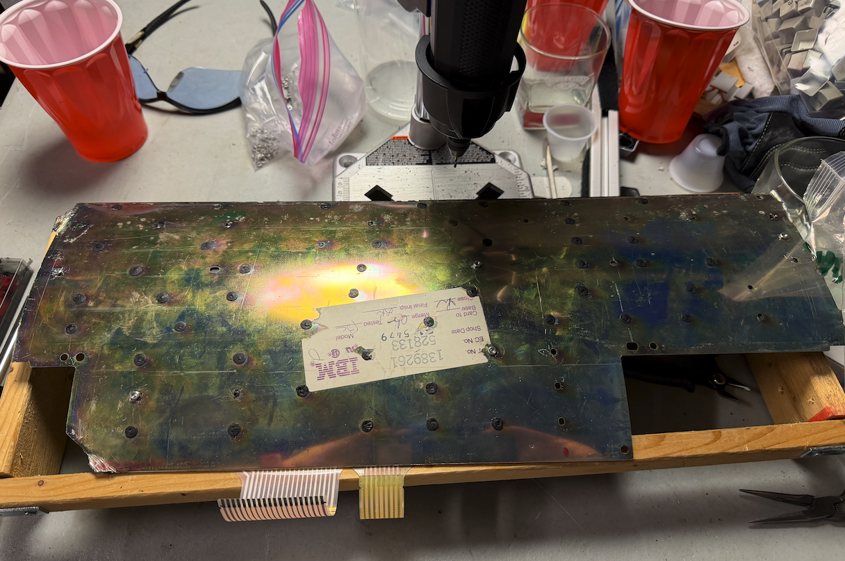

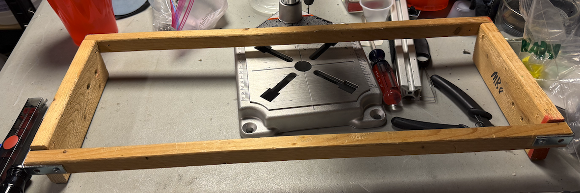

25 Apr 2026, 16:04
I just wanted to mention a few things I've learned.
The first is that a the dremel press unit is very helpful, as it allows me to have the dremel steady and use my hands to move the assembly, rather than attempting to move the dremel. I have shaky hands, so it helps.
The second is that I find holding the screws with pair of bent needle-nose pliers helps immensely.
The third is that I thought the book thing was kind of nuts, but tried it a few times. It was the cause of most of my trouble. I have a history of designing functional things out of wood, so I knocked together this thing out of scrap wood I had in a huge pile of scrap wood in my basement. It works much better, and I recommend anyone who wants to do this, build something like this. It took me literally 5 minutes, although that does require owning a table saw:
