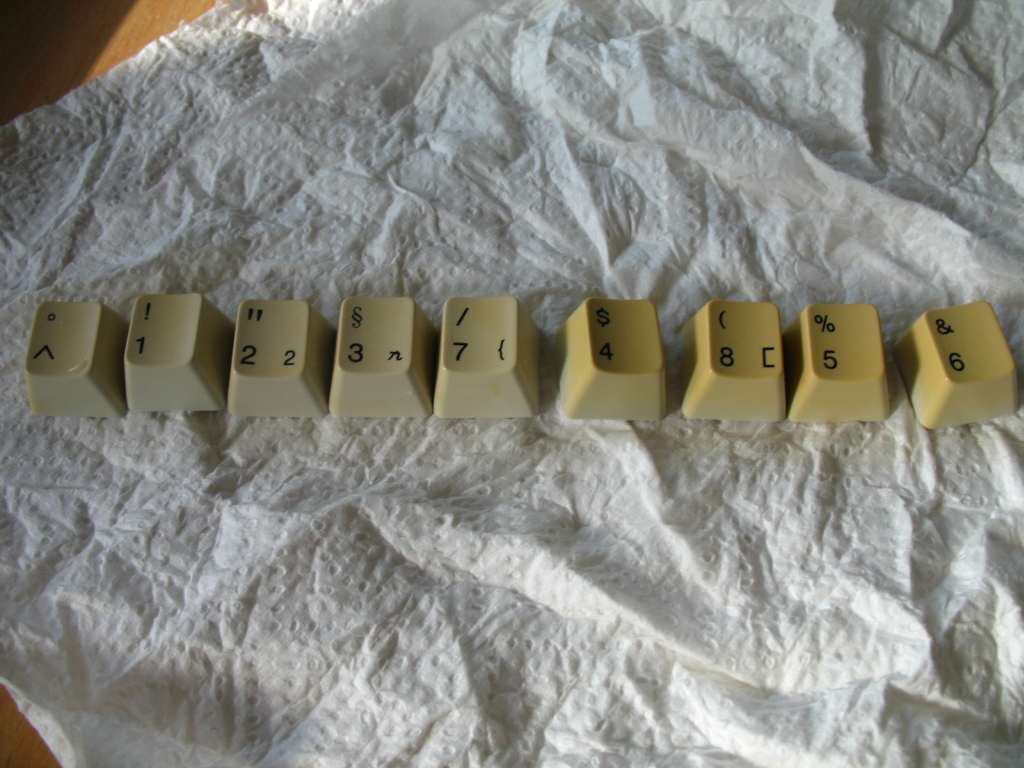

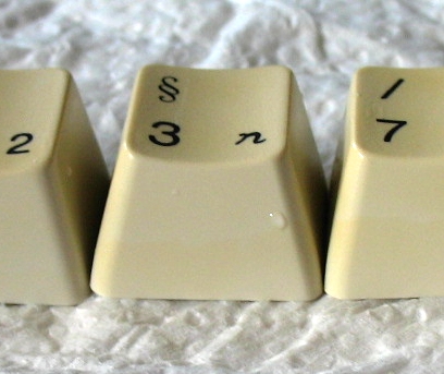

25 Oct 2012, 23:06
I pulled out a white Filco today (the "original" Otaku), and I was shocked. Slight yellowing! It has been in a box!
In original state:
