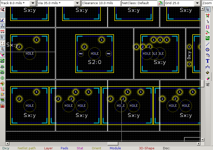

Problem: I can't place modules with underscores in their names.
I wonder if this is an issue with different versions of pcbnew. However, I've solved it by removing any underscores.
Next problem:
How to delete a part of a module or edit the name, once it has been placed.
Solved: Just right-click at the component and choose the submenu of the first menu item.
Editing a module:
double-right-click gives the full menu to perform rotations etc.

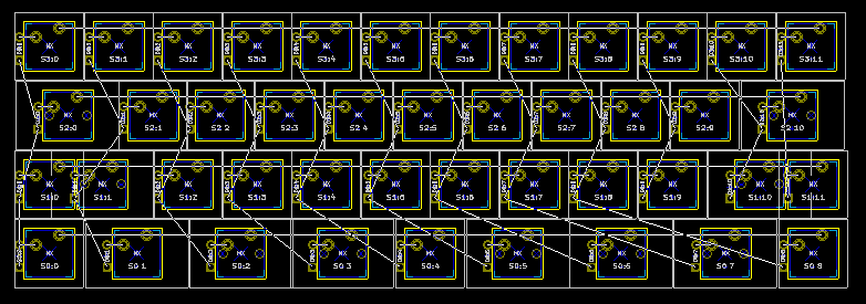

One question about the Cherry switches and diodes: Is the blue section the area where the switch is, or is it the yellow?

You should always define the schematic first. In the EEschema schematics editor. If your components aren't defined there with references and all, you will sooner or later auto-delete them somehow =P From EEschema you export a netlist file, something that is only possible if all components have been given references properly (annotated).
There are some buttons in the left panel of PCBnew where you can set how much of the ratsnest that is displayed. Everything, only the current component, or nothing. There is also a lot of visibility options under the Render tab in the right hand panel.
I sort of got sidetracked with other business while writing the KiCAD tutorial.. There is a lot of work to be done to it =P
The yellow lines are for the plate cutout, the blue ones the footprint stayout area of the component (I sort of guessed them so don't place anything too close)

Controller and LED pads are still missing, but can be added at any time.

Usage:
scheme.pl -s 4x12 > mykeyboard.sch
Output is the content of a .sch file with the necessary matrix.
Run mykeyboard.sch through kicad-GUI and make a .net file out of it.
The necessary .cmp file is generated by this script:
#!/bin/bash
# purpose: generate .cmp file from .brd source
echo "Cmp-Mod V01 Created by CvPcb (2012-04-29 BZR 3537)-testing date = Fri 03 Aug 2012 03:04:22 PM CEST"
cat "$@" | grep ^Li -A4 |
grep ^AR -v |
grep ^Op -v |
sed 's/^T0[[:space:]]\([^"]\+\)["]\([^"]\+\)["]\(.*\)$/Reference = \2;\nValeurCmp = \2;\nEndCmp/' |
sed 's/^Li\([[:space:]]*\)\([^[:space:]]\+\)/BeginCmp\nIdModule = \2;/' |
sed 's/^Sc\([[:space:]]*\)\([[:alnum:]]\+\)\([[:space:]]*\)$/TimeStamp = \/\2;/'|
sed 's/[-][-]//'
echo "EndListe"
Usage:
board.sh mykeyboard.brd > mykeyboard.cmp
Then you can load mykeyboard.brd into pcbnew and let it read the netlist (by clicking on the Read Netlist icon in the top panel). Ignore the error messages and you are done.
This is how it looks like:
