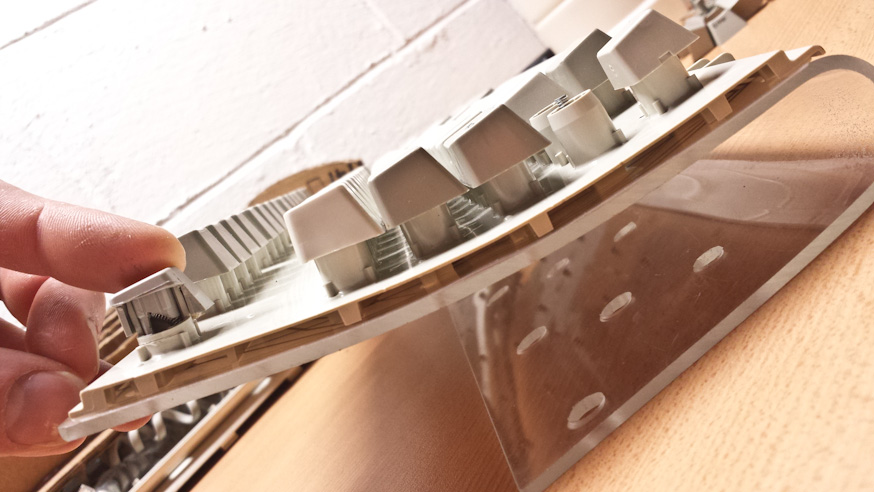

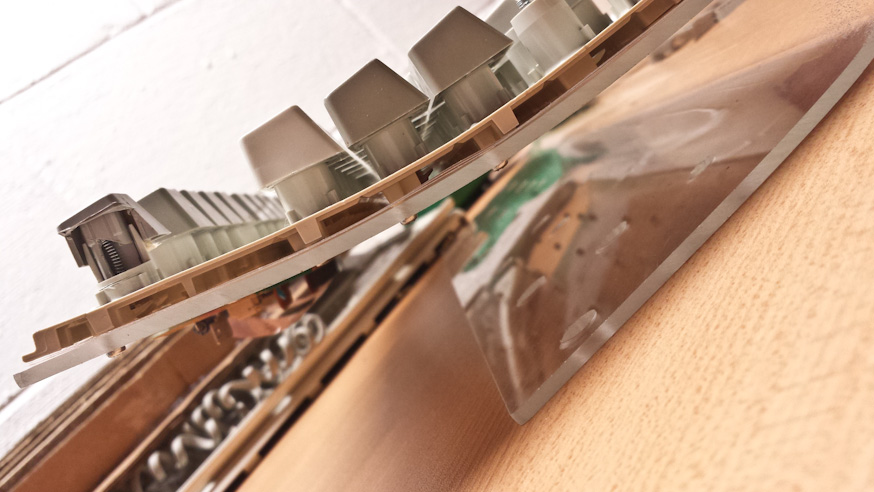

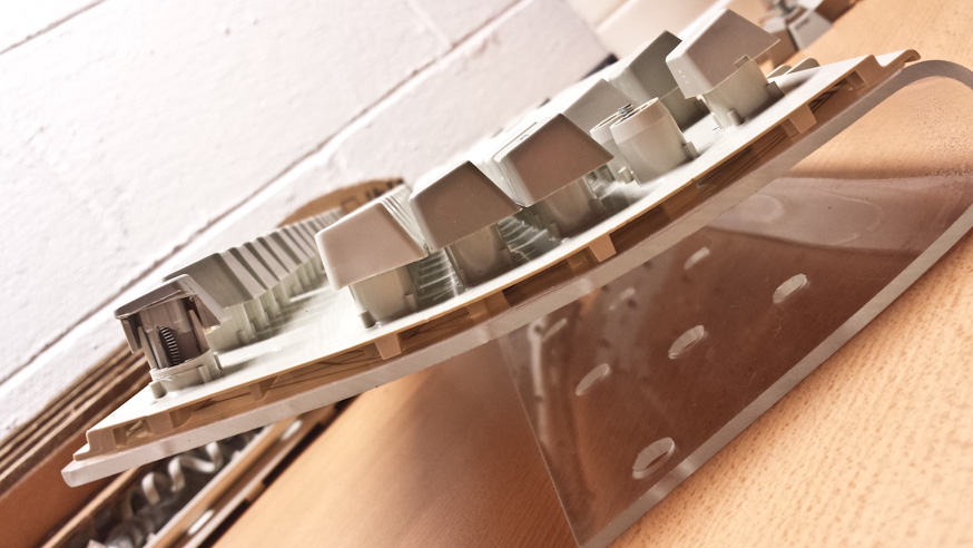

I have a little pet project for a display at the vintage computer fest in April.
Sneak peak!:
2014-03-15 17.21.35.jpg (133.77 KiB) Viewed 4258 times
2014-03-15 17.23.08.jpg (108.6 KiB) Viewed 4258 times
The one key I have in there sounds awesome when pressed. Hehehehe!!

Oh wow, that's really cool!
Now that I think of it, I'm surprised noone has ever done this before, it should work pretty perfectly.
E TwentyNine
16 Mar 2014, 01:37

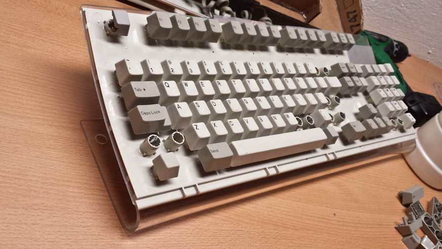

I have a sheet of plexiglass and have considered doing something like this, but just replacing the backplate, and making some sort of open design ala the steampunk boards.
Getting an oversized piece and bending it to make a stand is an outstanding idea.

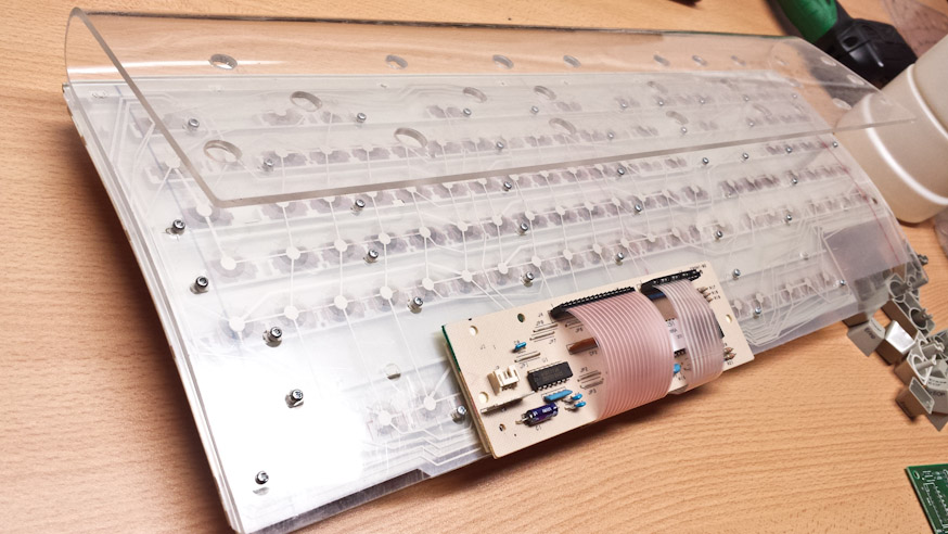

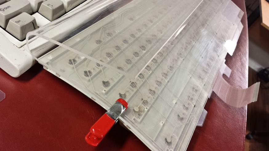

Indeed. Reckon you could mount the controller underneath and make a fully working skeleboard?
I want to believe.
phosphorglow
16 Mar 2014, 21:40
Muirium wrote:Indeed. Reckon you could mount the controller underneath and make a fully working skeleboard?
I want to believe.
Heheheh :P
Done and done. I'll take some pictures soon.

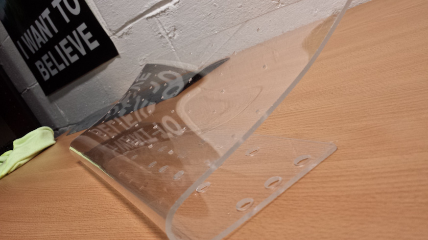

I'd also be curious as to the method used to get the curve on the board. Heatgun and a backplate, just eyeballed it, what?
phosphorglow
16 Mar 2014, 21:48
E TwentyNine wrote:I'd also be curious as to the method used to get the curve on the board. Heatgun and a backplate, just eyeballed it, what?
You got it! Heat gun and backplate.
I'm excited to see other people fiddle around with various designs.

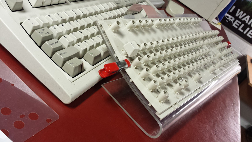

It does solve the problem of my friend needing a keyboard for his iMac that he's retrofitting, and opens the door to making a split ergo model M... ^_^

I considered the split M too, but simply using standard backplates.
Honestly most of my M ideas got set aside once I modded my F, I'm liking it too much.

Now I'm also wondering how that might look if you snuck some LED's in there, the way LED's can light up the edge of cut plexiglas....

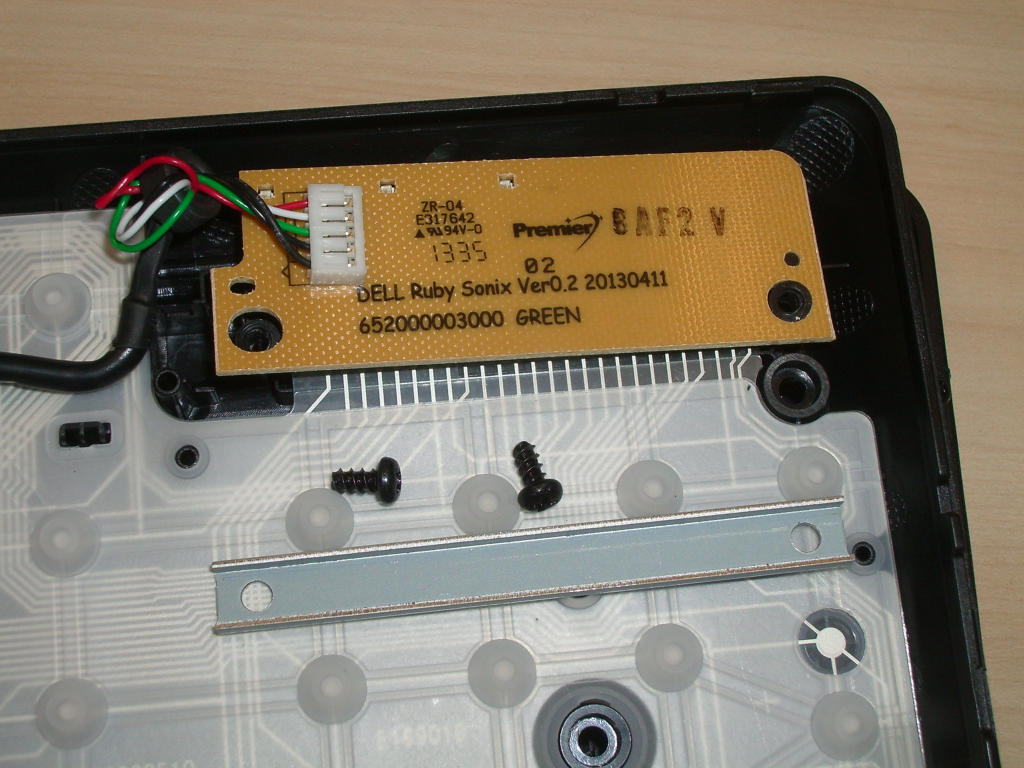

Making this look like a finished product isn't easy, but it's doable. Are the membranes special in any way? Could you scavenge some from a modern desktop PC where the controller board is on the far right?
Dell KB-212B membranes.jpg (152.64 KiB) Viewed 4098 times
This would allow you to place the controller board directly under the LED area, especially useful if anyone wants to have a custom controller instead of the IBM one.
Also, it would make it easier to get ISO and Windows key versions. (Differences in key spacing would simply involve altering the 3D shape file for the barrel plate.)

I have tried putting a membrane from a USB keyboard inside the model M assembly. It works fine. The pads that line up that is. The problem is finding a keyboard where the pads are in all the right positions.
I acquired a Keytronic classic M clone to use the case for something (that failed miserably), but I'm pretty sure the keys were spaced properly. The problem became where the holes for the bolt mod would go, and where the traces ran on the Keytronic membrane. Seemed doable but not worth the effort at the time.
Also, as far as I know, and I could be wrong, the more recent unicomp M's all have the controller on the top right.

That looks like an old school Unicomp M controller?
The controller is a Lexmark manufactured - '93ish I think.
Oooooooohhhh! A clear barrel plate...!!! Yes yes and yes. And while we're at it, clear keys. :D
Technically I could drill holes for some LED's into the barrel plate. That controller does support lights. Hmmm...
So. Who can 3D print a translucent barrel plate? Heheheh.
