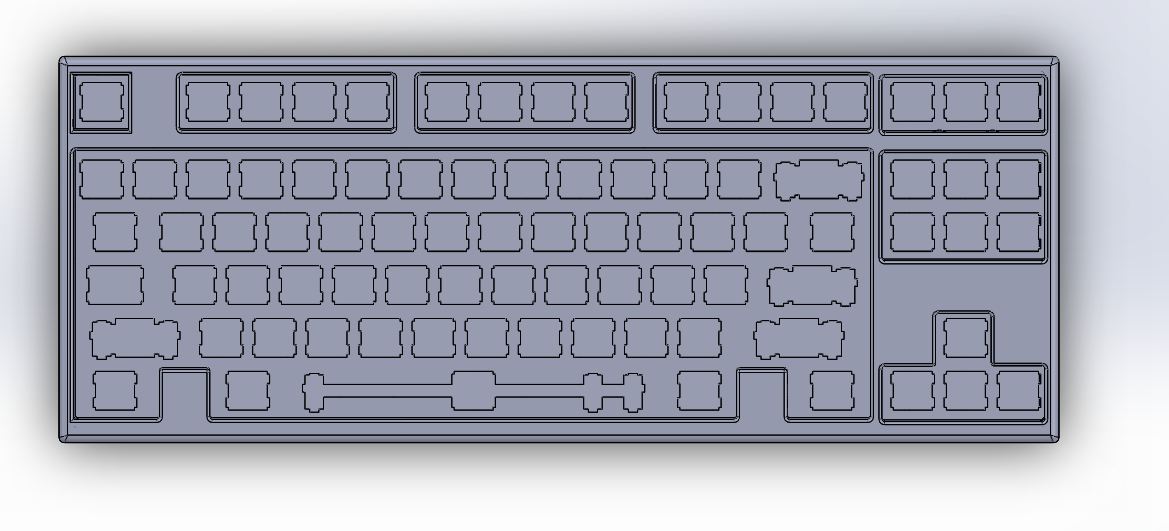

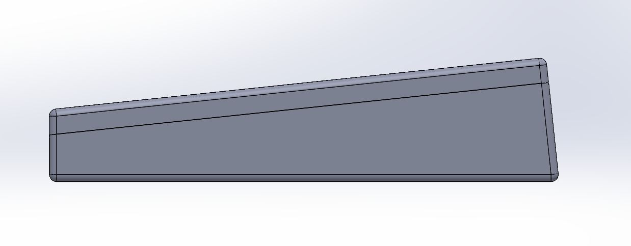

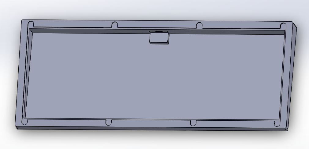

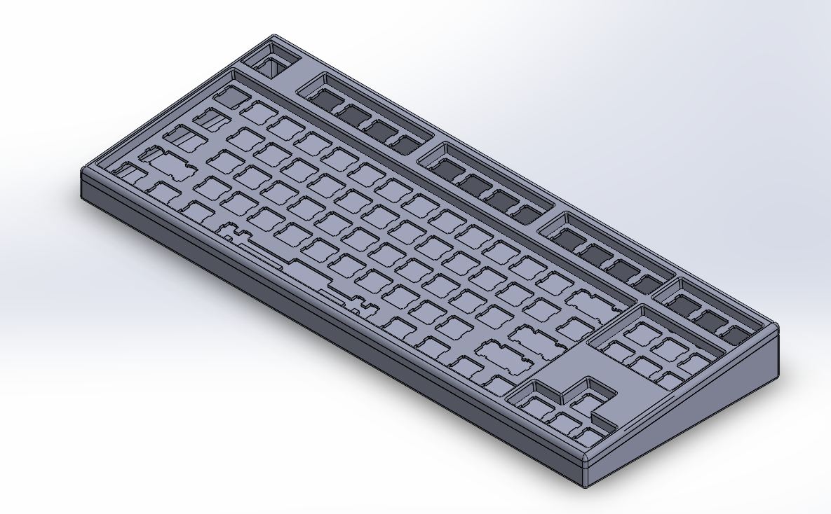

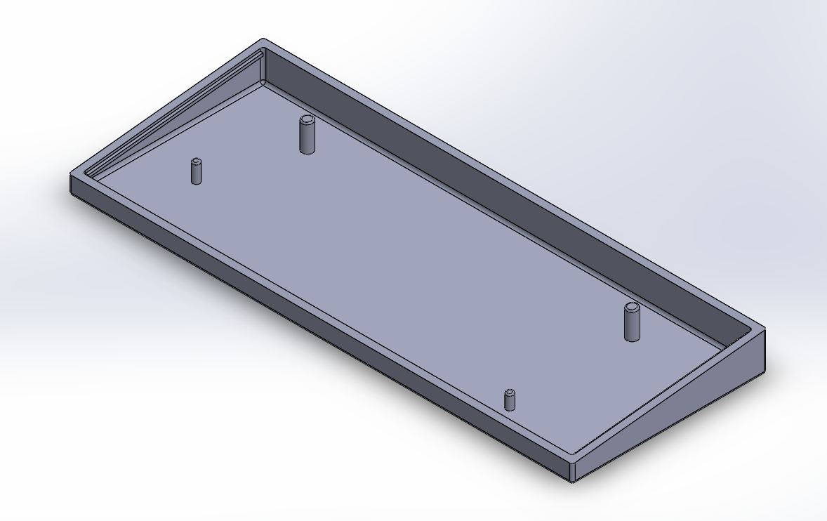

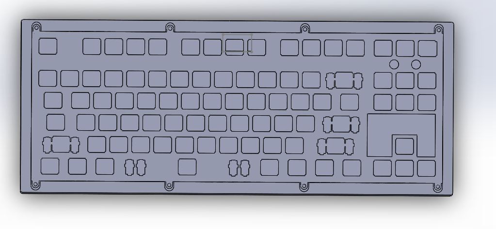

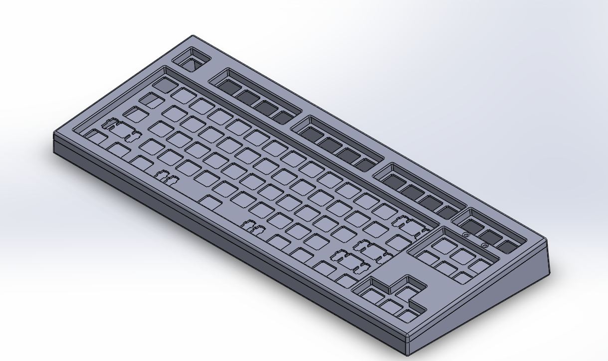

I've decided to change the mounting. New plates will have to be made, and they will be screwed directly onto the case (similar to the KMAC). This will allow the case to be used with more keyboards (I believe it should work with any plate mounted TKL that has the same layout as one of the plates - there will be iso, ansi, 7bit etc), and I believe the mounting system is superior to stand offs.
- all.JPG (125.78 KiB) Viewed 16049 times
- platebottom.JPG (117.23 KiB) Viewed 16049 times
- plate.JPG (98.67 KiB) Viewed 16049 times

It depends on where you are in the world. I reckon It'll be around the £150-200 mark (including the plate and anodising), so if you're in the UK or western Europe it'll probably end up cheaper than getting the Vortex from the US and paying a packet on postage/customs. However, I can't say the same thing if you're in the US. Bear in mind that £150-200 is just a rough estimate. It could be cheaper or more expensive.Grond wrote:That's great, I've been waiting for something like this! I hope this is happening, and as long as it's cheaper than Vortex's, I'm getting one for my Filco.

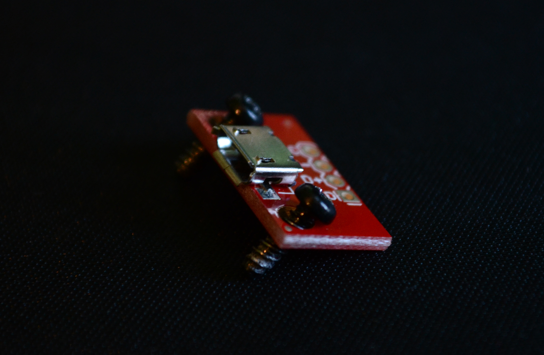

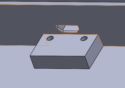

Added the mount for the micro/mini usb breakout board.
Here's the mount at the minute. It's very simple, but I believe it will be perfect. Screws will hold the breakout board securely in place, there's a large hole for the connector to fit into but the hole goes from large into a shaped hole which makes it look nice and tidy. However, I'm considering removing the shaped hole in order to make this easily compatible with mini-usb.
- mount3.JPG (19.58 KiB) Viewed 15931 times
- mount2.JPG (24.88 KiB) Viewed 15931 times
- mount1.JPG (18.38 KiB) Viewed 15931 times

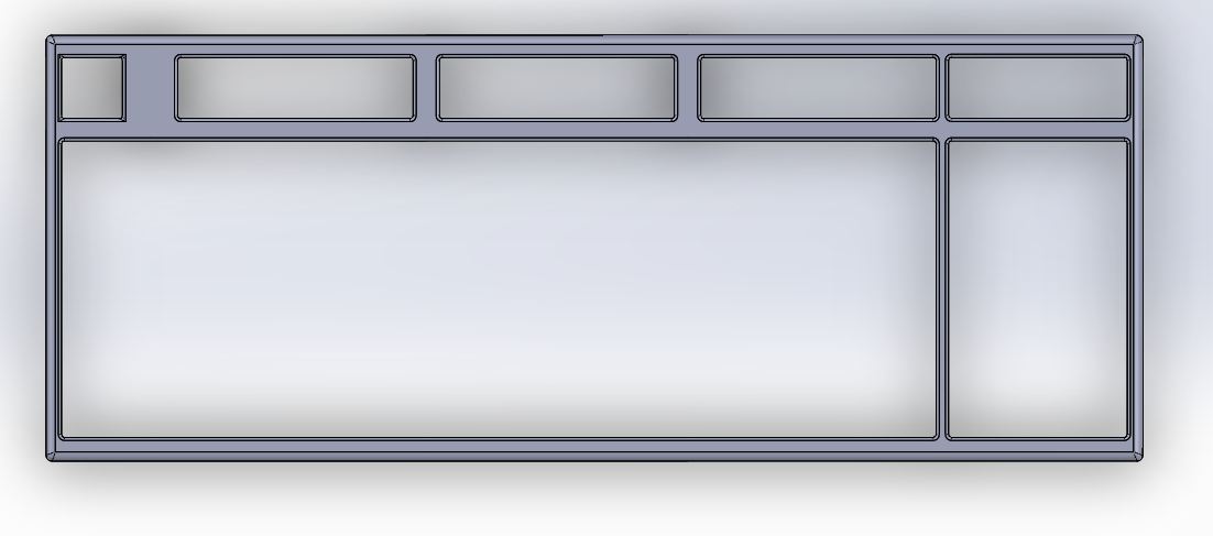

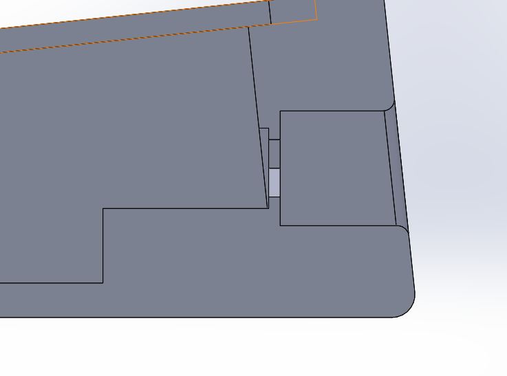

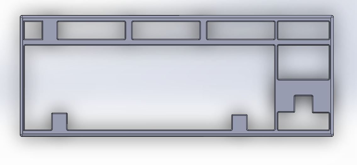

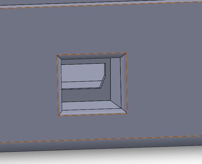

I've now finalised the plate design, plate mounts and usb mount.
I had to change the usb mount slightly so that the breakout board comes into contact with a right angle instead of an 84 degree angle, but otherwise it's practically the same.
Changed the plate mount so there's space for screws etc.
Now I just need to do the following :
-Apply new plate design to other layouts
-Adjust 7bit and winkeyless top halves slightly
-Add small things such as places for rubber feet
-Add screwholes (I already know where I'm putting them and what screws I'm using. Just haven't got round to it yet.)
Once those things are done and I've triple checked the design I'll get a quote for a prototype!
- usbcross.JPG (23.35 KiB) Viewed 15549 times
- usbout.JPG (26.6 KiB) Viewed 15549 times
- usbin.JPG (29.31 KiB) Viewed 15549 times
- caseplate.JPG (38.71 KiB) Viewed 15549 times
- platecase.JPG (66.91 KiB) Viewed 15549 times

I'm sorry, if I misunderstood but:
nobody in their sane mind will be getting a new plate for their Phantom just so they can fit it inside that case especially since that would involve doing a load of ddesoldering and then more soldering...
- photekq
- Cherry Picker
- Location: United Kingdom
You didn't misunderstand the plate, however you have misunderstood the reason why I'm making this. I started designing this for myself, and I was not planning to sell it. If people are interested then I will sell it, but for barely any profit. This project is me, I want it to have a custom plate, and I'm willing to do the soldering (I quite enjoy soldering, and I'm sure there are a few out there who do aswell).Half-Saint wrote:I'm sorry, if I misunderstood but:
I am fully aware that most people would prefer to not have to do any work and have the standoffs, but at the end of the day this project is for me and I prefer this design and so I'm sticking to it. Besides, I have never seen an aluminium case that supports a 7bit layout, and I have only seen korean boards that support a winkeyless layout. Hopefully I'll be able to offer something unique.
Also this case isn't just for the phantom. Due to the custom plate this will work with virtually any TKL keyboard. This would not be so if I had stuck with the standoffs design.
