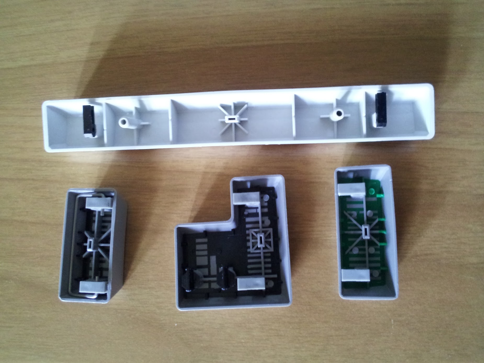

It's Big Assed Enter night on DT! Here's mine:
- IMG_6822.JPG (242.56 KiB) Viewed 7360 times
That was a tricky cap to get off. But with some patient wiggling, it is done; with wiry stabs all intact.
