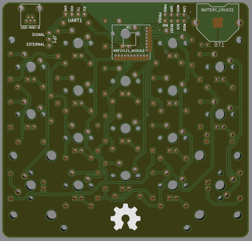

First of all, I apologize for hijacking PJE's thread. If it's a problem - I will make my own, but I thought this belongs here, since this is PJE's layout and design.
So, I've started working on the wireless version of the PJE's OneHand layout. Because of EagleCAD's board size limitations I've had to learn to use KiCad which was a pretty pleasant experience. On the whole I think it's a much better package than EagleCAD even not taking the Eagle's limitations into consideration. This is what I've got so far:
This image is from an amazing piece of software called ZofZPCB. It takes the gerber files as input and creates a rotatable 3D representation of the finished PCB. It really is amazing.
I am using the smaller CR1632 coin cell (upper left corner, under that SMD mosfet) because I could not fit the CR2032 on the board. I have a reverse polarity protection MOSFET and a through-hole mini USB socket for powering the LEDs. I've also added a breakout for programming the nRF and a breakout for UART.
I've made all the components through-hole to make it easier to assemble. The only exception is the MOSFET, but that shouldn't be hard to solder.
I still have to double check the component footprints, and think of where to put to mounting holes. Then I'll send the gerbers to a PCB fab. And then I'll start working on the firmware.
I've attached the KiCad files of the board and schematic. I used the latest version, so you might have to upgrade if you want to open the files. I will probably make a google code project later on.
All comments are more than welcome.

Hi kile, no problem with hijacking the thread. Post away!
Love the design idea. I'm considering moving the outside columns down on the V2 design to line up with the center column to keep my thumb and little finger more centered on the home keys. The current layout is still pretty good for my hand size though.
Your placement of the RF module is clever, I'd recommend ensuring no ground plane covers the on board antenna.

This is the last sanity check before I send the gerbers to the PCB fab.
The LED on SW1:3 can be disconnected from the 5V USB power and connected to an MCU pin and used as a signalization LED for some firmware features (board lock/unlock or layer switcher for instance). Wether the LED is on the 5V or on the MCU can be selected with a jumper (JP1).
I've tried to keep the PCB area around the antenna clear from copper to avoid shielding.
I've added an "external power" source if you want to connect larger batteries. For instance, if there is room in the case you could power the circuit from two AAA which would last much longer than the coin cell battery.
The KiCad files and gerbers can be found on: https://code.google.com/p/onehand-wireless/
Comments and suggestions are welcome!

Hi kile,kile wrote:This is the last sanity check before I send the gerbers to the PCB fab.
Nice work! The only suggestion I'd make would be to drop a 3.3V regulator powered by true USB connector which would allow the board to be powered from a USB battery pack. Some of these packs are small enough to package with the keyboard and can be recharged as needed.
I'm working on a new TwoHand arrangement with less angle between the two units. I'm looking a creating a V2 PCB for this type of keyboard, maybe offloading the CPU onto a thumb switch board placed between two OneHand matrix PCBs.

Hmmm... Do you mean adding another USB port which would power the LEDs and the controller? Or using the existing USB plug? Either would mean you have to remove the CR1632 battery when you plug in the USB or else the battery might go boom! Also, I don't like regulators for this because all have a quiescant current which is usually about 10 times higher than the controller power consumption. I would be powering the regulator instead of the rest of the circuit. I already have one USB connector which only powers the LEDs, so you can plug the USB battery pack into that and keep the controller powered from a CR1632.PJE wrote:The only suggestion I'd make would be to drop a 3.3V regulator powered by true USB connector which would allow the board to be powered from a USB battery pack. Some of these packs are small enough to package with the keyboard and can be recharged as needed.
I've made another check moments before I wanted to send the files and found a serious problem. I swapped two pins on the module breakout which would need some ugly trace cutting to fix had I not caught it. Phew!
I've never before sent a PCB into production without etching a prototype at home first. I'm a bit nervous...

For some reason my response never made it to the board...kile wrote:Hmmm... Do you mean adding another USB port which would power the LEDs and the controller? Or using the existing USB plug? Either would mean you have to remove the CR1632 battery when you plug in the USB or else the battery might go boom! Also, I don't like regulators for this because all have a quiescant current which is usually about 10 times higher than the controller power consumption. I would be powering the regulator instead of the rest of the circuit. I already have one USB connector which only powers the LEDs, so you can plug the USB battery pack into that and keep the controller powered from a CR1632.
I was meaning via the USB you had already added. Obviously this comes down to how long the keyboard will work on the CR1632. Did you see if a CR2032 would fit? From my checks it seems to have a better price/power ratio than the smaller cell.
I bought my OneHand PCBs from Seeedstudio for $25. I was very happy with their quality.

My initial idea was to use CR2032, but I couldn't fit it on the PCB that was planned to be 94mm long at the time. Since then I extended it to 99mm to make room for the upper mounting holes, and I didn't check if the CR2032 would fit to the new size. Now I did and it turns out it would fit if I move the serial and the programming interfaces. So, I will delay sending the files another day or so... damn, will this ever end?!PJE wrote:Did you see if a CR2032 would fit? From my checks it seems to have a better price/power ratio than the smaller cell.
Yes, I use ITead. Same factory, same quality. $28.88 shipped for green PCBs.PJE wrote:I bought my OneHand PCBs from Seeedstudio for $25. I was very happy with their quality.

Last night I've changed the battery holder to CR2032, rerouted the top of the PCB and sent the gerbers to ITead. And today I found a small mistake on the board. I wanted the mounting holes to be 3mm, but they turned out to be only 2.5mm. Oh, well...
