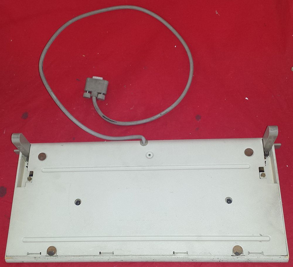

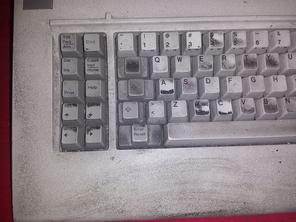

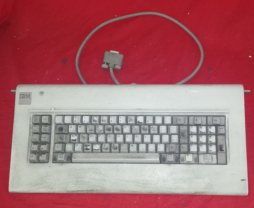

I couldn't help myself. I know nothing about it, but it's filthy, strangely proportioned, and has a cute stance. Waiting for it to arrive - anybody have some background info?
- Muirium
- µ
- DT Pro Member: µ
Bigfoot:
http://deskthority.net/wiki/IBM_Model_F ... 1_Keyboard
A Model F. But, as far as I know, incompatible with Xwhatsit's or Hataa's controllers.
http://deskthority.net/keyboards-f2/ibm ... it=Bigfoot

Neato! I'll look into it, thanks!Parak wrote:Soarer's controller (not adapter) works with it, AFAIK.

I could be wrong (I find IBM's naming and product labyrinth impossible to fully understand…) but according to this thread, the controller PCB is hard bonded to the keyboard matrix on this model, and it doesn't speak a protocol that Soarer's converter supports. That's both controller and converter incompatible. Well, without a lot of chopping…
Hopefully I am just misidentifying this keyboard. If you can hook it up to Soarer's converter, you will indeed have a lot of fun with it. His stuff is great!
By the way: Soarer's controller doesn't handle capacitance sensing, so it is not for Model Fs. It can drive a Model M because those switch in the same basic way as MX switches. There are other, specialised, capsense controllers out there like Xwhatsit's instead.

I'm pretty sure Muirium is right here - pretty much all of terminal Model Fs (except the 122-keys) will need a much more low level adapter as they speak a weird protocol over a parallel connector which doesn't map nicely onto the AT protocol.

Interesting that the 122 keys were better behaved. Even the little Kishsaver falls into this trap: the stock controller doesn't send full make and break codes (separate signals when keys are pressed and released) unless in a diagnostic mode that Hasu used for his Kish converter. Although an excellent bit of detective work on Hasu's part, it never was fast enough to keep up with moderately fast typing.
So everyone's currently installing replacement controllers in their Kishsavers to get around all that. The installation is quite fiddly (there's a 30 pin ribbon cable to desolder and resolder, while keeping aligned) but far from impractical. But the Model Fs with integrated controllers, like the XT and the Bigfoot, are a whole other order of hard to work with.
The XT, fortunately, works just perfectly with its stock controller and Soarer's converter. But the other guys don't.

I am confused. I thought that the IBM Model F 122-key keyboards worked fine with Soarer's converter. I have an F-122 waiting in the wings. I am typing this on my XT, but I am still using the Hagstsrom converter.Muirium wrote:Interesting that the 122 keys were better behaved. Even the little Kishsaver falls into this trap: the stock controller doesn't send full make and break codes (separate signals when keys are pressed and released) unless in a diagnostic mode that Hasu used for his Kish converter. Although an excellent bit of detective work on Hasu's part, it never was fast enough to keep up with moderately fast typing.

Sorry about that, I just wandered off on a tangent. The 122 key Model F isn't affected by the weird protocol problem that rendered the Kishsaver silent until just recently. 122 key Model Fs and XTs speak in a sensible tongue and Soarer's converter is quite enough for either of them.
The Bigfoot's problem is that it is stricken by the protocol issue *and* has a hard mounted controller. A keyboard is fine if it only suffers one of those two. (The Kishsaver fails the first but passes the second. The XT passes the first while failing the second.)
Hopefully I'm wrong, and Phosphor's Bigfoot doesn't have this hard mounted controller:
If it does, things get complex. No one has made a converter. And it takes daring to hack something like that straight off the main PCB, to clear space for a replacement.

Hrm? Soarer's Controller firmware includes a bigfoot config file.
# IBM 'bigfoot' PC/XT layout 5291-2 terminal keyboard
# Works without modification to keyboard (bigfoot has no CPU!).
Also, I'm typing on my SSK with his controller firmware right now and wow - it's ridiculously easy to configure and install. Bam. Haven't done the layer mapping yet but it also looks super freakin' simple.
Soarer - you rock. A lot.

Perhaps he means a Model M version of the Bigfoot. Model F keyboards use a completely different sensing technology, which requires more complex electronics. (You have to probe with an oscillator instead of a simple flat voltage.)

Further investigation yields: Soarer is epic.
http://geekhack.org/index.php?topic=48950.0
It reads multiplexed strobes. Neato.

Oh, that's good! The one he's converted has a weird split controller design, where the capsense and the logic are separated entirely. Instead of a signal/protocol, the raw capsensed output is exposed over the wire, so he's processing that. Hopefully yours is one of these!
