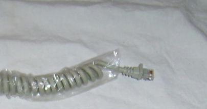

Sorry for the crappy picture but could you connect this with a adapter of something else. looks a like a RJ45 connector.
29 Dec 2014, 20:36
Take a better picture. The pins are the only thing of significance. Can't even see them there!

Muirium wrote: Take a better picture. The pins are the only thing of significance. Can't even see them there!
Re: pulling cpas from space invaders, I tried, believe me! A hundred and some times. I did every combination and sequence of pressure I could think of. About quarter to a half off them came off inside their caps in any case!
This is the only one I can do right now, not my picture.
30 Dec 2014, 17:39
crunch wrote: This is the only one I can do right now, not my picture.
When you say RJ45, you mean 8P8C, right? And all eight wires? That's unusual for a keyboard: it's normally 4P or 6P.
Your picture there is 6P6C.
crunch
30 Dec 2014, 17:51
Ok so this 6P6C conector can you find a adapter or something to either PS2 or USB, I know nothing about this.
I thinking of buying the keyboard and would like to know if it's possible to convert it somehow to ps2 or usb.
31 Dec 2014, 00:20
crunch wrote: I thinking of buying the keyboard and would like to know if it's possible to convert it somehow to ps2 or usb.
Yes it will be possible somehow. Whether the effort and cost required is within your expectations depends entirely on what keyboard it is, and so far all I see is a cable.

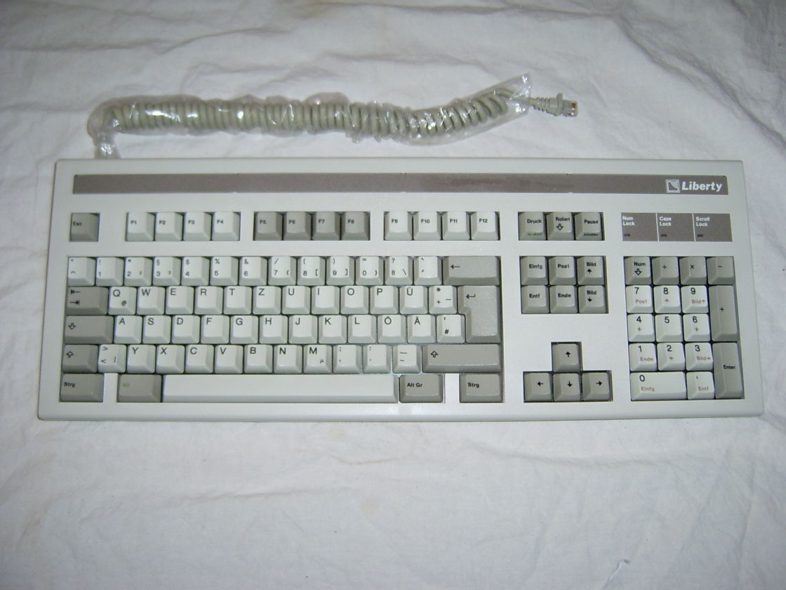

Here is the keyboard, it has white space invaders.
31 Dec 2014, 01:03
OK, so it's a regular PC layout, so that's promising. It might just be that it talks AT on a modular connector, in which case you'd either need to cut the plug, wire up a PS/2 plug to a modular jack (to preserve the keyboard intact), or replace the whole cable with a PS/2 cable from a donor keyboard.
Not a guarantee, as there are perfectly normal–looking Alps Bigfoot keyboards that use one or more SGI protocols, instead of the AT protocol.
What model is it? That might shed some more light on it if no-one else recognises it. The rear label might give some clues as to what system it was designed for.

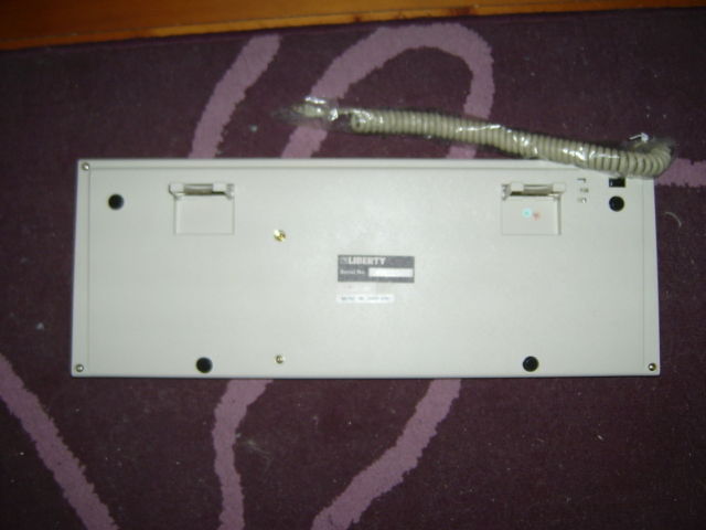

I got some info and a picture.
Liberty: Serien No. TK900009
Made in Thailand
117173-001
31 Dec 2014, 16:55
I think it's safe to say that Liberty were not one of the big names in computer terminals. The only thing I could find was this dead topic:
https://geekhack.org/index.php?topic=35205.0
No answers, but it does show you the allocations of the wires in at least one terminal. There's some models here, but they're not widely documented:
http://www.usedprice.com/items/computer ... index.html
I think this one is going to be a gamble! Interestingly, there seems to be a switch on the bottom right — but my CSI isn't working and I can't see what it selects.

Daniel Beardsmore wrote: I think it's safe to say that Liberty were not one of the big names in computer terminals. The only thing I could find was this dead topic:
Thanks will look at that. Do you know if it would be possible to use something like RJ12 to DB9 and then DB9 to PS2.
http://www.ebay.co.uk/itm/ADAPTOR-DB9-J ... 5b019cccda
http://www.ebay.co.uk/itm/PS-2-PS2-PS-2 ... 3ccbce2174
