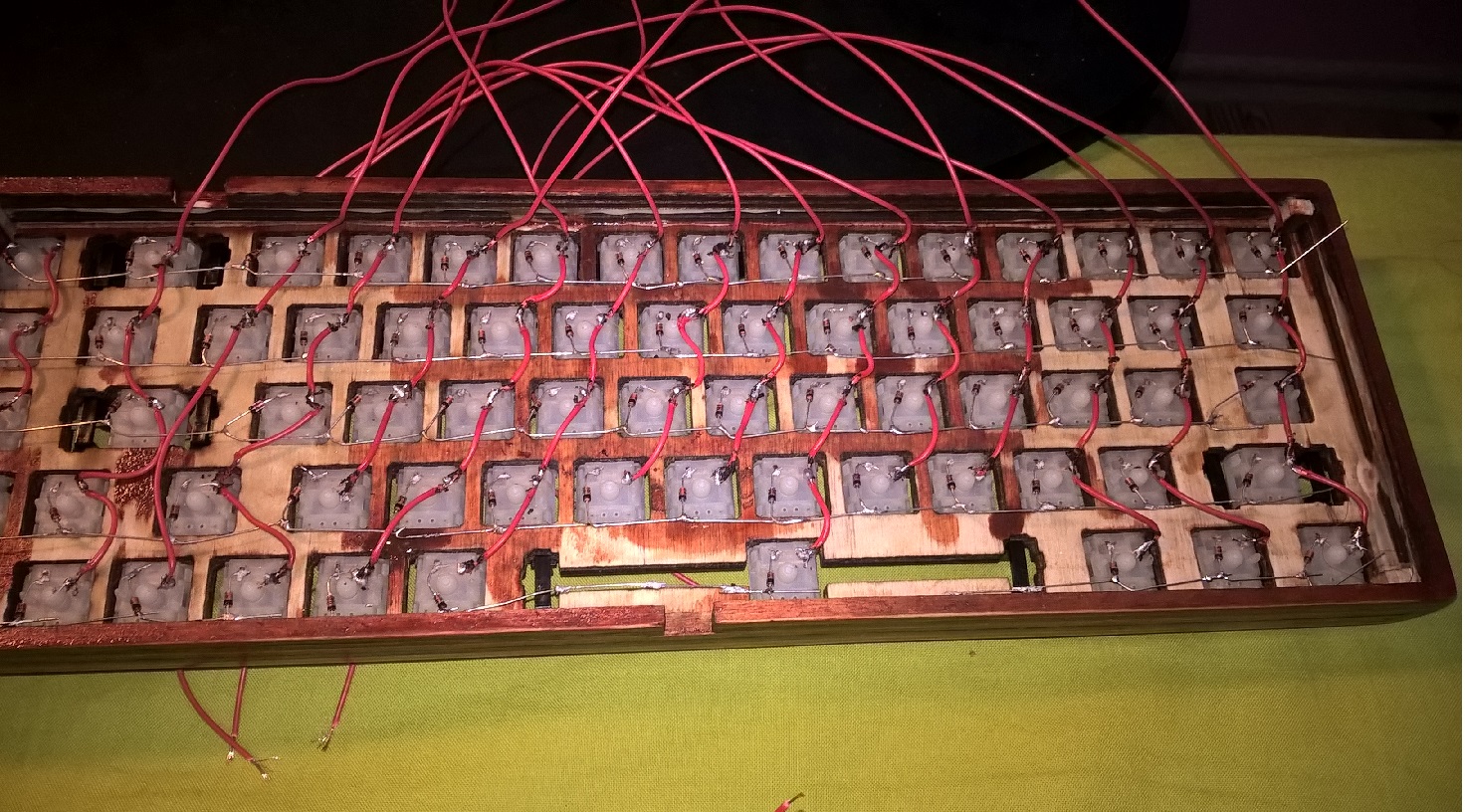

I've attached a picture (it's missing the wiring for the rows)
It doesn't have any metal in the encasement (it's made out of wood)

Well, your solderjob looks good enough. If it did work once, that shouldn't be the problem. Except I cannot see wires connected to your rows.

The columns aren't wired because the picture was taken before soldering those...I didn't got the chance of making one with all the wires present; also at the moment I'me re-doing some of the wiring inside it to eliminate any hardware problems (errors in my work) thus I cannot put a newer picture.
