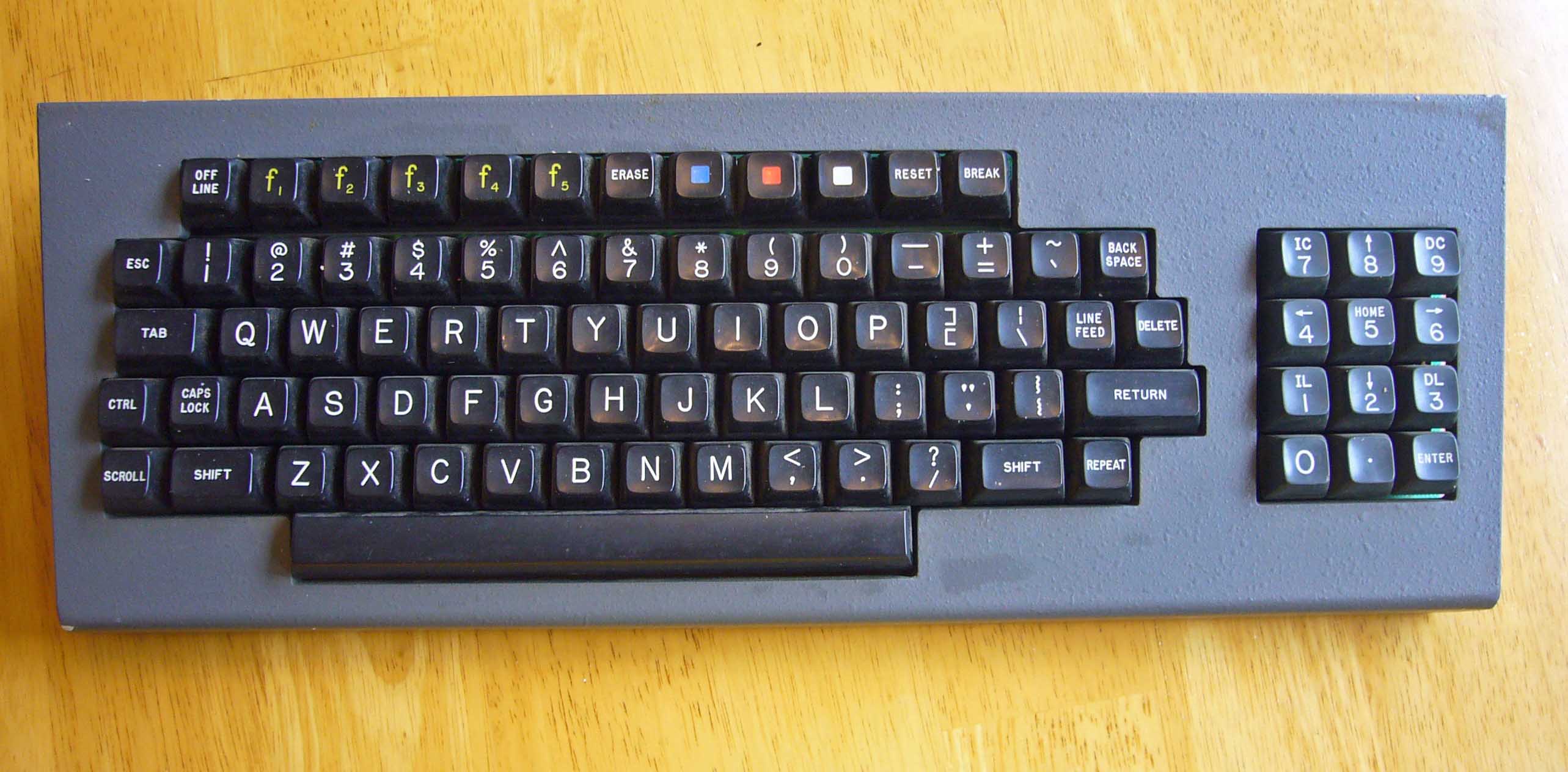

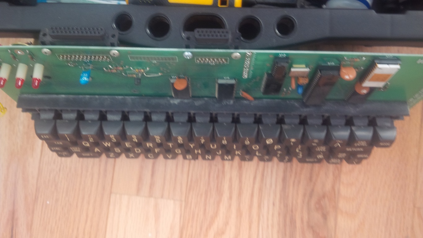

Since I mentioned this in my last post, the other cool keyboard I have is the IMSAI IKB-1 that you may have seen in War Games. Mine does not have the graphics on the outer case (because it's an early version) but it is definitely it. It goes beautifully with the computer that it really went with as opposed to the IMSAI 8080 that was in the movie. There was some discussion at GH a while back about this but while it was not marked as Stackpole or Hi-Tek, it appears to be one of them. I figured those who may have not seen it would be curious about it since there's interest in the Polymorphic keyboard..
Here's some pics.
Here's some pics.

I must say you have some very sweet vintage keyboards snuci! Another Hi-Tek. Impressive.

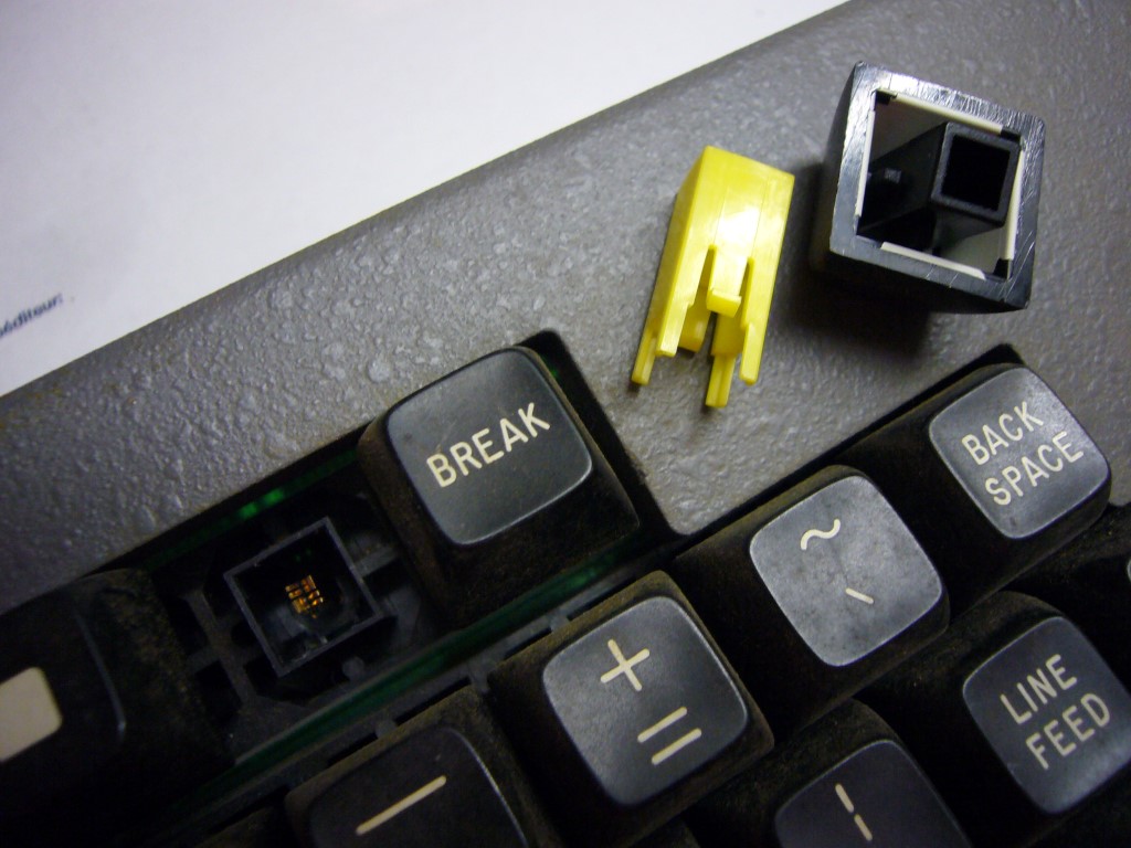

That is similar to a Hi-Tek Stackpole I used to have (yellow switches) but it did not have the case.
I kept thinking about building a really nice wooden case, but I eventually sold it to hwood34
Stiff linear switches are not my cup of tea.

The switch shares the same style of return spring (a tight cluster of turns in the centre as well as at each end), and the same contact mechanism, as the later NMB Hi-Tek switch.

I don't own this keyboard any more, but I was assuming that stackpole was made by Hi-Tek.
This is not my area of expertise.

That keyboard is from a Heathkit H88 or H89. I have one of each. They are stackpole because of the fingers on the key switches. The stackpole and Hi-tek keyboard assemblies both have the waffle grid and look almost identical so it would not be hard to mistake them as the same.

The easiest way is the tooth pattern which allows you to see very clearly whether it's a true Hi-Tek or a Stackpole. Btw Stackpole was a different company entirely and not affiliated with Hi-Tek; the latter sued for patent infringement on the back of Stackpole's obviously stolen design.

The tooth pattern has to do with which of the "hands" are "toothed" so to speak. Hi-Tek only has teeth on ONE of the hands. Stackpole and other clones have teeth on both hands, often diagonally mirrored. Sorry if it's not clear without a picture but I'm on my phone atm

The best resource that describes the differences is the Wiki page for Hi-tek linear here: http://deskthority.net/wiki/Hi-Tek_linear

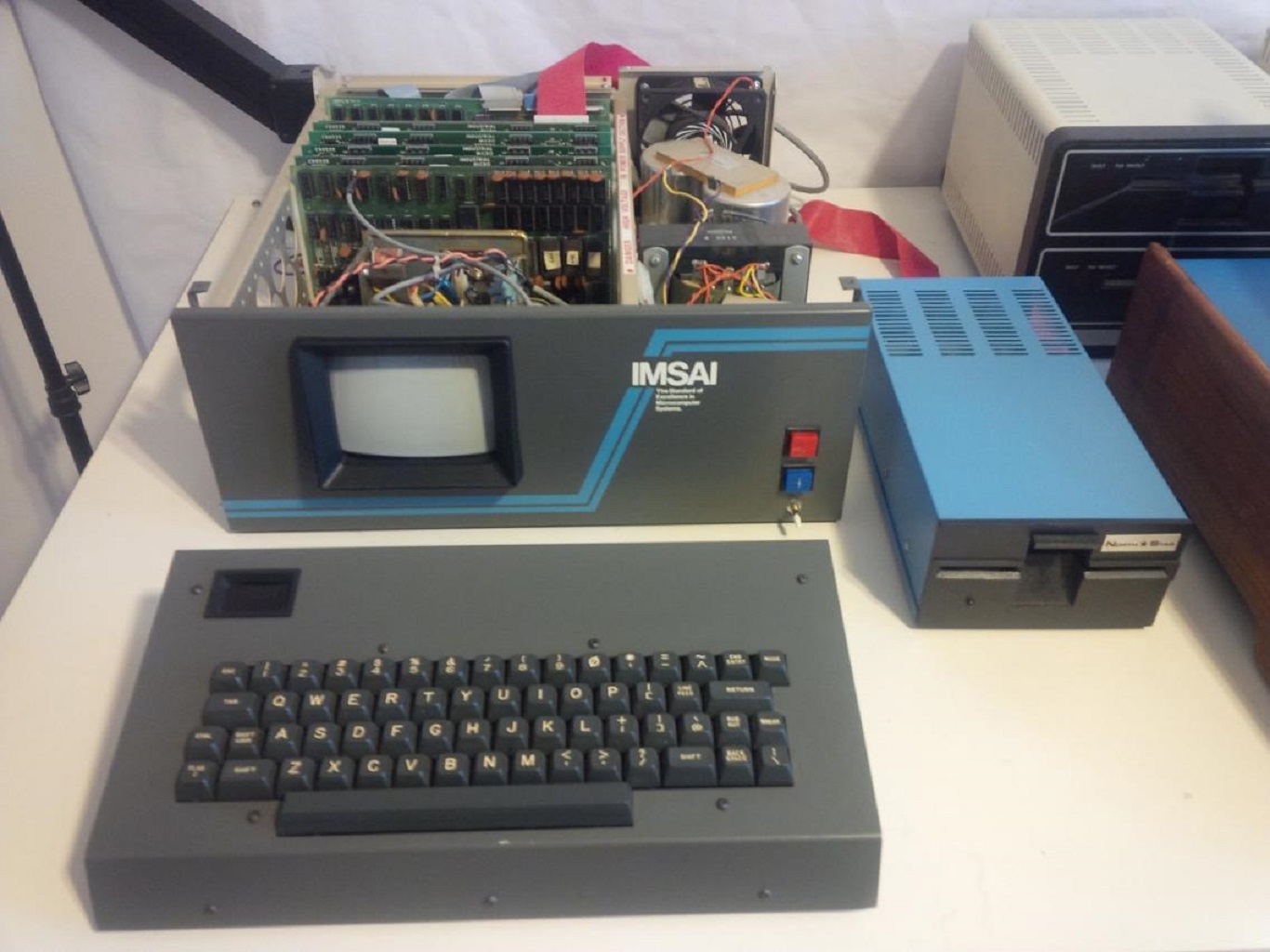

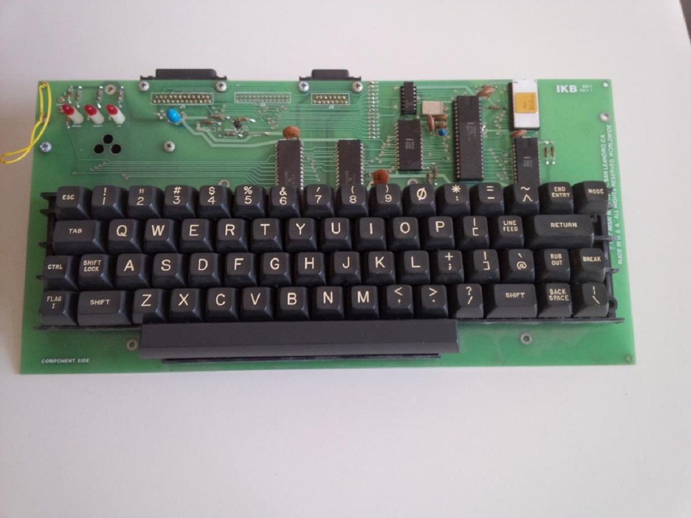

Thanks for posting those pics mr_a500. Very happy to meet a fellow collector.
The IMSAI IKB-1 is a truly special keyboard even though the key caps are only Hi-Teks. It is both a parallel and serial keyboard (set with jumpers) and is programmable. I thought that was pretty cool for 1977! The little dark square is where the LEDs are that indicate when it's in p"programming mode" and "normal mode" but it has such a dark tint that they are hard to see unless you are in front of it. For those interested, you can read details about how this keyboard was programmed for the movie at http://www.imsai.net/movies/wargames.htm
The last ad is of an IMSAI VDP-40. I have a VDP-80. If I get some time this weekend, I'll post some pics of the keyboard on mine. I don't think it's anything special. Probably Hi-Tek switches also. I'll have to check what kind of keyboard it is too.
