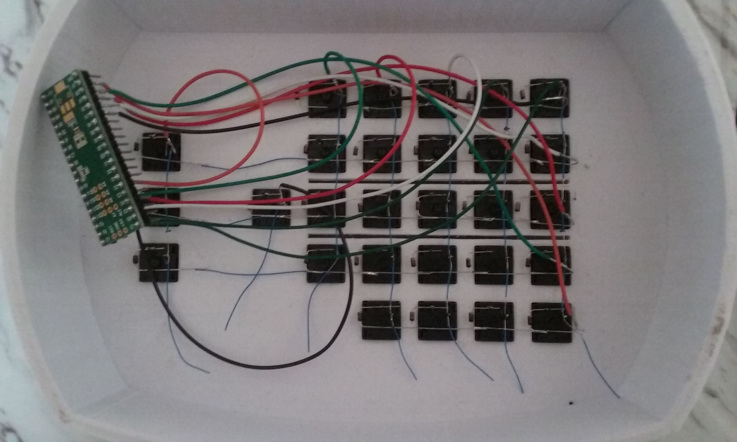

Hey!
I'm new to all of this and am currently stuck on creating or making the actual Hex file. I have tried several ways and I still keep getting errors on both PC and Mac. I'm running out of options and was hoping that someone could be nice enough to compile my files <3

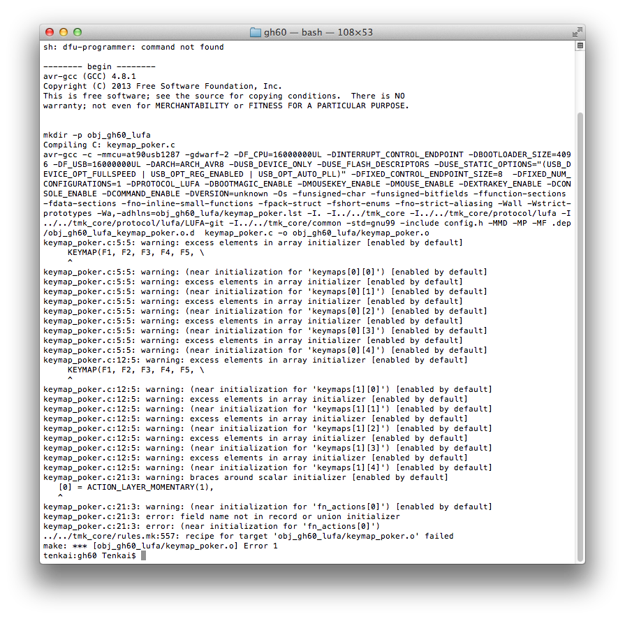

TenkaiX
18 Sep 2016, 13:56
So I'm getting the (make:*** [gh60_lufa.efl] Error 1. My codes are:

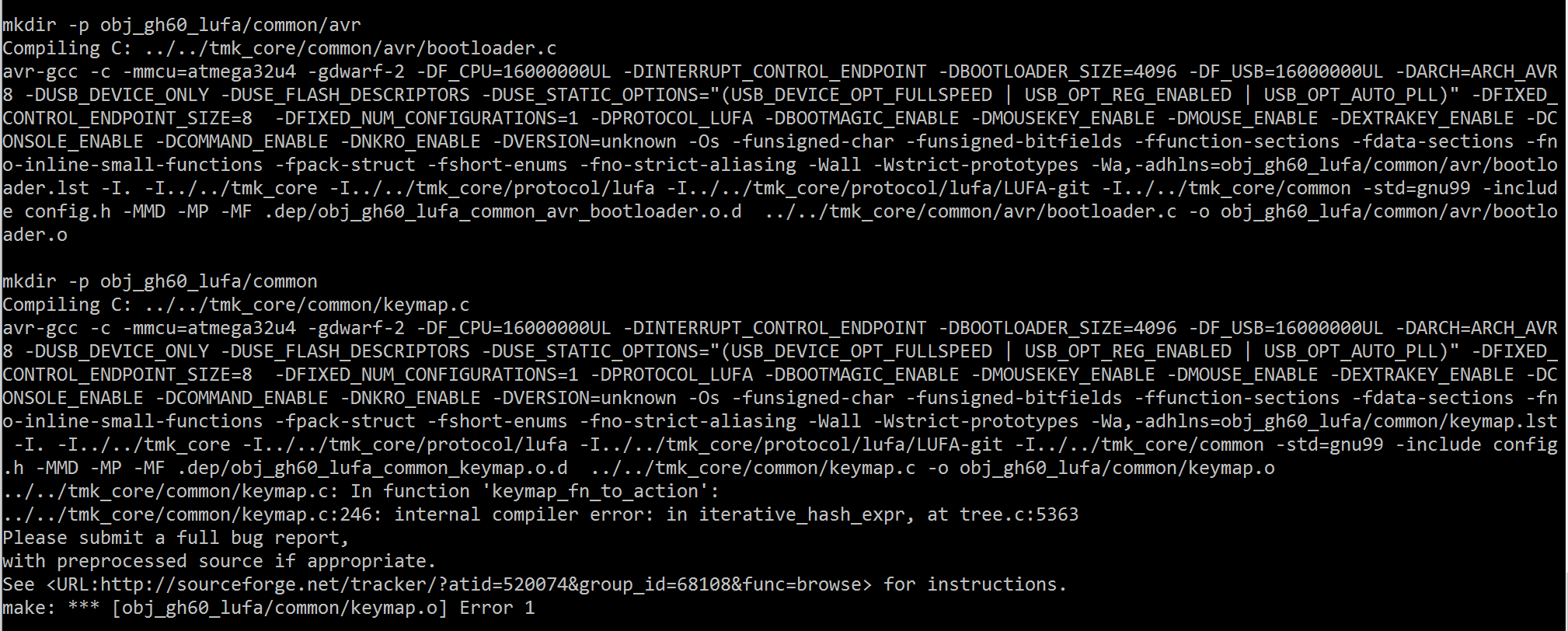

So here is the error that it's giving me:
http://imgur.com/TJykA7I

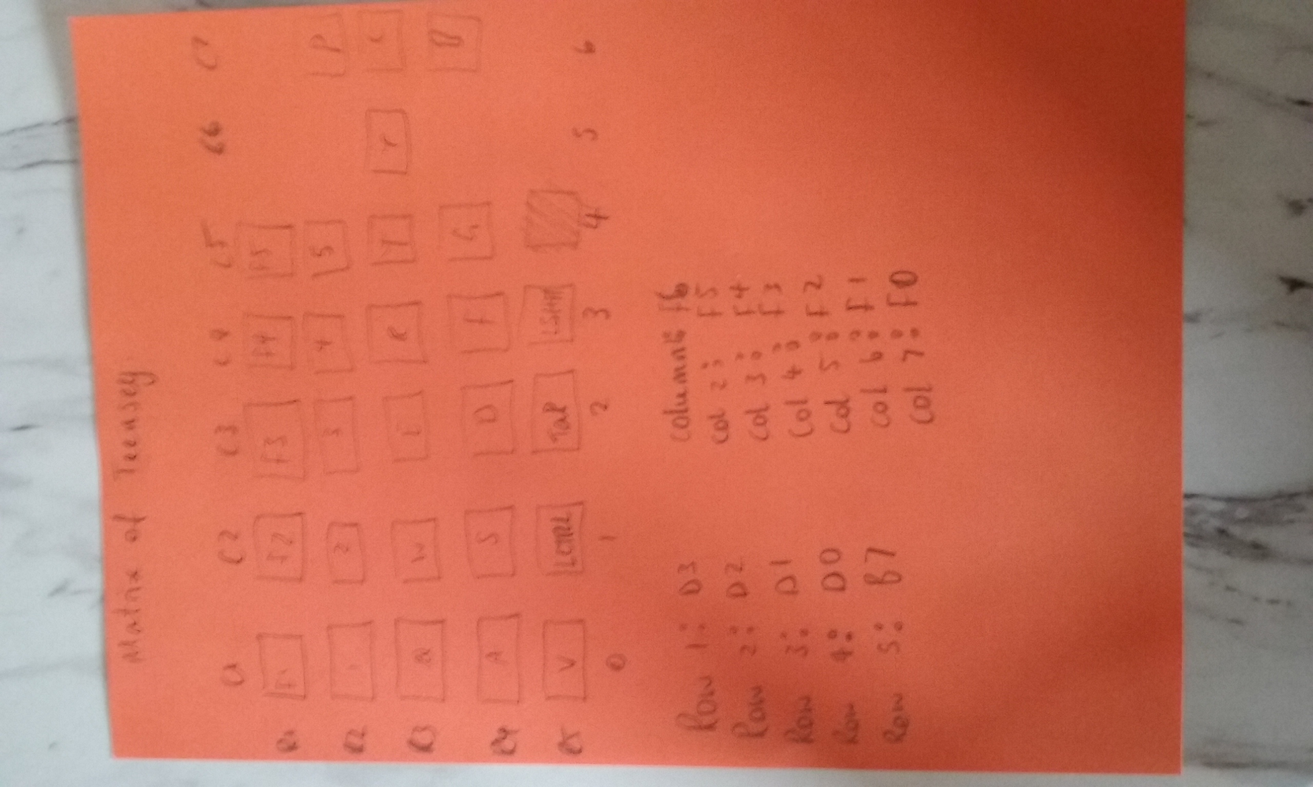

And these are my files:
http://imgur.com/a/ga6Mz
Hope you can help :) <3

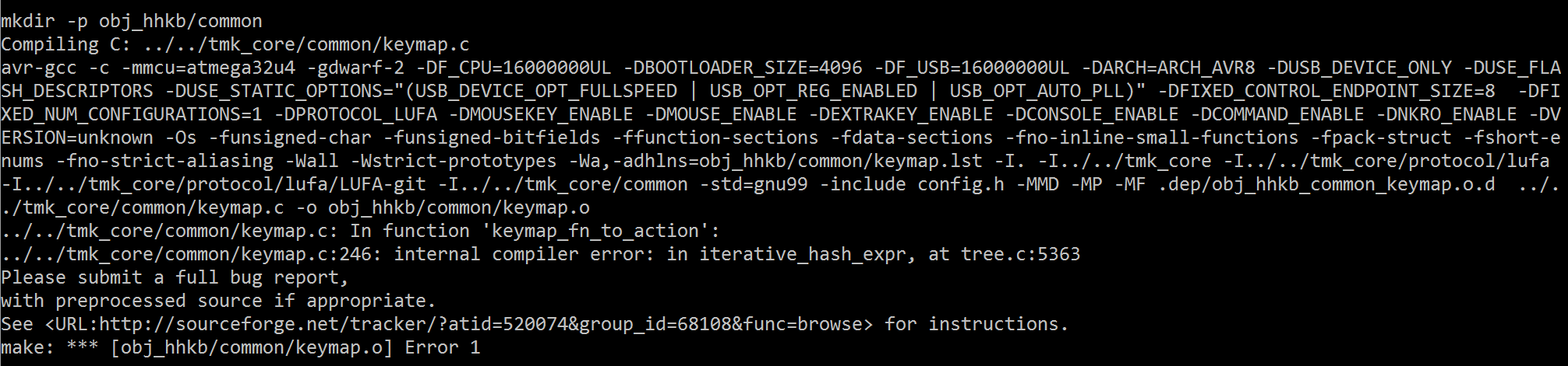

Secondly, I am having a hard time to compile even the unchanged source code (I tried the GH60 and the HHKB). I am running WinAvr on windows 10 (I already updated the 'faulty' .dll mentionned in a previous page). When I execute make -f Makefile I get some weird (at least for me) error in the keymap.c file (or tree.c ?)
Error when Compiling HHKB Same for GH60
Also I created my own layout (a 68%) and when I run the make it gives me the exact same error. I am started to think that there might be something wrong with my version of WinAvr or something like that.
Same error on my version of the source code
Could someone please try to compile my folder on a different OS? (I have attached a zip of the folder with my keymap_poker.c, etc.)
Own 68%.zip
My folder with keymap, etc.
(412.5 KiB) Downloaded 428 times
Thanks a lot

flabbergast wrote: I like to go vanilla with installations, so:
1) Installed cygwin (one package to select on top of the 'recommended' installation is make; I also installed git). This is really an installer. After installation, the "Cygwin64 Terminal" icon drops one into a familiar shell (oh the relief...)
2) Downloaded avr-gcc. That's a zip, so just unpack it somewhere (I used d:\avr-gcc). Add d:\avr-gcc\bin to PATH (google. it's in 'advanced system settings' -> 'environment variables')
After this {EDIT: probably a reboot}, I just downloaded and unpacked tmk_keyboard, go into cygwin shell, cd to tmk_keyboard_master/keyboard/gh60 and run make. Compiles fine.
However Jack Humbert seems to recommend the inferno tools.
Ok, I finally manage to reach this post in my reading of all the posts and this is exactly the problem I was encountering.
Two thumbs up mate, this is the fix for the unstable WinAvr problem under new windowes. Like you mentionned, it would probably be wise if Matteo could tell people under windows to follow your fix!
Thanks a lot!

After trying to do everything in MAC Terminal, I came with these errors. Hopefully someone can help me fix this ;(
I've been working too long on this.
Screen Shot 2016-09-23 at 11.04.25 PM.png (250.87 KiB) Viewed 14719 times

25 Sep 2016, 06:48
Okay,
Progress: Everything was good until I got back to the keymap_common.h and keymap_poker.c
Something in my coding is screwing up the compile as I went through slowly and copied pasted the directory gh60 and kept trying to see if what I add was stopping the compile. Everything was good up to that.
Someone please for the love of god, Look through my code and tell me why I'm getting this.

PS: I don't have an function layers. Here are some pictures of my actual designs and what not.
Matrix 3.jpg (933.51 KiB) Viewed 14635 times
Matrix 2.jpg (805.94 KiB) Viewed 14635 times

In your keymap_poker.c, did you remove the following code?
const action_t PROGMEM fn_actions[] = {
I think you have to have it no matter what, even if you don't have FN keys
