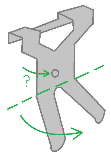

The actuator leaf spring may benefit from being gently adjusted — it may have become too straight, and need to be corrected back to its original angles.
Bendibus maximus — caveat: drawn left-handed in MS Paint 2D
It's fairly easy to slip this part on and off, and you can test the switch by inserting just the spring and slider to see if it registers, before reassembly.

Daniel Beardsmore wrote: The switch shouldn't move, so I assume that any movement is very subtle!
I wasn't kidding when I said I use the BS key a lot, especially when you consider that after 25 years (??, roughly) of use, the BS key is the only one that's ever needed the slightest bit of attention. Anyway, I fixed it, after about a half-dozen more attempts. Whatever I thought I was doing by very slightly putting forwards pressure on the switch, I actually had to do the opposite to the switch part of the keyswitch to fix it, that's why I couldn't fix it a first.
I think you're correct with what you said above, but it wasn't the problem in this case. I didn't have to bend any of the leaf springs (tried that to no avail). What worked was moving the internal switch assembly very very slightly backwards (towards the nearest shell side). Perhaps the way I naturally type/hit the BS key, and the way it's angled, pushed it forward over the years, IDK. Once I got the key working properly, I disassembled again, put in new/spare shell and leaf/coil springs, and hopefully good for another 25 (as if I am...).

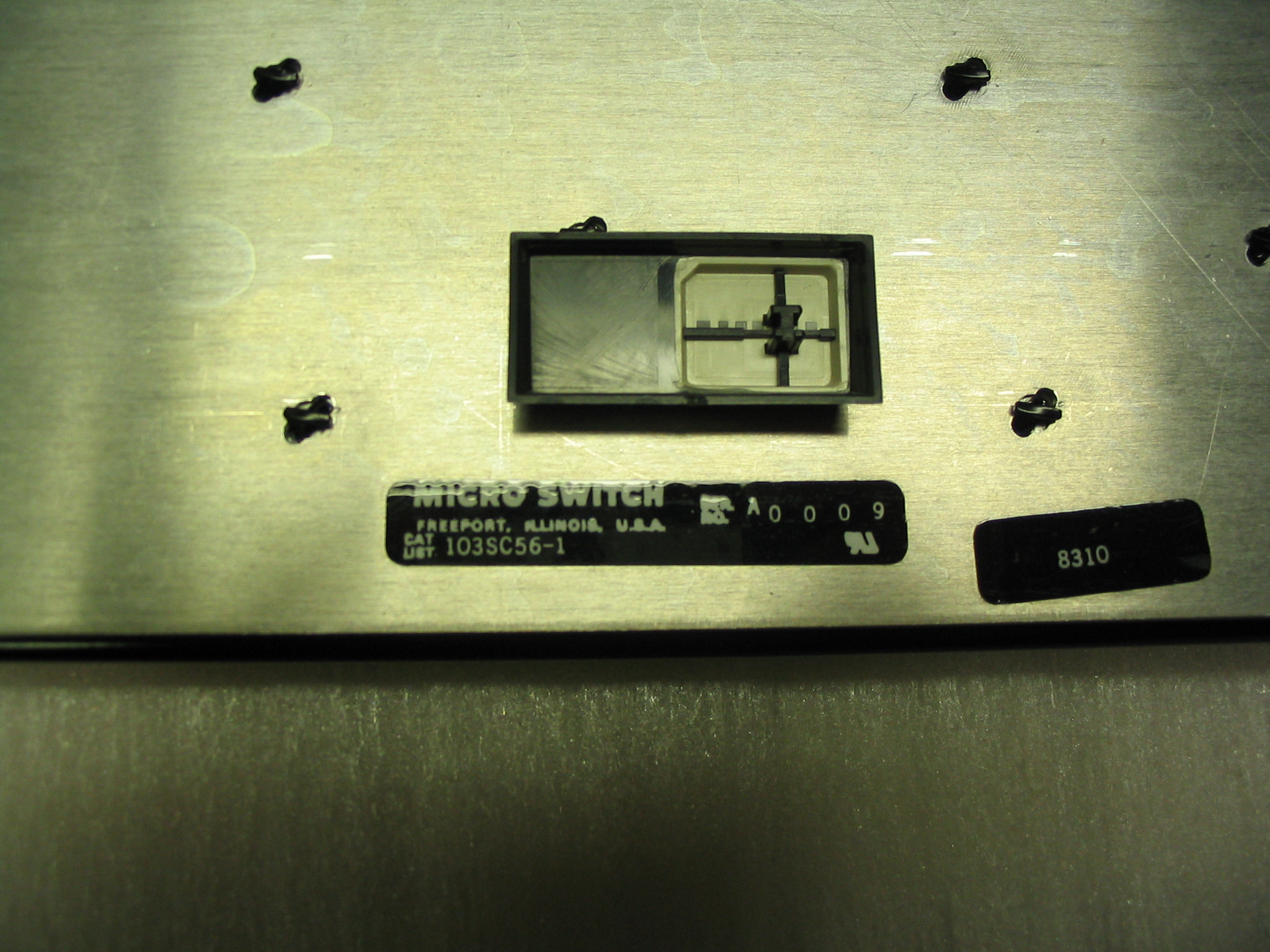

That Micro Switch KB is a 103SC56-1, build date 8310, S/N A00009. Definitely SC as all the custom parts are labeled SCxxx. There is *zero* feedback of any type from the switches, you just have to have faith... The shape/size of the keycaps and feel of the springs is very pleasant...seems weird to say, but you guys get it. I recall going to a lot of trouble, and expense (for me at least, at the time) to get it. Actually, I just recalled my GF at the time worked for Honeywell, and she couldn't even help me. Totally forgot about that. Memories... :) I must have quite a lot of documentation for this KB, somewhere, as I didn't order/"specify" it in a vacuum, and I did use it with a custom-design/built computer (Z80) so I had to do the interface myself. I remember I was obsessed with their Hall effect keyboards then too, but totally failed with ever getting a satisfactory (to me) interface, they were not simple to work with and for some reason I couldn't get one with the interface circuitry built in (still have a box of their "raw" Hall effect KB assemblies somewhere here).

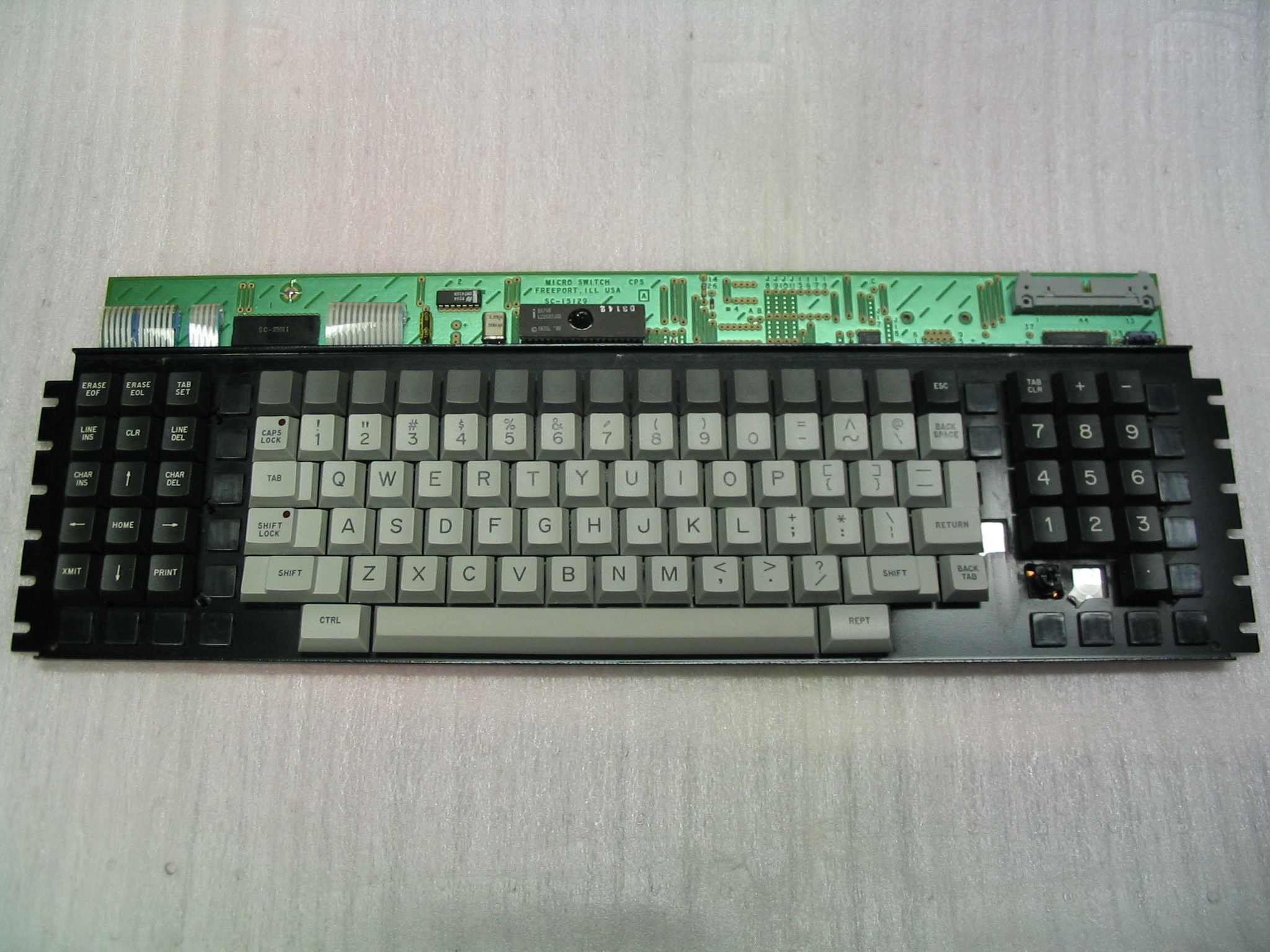

Man, am I ever way OT now... I found the "engineering drawings" for the 103SC56-1, 6 pages includes schematics. I guess I can't take a switch module out after all, but I can see the "plate" in each switch that the actuator moves is copper-colored (i.e. looks like phosphor bronze, not saying it is for sure), and there's no click or tactile feel at all. Regular switch modules are SC-10090, modules with an LED are SC-11002 (there is another version of this module, SC-10109, not used here). Membrane assembly is SC-25203, detector chip is SC-23011 (switch scanning matrix connects to this). There is no rubber anywhere! They claim NKRO, but then mention any more than 6 keys in the same row or column (of the scanning matrix) pressed at once may cause errors. Keycaps have very nicely molded-in legends (very neat from the underside, compared to e.g. the Northgate). Also has serial output, which I never used (additionally, a D-sub connector is optional). Assembly has positions/electronics for up to 126 keys.
The docs I have are obviously photocopies, and parts are already difficult to read, so I don't know how well a scan would turn out...also, they say they're the property of Micro Switch/Honeywell and can't be reproduced without permission...don't know if they'd really be of any use to the community if somebody wanted to host them for whatever reason... Pics should be fine. Later I'll see if I can find the actual catalog where the switch modules are defined, I must have it somewhere as I was very particular about getting all the deets back then when pretty much everything home computer-wise was still largely DIY.

I got to thinking along similar lines, that SC or ST might be more general purpose designations for "something". e.g. I thought the "C" might stand for capacitive. Clearly the various switch components could be used in any frame, and it would be the membrane that would partly form the switch characteristic, as well as the spring and metal actuator. I was hoping to find the actual catalog I ordered from, but I may not easily do so because I have no idea if it was from an MS/Honeywell one, or from datasheets because I bought it at a large local (non-chain/franchised) distributor who didn't have catalogs IIRC. [Sorry first time posting pics here, I didn't do it the way I wanted, they're in reverse order from what I intended...]

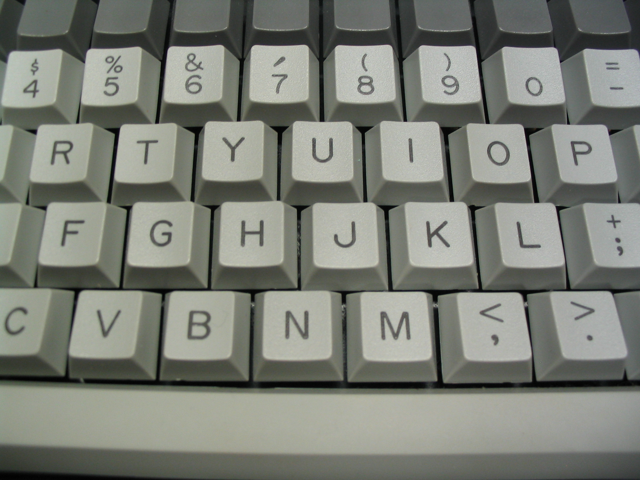

I like the clear large keycap characters. The keys themselves are made of some kind of somewhat pliable and textured plastic, much less "brittle" than the e.g. Northgate's keycaps, but not rubber, IDK what it is, feels almost PVC-ish, but PVC would be too soft, wouldn't it?
Here's that removed charcoal "0" key showing the neat molding of the cream/ivory/off-white text.
The keys are all shades of gray, no exact black, in real life. Here is a general pic, if you click on it/magnify you can better see the coppery-colored actuator and the empty switch position that would normally be covered by the double-width "0" key.

Double-shot moulded keycaps are only known to have used two materials historically: ABS and Tenite. Comptec/Signature Plastics always used ABS. Cherry used both ABS and Tenite. I'm assuming that Tai-Hao (who made the Northgate keycaps) always used ABS, although they now offer PBT double-shot keycaps (with the first shot, the legend, being POM I think). Micro Switch keycaps are held in high regard, but nothing is known about them.
It's hard to make the switch out in the photo, but indeed it seems to be something we've never seen before. Just to be clear, is this linear or tactile?
