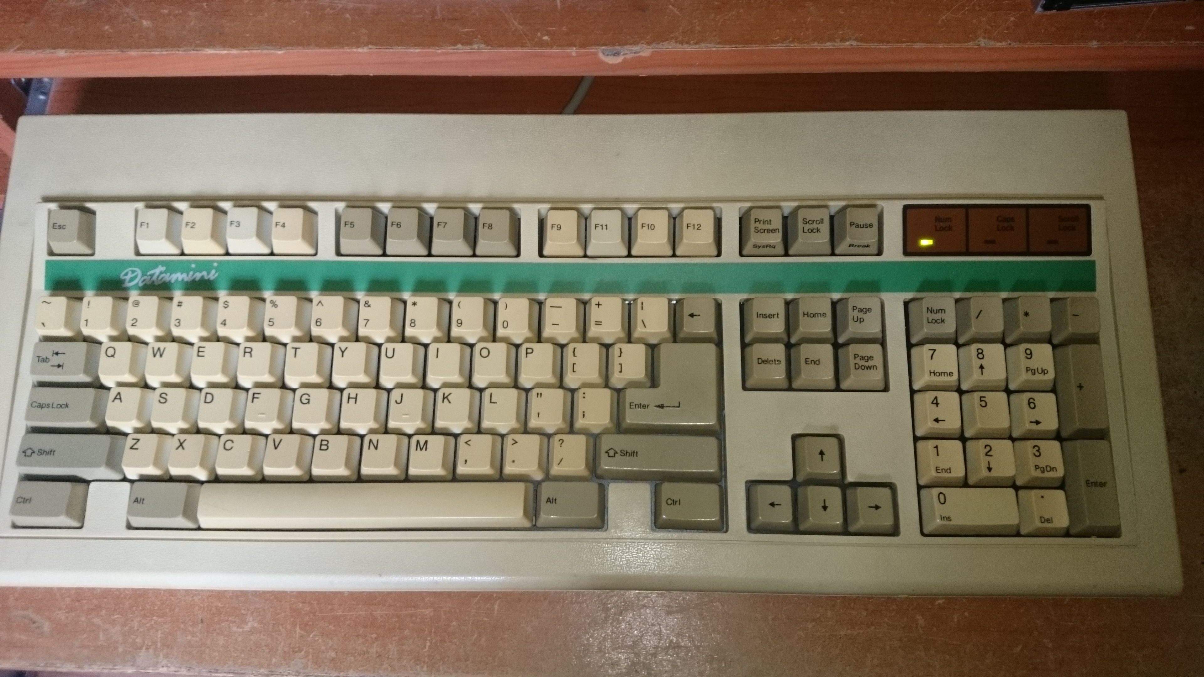

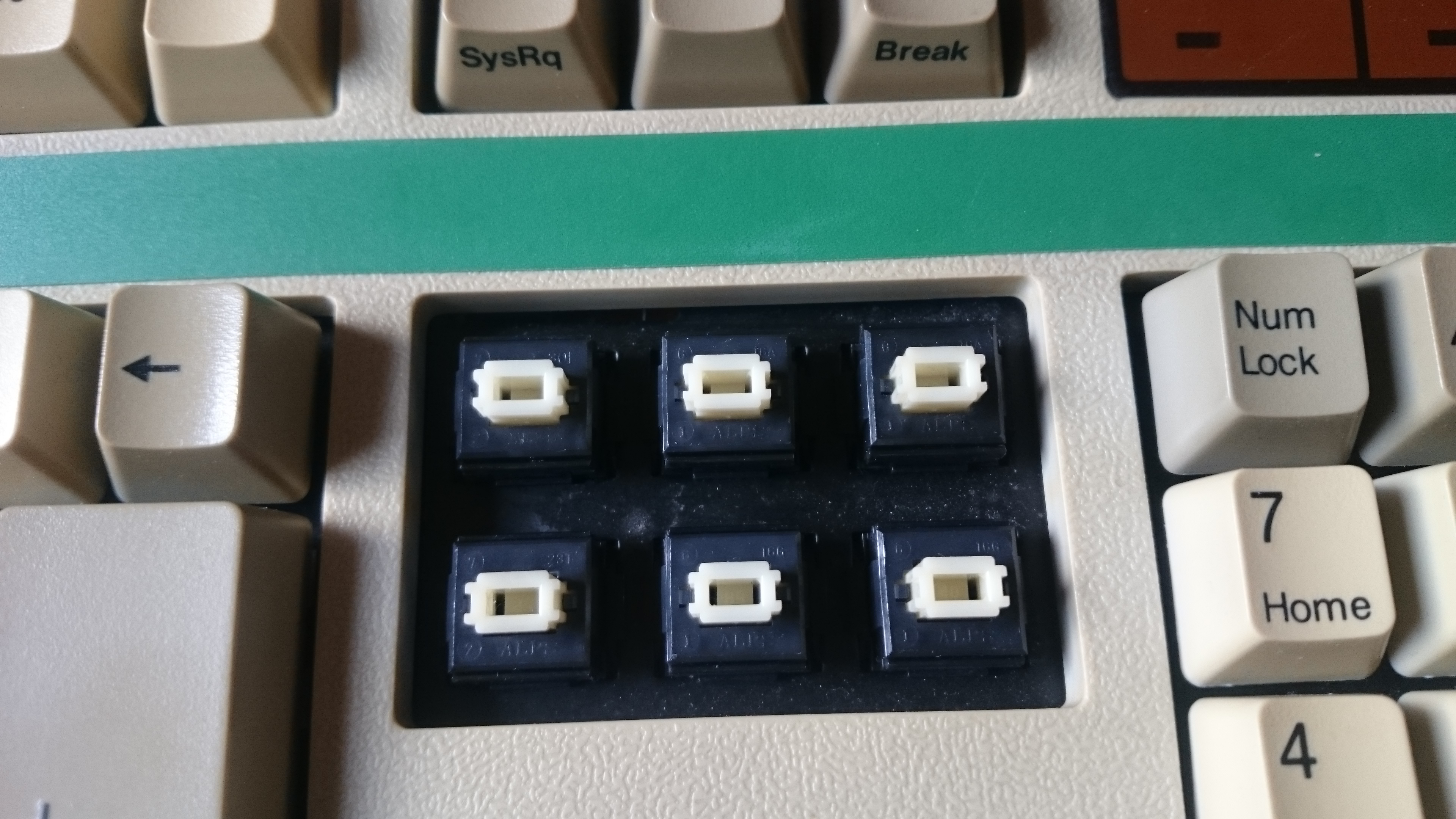

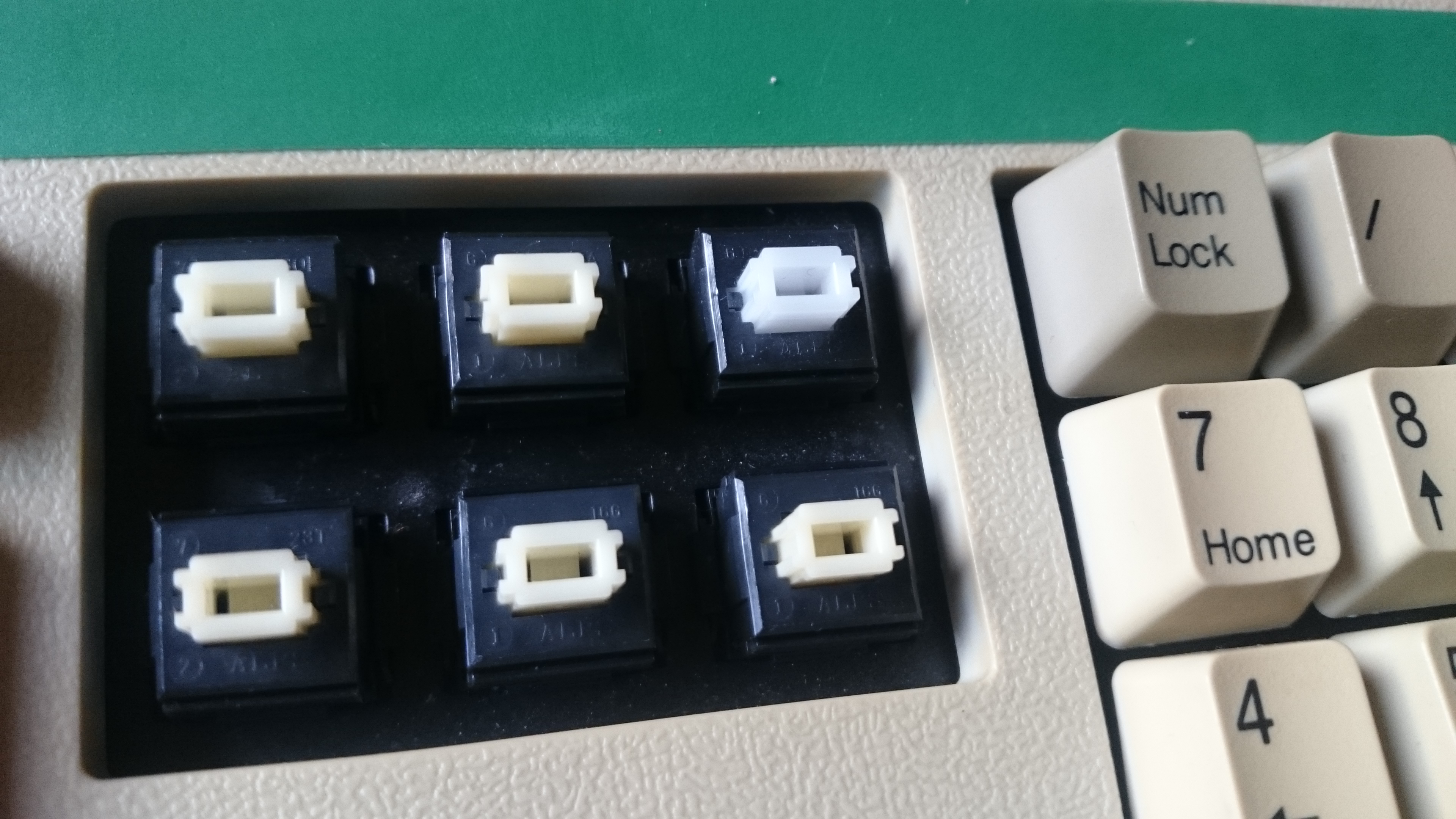

Chicony KB-5181 is my favourite keyboard for now. Came with a wide variety of switches, and the build quality is not that bad. Cable 3 way router is present with a 2-part flipout feet, though the keycaps are junk. Anyway, the keyboard didn't have any stickers, so I made one for it with my Epson FX-980 dot-matrix, therefore it looks even more retro
Originally came with White Alps, short switchplate, logo on the top.
THE LAST OF US
PS: the keyboard is not warped. The picture is shit
Edit: Lol F1 and F11 are swapped xD
THE LAST OF US
- DSC_0260.JPG (2.99 MiB) Viewed 10064 times
- DSC_0259.JPG (2.9 MiB) Viewed 10067 times
- DSC_0258.JPG (2.64 MiB) Viewed 10067 times

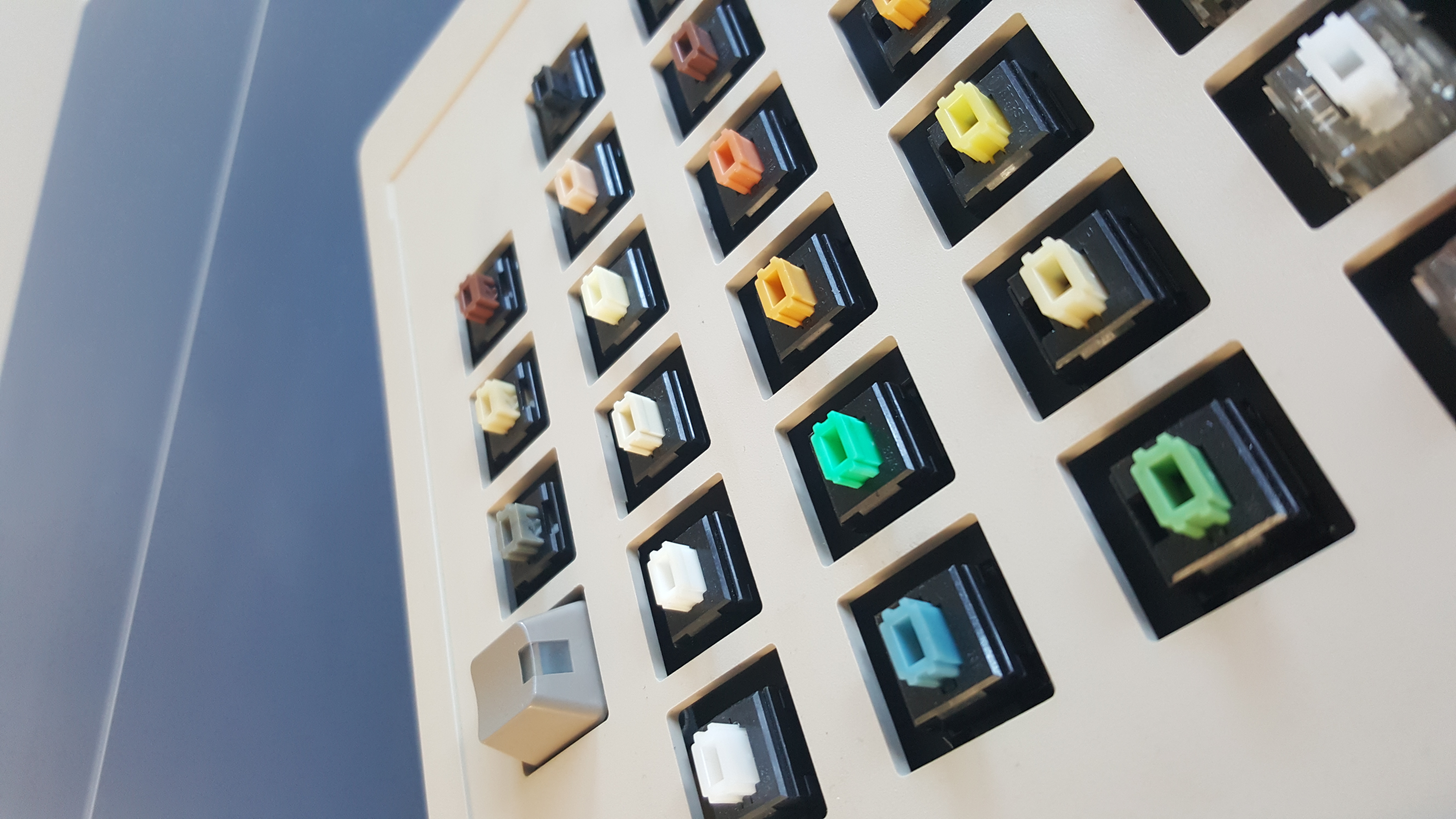

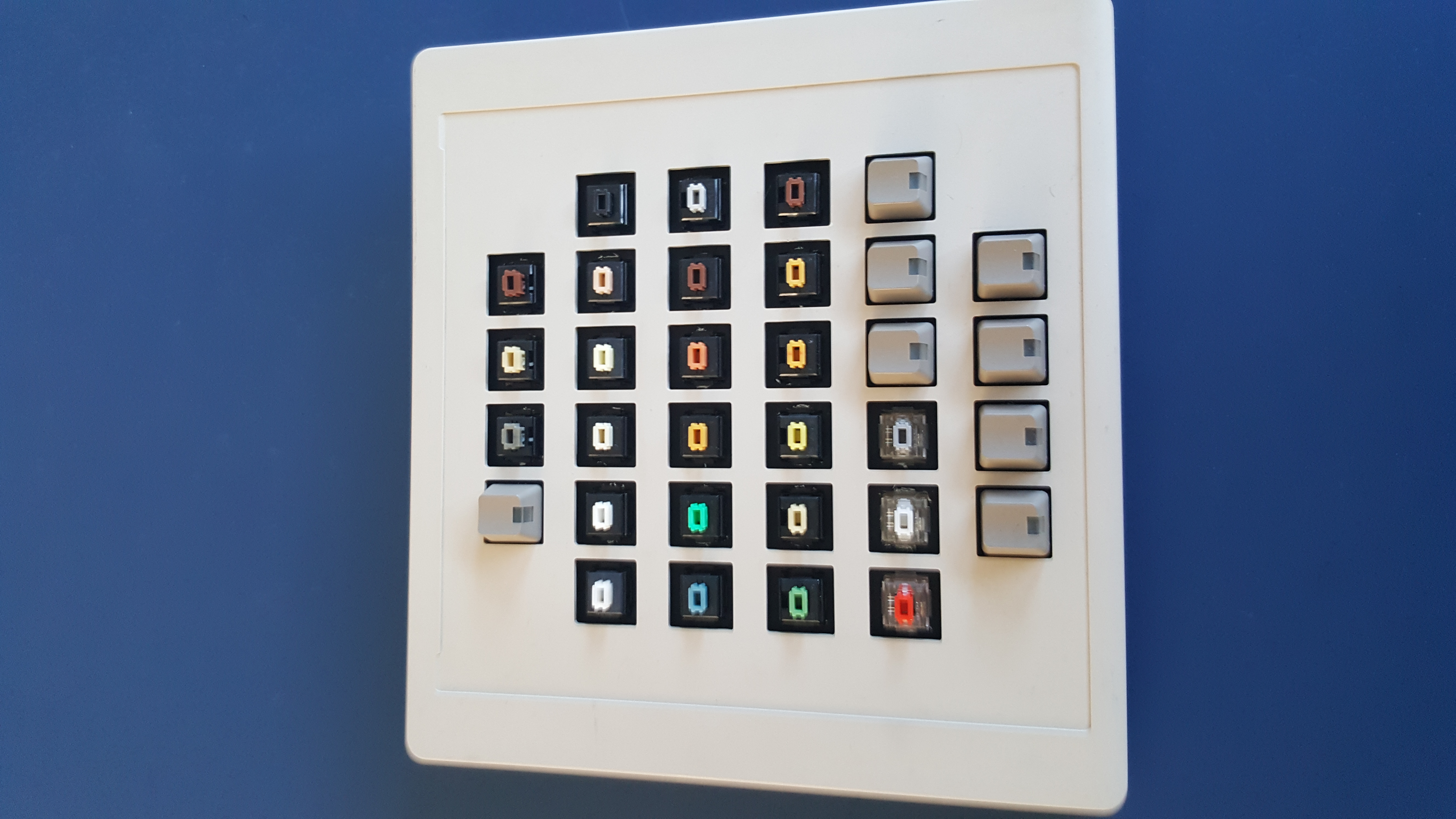

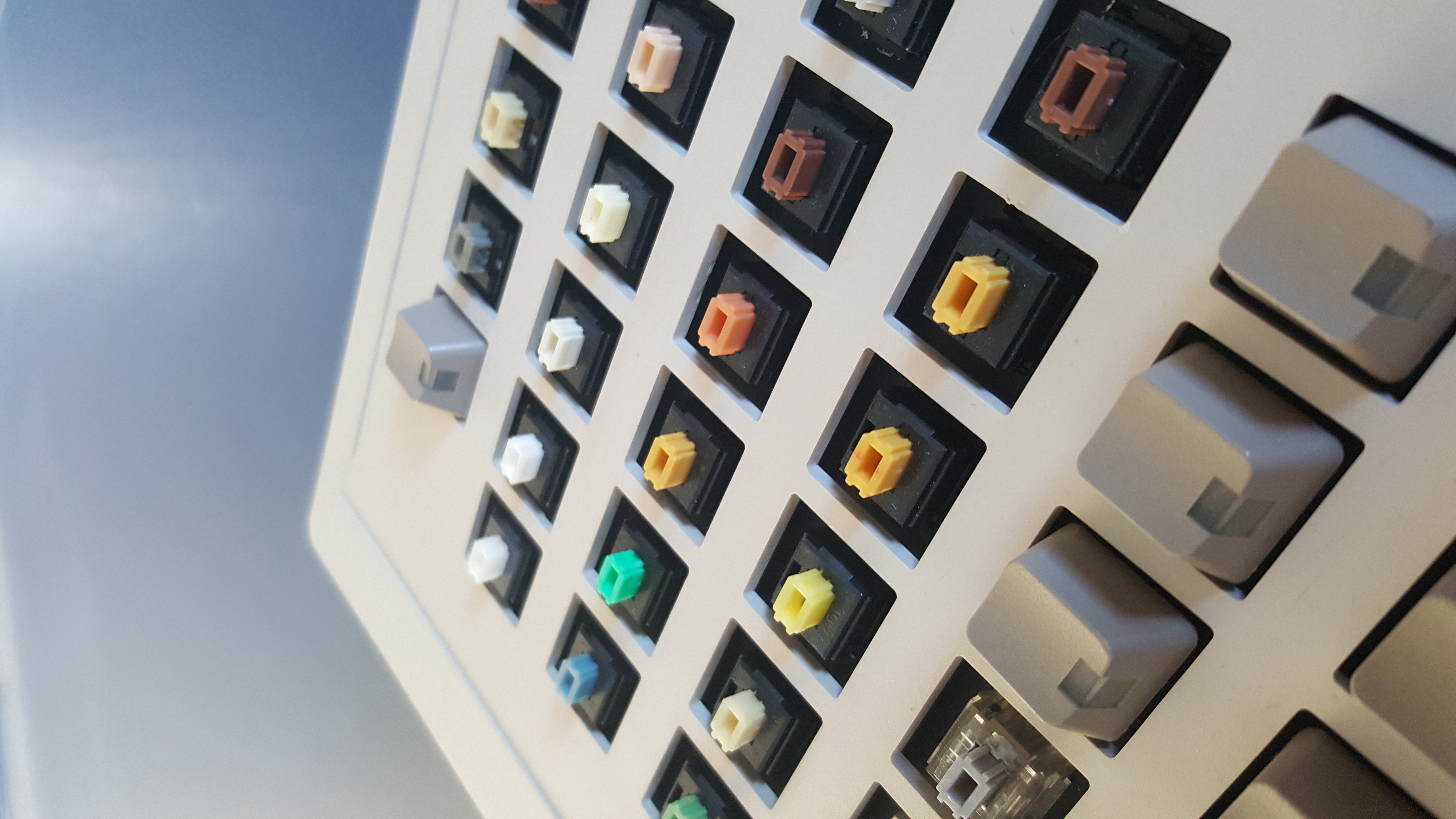

WOW subcat -- that's a beauty! You should really make a separate thread for that one and show us all its glorious guts.
Also, where did you find that sexy donor board?
- subcat
- Location: Australia
- Main keyboard: HHKB Professional
- Main mouse: Zowie EC2-A
- Favorite switch: Topre
There isn't much to show, it's just a plate and case
These are Silicon Graphics button boxes that come with either SKCL Grey or SKCL Cream switches, with LEDs. Never has something made me contemplate suicide so frequently in the desoldering process...
I got this particular one of Taobao, proxied to me by a member here, and many of the switches I would not have without the kindness of members here, such as Daniel Beardsmore who paid to ship me that SKCM Green along with a myriad of other interesting NOS switches, some of which I had never seen before.
So really this is a culmination of the community here. I'm very happy to have completed it!
This was indeed inspired by this very picture. That Striped Amber would not be there if it wasn't for you either
