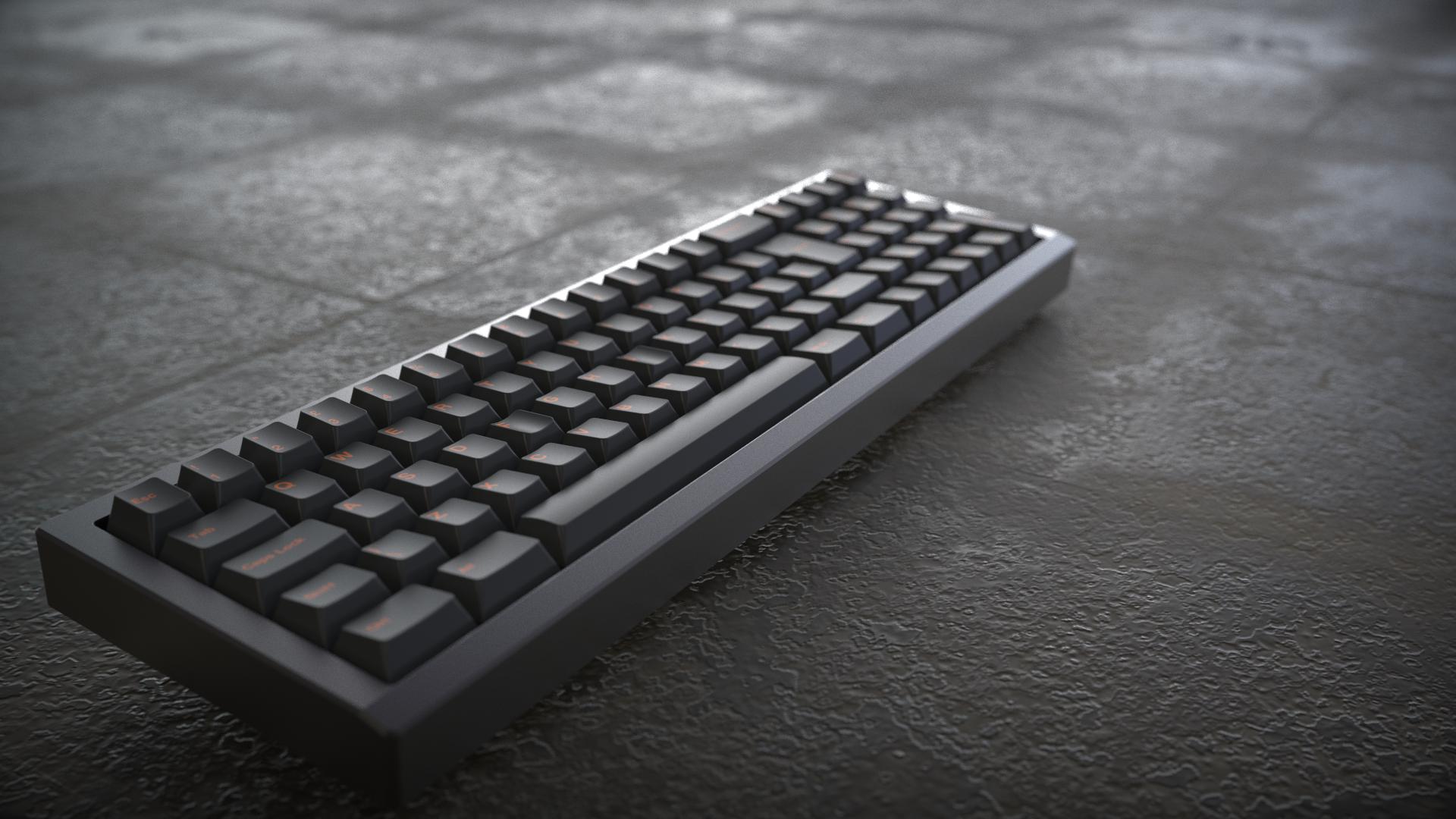

UK78
Inspired by the XT and 1800 layouts the UK78 is a 60%+Numpad fully programmable keyboard.
UK78 soon cover.jpg (1.05 MiB) Viewed 10113 times
Current rough price estimate: $350 (for PCB, case and full aluminium base)
Link to Geekhack Discussion
The UK78 currently features:
  • ISO AND ANSI Supported Supported Layouts
  • MX and Alps Compatible!
  • Custom PCB that can be cut to a 65%, restistors, diodes and MCU presoldered as standard with limited DIY bare PCBs available by request
  • Underglow lighting and switch LED lighting
  • A single piece aluminium case with acrylic 'vanity' base to view the pcb

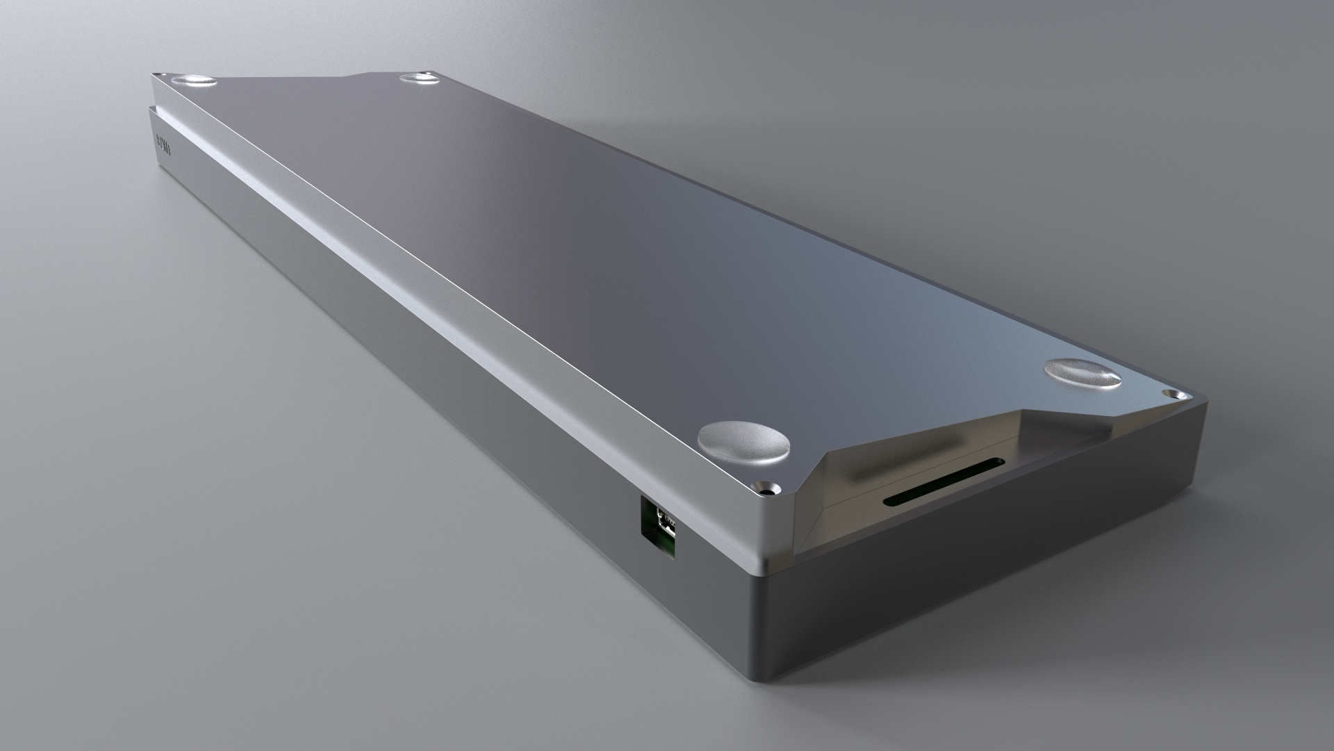

  • 5 degree incline achieved by custom CNC'd aluminium feet or a full width aluminium base
  • Stainless Steel plate in various MX and Alps layouts with the option for specific layouts or materials to be requested (anyone fancy brass?)

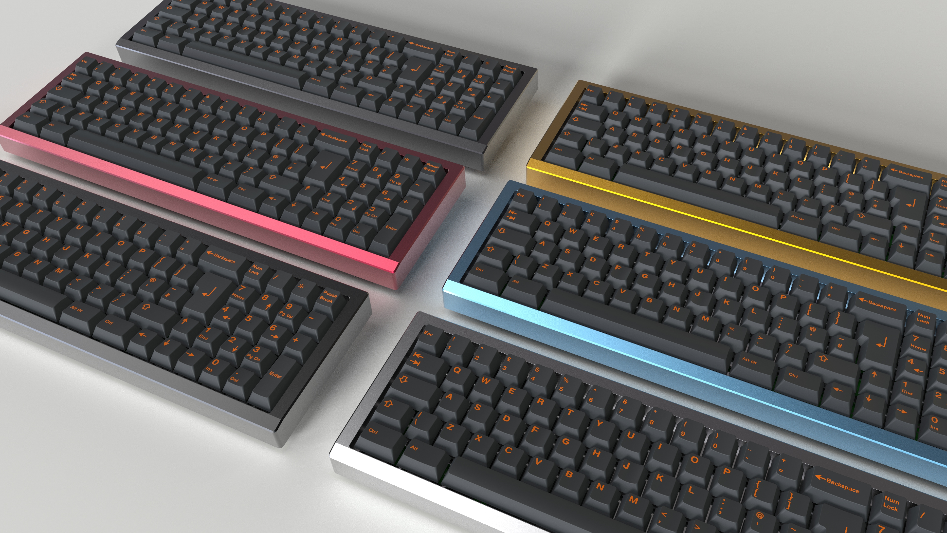

Available anodising colours from the manufacturer (other colours may be available):
uk78 CHERRRY ISO icon.186.jpg (3.82 MiB) Viewed 10113 times

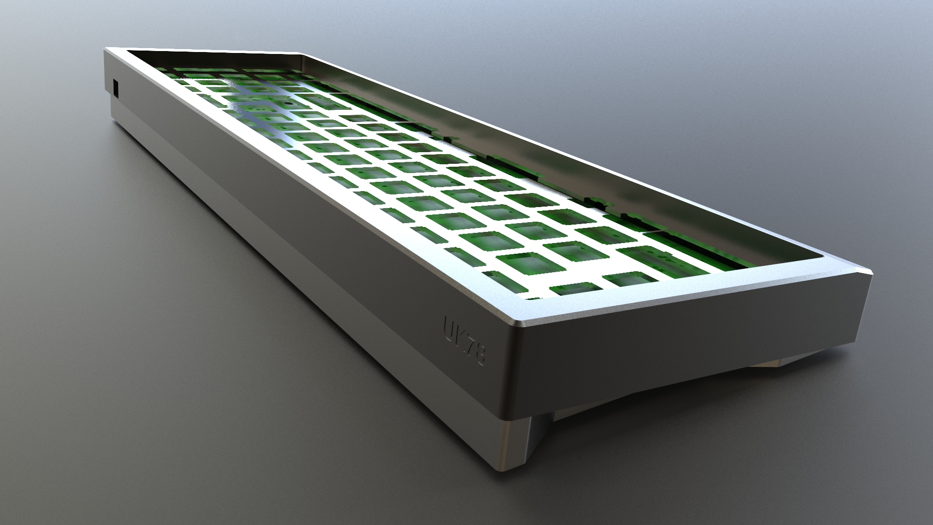

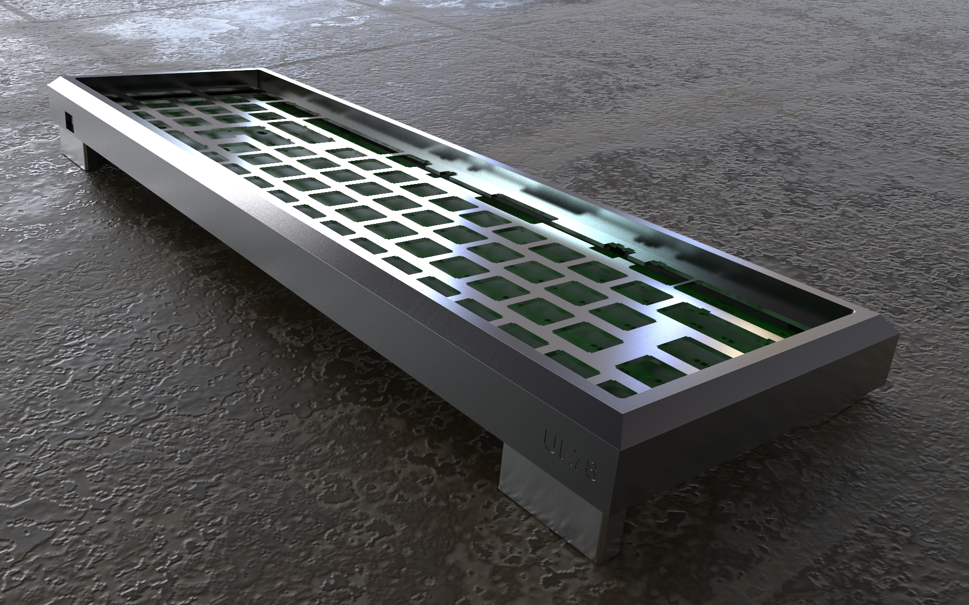

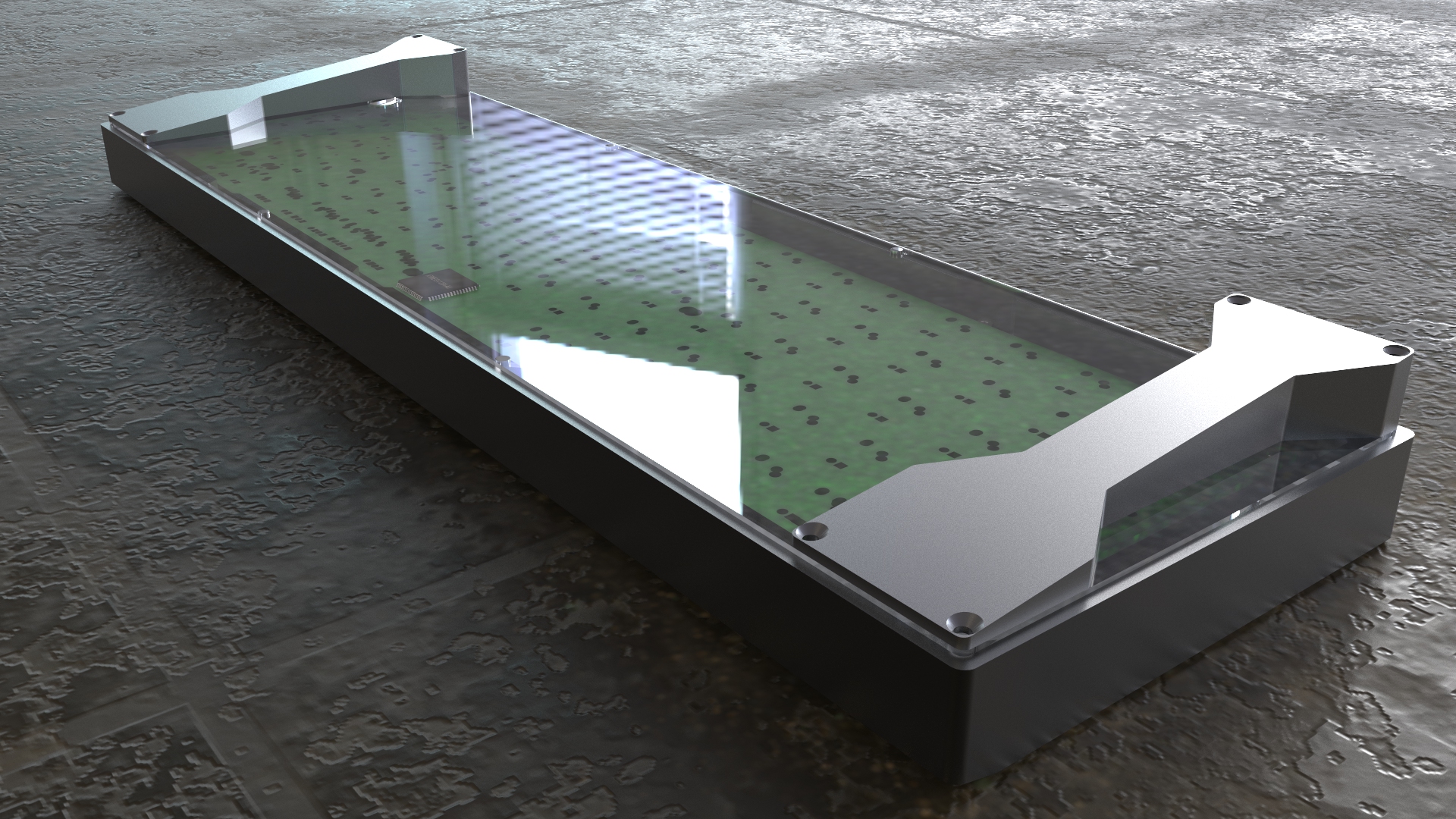

Renders:
Standard Case Design
uk78 CHERRRY ISO.177 VINGETTE.jpg (182.57 KiB) Viewed 10113 times

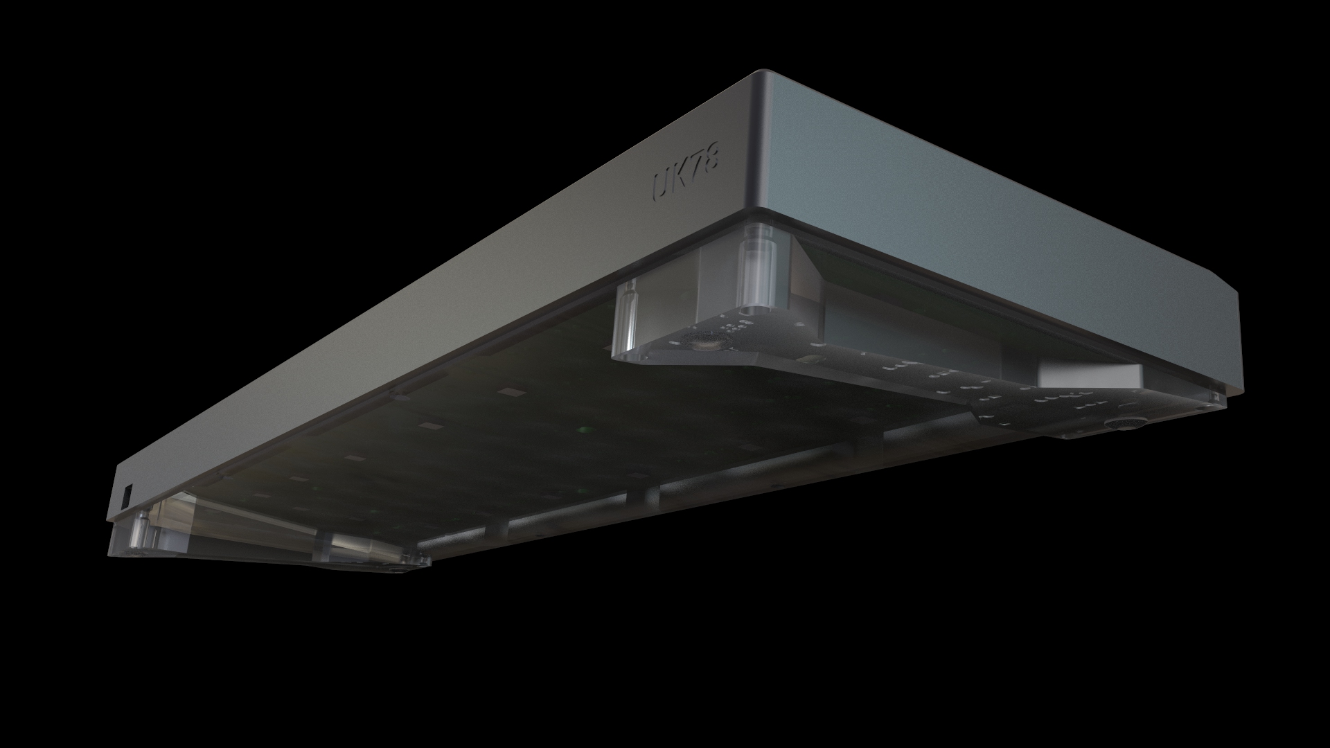

Alternate case design
new feet design.192.jpg (1.17 MiB) Viewed 10113 times

I'd be so down for this, if the numpad was on the left side. I'm interested in the current state though. If I get one depends on if I got the money when the drop happens.
The angle of the acrylic bottom look pretty steep to me though, personally I prefer a flat angle. The ZZ96 of a friend was too steep for me for example.
I like both designs, I'm okay with either.

I will likely change the angle to 5 degrees as that is what I have on the prototype which is very comfortable.

Currently the costs for a set of small feet are ~$90 and the larger base is ~$160 making the overall cost of a UK78 ~$300 and ~$350.
There could also be the option of Acrylic small feet for the same cost as the Aluminium ones.

I really like the render, but I doubt it'll look as good in reality. To be quite honest, I dislike the whole metal+acrylic thing as it always looks cheap to me. I'd even go as far as to recommend to mount the acrylic bottom inside the aluminium frame. The Redscarfs design I once assembled suffered a lot by that cheap, flimsy acrylic bottom contrasting the massive aluminium housing. Maybe a frosted finish would've made it look nicer, I don't know, but the clear acrylic really didn't look good from the front.
Personally I don't mind though, as I'll go for the aluminium version anyway.
(on a sidenote, I really like acrylic housings, just not mixed with aluminium, or any other metal.)
Stabilized
26 Apr 2017, 18:21
I agree regarding the acrylic and metal housing, I would prefer it if it was a layer or fins sandwiched in metal layers: like with the KBD75 or the TriC cases.
rozakiin
26 Apr 2017, 18:33
You will be able to achieve that effect with the full aluminium base by putting the acrylic layer between.
Sankart
26 Apr 2017, 18:47
That's actually a really nice idea, but I didn't mean it that way.
The way it looks on your renders, it looks like the acrylic plate is shorter than the frame? Then this might not even be an issue.
What I'm talking about is this acrylic "lip" that's visible when you set the keyboard on the desk with the acrylic bottom (just like with the Redscarf II+ here https://www.massdrop.com/buy/red-scarf- ... yboard-kit ).
Personally I think that looks really bad. It's acceptable in the pictures provided by MD, but in reality it just looks cheap.
On the other hand, if you were to change it, I don't think your idea of using the acrylic bottom as a led-window with the aluminium bottom would be possible.
As I said, I don't care too much, I'm gonna take the aluminium bottom anyway, just some food for thought.
rozakiin
26 Apr 2017, 18:54
Ah ok, no the acrylic shouldn't be visible while the on the desk as it is indented into the case by 2mm.
