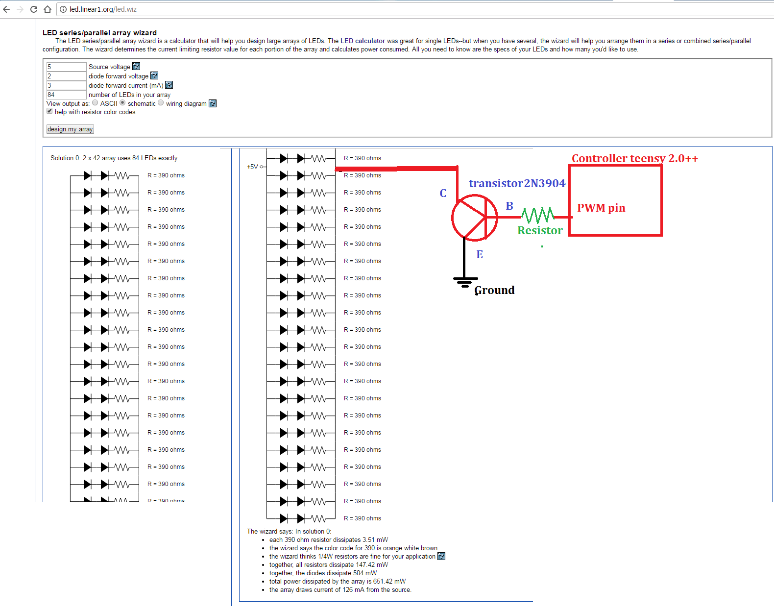

First of all, I do not speak English, and I'm translating all this into Uncle google
The question is that this is my second keyboard based on Teensy 2.0, and the functional part of keyboard works correctly, but the question is that this second keyboard sends it backlight and I'm very lost with it.
My idea is to have 2 independent leds, backlight and leds case, and I would use pins B6 and B7
I have these parts of code backlight.c that gave me the user breh:
I want to do something like breh does on your numeric keypad, have specific keys (the ones above the arrows) for the regular backlight, power on / off / more brightness / less brightness, and in another layer to control the LEDs of the case.Code: Select all
/* Copyright 2013 Mathias Andersson <wraul@dbox.se> This program is free software: you can redistribute it and/or modify it under the terms of the GNU General Public License as published by the Free Software Foundation, either version 2 of the License, or (at your option) any later version. This program is distributed in the hope that it will be useful, but WITHOUT ANY WARRANTY; without even the implied warranty of MERCHANTABILITY or FITNESS FOR A PARTICULAR PURPOSE. See the GNU General Public License for more details. You should have received a copy of the GNU General Public License along with this program. If not, see <http://www.gnu.org/licenses/>. */ #include "backlight.h" #include "eeconfig.h" #include "debug.h" backlight_config_t backlight_config; void backlight_init(void) { //check signature if (!eeconfig_is_enabled()) { eeconfig_init(); } backlight_config.raw = eeconfig_read_backlight(); backlight_set(backlight_config.enable ? backlight_config.level : 0); } void backlight_increase(void) { if(backlight_config.level < BACKLIGHT_LEVELS) { backlight_config.level++; backlight_config.enable = 1; eeconfig_write_backlight(backlight_config.raw); } dprintf("backlight increase: %u\n", backlight_config.level); backlight_set(backlight_config.level); } void backlight_decrease(void) { if(backlight_config.level > 0) { backlight_config.level--; backlight_config.enable = !!backlight_config.level; eeconfig_write_backlight(backlight_config.raw); } dprintf("backlight decrease: %u\n", backlight_config.level); backlight_set(backlight_config.level); } void backlight_toggle(void) { backlight_config.enable ^= 1; eeconfig_write_backlight(backlight_config.raw); dprintf("backlight toggle: %u\n", backlight_config.enable); backlight_set(backlight_config.enable ? backlight_config.level : 0); } void backlight_step(void) { backlight_config.level++; if(backlight_config.level > BACKLIGHT_LEVELS) { backlight_config.level = 0; } backlight_config.enable = !!backlight_config.level; eeconfig_write_backlight(backlight_config.raw); dprintf("backlight step: %u\n", backlight_config.level); backlight_set(backlight_config.level); } void backlight_level(uint8_t level) { backlight_config.level ^= level; backlight_config.enable = !!backlight_config.level; eeconfig_write_backlight(backlight_config.raw); backlight_set(backlight_config.level); } // Plank Code for Backlight //#include <avr/io.h> //#include "backlight.h" #define CHANNEL OCR1B // Plank is OCR1C void backlight_init_ports() { // Setup PB7 as output and output low. DDRB |= (1<<6); PORTB &= ~(1<<6); // Use full 16-bit resolution. ICR1 = 0xFFFF; // I could write a wall of text here to explain... but TL;DW // Go read the ATmega32u4 datasheet. // And this: http://blog.saikoled.com/post/43165849837/secret-konami-cheat-code-to-high-resolution-pwm-on // Pin PB7 = OCR1C (Timer 1, Channel C) // Pin PB6 = OCR1B (Timer 1, Channel B) // Compare Output Mode = Clear on compare match, Channel C = COM1C1=1 COM1C0=0 // Compare Output Mode = Clear on compare match, Channel C = COM1B1=1 COM1B0=0 // (i.e. start high, go low when counter matches.) // WGM Mode 14 (Fast PWM) = WGM13=1 WGM12=1 WGM11=1 WGM10=0 // Clock Select = clk/1 (no prescaling) = CS12=0 CS11=0 CS10=1 TCCR1A = _BV(COM1B1) | _BV(WGM11); // = 0b00001010; TCCR1B = _BV(WGM13) | _BV(WGM12) | _BV(CS10); // = 0b00011001; backlight_init(); } void backlight_set(uint8_t level) { if ( level == 0 ) { // Turn off PWM control on PB6, revert to output low. TCCR1A &= ~(_BV(COM1B1)); CHANNEL = 0x0; // Prevent backlight blink on lowest level PORTB &= ~(_BV(PORTB6)); } else if ( level == BACKLIGHT_LEVELS ) { // Prevent backlight blink on lowest level PORTB &= ~(_BV(PORTB6)); // Turn on PWM control of PB6 TCCR1A |= _BV(COM1B1); // Set the brightness CHANNEL = 0xFFFF; } else { // Prevent backlight blink on lowest level PORTB &= ~(_BV(PORTB6)); // Turn on PWM control of PB6 TCCR1A |= _BV(COM1B1); // Set the brightness CHANNEL = 0xFFFF >> ((BACKLIGHT_LEVELS - level) * ((BACKLIGHT_LEVELS + 1) / 2)); } }
Here also the complete keyboard configuration:
Https://dl.dropboxusercontent.com/u/5052546/Shiro.rar
Two pics

Rejerh wrote: For whoever is interested, after quite some difficulties and still wondering how everything works I managed to make my backlight work.
My set up is as follows:
1- All my 69 Leds with some resistors in series (be careful to take strong enough resistors so you don't try to get more than 500mA out of the USB port) are connected in parallel to the VCC and to one of the outside pins of a transistor (not the middle one).
2- The transistor has its middle pin connected to PD7 on a teensy 2.0 and its last pin connected to the GND.
The idea is to control the PWM on the PD7 to make the transistor open and close more or less to control the brightness of the Leds
I have designed schematic to control 84 led of my keyboard. As instruction of Rejerh, but it draw more than 500mA for those leds.
Rejerh, Matt3o or anyone please take a look at my attached pic and advise... thank in advance
- keyboard_84_led_schematic.png (129.64 KiB) Viewed 12948 times
