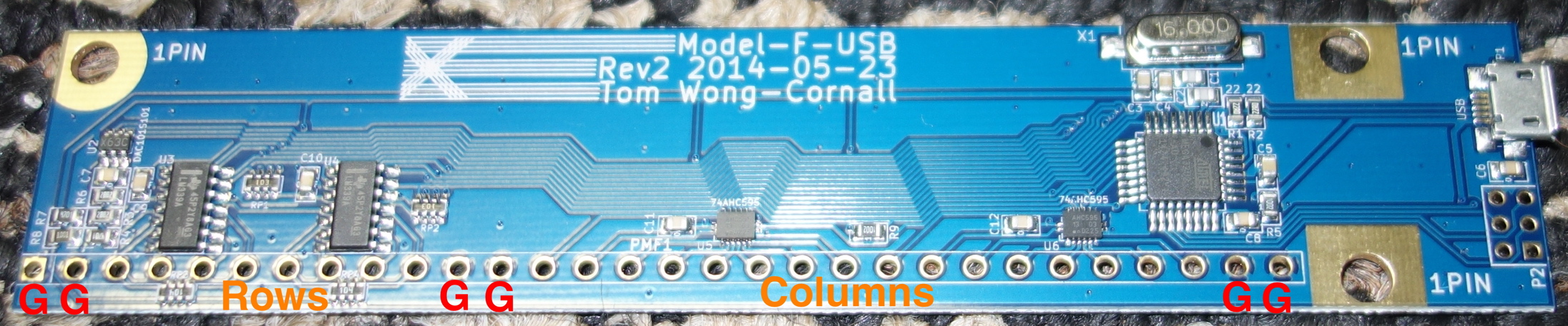

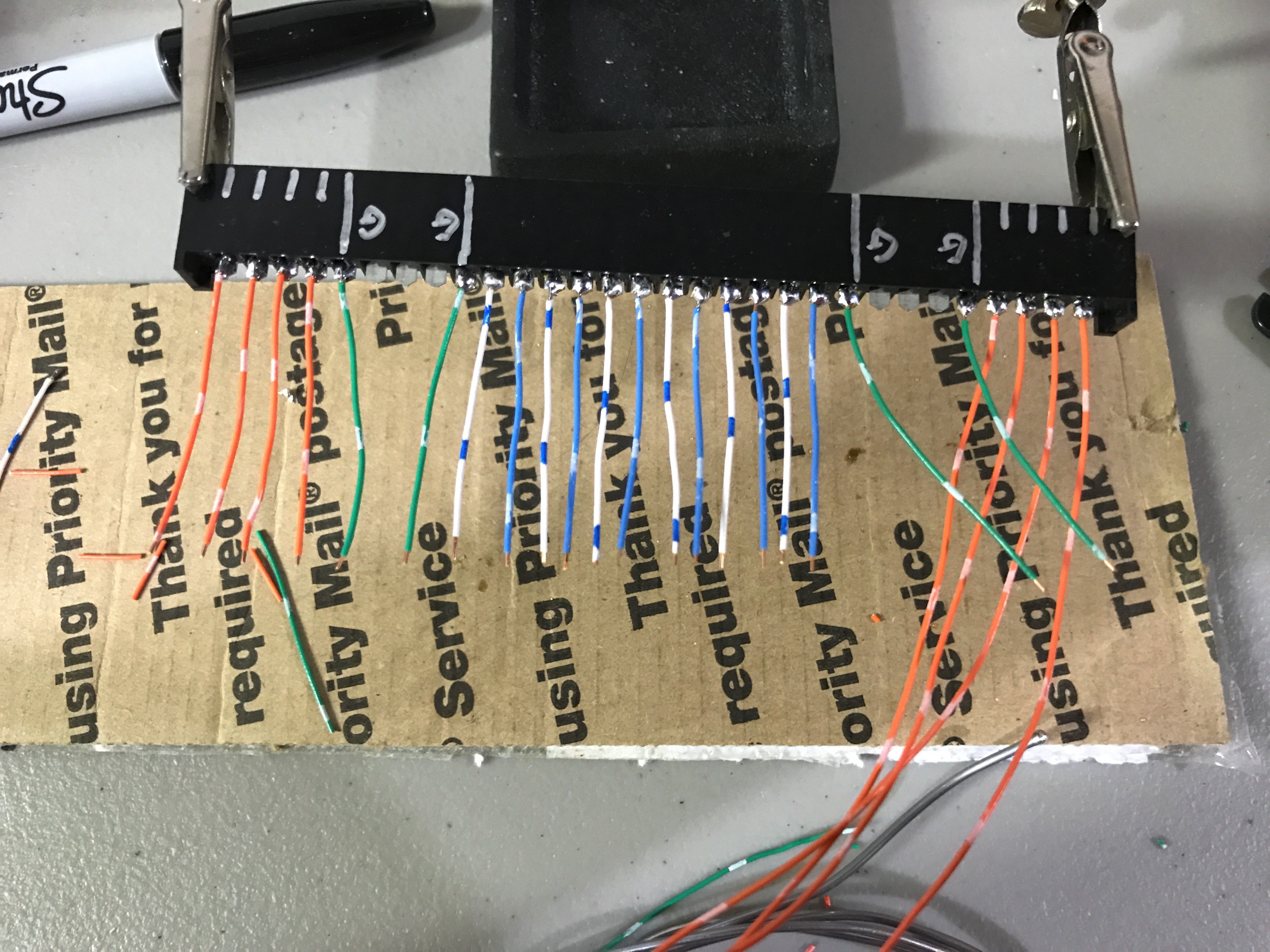

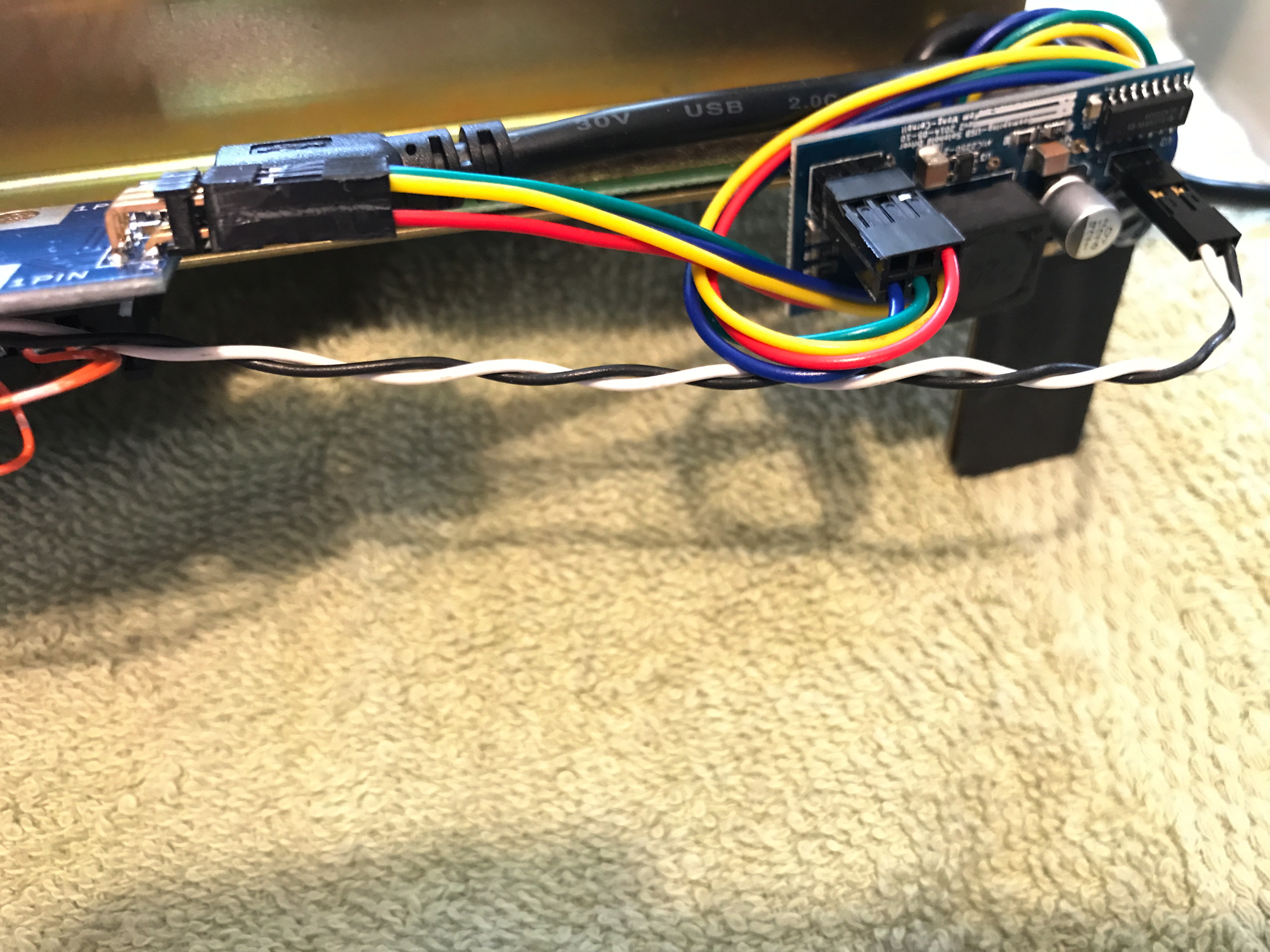

First off, reason for doing this is that there aren't any Displaywriter Xwhatsit Beamspring controller group buys on the horizon since they are unique to Displaywriters and can't be used with other Beamspring boards. This makes it hard to find enough people to go in on a buy and have the price be reasonable especially with how few unconverted Beamsprings remain given previous group buys.
The theory was that since Displaywriters use a 12x8 matrix, the Model F Xwhatsit Controller could be used as Model F’s use 16x8. Problem is that Beamsprings have the capsense pad down at rest whereas model F's have the capsense pad up at rest, so the state would need to be inverted from the default in firmware. Joc was kind enough to modify the firmware for me and tried it out and I can confirm it works!
Steps were:

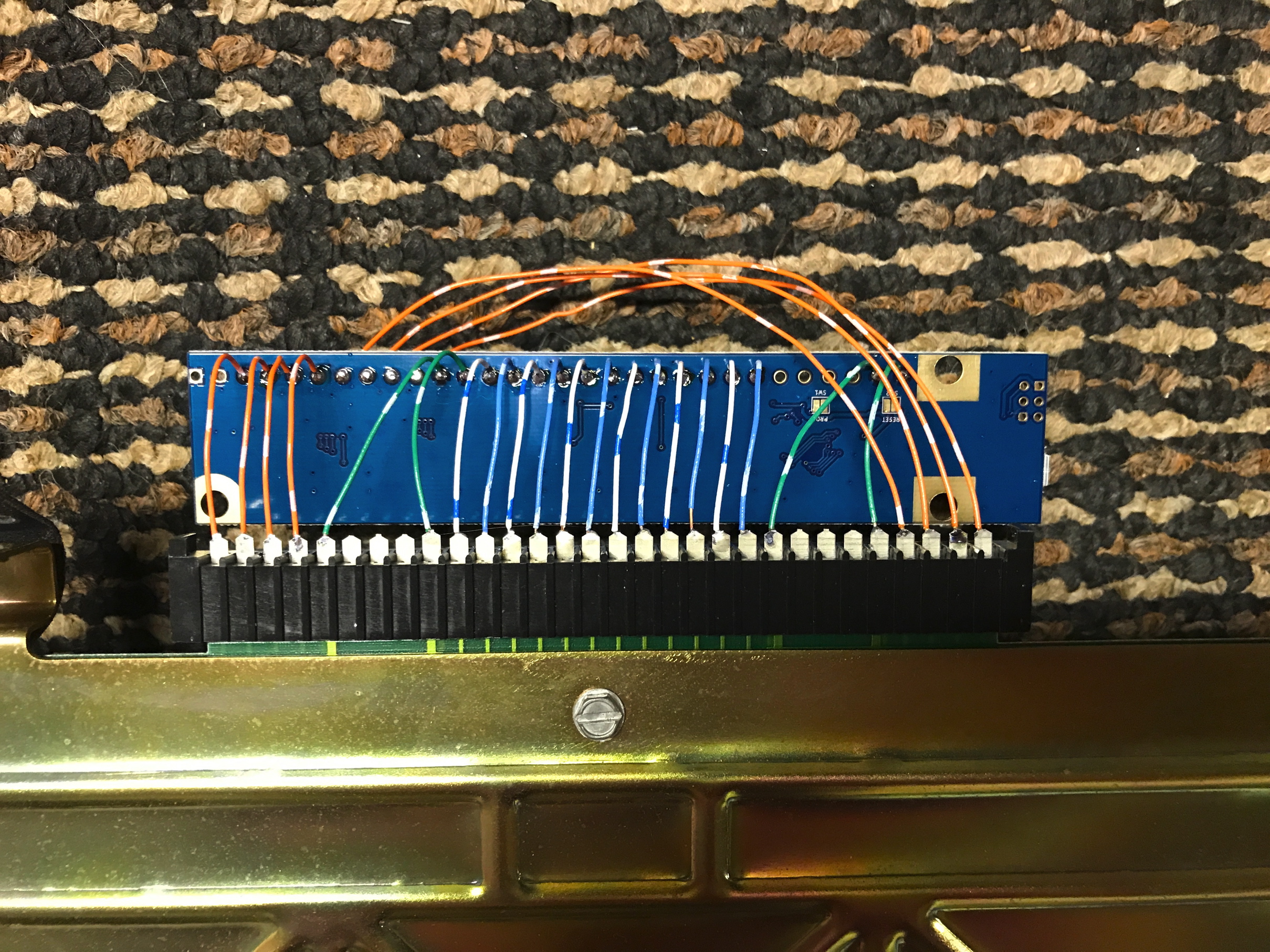

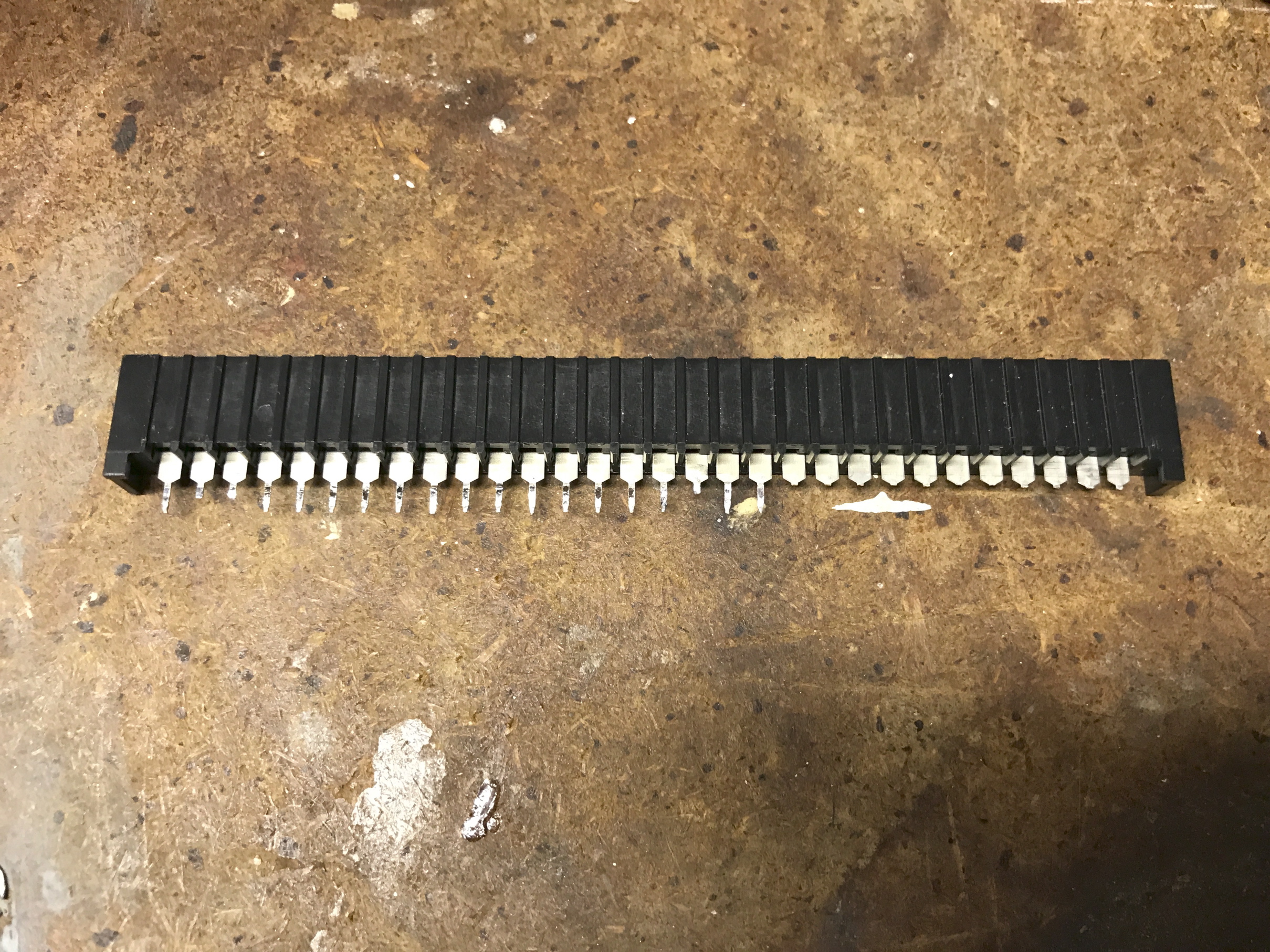

1. Remove original PCB connector from original displaywriter controller - I did desolder it, but eventually decided to bend off the small pins that went into the PCB as I was planning to solder to the larger part of the connector that came out of the housing.

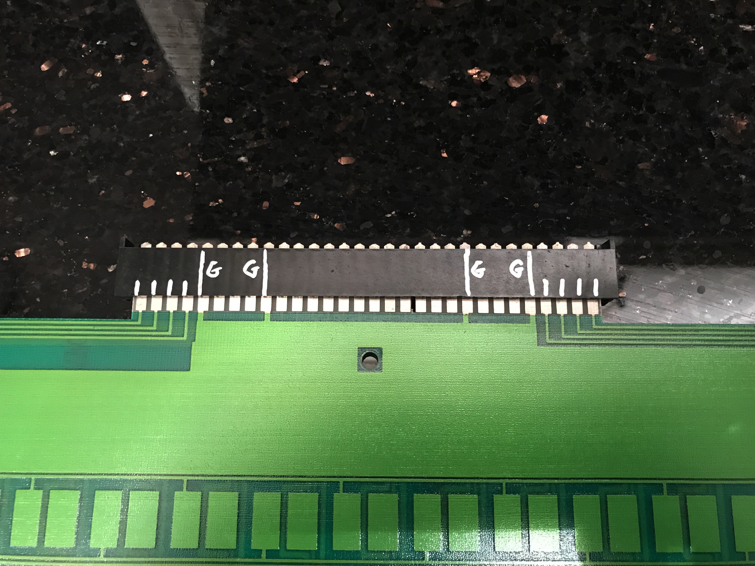

2. Mark out Which pins were grounds and rows vs columns on the Displaywriter. The outer 4 pins on either sides are the rows. The center 12 pins are columns. The others are unused.

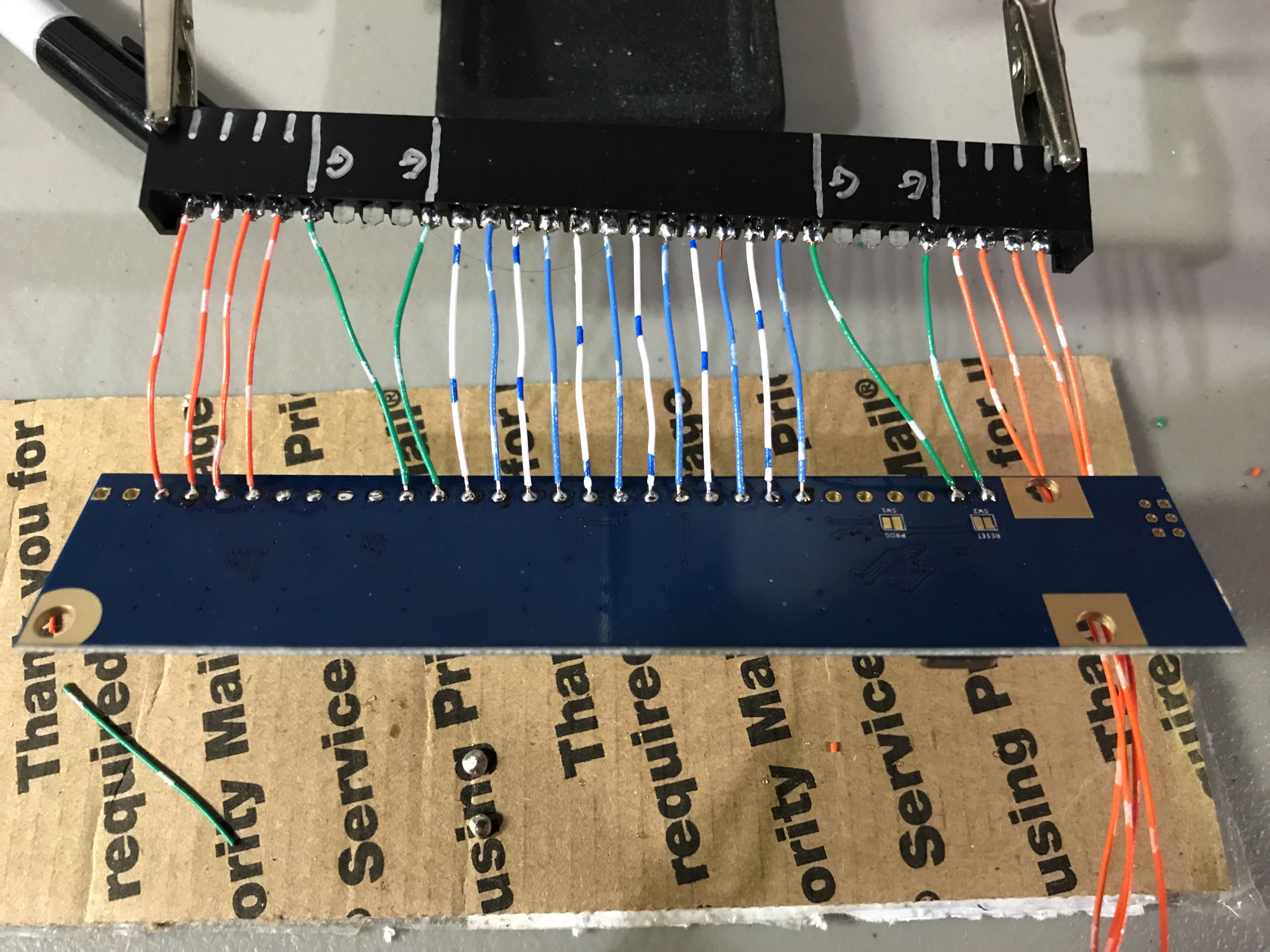

3. Run small solid core wire from these positions to those on the Xwhatsit Model F controller’s corresponding locations. On the Model F Xwhatsit, there are 2 ground pins on either end, columns are the next 8 on the left front of the controller, 2 more ground pins, then the 16 columns. Orange wire was used for the rows and blue for the columns. Green wires are ground.
4. You may connect a solenoid and driver if desired.
5. Run a ground wire from any of the ground pins to the case.

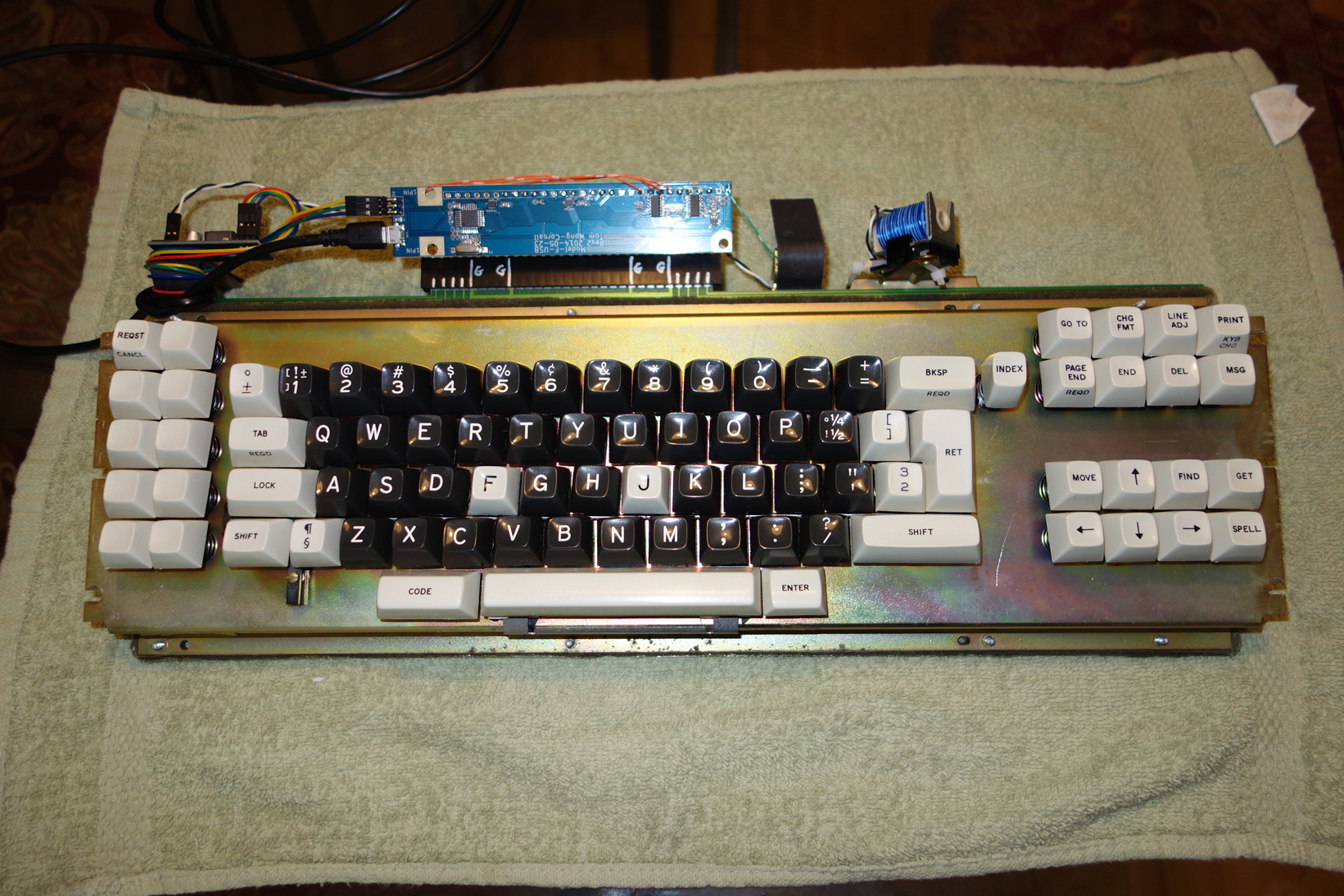

Video demo here:
https://youtu.be/kto87pWCmmo
If anyone wants to convert their beam spring this way, let me know. I have Model F Xwhatsit controllers that I can pre-flash with this firmware for the same price as normal. I also have solenoid drivers and genuine IBM solenoids for sale as well if anyone is interested.
Hopefully this will bring some more Displaywriters back to life!
Firmware is also attached if anyone wants to try this with their existing Xwhatsit controller.
