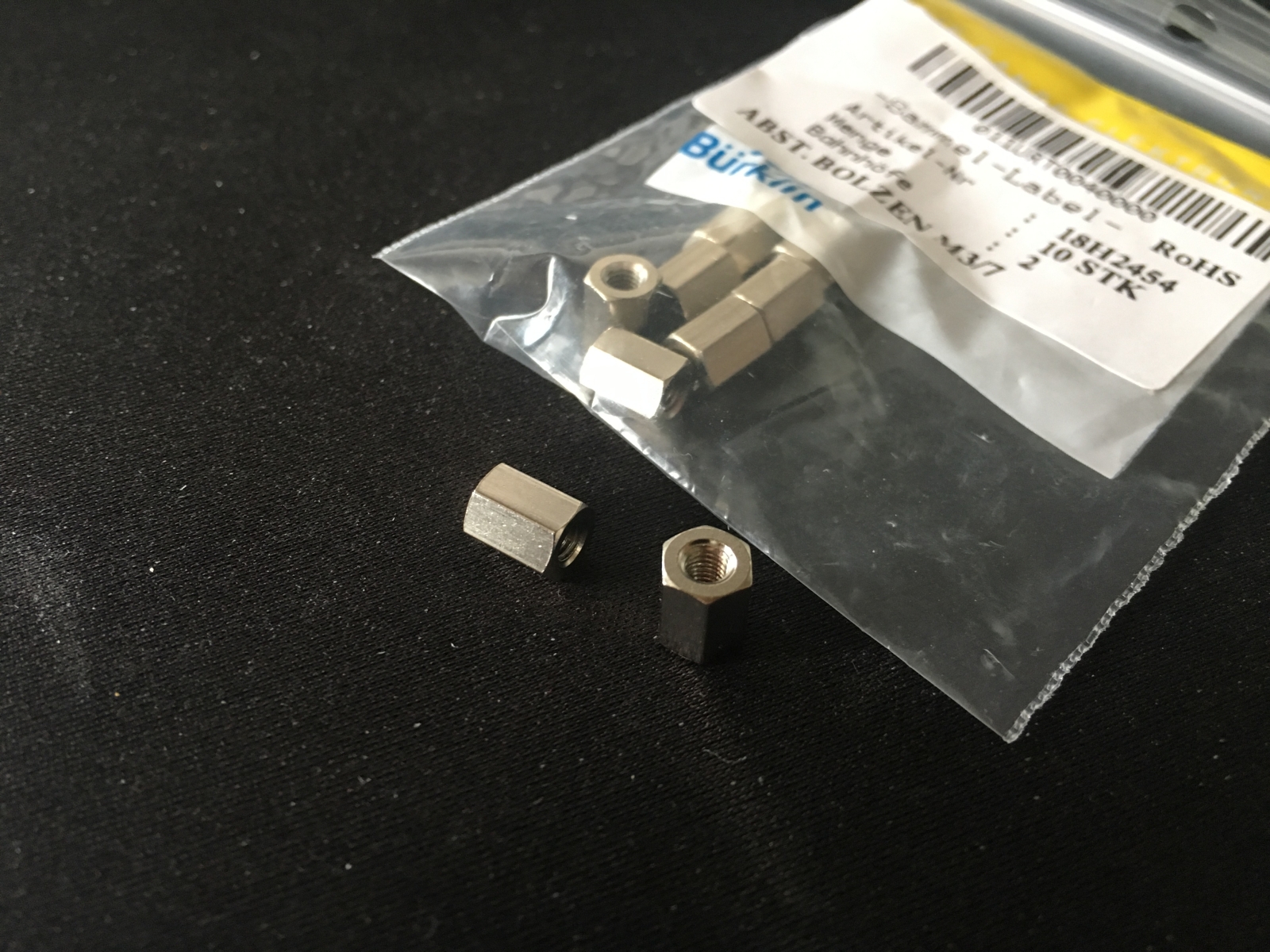

What's the longest standoff that will work with the SKB75? I'm liking the idea of having deep set caps.

It is the same for all versions, 60, 65 and 75.
8mm is the longest standoff you can use when you are at 6degree. You could use even longer standoffs if you chose to use a higher angle but I doubt it would be usefull. caps would would sink below the frame completely when pressed down. maybe looks nice with SA caps.
7mm standoffs will be included but even if you'd only use 6mm standoffs your caps would sink in deeper than with most other high profile cases.
I think about ordering eight of these:
link to shop. here is another shop. here as well. they are used dampen the controller module of RC planes and drones, so the gyroscope is less effected by motor vibrations. something like this might work as well:
these are the ones that I will include, M3x7:

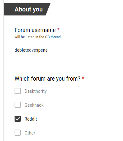

I... I... show up as a redditor in this list. :cry: :cry: :cry:
The important details (what I'm in for) are right, though. :D

I just checked to make sure I didn't accidentally made a mistake while exporting to excel. It seems I didn't, the google form shows that you did indeed check the box for "Reddit" :o
