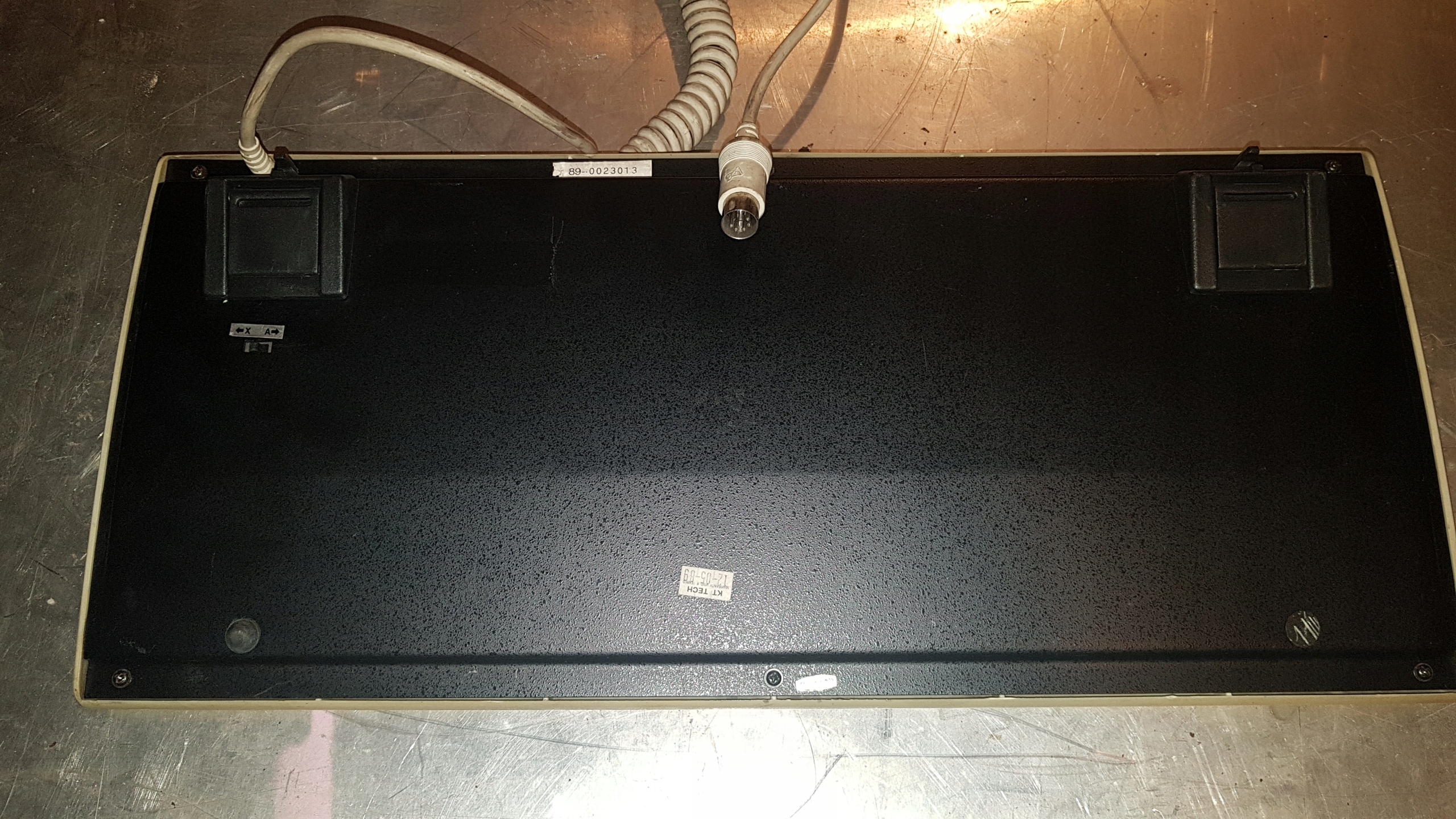

zrrion wrote: 12 May 2019, 14:34 A pic of the switch would be very helpful if you can get it. The layout and those feet remind me of a podworld 292, but the bottom plate and the case design do not match at all.
I was ask seller for photos.
thy_sikk
12 May 2019, 15:26
Pretty sure it's the same as this https://youtu.be/bUYuTBWfxr0
Post the photo if you can get it :D

Almost sure that's not a FK-555, almost everything about it is slightly different. The lock lights and their order, the colour of the F-key strip and lock light sticker, the keycaps, the layout (Monterey instead of Focus), the cable, the feet, the AT/XT switch, its position and its label, the serial number sticker and its font, and the colour of the back panel. It looks more like a fullsize version of those Tai-Hao or BTC AT clones. Or of the Chicony 5160, but I don't know if that has a metal back panel.
Noobmaen
12 May 2019, 16:13
ppCircle wrote: 12 May 2019, 14:22 Anybody know what board is that? Looks like focus rebrand.
Should be a Podworld PDC 101 viewtopic.php?t=15970

I also asked for a photo and I got this pic:
Looks like Noobmaen was right
Dingster
13 May 2019, 18:40
Looks to be some sort of KPT switch, but I've never seen red or black ones documented anywhere.

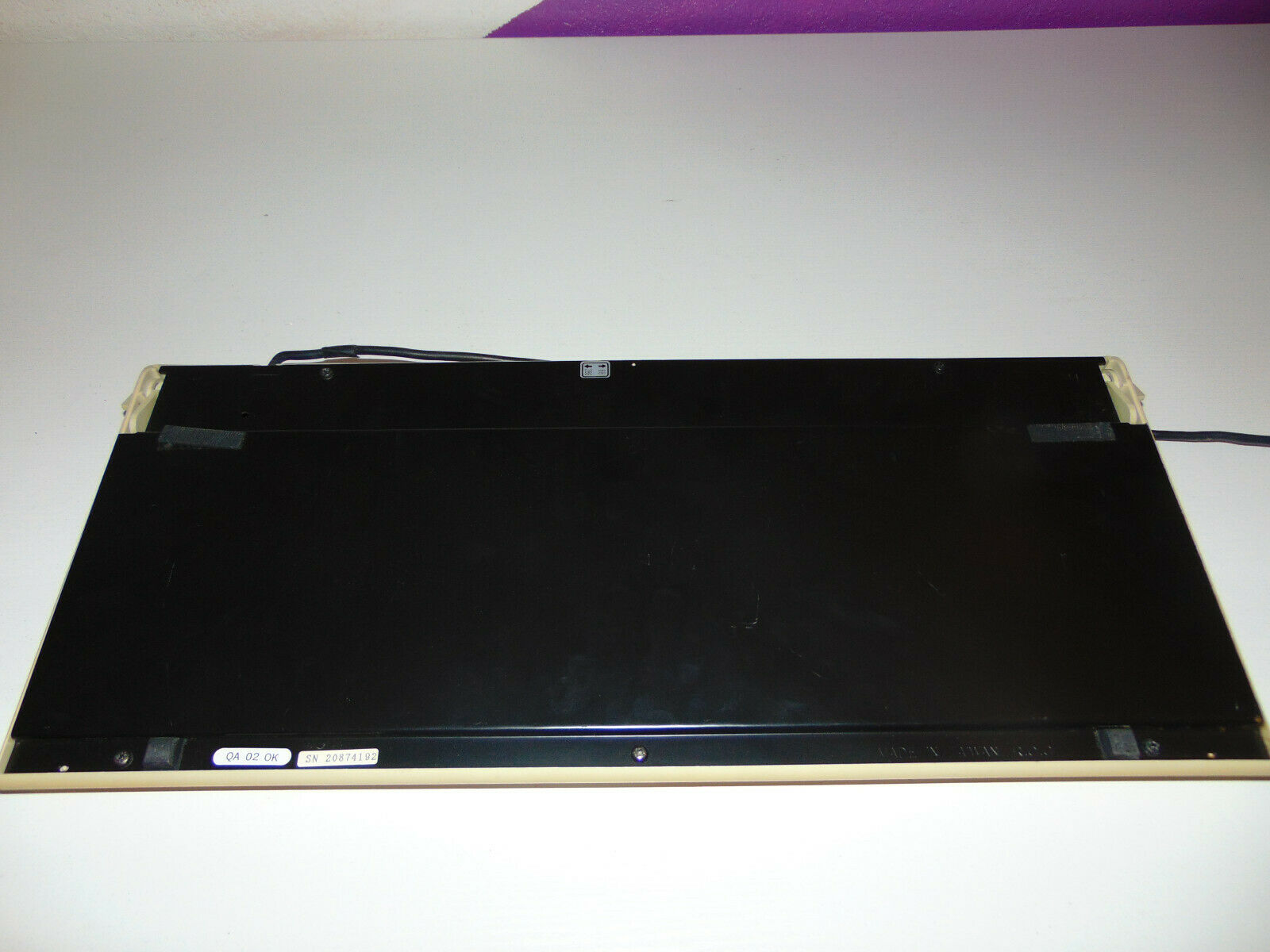

silverbergd
13 May 2019, 23:47
Hello all,
I was wondering if anyone recognized this 74 key keyboard. It has pull out spring loaded feet. Any help is greatly appreciated.
Thanks
David
Noobmaen
13 May 2019, 23:53
Fujitsu N860-2519 with 3rd gen Fujitsu leafspring, not sure if clicky or linear.
silverbergd
13 May 2019, 23:57
Noobmaen wrote: 13 May 2019, 23:53 Fujitsu N860-2519 with 3rd gen Fujitsu leafspring, not sure if clicky or linear.
Thanks so much!

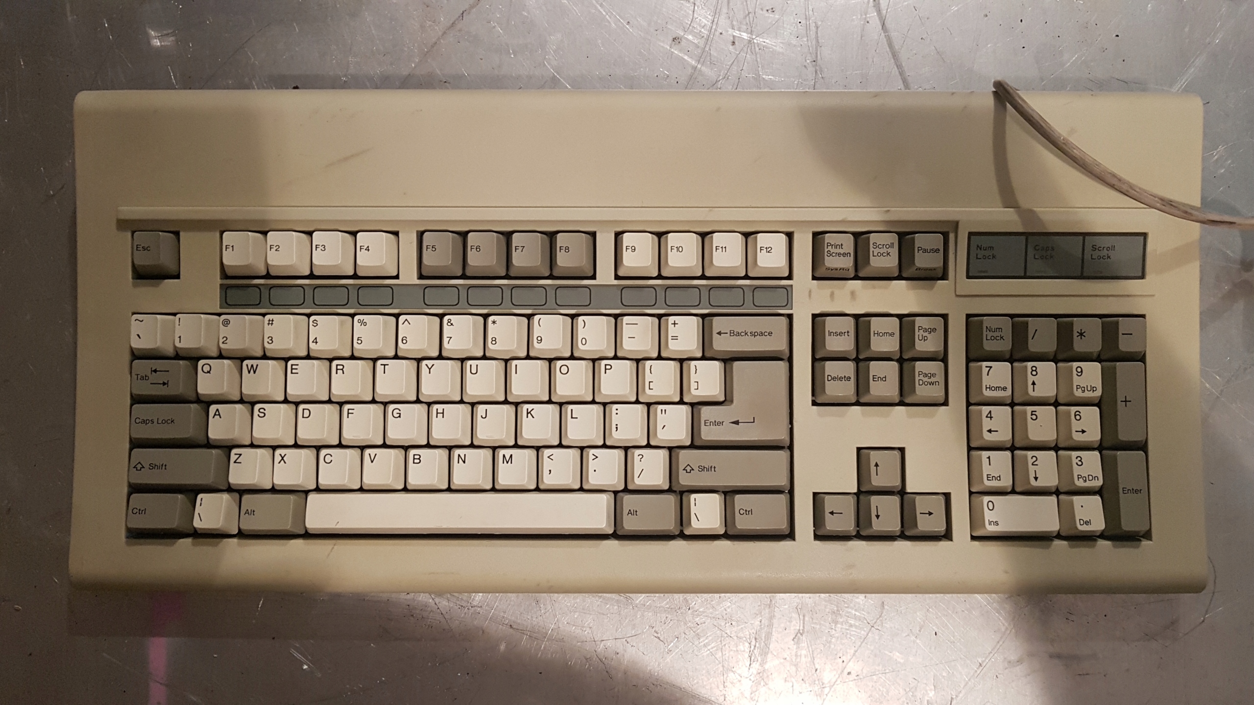

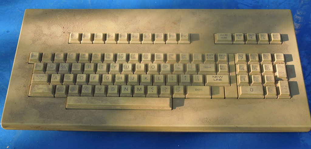

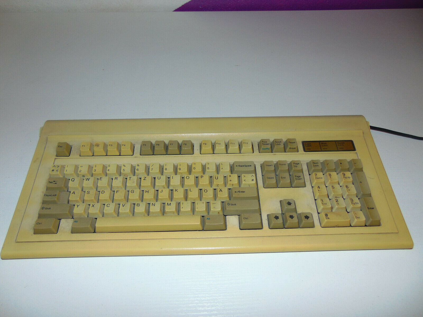

Obscure
15 May 2019, 14:34

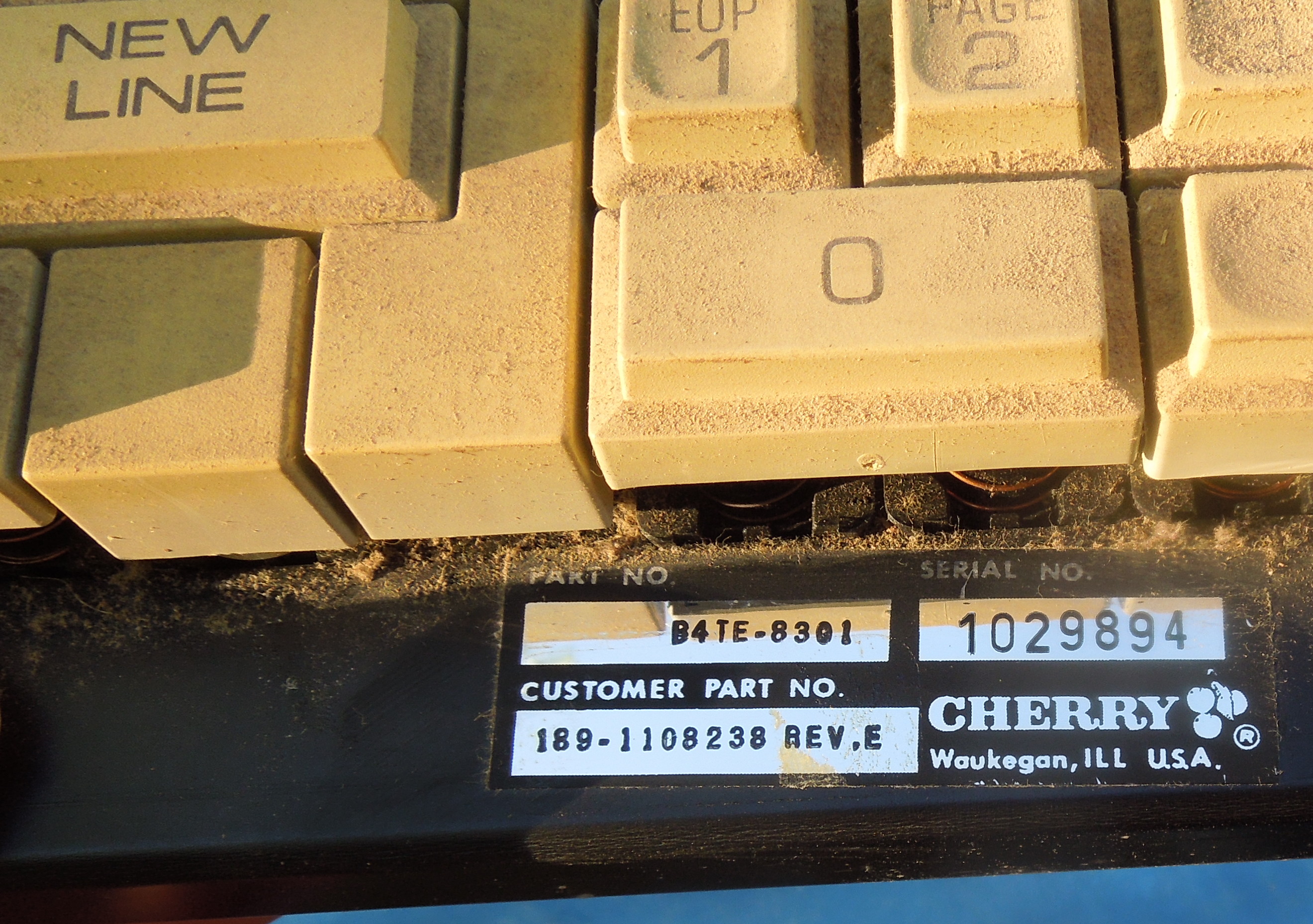

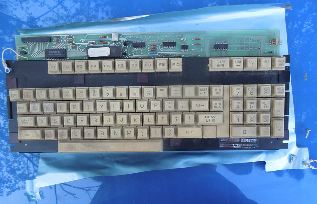

Which system does this derive from? Cable is missing. I can only post the pics, please just imagine how it smells.. and for the keyfeel: worth to post it in the ugliest keyboard thread. Thank you!
Anakey
15 May 2019, 15:13
cherry solid state capacitive so foam and foil though the keycap mount and profile look to not have been documented
15 May 2019, 15:17
Holy keycaps batman!
Myoth
15 May 2019, 15:21
ugh, another rule breaker of the fragile rules I found in the pre-germany Cherry naming scheme
thanks cherry, very cool
