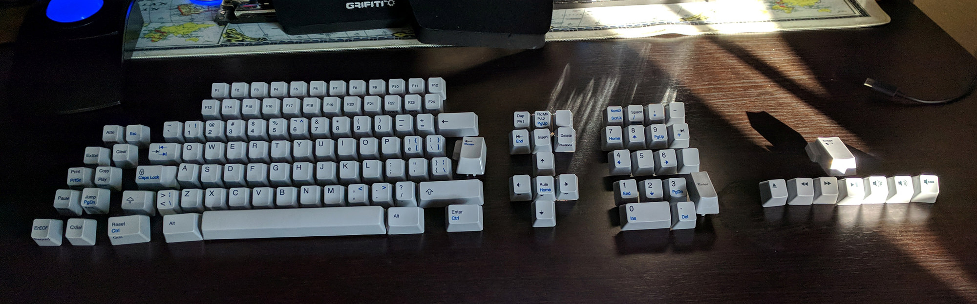

I solved the lack of homing keys by substituting a couple of Model M keys. The legends are slightly different, but not enough to notice unless you look closely. They can be easily obtained from ClickyKeyboards.com, and they are authentic vintage caps, so at least a little better than ones you could get from Unicomp.
If you look closely you can see that the F and J keys have homing bumps, but the legends are just slightly different...

I'm currently trying to mod my 4980 Model F to look like Iggy's black F122 that just_add_coffee restored. I really like the sleek, black case and grey keycaps. In the process of asking Unicomp what they can and can't do. I want grey 3270 terminal keycaps with blue sublegends, with sublegends in the F keys like on other terminal boards. I also asked if I could have more on the 10 keys at the left.
Going for a similar layout, with a large ANSI left shift and ISO enter key. I want a 20 key numpad with Chyros' F107 layout mapped to it.
I need to find somewhere that will paint my plastic case for me, but I don't know any places.
Pictures included are Iggy's F122 and the numpad I am trying to replicate.
