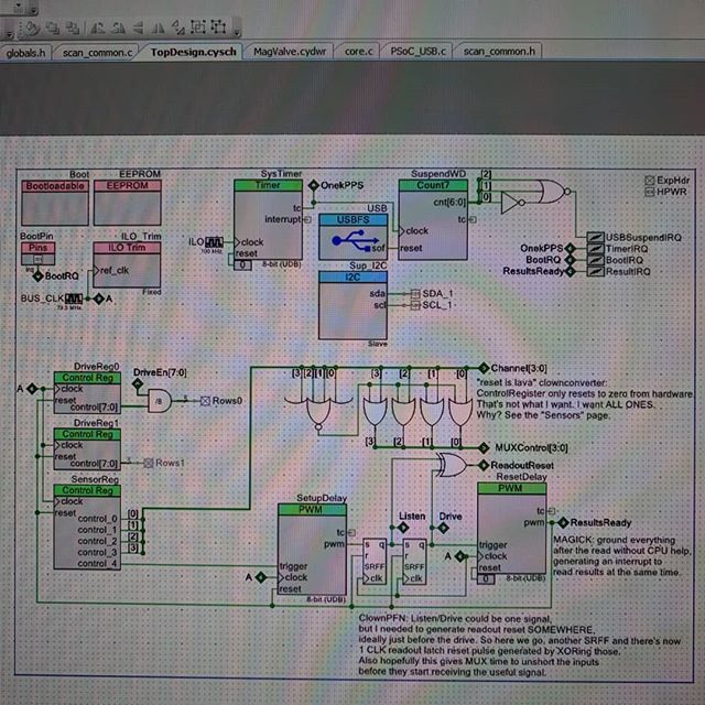

I've implemented the timing generator as described in the patents below in PSOC Creator, and attached a link to a test of the state machine below.

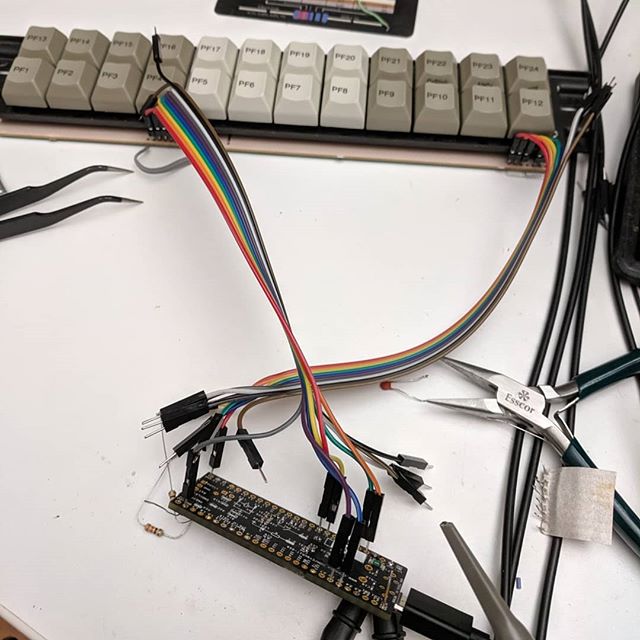

I happen to have 3 cortrons laying around. In one, I've got permission to replace the MCU and keep the driving logic because I couldn't figure out the analog part, really. Especially puzzling is the output from MCU which feeds back into the analog part depending on the previous key state.
.. I almost reversed the schematics in all 3, but work took the best part of me. I'll try to find the papers.
So, I was using a KitProg (of all things!) to drive the drivers - and was able to get almost (ALMOST) all keys working. Problem was 3-4 keys which register like 1 times out of 10 - and I can't figure out is it because I fucked up timings somewhere or the keys themselves. Lack of logic analyzer shows - just the oscillograph is not a good fit for long sequences.

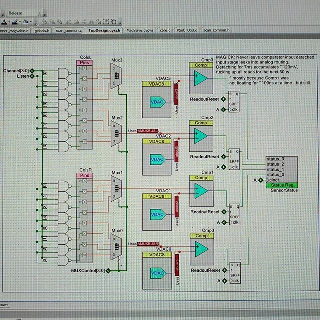

I tried to run creator from linux, but given up. Even if compilation environment is not really windows-specific, the UI is
As for writing verilog for psoc - I find it easier to make the equivalent schema from components and let the creator deal with everything else - from verilog to bitstream generation.
chibios - I can't really understand why you would even need OS on things that small. Driving a screen or something like that? But there's no screen..

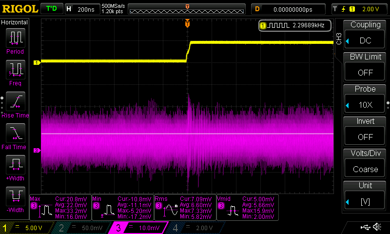

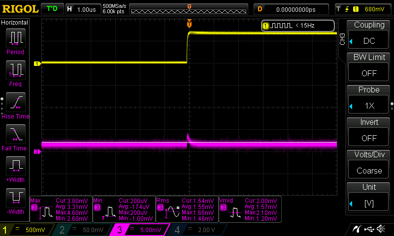

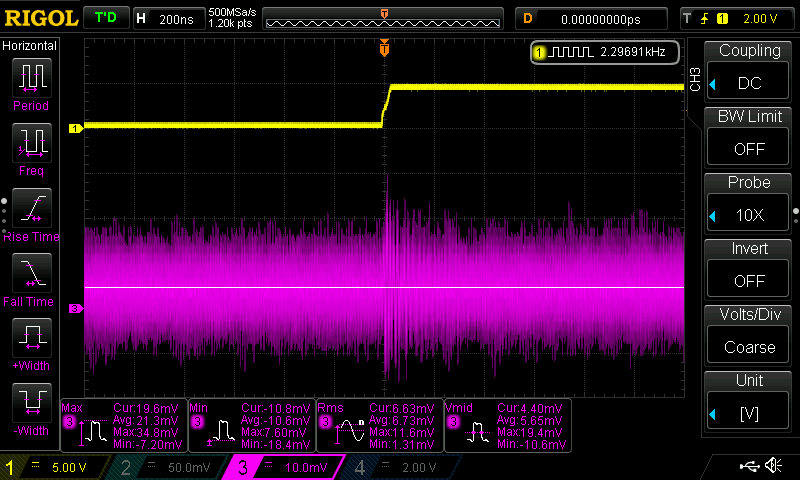

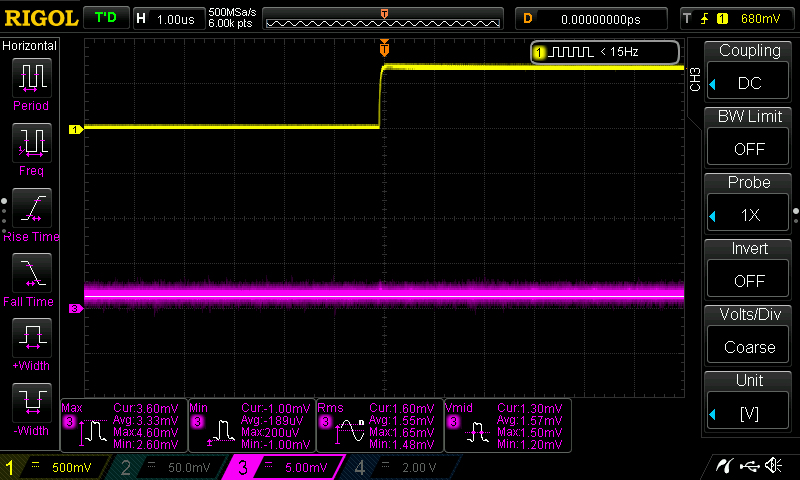

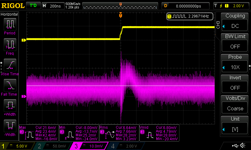

OK, I killed 2 days but now I know why reads are so unstable.
Turns out, 74145 is there for a Reason.
The Reason is all 10 outputs are essentially shorted together - well, technically, they're connected via a wire wound thru all of those ferrite cores, so there's some impedance, but inductance is low and the resistance is abysmally low, so a lot of active power is dissipated.
So much, in fact, that voltage sags to 3.8-3.9V at the USB plug, and 74145 itself is slightly warm.
RMS at the plug is 4.42-4.44V, which is very close to absolute minimum of 4.4V.
So after I finish this note, I'm into cutting some wires and direct-driving + direct-sensing. Not sure about output voltage levels - so driving first, sensing later.
Other than that - in my devices 7442 (rows) is driven normally, 0 to 9 (bits 4,5,6,7 - bit 0 being highest frequency), but 74145 is driven in an interesting way: bits 0 and 1 are coming from the MCU, but bits 2 and 3 are modulated by a NAND gate (half of 74LS00N) with positive strobe (φ2 in US3978474A AKA P1 in US4263582).
MCU drives all 16 values, but only 4,5 and 8 to 15 bring any of the outputs low. So, waveform of 1 row looks like this:
*) first 63 full periods of A (___~~~) are 70us, followed by 17 periods of 98us, giving full cycle time of 3.3+8.8=12.1 milliseconds.
The strobes themselves are a bit different from the patent - there's a positive strobe (2 lines, absolutely identical) and negative strobe. They are located in the middle of a pulse (20us + strobe + 20us or 40us + strobe + 20us) and shifted 5us front, 10us back:

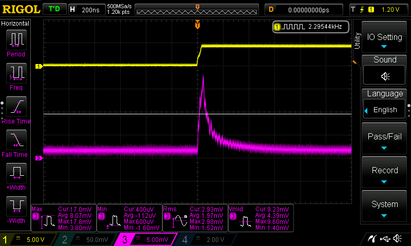

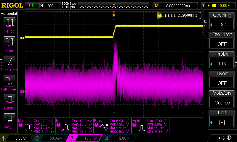

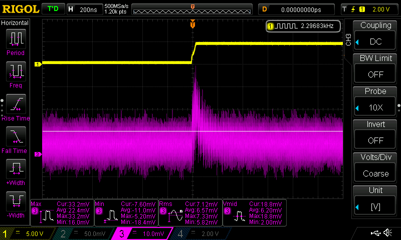

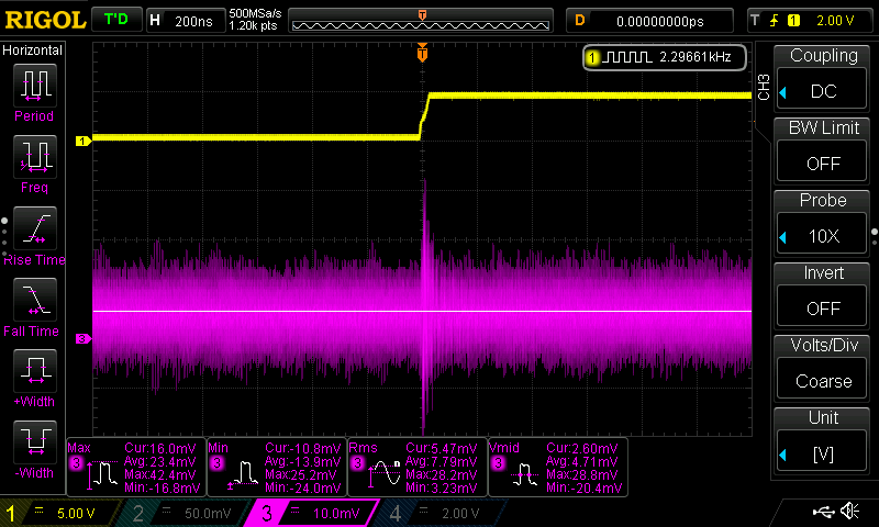

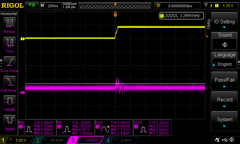

Comparator (not amplifier! LM319N in my case) generates an extremely short (and very unstable because of power sag: https://www.instagram.com/p/B0Ef6aLliQX/ ) pulse - ~150ns. PFN (another half of 74LS00N) takes care of it, presenting MCU with the signal depicted as IN: on previous diagram - from the "ON" of positive strobe to the "OFF" of negative one.
I was able to poll without a single line of Verilog:
Drive and Strobe are control registers (clocked by 200kHz - same clock that drives the DriveIRQ), DrivePins are "resistive pull up" digital outputs, positive strobe (StrobePin_{0,1}) are resistive pullup too, negative strobe (StrobePin_2) is resistive pullup-pulldown.
I would make others pullup/down too - it significantly reduces spikes at the cost of 500ns to reach the logical 1/0 - but pulldown resistors only can pull the inputs down to 1.5V and this is not enough to trigger logical zero.
SensePin is digital input, CMOS, buffered.
The code pasted uses longer key scan slot as an attempt to reduce current consumption. It helps - min voltage is about 4.05V. But that's not enough, readouts are still unstable.

OK, I have good news and bad news. Good news is one can sense keypress depth: https://www.instagram.com/p/B0KiNFCFydI/ - kind of.
The bad news is you have 20 mV of noise and 15 (FIFTEEN) mV of signal, for what seems to be 100 nanoseconds.
Here's non-pressed vs pressed oscillograms for 4-switches in series, loaded by:
Nothing (well, oscillograph probe is some load):
100K resistor:
Small ceramic capacitor:
Looks like capacitor is the best, but 50 nanoseconds is not really workable.
Seems like magvalve scanner will have a lot of passive components.
Need to read on direct current in transformers.

Turns out the noise was my scope. I remembered the probes have 1x position and remeasured.
It's not that bad, but 50ns measurement window smells like OpAmps - which we have, but they only can be used on specific pins and there are only 4 of them (so either external demux OR external OpAmps OR rewiring of ALL the switches OR using 2(3?) kits and an internal USB hub.)
100KΩ load:
No load:
Capacitor load
Also it seems like external current-limiting resistors (1kΩ) will be needed - current is just too low with internal pullups to produce any meaningful output voltage:
Rectifier would save the day - but rectifying 16mV.. haven't seen diodes having forward voltage of <150mV so direct rectification is out of question.
100KΩ load:

Made a 2-column keyboard - AMux + VDAC + comparator + SR flip-flop, @80MHz.
2-step debouncing is mostly OK, especially if you trim the comparator right between the unstable regions.
Comparators turned out to be seriously badass - can be trimmed +/-16 mV, so can easily shift 3 DAC steps if needed.
Not sure how to represent all this in configuration UI though. Probably won't - auto-trim to zero gives a threshold of ~3 on my rig.
Will make better sequencing logic tomorrow-ish to make it single-shot from the software side (Software will only need to "select column block, drive this row, read that register") and reduce pulse length to ~40-50ns so I can remove current-limiting resistors, reducing number of passive components required to zero.

OK. I've got this 2x6 piece of matrix (in background) to work.
Scope is invaluable. I screwed up both in hardware (several things) and software (skipping half of the init, then shorting all rows in debouncing by passing zero instead of the row) - and the scope allowed me to figure out that OK, the scanner is now working, the problem is in firmware.
Couldn't do it on ADCs, had to resort to comparators. Trigger levels are FOUR MILLIVOLTS. Step is 4mV, and 8mV doesn't work already - signal is too weak.
Pin placement is trickier than in original CommonSense, because there are 4 MUXes, which strains analog routing a bit. But it's nice to have 4 parallel read channels - things are faster that way.
Here's the sensor: And here's the driver/sequencer: Will try to graft to this guy over the weekend, see what happens. Today is exactly 11 months since I've got it. Hopefully Sangdrax will be typing on it before it's a year ;D
