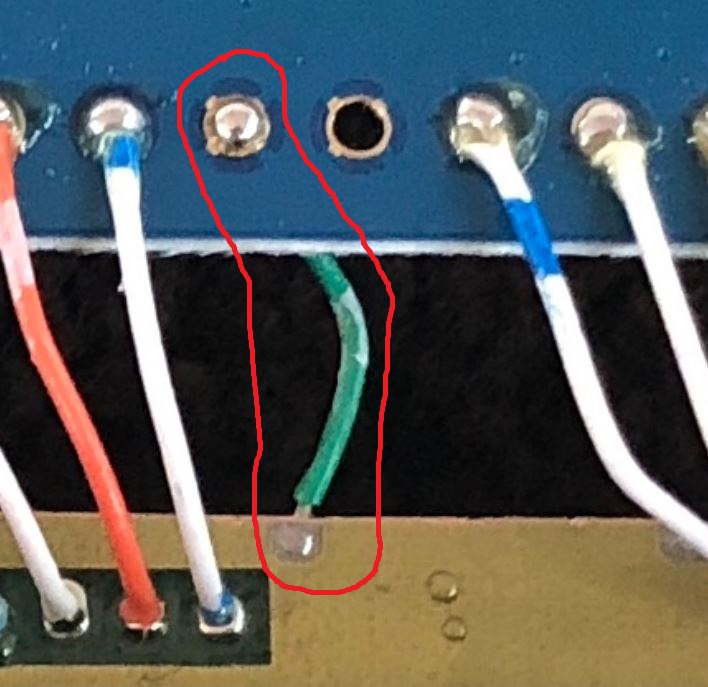

Hello guys,
I've got the same issue.
All of a sudden, my F XT refused to work. (Soarer's converter on a Pro Micro clone.) Right before the failure it started to type itself some garbage, I've plugged the USB off, and then on again. And enjoyed the silence.
I've flashed another Pro Micro and tried it, but with the same result. Nothing.
Here is the output of hid_listen:
And that's it. Doesn't matter what I try to type, no single keypress is registering.
I've unscrewed the back lid and tested the cable with multimeter. It's totally alive, continuity is rock solid from Pro Micro outputs to corresponding contacts on the keyboard PCB (right through the plug, too). The screw which presses PCB to the plate is tight.
My F XT turns out to be of revision 2 (without "Reset").
I reckon the controller is dead. Am I right?
Does anyone have the schematics?
Thank you in advance for the answers!

It turned out that Intel 8048 is a factory flashed chip. Good news: there is Intel 8748, the same chip, but rewritable. Also, as far as I've found, there is no write protection exists in this chip family.
So, the plan is:
To desolder and check the capacitors.
To find the firmware of 8048 dumped by someone(?).
To buy 8748 (they are available). Maybe, for me it will be even easier to get KM1816BE48, which is 1:1 Russian clone.
To flash it.
I think, it will be sufficient for reviving my beloved F XT.

If it was me, I'd probably just get a different capsense PCB or I suppose a desoldered chip from someone who's parted their XT out if you're 100% sure that's the problem. Other thing you can do is cut the original controller part off and replace with an Xwhatsit as I have done here: viewtopic.php?t=19522

Thank you, orihalcon! It's just ingenius! I've never ever dreamed of such a simple solution

I've got just one question. Where does this green and white wire goes? To the ground on the back side?
I'll try my plan first just because it's much cheaper (and I've already ordered the programmed controller). But if it doesn't work, I'll definitely follow your recommendation!
- xws.JPG (110.76 KiB) Viewed 5468 times

It seems you forgot a few words there. I guess you mean that you have a spare controller which you are willing to send to someone if they pay for shipping?Weezer wrote: 11 Mar 2020, 14:38 If anyone's still having issues with this, and theyre sure its the controller board, can send someone an xt controller for the cost of shipping.

Yep that is what I meant. And yes, I see I'm missing an "I" between "board" and "can". Thanks for pointing that out!JBert wrote: 12 Mar 2020, 11:04It seems you forgot a few words there. I guess you mean that you have a spare controller which you are willing to send to someone if they pay for shipping?Weezer wrote: 11 Mar 2020, 14:38 If anyone's still having issues with this, and theyre sure its the controller board, can send someone an xt controller for the cost of shipping.
