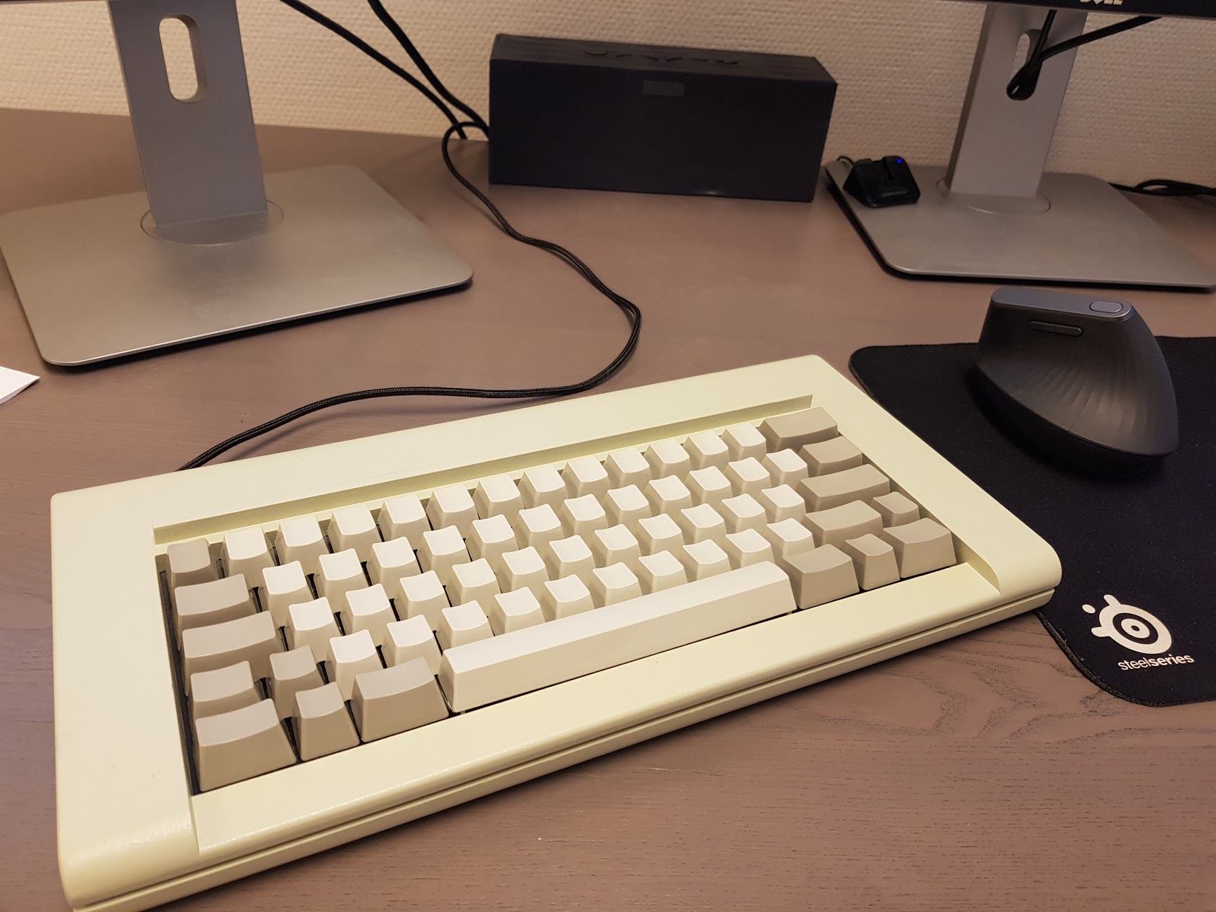

24 Mar 2020, 10:26
Hey Ellipse, would it be possible to get a full pic of the red case? Thanks :)

Redmaus yes here are photos of the F62 and F77 red cases.
https://imgur.com/xsmAzcA
https://imgur.com/xjnlzJ6
https://imgur.com/fkZvatK
https://imgur.com/w4cNg4M
https://imgur.com/TKxUAKy
As a note here is the link to the previously posted photo album of all mailed keyboard variations that is updated whenever there is a new variation. https://imgur.com/a/gw8FOl0
Redmaus
Gotta start somewhere
26 Mar 2020, 06:37
Ellipse wrote: 26 Mar 2020, 04:00 Redmaus yes here are photos of the F62 and F77 red cases.
Nice. I'm thinking red case + black keycaps :mrgreen:
Thank you for the images!

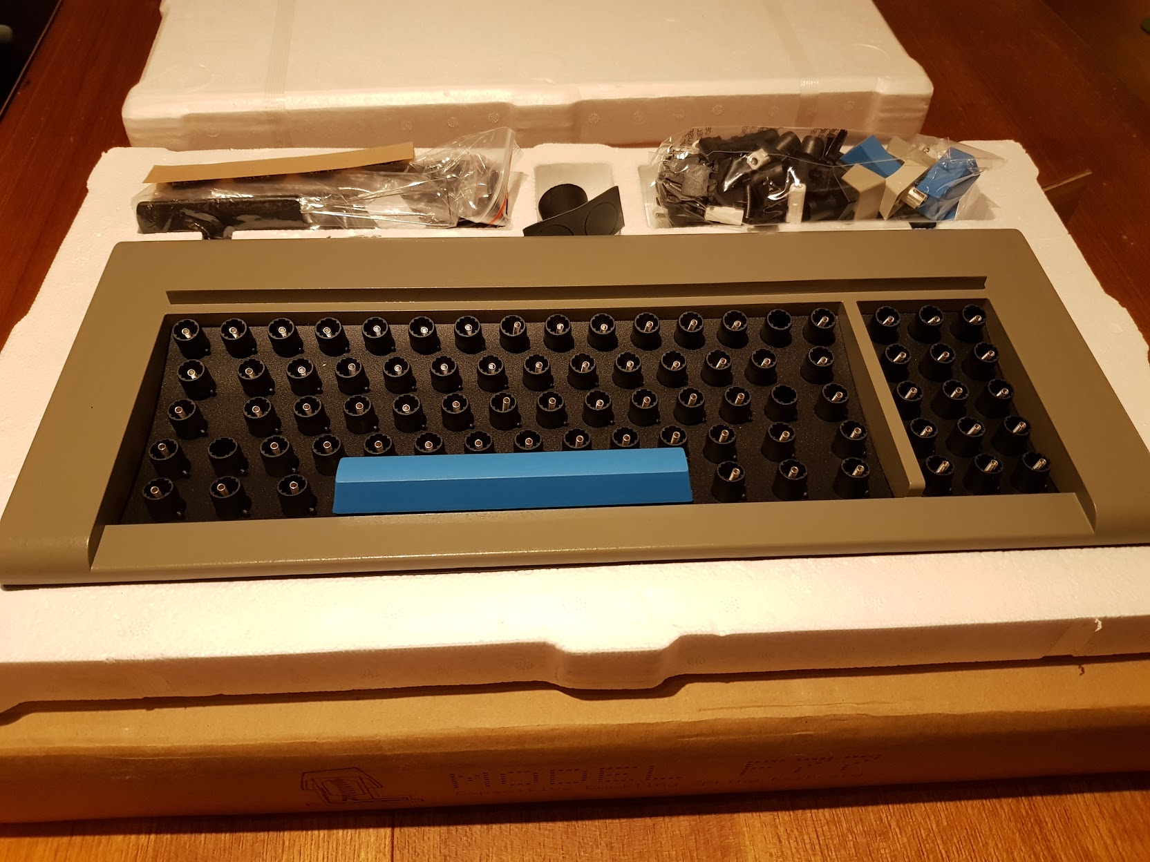

27 Mar 2020, 16:03
Package arrived! Big thank's to Joe!
Shipping was suprisingly fast, even with a delay with the postal service and considering the times we are in - it took only 9 days shipping all the way to the north of Norway.
Gave the F62 a split left shift and it has already been put to work at the office.
Keys are supersmoooth and both the feel and sound is perfect. Even better than my XT and AT.
The F62 in paticular has such great heft and is easily the best keyboard I have owned.
Have them both flashed with pandrew's firmware fix, and have no issues at all. The F62 is running with threshold at 131 at work on my Dell, but I had it at 129 on the Thinkpad at home. So it defently behaves somewhat differently across computers.

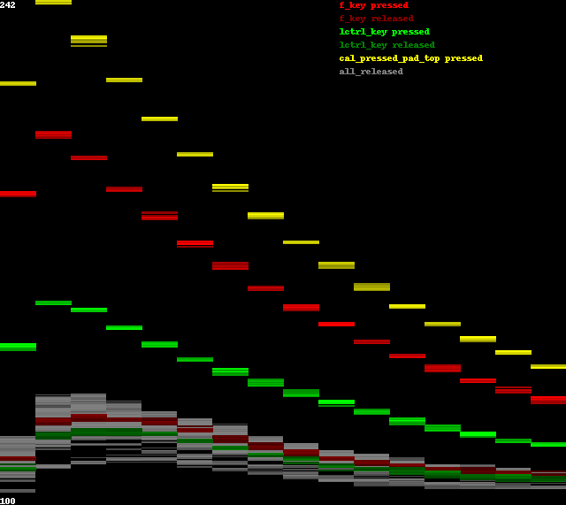

If anyone is having issues on their board with finding a good voltage threshold, I would love to collect some data from your board, to understand what's making it hard. I can plot scope-like signal traces with my code. I PM-ed Spacesaver, but he hasn't responded yet.
So I wonder how IBM did it. I doubt they made millions of keyboards which failed under different temperatures etc. Maybe the hardware has less divergences. But maybe it did some kind of self-test at startup and auto-tuned itself? I wonder if something like that would be possible.
pandrew
29 Mar 2020, 13:35
webwit wrote: 29 Mar 2020, 12:39 So I wonder how IBM did it. I doubt they made millions of keyboards which failed under different temperatures etc. Maybe the hardware has less divergences. But maybe it did some kind of self-test at startup and auto-tuned itself? I wonder if something like that would be possible.
I don't know how IBM did it. The xwhatsit's calibration is not gonna work on the model F reproductions, because the always-pressed calibration pads give a much higher signal then real buttons. I don't know if the reproduction keyboards are different, or if the xwhatsit approach is flawed. I was thinking that one way of calibrating would be to assume that when the keyboard is plugged in no keys are pressed, and then to measure the signal level for each unpressed key. Add a static offset to the measured value, and then try to come up with 2-3 bins of thresholds. For each matrix scan do 2-3 actual scans with different thresholds, and based on that determine each key status. For temperature-drift during operation, we could periodically measure the calibration pads. But I'm not sure how I should adjust the thresholds based on drift. If the reference changed +10 steps, should I change my thresholds +10 steps? We could come up with a formula, but we'd need to measure the same keyboard in various temperature conditions.
See attached waveforms from tantator's keyboard. There's a massive difference between CAL pad response, and the left control key pressed. (thresholds are on the Y axis, there's 4 pixels per step of threshold)

@pandrew: I'm going to test the board close to my microwave and again with the drill today! :)
@ellipse: would it be possible for you to send me a couple of xwhatsit controllers only over? I'd like to test qmk with pandrew also on some other model F boards and maybe even a beamspring I have...
I'm so happy and stunned this is working so nicely!
And btw it looks rock solid so far.
