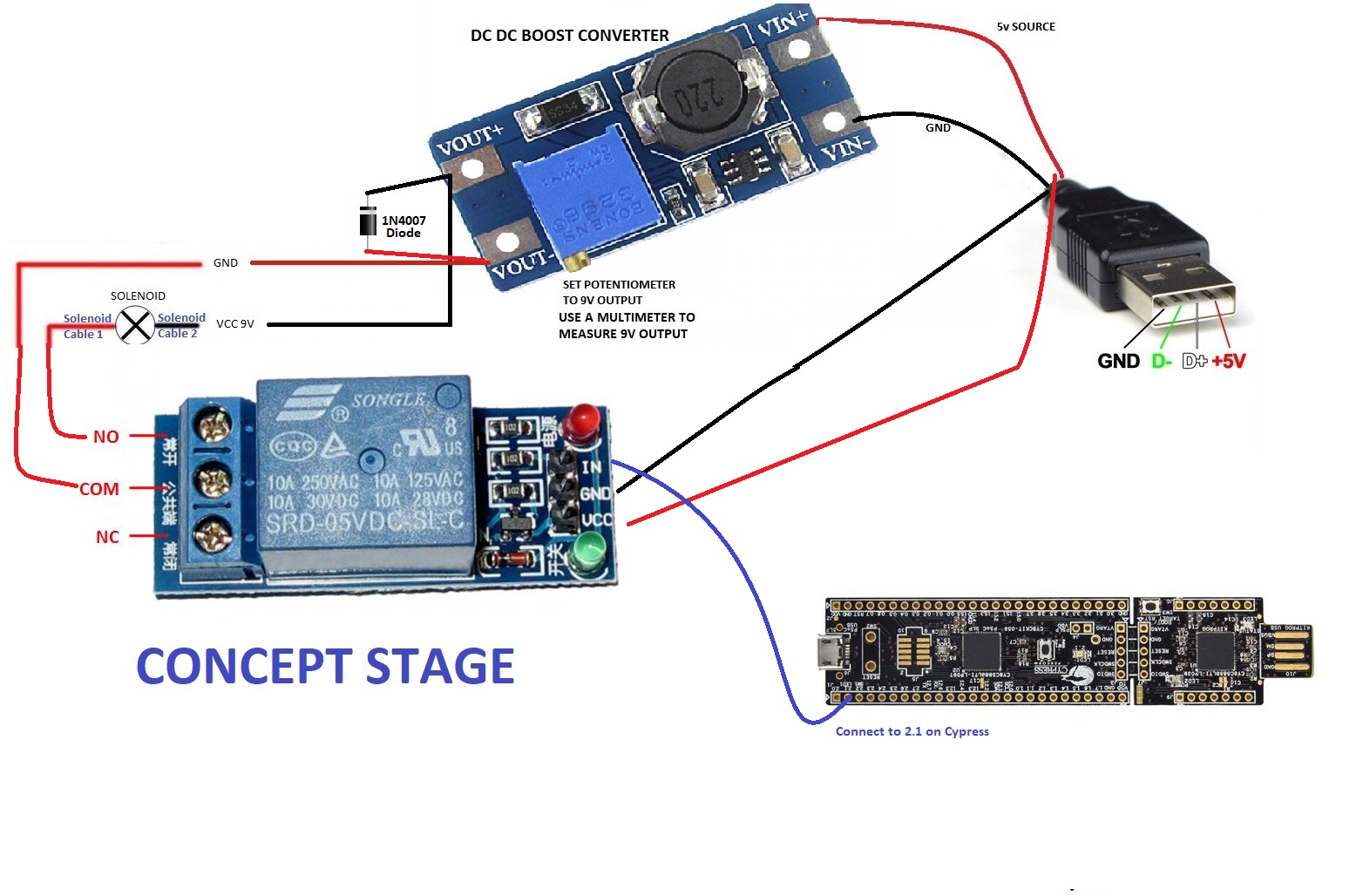

So here's how the schematics look
Updated: Added a Diode for safety.
Notice the Labels on the Relay. It is IMPORTANT that you connect the cables correctly. The sequence of pins will differ by manufacturer. For the output you will need to connect to "COM" and "NO". This is assuming you are using a Low Level Relay. Some relays will have a jumper to set High Level or Low level. Set jumper to Low Level Relay.
Input labels should read GND, VCC and IN or DC-, DC+ and IN.
Special thanks to user: ListofOptions for reviewing the circuit and ZedtheMan for the initial proof of concept

Erhm.. please don't drive inductive loads from GPIO. You'll fry the GPIO. They'e specced for 4mA source current and you're trying to pull SEVENTY, if datasheet doesn't lie: http://www.circuitbasics.com/wp-content ... asheet.pdf
The important parts of xwhatsit's solenoid driver is that it's a 9V boost converter with an input current limiter, huge-ass capacitor behind it, and 9V solid-state relay.
If you absolutely detest SMD components (they aren't that hard to solder, btw - just get a good iron and a lot of flux) - there are thru-hole versions for most of the stuff. Not current limiter though.
There are 2 reasons not to use "off-the-shelf products":
1) space.
2) cost - those modules were much more expensive back in the day. Although I've heard there are small prototype PCBA services nowadays which don't mind assembling small runs and have standard component library so you don't even need to source components. I forgot the name but will ask around.
1) space.

Personally I prefer to use a solid state relay as well. The diagram only represented the wiring against relay pins, I'll change it to a solid state relay. Also, I'll use a parallel usb for the source of power for the relay.

I was a bit incorrect - relay is high-side, so it will work with a power supply capable of delivering solenoid's "on" current (the "don't drive relay from GPIO" part still stands)kmnov2017 wrote: 17 Nov 2019, 22:50 Personally I prefer to use a solid state relay as well. The diagram only represented the wiring against relay pins, I'll change it to a solid state relay. Also, I'll use a parallel usb for the source of power for the relay.
Boost converter, especially powered from the same USB socket, and especially not having a big buffer capacitor, will not be amused by suddenly increased load and will suck enough current out of USB socket to trip the (hopefully resettable) fuse - powering down the controller. Best case there is converter's own controller shuts down from self-inflicted undervoltage before fuse trips. PSoC is likely to ride out that voltage dip, because of 1uF buffer capacitors on it's core's power rails and because core actually runs at 1.71V.

How much is the total power draw by the Cypress board?DMA wrote: 18 Nov 2019, 00:10I was a bit incorrect - relay is high-side, so it will work with a power supply capable of delivering solenoid's "on" current (the "don't drive relay from GPIO" part still stands)kmnov2017 wrote: 17 Nov 2019, 22:50 Personally I prefer to use a solid state relay as well. The diagram only represented the wiring against relay pins, I'll change it to a solid state relay. Also, I'll use a parallel usb for the source of power for the relay.
At 9V, the solenoid should draw around 200 to 250, lets say 250mA. The relay around 75mA. If the Cypress board draws a max 200mA, then a standard USB port with 500mA power output should be fine.

9V 250mA is 450mA from 5V, assuming 100% conversion efficiency. Just the solenoid blows you out of power budget.
CS by itself consumes ~25mA, up to 36mA in some modes.

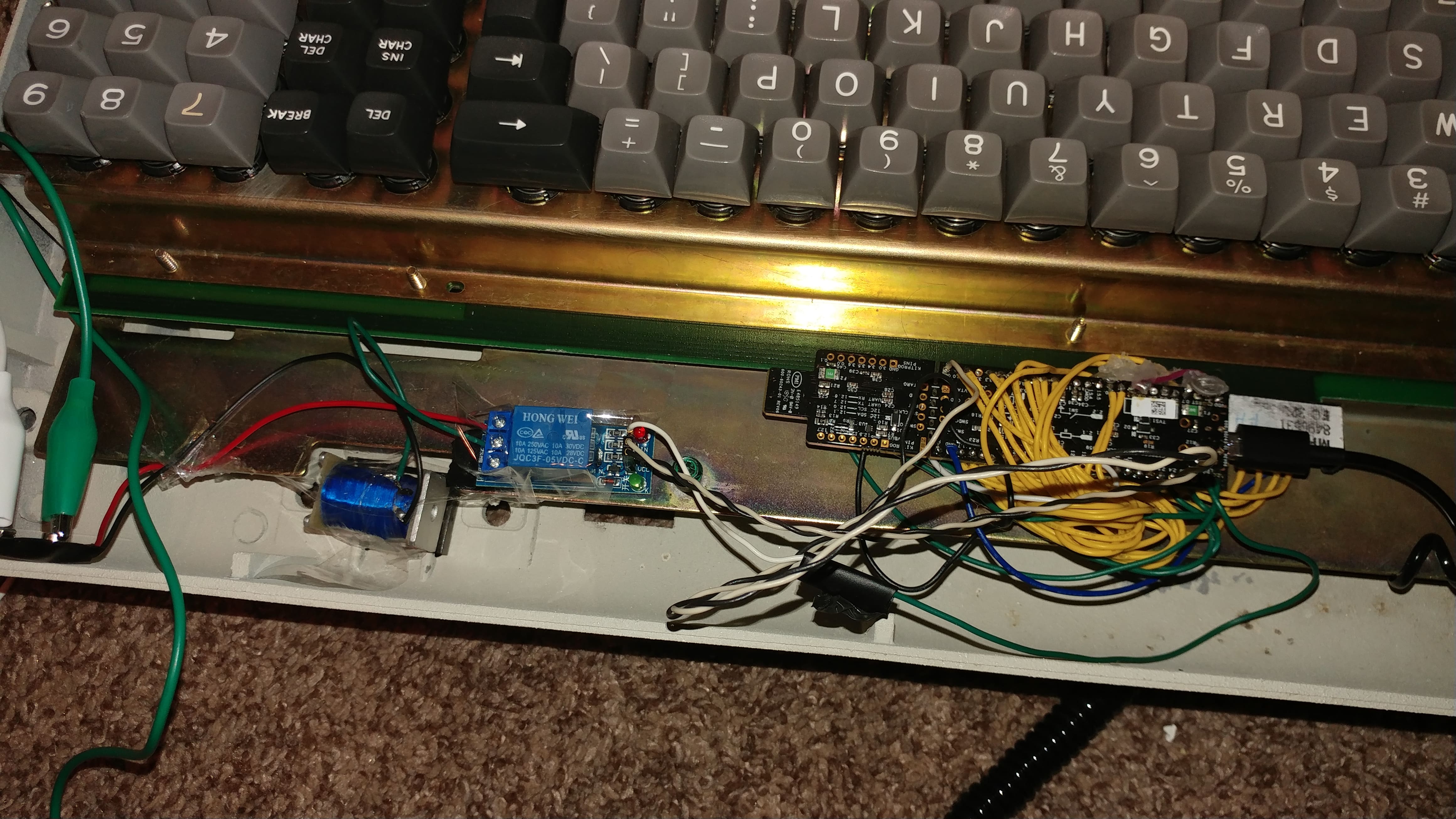

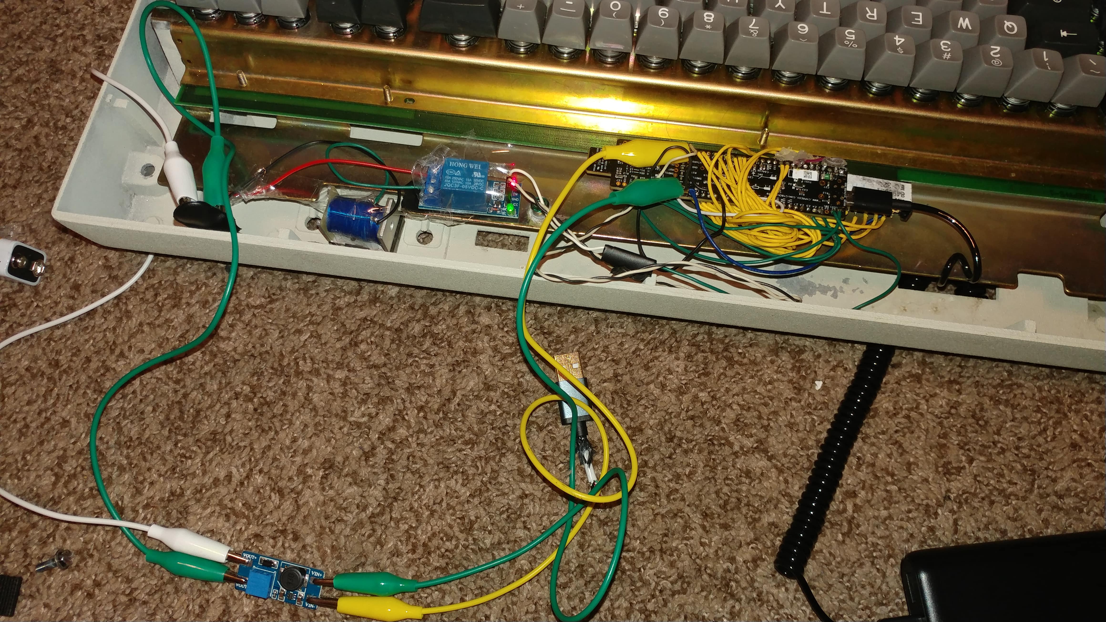

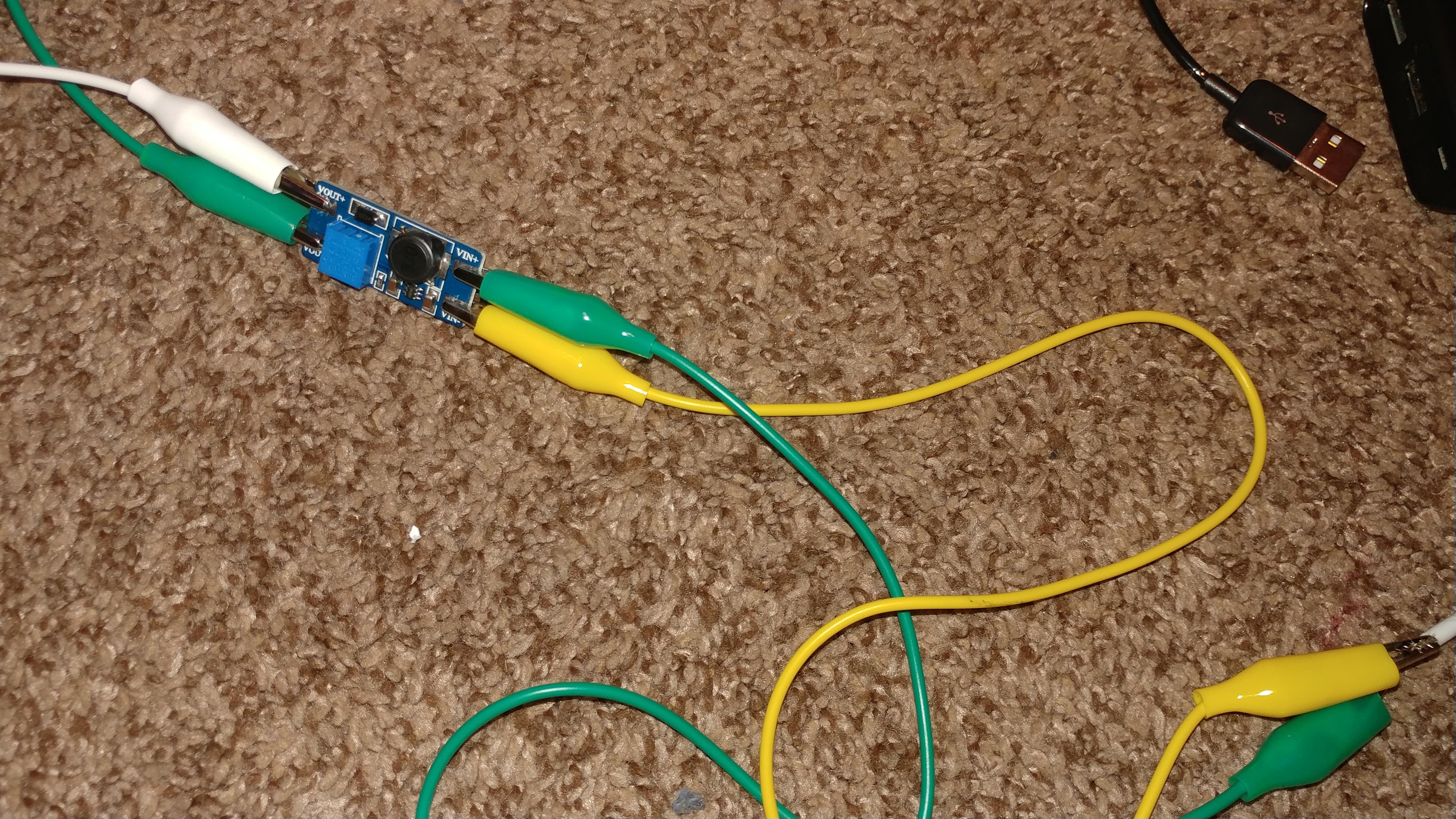

Good news all! I've been doing some testing, and managed to get this alternative working via only one USB port, using vdd and gnd from the cypress. (Admittedly, it required some tuning with the potentiometer. 8.5v output managed to work though without causing the cypress to turn off.) Edit: solenoid works fine with less voltage. I recommend this to give yourself more headroom.
That is, this is still a solution to use at your own risk, but initially it seems to work. If you do not feel comfortable using only 1 USB for powering all of it, you can use a second USB port/cable. Both have worked for me.
