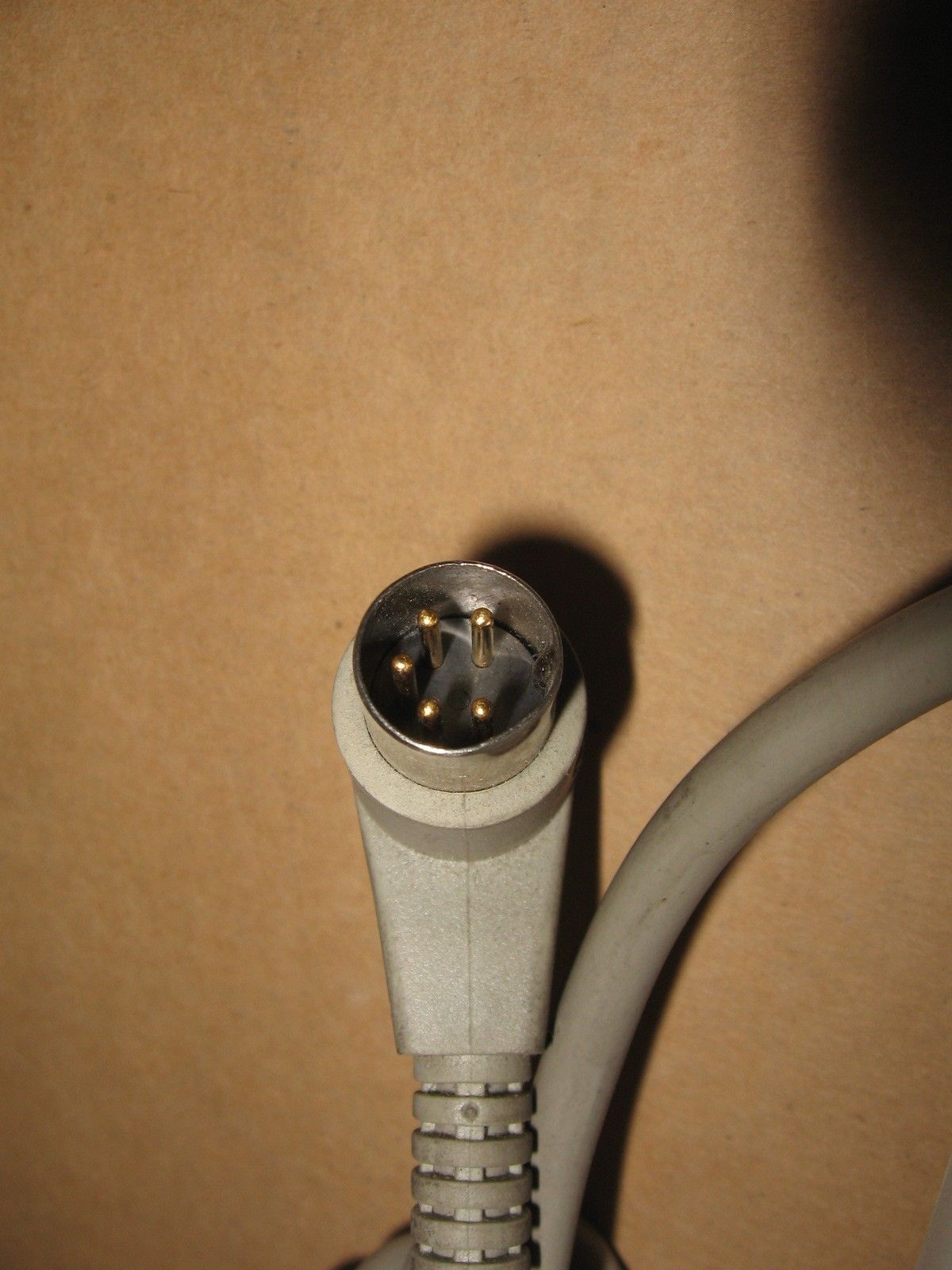

But the 1390702's plug is this variant:
Not the same. The pins are further apart than on XT/AT, covering more than 180º. The Wikipedia agrees that it's a DIN plug, but that's because there are many kinds.
So, what's it matter? Well, it's not intended to plug into an XT or AT socket. It could speak a different protocol. But there is at least a chance that this keyboard is XT or AT, in which case Soarer's converter would still talk to it if appropriately wired. Hooking it up would be a bit of a risk though: to a $16 Teensy more than the keyboard. This might just be the 122 key terminal that got away.

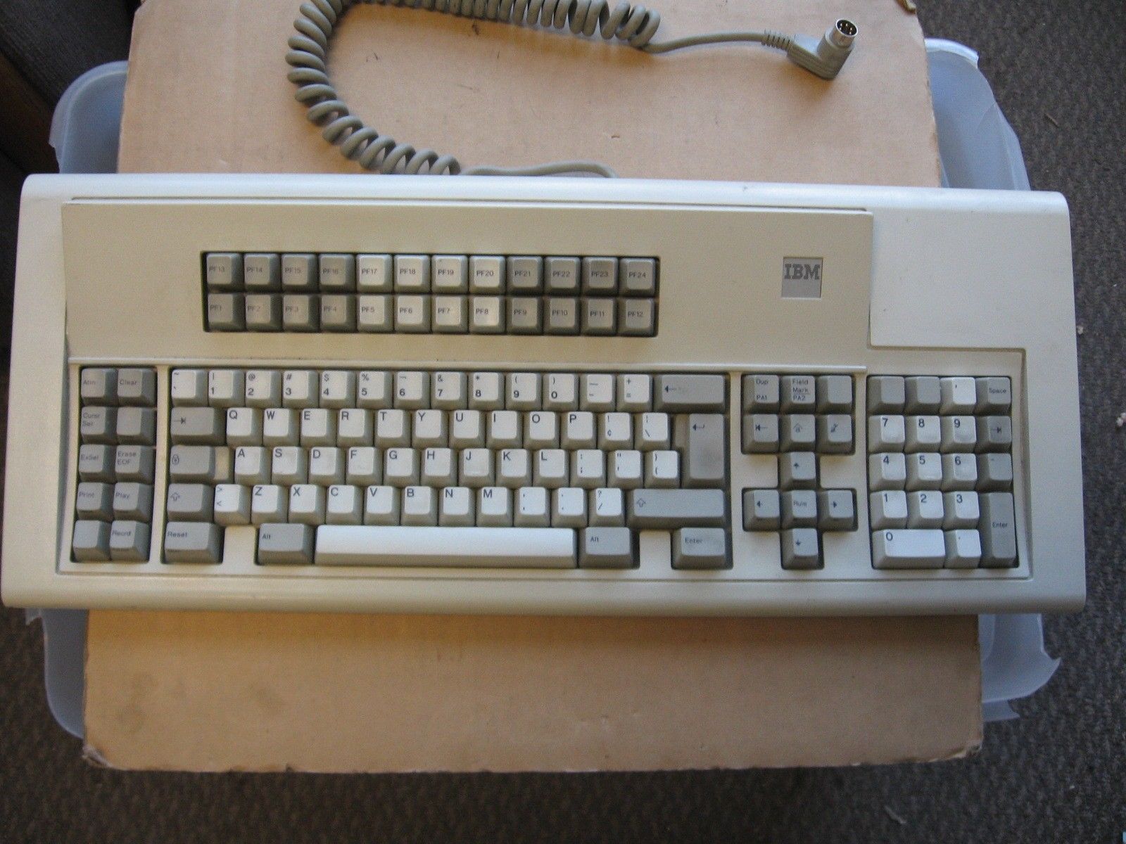

Here's my 122 key, by the way. In yellow sunlight (it's actually nice and neutral coloured like my other Ms) and in its original ISO layout:
It's one of the later versions. Note the shorter upper deck that only extends as far as the backspace key.
Actually, scratch that. I see the one I presume to be yours has a 1991 date on its label. Mine's from 1990. Oh IBM, did you ever not mess around?

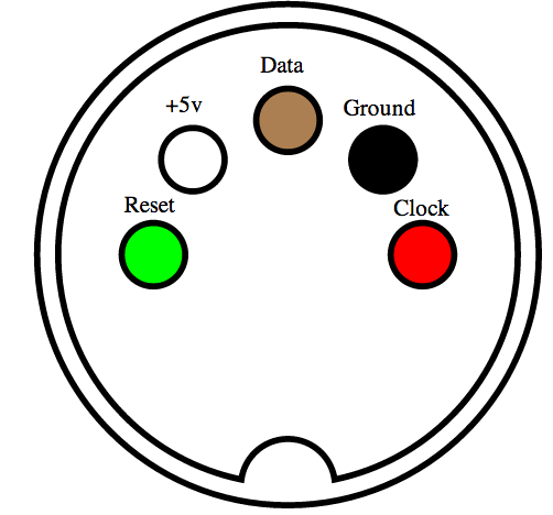

Yes, my DIN 5 is the 240-degree variety rather than the 180-degree as found in XT/AT connectors, which reportedly has the pin assignments shown below ("shield" is misspelled; the diagram is from a Japanese site):

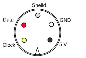

As compared to the pin assignments on a standard AT DIN 5 connector (with thanks to http://imgur.com/a/sHkz4):
Therefore, it appears that an adapter could be built easily, being mindful of the correct pin assignments. Does this mean that by using only an adapter and connecting to a computer with an AT to PS/2 converter that the keyboard would function? Does the addition of a Soarer Converter provide (1) the ability to convert the signal from AT or PS/2 to USB and (2) the ability to reprogram the keyboard?
A switch box like yours, perhaps with an additional 240-degree DIN 5 connector, would give me the ability to test keyboards, and I might want to install converters in them for possible resale. However, for my own use, I think I would want to stick with the IBM SSK, which has the best layout for the needs of my "day job". Someday, it would be fun to undertake a major conversion in order to have capacitive BS switches (as in a Model F) and an ANSI/HHKB layout.
06 Apr 2014, 17:17
rjrich wrote:Therefore, it appears that an adapter could be built easily, being mindful of the correct pin assignments. Does this mean that by using only an adapter and connecting to a computer with an AT to PS/2 converter that the keyboard would function? Does the addition of a Soarer Converter provide (1) the ability to convert the signal from AT or PS/2 to USB and (2) the ability to reprogram the keyboard?
I assume the keyboard speaks the IBM terminal protocol, so you'll definitely need Soarer's converter for that. Soarer's will do both of what you asked - it outputs directly to USB.

quantalume
06 Apr 2014, 18:41
rjrich wrote:Yes, my DIN 5 is the 240-degree variety rather than the 180-degree as found in XT/AT connectors, which reportedly has the pin assignments shown below ("shield" is misspelled; the diagram is from a Japanese site):
When I saw that diagram, I thought there must be a mistake. What electrical engineer in his right mind would use black for positive voltage? So I took my similar IBM terminal keyboard apart and traced the connections to the ICs on the controller board. Sure enough, black is positive. :roll: You should be safe hooking it up that way.
Thanks for corroborating this! It would be bad to reverse, e.g., ground and +5V.
