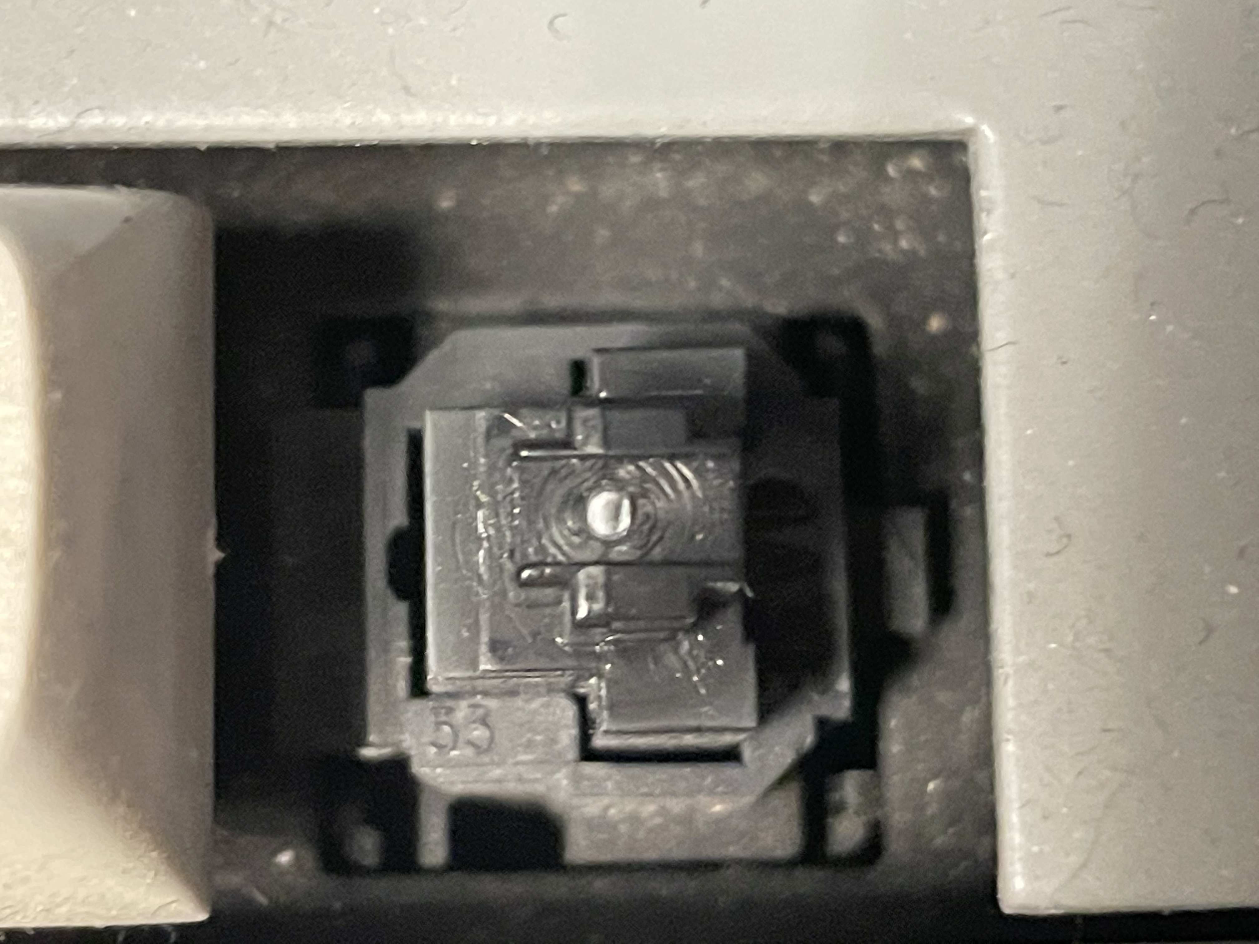

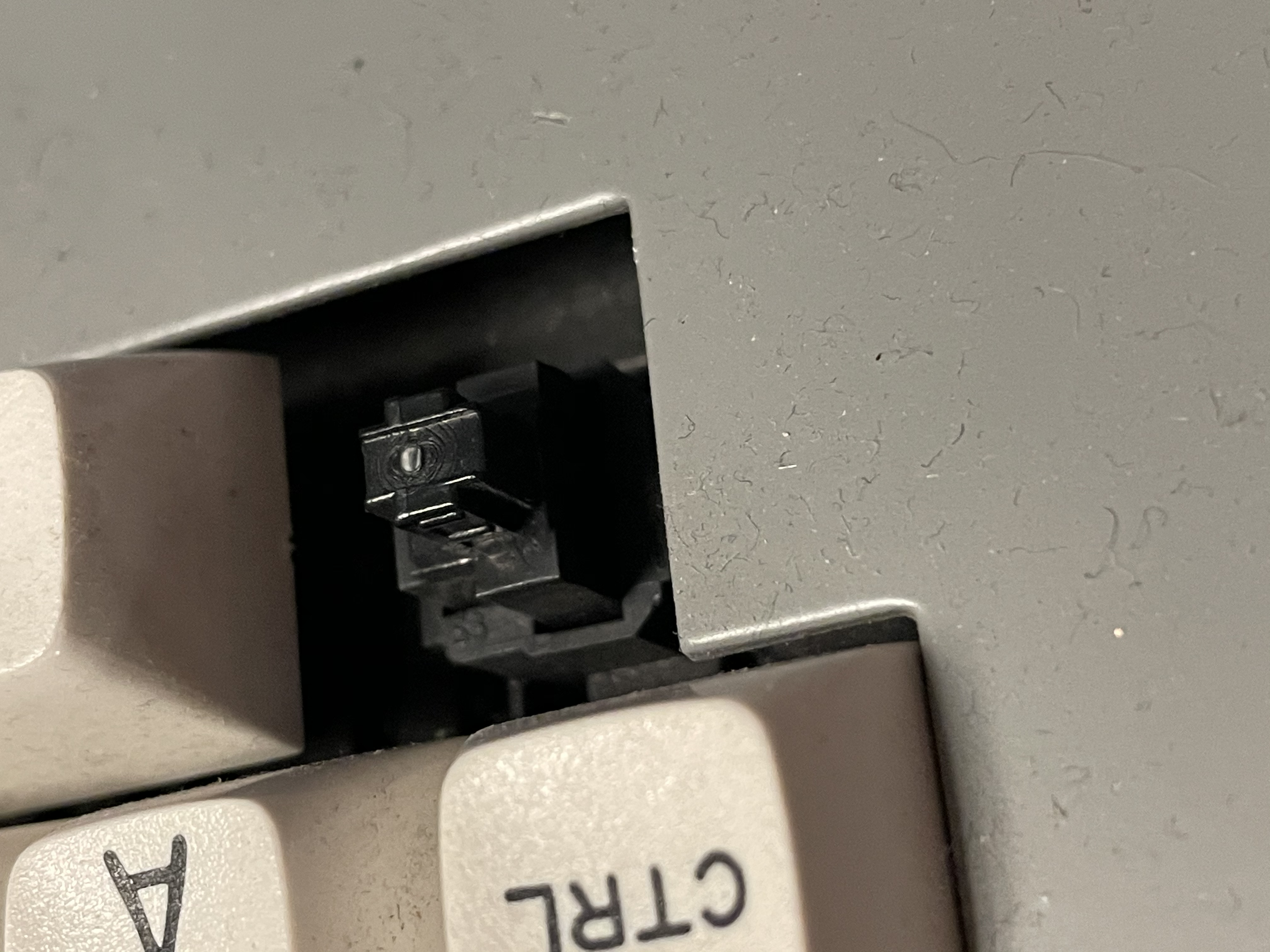

Wondering what kind of switch this is...
This is a Toshiba Satellite T series laptop. Externally in poor shape.

zrrion
24 Jan 2021, 09:04

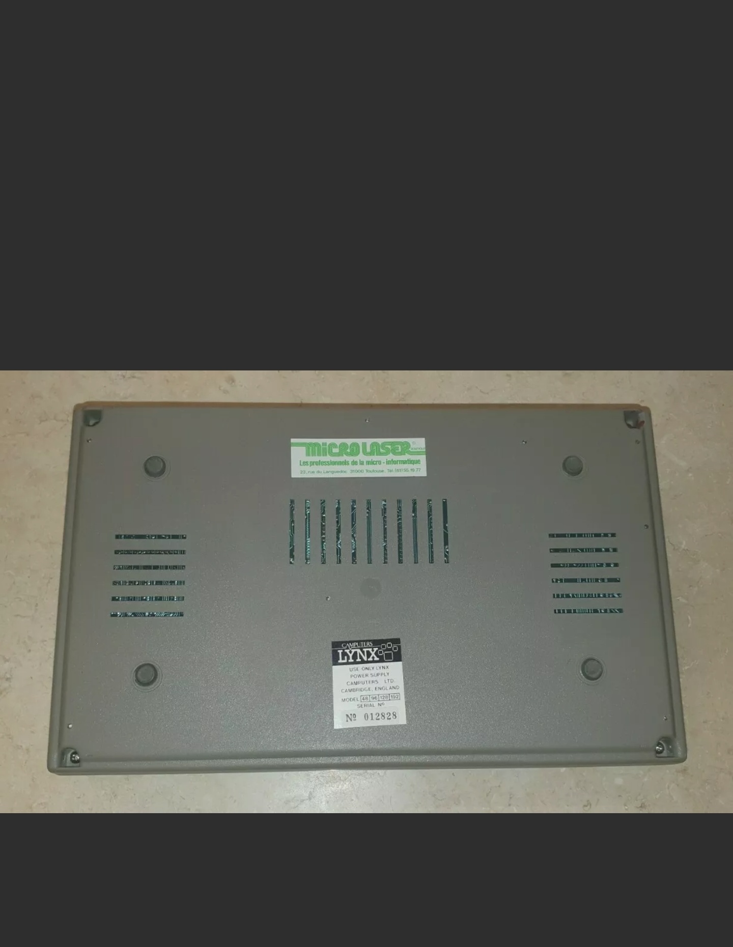

Lynx_Carpathica
10 Feb 2021, 20:17
Hi there.
What is this? I can seem to be able to identify it here: wiki/Switch_recognition
The dude says it's linear.
TNT
11 Feb 2021, 01:00
I'm not an expert, but it kinda looks like SMK- or NEC vintage linear with a different slider colour ...

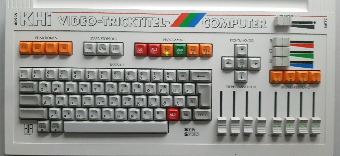

Hey found this two online and wanted to ask if anybody knows what switches they use :-)?
Thx!!

Lalaland124 wrote: 21 Feb 2021, 20:18 Hey found this two online and wanted to ask if anybody knows what switches they use :-)?
Thx!!
Considering the first one is german and also has spherical keycaps, I would say RAFI hall effect.

PlacaFromHell wrote: 22 Feb 2021, 00:23
Thx!!
Considering the position of the LED window, I would rather think it has Cherry M8 or M9 switches. I once had a video editing board with quite similar keycaps (except they were black on white).
