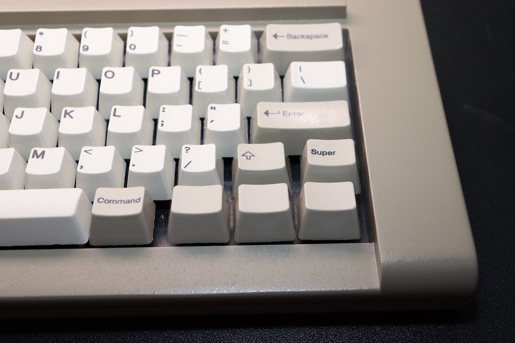

Just to complete my previous response ... the first attempt on the F62 looks quite nice, still working on the alignment, but here you go:

darkcruix wrote: 12 Feb 2021, 13:25 Just to complete my previous response ... the first attempt on the F62 looks quite nice, still working on the alignment, but here you go:
Nice. Extra points for the use of the shift symbol for 'up'.
darkcruix
12 Feb 2021, 16:08
clickclack wrote: 12 Feb 2021, 15:57
I have it configured to be shift by press+hold. If it is single pressed it is an arrow_up. Double-pressed and held is an arrow-up that is held down (like scrolling up continuously). Full functionality in one key :)
