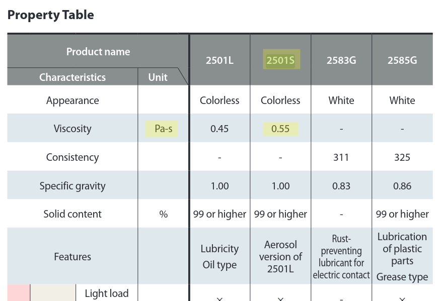

How come nobody is looking into the TB2501S?
Considering that 2583G cannot be found, feel as though it would be best to stick to Threebond as this was the known company for supplying the lube for Alps switches.
2500 series lube indicates on TB's website that "It prevents sulfurization and oxidation of electric contacts, and it stabilizes contact resistance at the contact point by preventing an increase in contact resistance due to periodic repetitive motion." <---- sounds pretty consistent with what an Alps switch needs, particularly around preventing contact resistance due to periodic repetitive motion.
Whats confusing however is that recent TB brochures indicate slide switch is not suitable for the 2501S, but the wayback machine indicates it is 'available' for light load slide switches, and conditionally available for medium load slide switches. 1855/1856 as others have mentioned indicates its for vehicles, so why are we even considering 1855/1856? From looking at my own collection of Alps switches, the lube seems to have been sprayed on. I orderd TB2501S to see how it performs. Unfortunately I don't have a perfect NOS Alps board, so will post results on video to gather other people's opinions.
I did find it interesting that 2501S is considered a contact rejuvenation/restoration lubricant. According to TB's brochure, the 2500 series is the only application with slider switch mentioned (page 75), the 1855/1856 does not. https://threebond.com/wp-content/upload ... -LOCAL.pdf
I plan to spray it on a pad and dab it with a paintbrush and lube accordingly.
NeK
26 Apr 2021, 12:36
Its (dynamic) viscocity is 0.55 Pa-s (Pascal per second), which it converts to 550 cP (CentiPoise). The greases that I am working with and are the only ones that do work have:
NyoGel 767A: Kinematic Viscosity 18185 cST (centiStoke) which with 0.87 Specific Gravity converts to (18185*0.87) = 15820,95 cP (CentiPoise)
OKS 477: Kinematic Viscosity 1600 cST (centiStoke) which with 0.87 Specific Gravity converts to (1600*0.87) = 1392 cP (CentiPoise)
550 cP is way too low to provide the necessary film strength that SKCM needs in order to overcome the binding and the stick-slip friction. So I am skeptical about it, I don't think that 2501s has any relation with the OG grease they used back then, but that's just my opinion. And nevertheless, ti would be great to try it and let us know the results. ;)

NeK wrote: 26 Apr 2021, 12:36 The greases that I am working with and are the only ones that do work have:
Forgive my bluntness here, but when you say 'and are the only ones that do work' <--- from my understanding its just you?
afaik, there is no data sheet for the original TB2581P that the TB employee indicated. The closest one to it he indicated is the 2583G, which is currently difficult to find from my understanding.
There could be some similarity, considering the use cases for it provided in the earlier post. as far as i can tell, the slide switch availability is only indicated for the 2500 series TB oil/spray/grease.
Based on the posts thus far, the Nyogel 760G seems to be working well for some (ymmv based on the lube job ;) ) as it is closest to what Nye Lubricants has in replacement of the 2583G (per post history). Until we can get ahold of the 2583G, the 760G should be the lube of choice. I'm making this conclusion based on the post history summarized below.
* TB2581P was the original lube used for alps switches.
* TB2581P no longer manufactured, TB employee indicated TB2583G is most compatible
* TB2583G cannot be found anywhere, until someone can source it
* Poster asked Nye Lubricants which would be closest to TB2583G. Employee/rep indicated Nyogel 760G is most similar (specs found here on page 75 https://threebond.com/wp-content/upload ... -LOCAL.pdf)
* Another poster indicated Shin Etsu G-501 could be similar to TB2583G, but unable to find conclusive evidence, unless I'm missing something here. G-501 is also used as a 'sound dampener.' TB 2500 series lube "reduces contact resistance, thereby preventing noise and abrasion from sliding (scratching?), and has a cleaning effect that can remove adsorbates and wear debris attached to the contact surfaces'
* Until someone sources a complete data sheet for the TB2581P, we will never know the exact formula for the original alps switch lube. Maybe it is a trade secret after all, as even the TB2583G is lacking technical information.

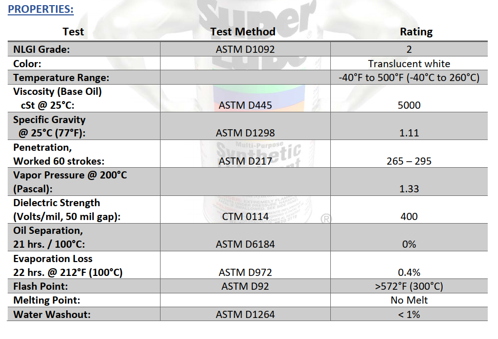

Ok I know this sounds like a normie suggestion but take a look at Super Lube® Silicone Lubricating Grease with Syncolon®
Captura de pantalla 2021-04-27 190301.png (206.82 KiB) Viewed 10351 times
Grade 2, super duper viscous, and complemented PTFE
Technical_Data_Sheet_Silicone_Lubricating_Grease.pdf
(216.36 KiB) Downloaded 278 times

andresteare wrote: 28 Apr 2021, 01:09 Ok I know this sounds like a normie suggestion but take a look at Super Lube® Silicone Lubricating Grease with Syncolon®
5000cst at 25c seems pretty good. At 40c would be lower of course but probably more than 1500cst. And it is plastic safe. It doesn't explicitly state what the base oil and thickener is, but according to wikipedia, silicon grases usually have a silicone base oil with Silica thickener and this one also has some additional PTFE added in for good measure.
It seems that it will work very well. The problem that I find is that, silicon oil cannot be mixed with PAO. In other words it doesnt mix with the NyoGel 767A.
But who knows, it may work for our use case. Worth a try if it is cheap.
Update: what I think that will work well and without having to mix it with anything else, are other NyoGel products. Particularly the 774H or VH 774 (updated). In paper they seem to me that they will be excellent. They are Silica thickener with PAO base oil with the right viscosity. But in europe they are super expensive and I am not willing to shell out that much to try it.

andresteare
28 Apr 2021, 05:53
NeK wrote: 28 Apr 2021, 05:39
I'm aware that PAO cannot be mixed with silicone, but maybe with a silicone based dampener I guess? Maybe mixed with some cheap really thick dielectric grease for dampening effects, pretty sure most of them are silicone based, I don't have SKCM switches to test

28 Apr 2021, 14:23
I've got a tube of this already for lubing stabs with. I'll give it a whirl on some switches later.
andresteare
28 Apr 2021, 15:41
headphone_jack wrote: 28 Apr 2021, 14:23
Great! If it binds try a mix with some thicker dielectric grease, or any sort of silicone based dampener
