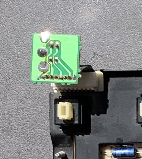

The two ADB ports are their own separate modules. One can be broken and the keyboard can still work fine. They both run wires inside down to the main PCB.

True. Breaking one of those ports isn't as catastrophic as on a keyboard with just one port; but it's still not ideal!
Can't remember if the daughterboards are identical or mirror imaged. It's been a while. They are at least very similar.

Muirium wrote: 13 Apr 2021, 13:41 Can't remember if the daughterboards are identical or mirror imaged. It's been a while. They are at least very similar.
I’ve checked with the pictures of the cleaning of my AEK II. The daughterboards aren’t identical.
