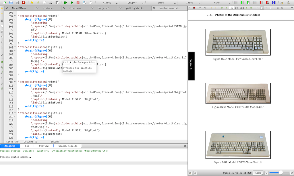

I wanted to give a quick update on the status of the Technical Manual.
After chatting with Zed (who's ideas and work I value so much), I dissected the LaTeX document and started to do a small rebuild of what we have so far.
I have not only segregated the sections into different files, I also did the same for the figures and photos.
Furthermore, I segregated two variants of the Manual:
The Print version will use the original IBM design with rotated pages, tables, or graphics. The size of the photos is normally full size in best quality including color profile.
Within the latex typesetting files I am using a processifversion detection, so it will automatically produce the versions needed. All within the single project.
- Digital
% Define which version should be produced Digital or Print
% Options in the typesetting docs are:
% \processifversion{Print}{Hello Print Version!}
% or
% \processifversion{Digital}{Hello Digital Version!}
\excludeversion{Print}
\includeversion{Digital}

I am in the process to move the site to a different cloud space. Unfortunately, I had to stop in the middle for a week or so. I have uploaded the actual version to this temporary link for now: http://195.90.200.37/ModelFManual.pdfj-pevar wrote: 11 Nov 2022, 10:54 I'd love to be able to check out the website (bucklingspring.com) and the manual, but I get an error anytime I try. Has anyone else here run into this issue and if so, what's the work-around.
Thanks!
