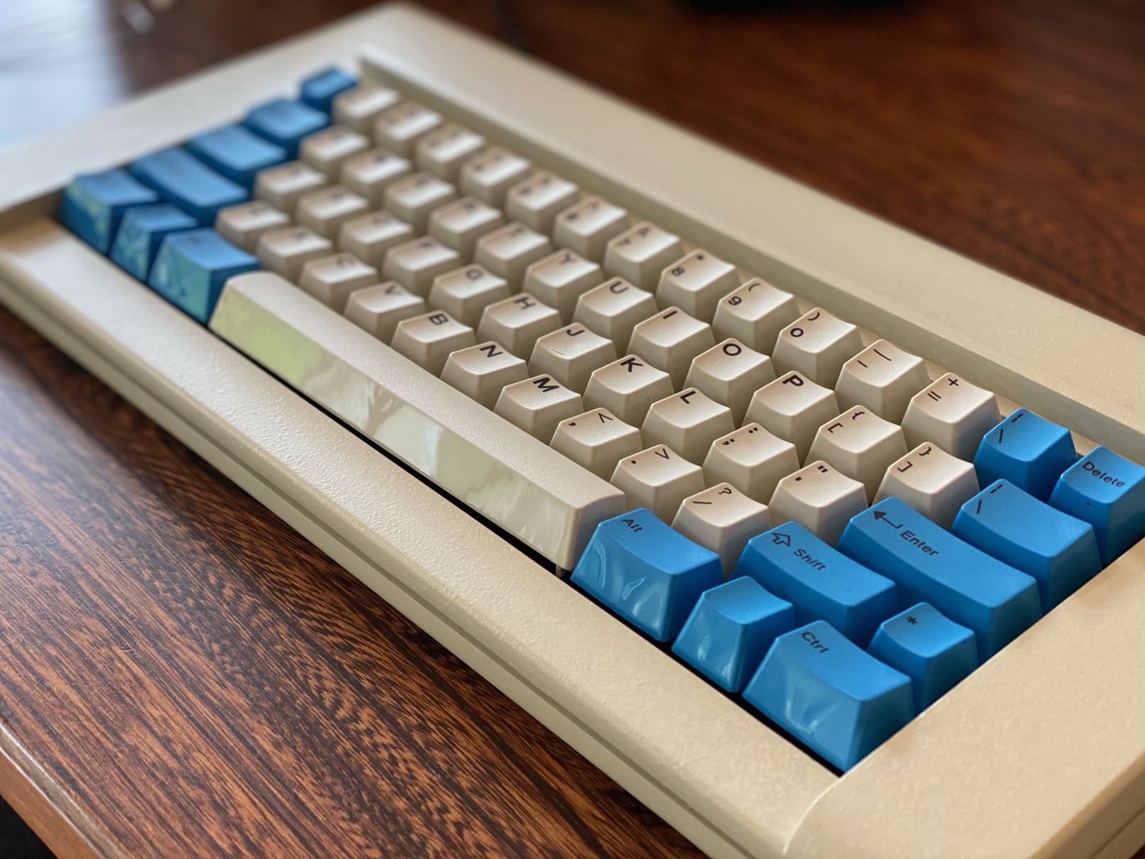

I also wanted to share with permission another great customer image. This one shows the pearl keys and Industrial SSK Blue keys:
pearl and blue.jpg (404.08 KiB) Viewed 13143 times

Ellipse wrote: 14 Jul 2021, 01:56 I also wanted to share with permission another great customer image. This one shows the pearl keys and Industrial SSK Blue keys:
man thats pretty... If i didnt need the arrow keys so much at home i'd totally have gotten the 62 key hhkb...
This looks fantastic. These keyboards are a bit difficult to properly capture the textures in photos. So far, this is one of my favorite photos, as it really captures the feel of seeing it in person.
I'm typing this on my F77 that arrived several months ago, still with my 15 years used Model M keys. It feels just as good as the day it arrived, and the worn keys really give it that 'old friend' feel. I'm salivating at how great the new keys will be, and I'm happy to wait for them. I was one of the wierdos who ordered custom keys with homing bumps, it's going to be a perfectly customized experience.
I'm not sure if it helps the impatient, but Ellipse was able to send my second F77 more quickly than expected when I switched my order from the nav cluster to the numpad, like my first F77. I'm guessing this meant he didn't need to flash a different firmware, so the board was able to ship with less work for him. That's just me speculating, I could be totally wrong.
No matter what, I'm elated to be typing on this incredible machine, and I'm extremely grateful for him following through with this project to the absolute best of his abilities. It's an act of passion that obviously consumed much more of his effort than originally intended. I'm going to be proud of using these keyboards for years, hopefully decades.
And you know what? If I was rich as heck, I'd buy his $4k spacesaver just to show him how much I love these model F's. I'd probably never open it, and never get my money back on it, but I wouldn't care because I was throwing rich guy money at what I like. Somebody just paid around 1.5 million for a mint, unopened copy of Super Mario 64. That's the collection business; It's based on passion, revolves around disposable income, makes no logical sense, and everybody in the business is hoping for a rich guy to walk in and make it your lucky day.

Several of the springs in my F62 (the ones that felt softer) and some of the springs included in the bag of 77 that I ordered are slightly damaged. Is this happening in transit or is this happening during production?
The pearl spacebar has some kind of flashing defect on the inside of the stem, which is what was causing the roughness. I can't really use it so that pearl set is as good as useless for now. I'm using the black set I ordered, which doesn't appear to have the defects (and doesn't feel as bad as the black set I ordered with my F77 two years ago)
The assembly isn't "happy" and the plates are fighting apart. This is despite opening it, ensuring all tabs were straight and even adding a bit of curvature to the barrel frame (which was unevenly curved without me touching it). Model F plates should conform to their curvature, even when thick replacement foam mats force them apart. With the case screws tightened normally (not overtightened), this is somewhat remedied, although it shouldn't be the case. What's going on here?
I did notice the new barrels are much shinier and more slippery in texture than the older ones from my F77, as well as original Models F.

Wazrach wrote: 19 Jul 2021, 22:36 Several of the springs … are slightly damaged.
Can you post a pic of a damaged spring?

Pete wrote: 20 Jul 2021, 01:06
I have updated my post. I'm not imagining it, am I? This can't be normal. I've looked at many good condition Model Fs and the springs aren't like this.
Pete
20 Jul 2021, 12:04
Wazrach wrote: 20 Jul 2021, 10:16
You have the same colour case as me :)
I’m attaching pics of my springs. Do they look a bit straighter maybe?
Wazrach
20 Jul 2021, 19:49
Pete wrote: 20 Jul 2021, 12:04
I do love the case, it's so gorgeous. Yeah, your springs look straighter than mine. I was still able to fill my F62 with mostly straight springs, but it's still worrying.
I tweaked the tabs some more and quietened the spacebar a little bit. The keyboard is now closer to perfection. I think the keys will become smoother with a bit more use. My theory for why they're rougher is because there is less play compared to original Model F keycaps.
