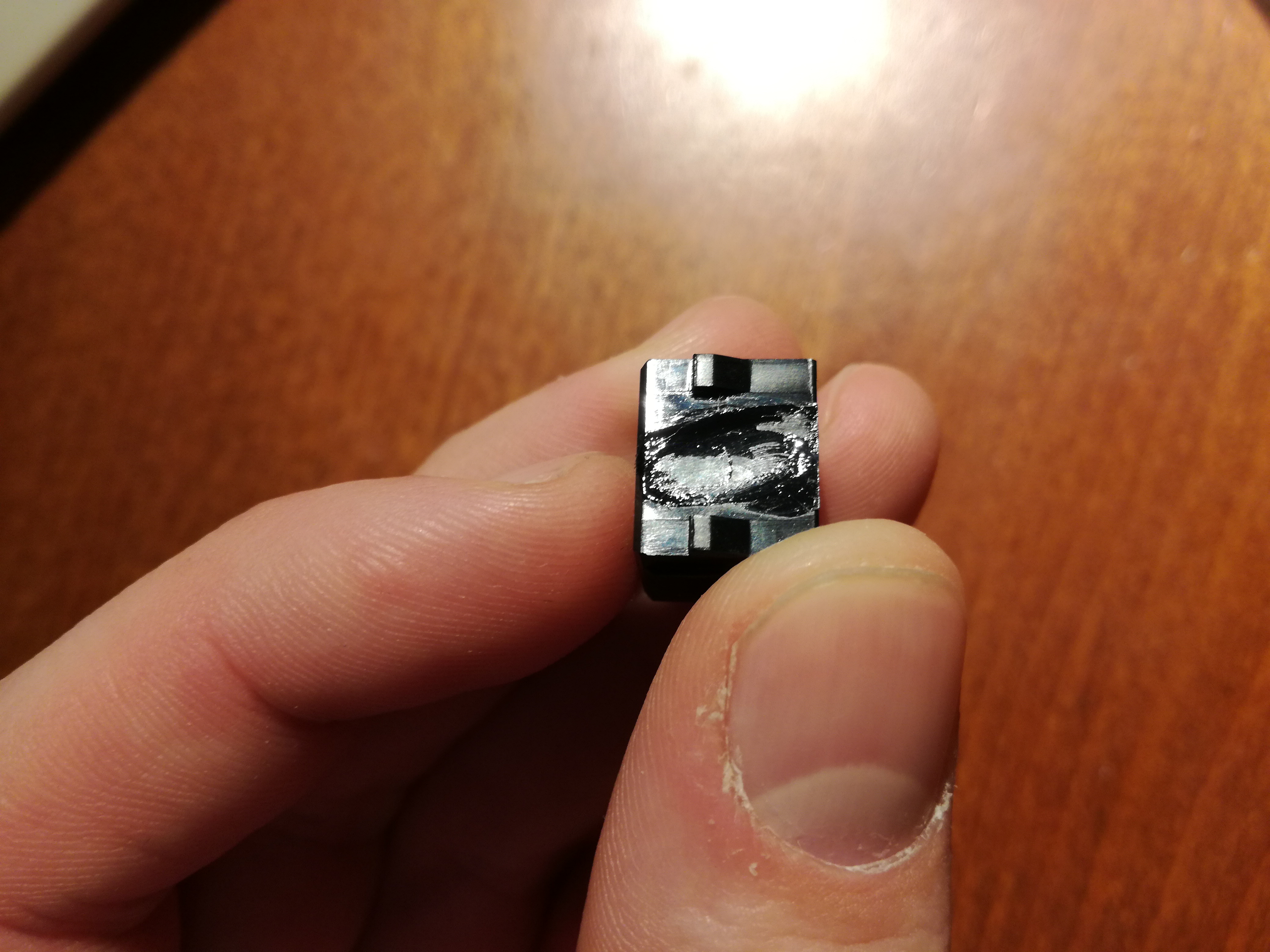

Just one bit of the video I wanted to mention. At one point, you say that Alps SKCM/SKCL housings are made from ABS, but that is certainly not the case as I've tested a housing with an acetone swab as well as (after watching the video, to be sure) soaking a housing in acetone for an entire day.
Both tests resulted in no damage at all. No melted plastic or dye on the swab, and no puddle of plastic goop from soaking. I would guess they're nylon, but whatever they may be, they're certainly not ABS.

Interesting, are these the black housings or the dark blue ones?

Chyros wrote: 03 Apr 2019, 10:24 Interesting, are these the black housings or the dark blue ones?
I've tested on both and end up with the same results without any reaction. Where did you you get your data regarding their construction being of ABS? :o

Both Alan (a former Alps employee who assembled AKCL/SKCM boards) and Steve (vice president of Matias) said they were. I'm also sure I had the discussion a long time ago with someone who mentioned that their housings melted in acetone (at the time I DIDN'T think they were ABS). Pretty sure I tested it myself at that point too. I'll have a look myself at a later point.

Chyros wrote: 03 Apr 2019, 13:17 Both Alan (a former Alps employee who assembled AKCL/SKCM boards) and Steve (vice president of Matias) said they were. I'm also sure I had the discussion a long time ago with someone who mentioned that their housings melted in acetone (at the time I DIDN'T think they were ABS). Pretty sure I tested it myself at that point too. I'll have a look myself at a later point.
I can take a video for you if you don't find my word credible, haha. :) I can assure you, neither of the housings melted. Top or bottom.
I do recall you saying that they weren't ABS at one point, which is why I was a bit surprised when that changed. IIRC, you said they were nylon in the past.

Oh I absolutely believe you, and yeah, I DID think they were nylon in the past, until, as I mentioned, several people corrected me. But now that seems to be dubious xD .
Not sure if all ABS compositions are sensitive to acetone, but tbh I think they should be. Regardless, I'll try.
P.S. when you say "acetone", do you mean actual acetone (tech, PA, chrom etc.), or nail polish remover or some other formulation?
EDIT: it seems it was Andrewjoy that reported his housings melted in acetone, so I'm definitely not imagining things xD . That's good - I already feel close to the brink of insanity as it is xD . I'll have a look myself when I have a second :) .

Oh no, like hardware store acetone, not nail polish remover.
Yeah, it seems like a good idea to have multiple people testing this. I mean, I've had some melt from heat - from a heat gun.
Maybe some clones or perhaps forward electronics produced housings or something? It would be interesting to get to the bottom of this. Reminds me of how some Model Ms have ABS space bars and even ABS cases on rare occasions. I think the ABS space bars were more common from the Irish plant iirc.

Well, it would appear both statements are true xD . Complicated Alps don't dissolve, simplified do xD . Only the top housings, though. Tested on; SKBM white, SKCL Yellow pine

Chyros wrote: 06 Apr 2019, 15:22 Well, it would appear both statements are true xD . Complicated Alps don't dissolve, simplified do xD . Only the top housings, though. Tested on; SKBM white, SKCL Yellow pine
Now we need to try pine vs bamboo.
Maybe they changed materials when removing the slits?

Well, I got this board for the cost of shipping, with the keycaps too. I can assure you, the housings are absolutely unusable. Definitely made out of ABS, at least for dampened white switches. So it seems that the top housings for bamboo switches are made out of ABS.
