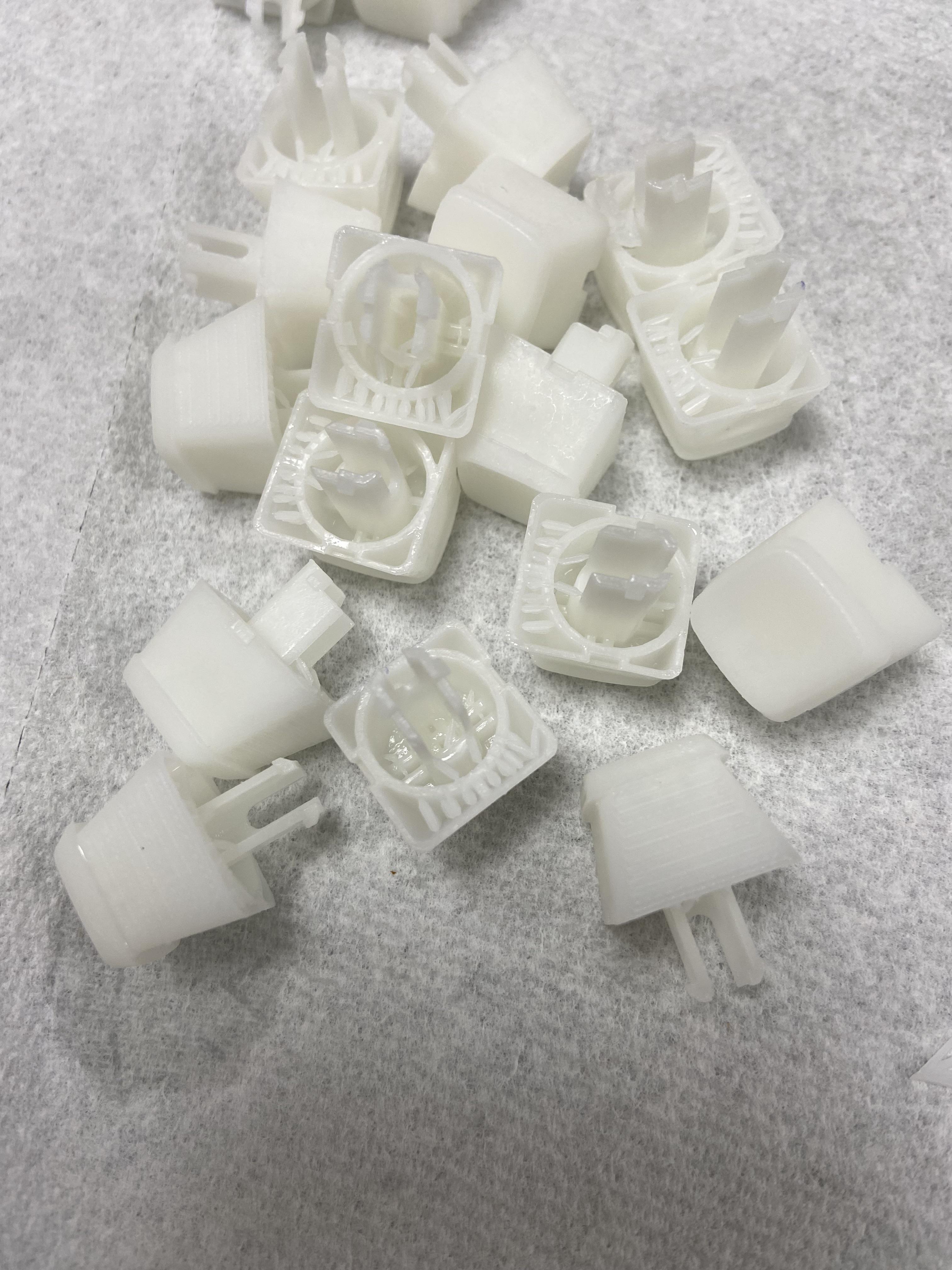

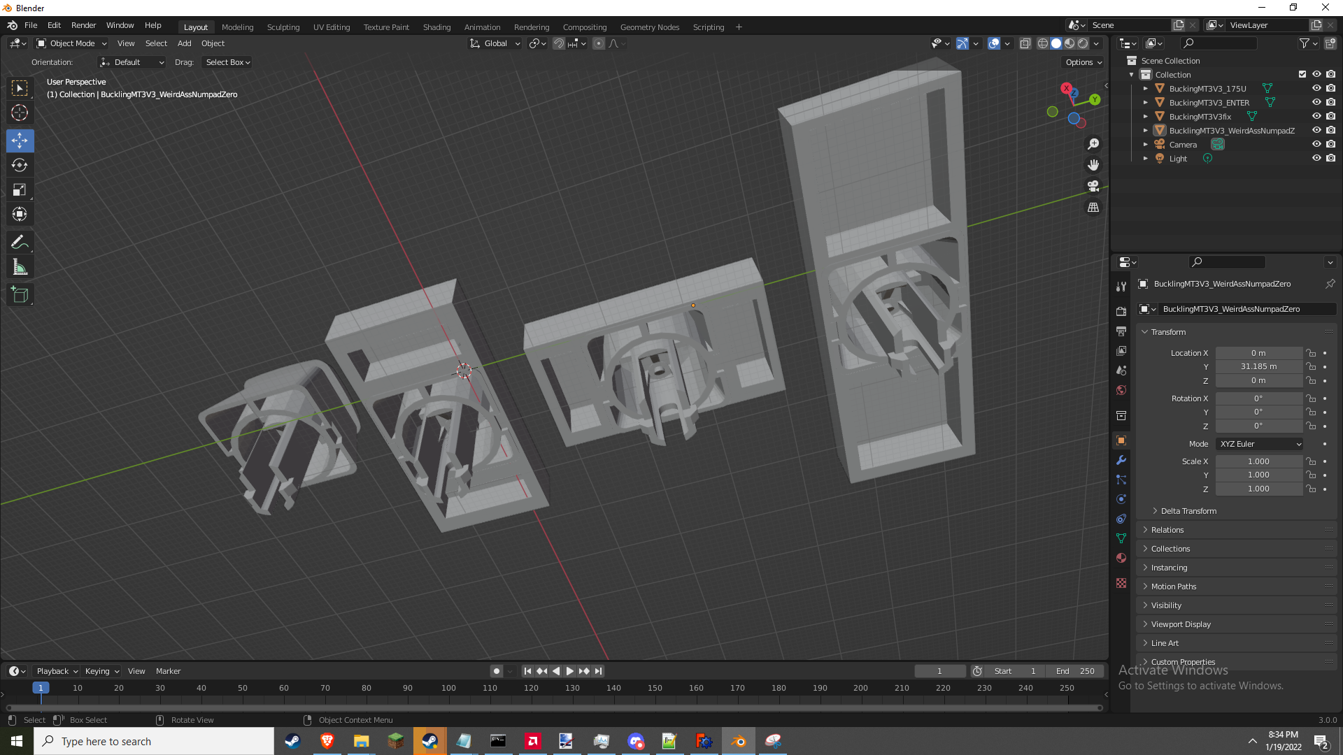

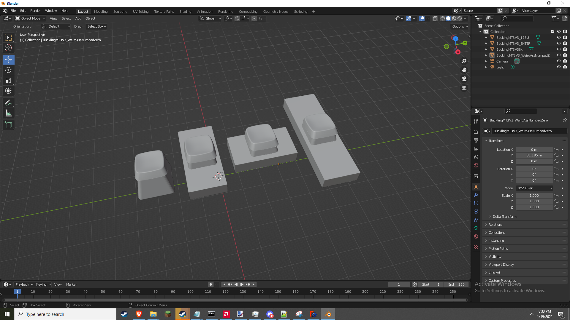

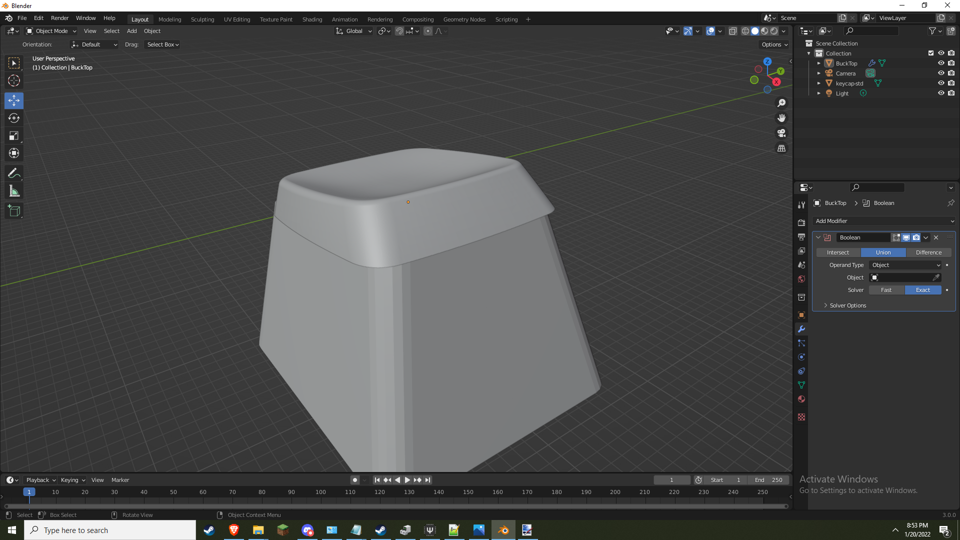

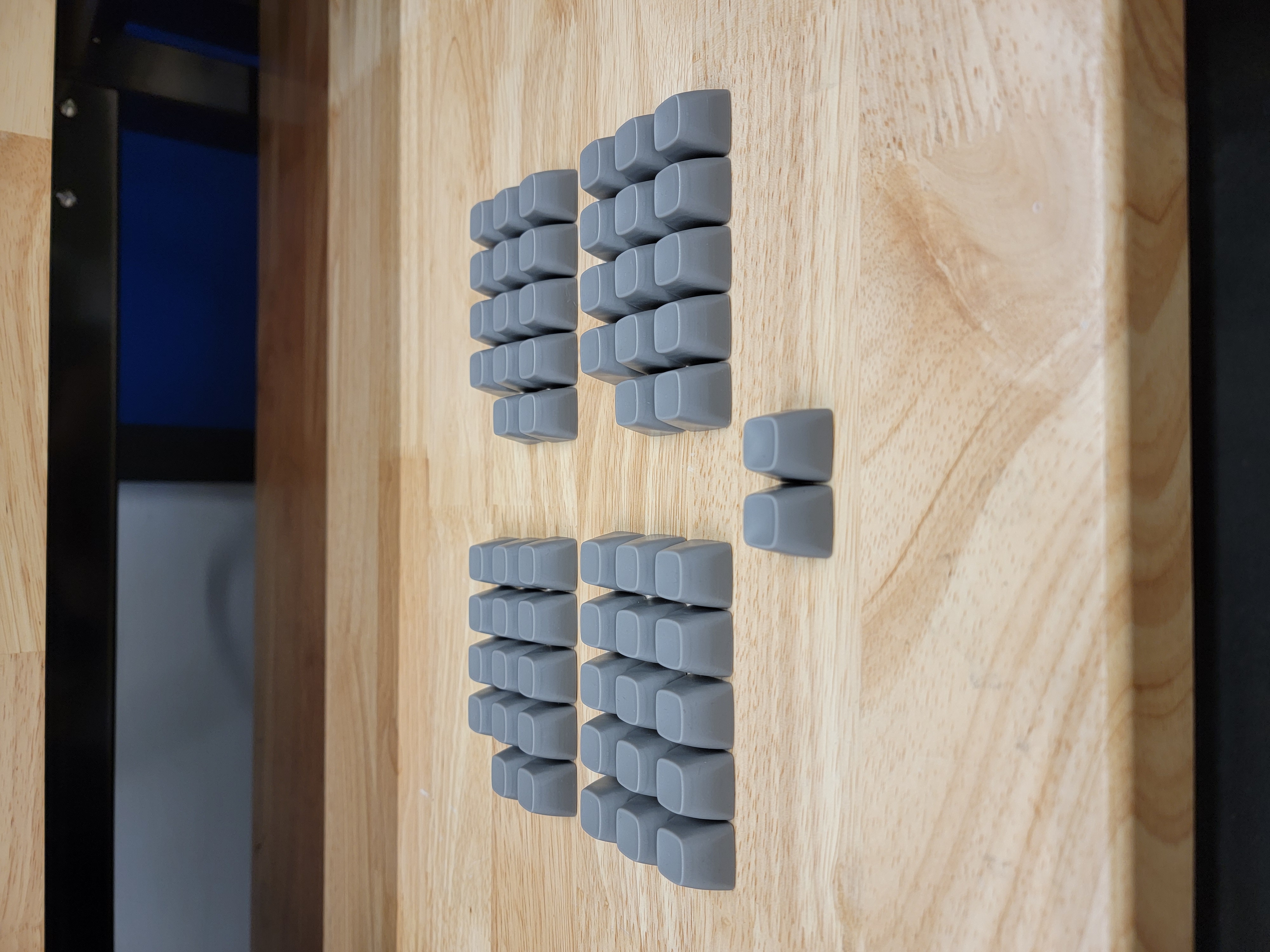

So i got to type on a selectric for the first time and i really loved the keycaps, but with buckling springs theres really only 1 profile so i had to get working in blender (With some people that can do CAD to fix bad stuff in the model). While it may look a bit crude, my attemps at making it look good have failed spectacularly. The base of the model comes from jaseg's buckling spring stl and it was some 20s typewriter buckling spring keycap i used for the thing that the spring sits in (These were designed with the Model F XT in mind so it is unknown if some of these keycaps will fit onto a model m) As of right now, these are untested. EDIT: Someone has offered to redesign the top part of the 2 piece keycap

Issue with prototype where the part where the spring sits is missing

These will 100% feel scratchy and awful at the resolution you've printed them at. Filament printing, even at its best, really can't do the "grain" you would need to get a smooth switch, even with monstrous amounts of lube applied. Hell, I doubt resin printing could get a high enough resolution to make these feel anything close to the original. The key tops are also very sloppy, you need to adjust the angle of the bottom piece to be flush with the dish at the top. But without injection molding (which would cost thousands) these aren't really that useful.

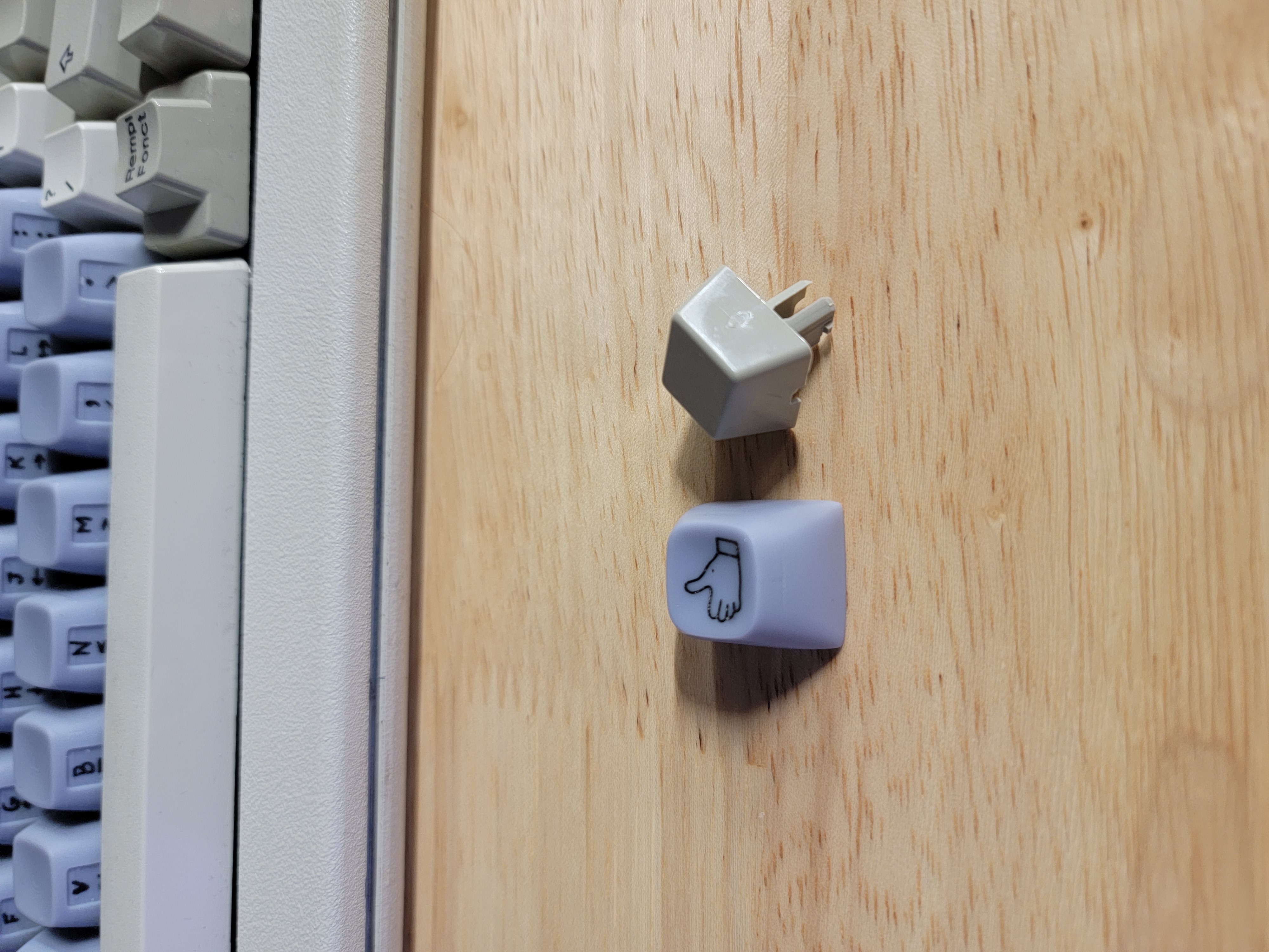

Have thought about grafting selectric caps as a possible solution. I think by hand could work even if tedious. Today's adhesives, some of them are amazing. I don't think that would be your main issue with this method.

Joining dissimilar material should be easy, one would think, with modern adhesives. Get your smooth half from originally mold cast IBM pieces, then put your finger interactive half from the old type writers on top.

Another approach might be to utilize buckling spring two piece caps and just print some tops with your desired profile.

Seems thats the only option as the prototype (even without the thing where the spring sits) is way too hard to push up and down and is not smooth at all (Even without the spring in the barrel!) as someone else in this thread said

Is your goal now to make white, spherical, blank outer shells? That's about all you can do with 3D-printing.

Yeah, i guess if you want to do sublimation you have to do that yourself

UPDATE: Turns out ThermometerSandwich actually did their own take on it, albeit still prototyping

ThermometerSandwich
26 Jan 2022, 17:36

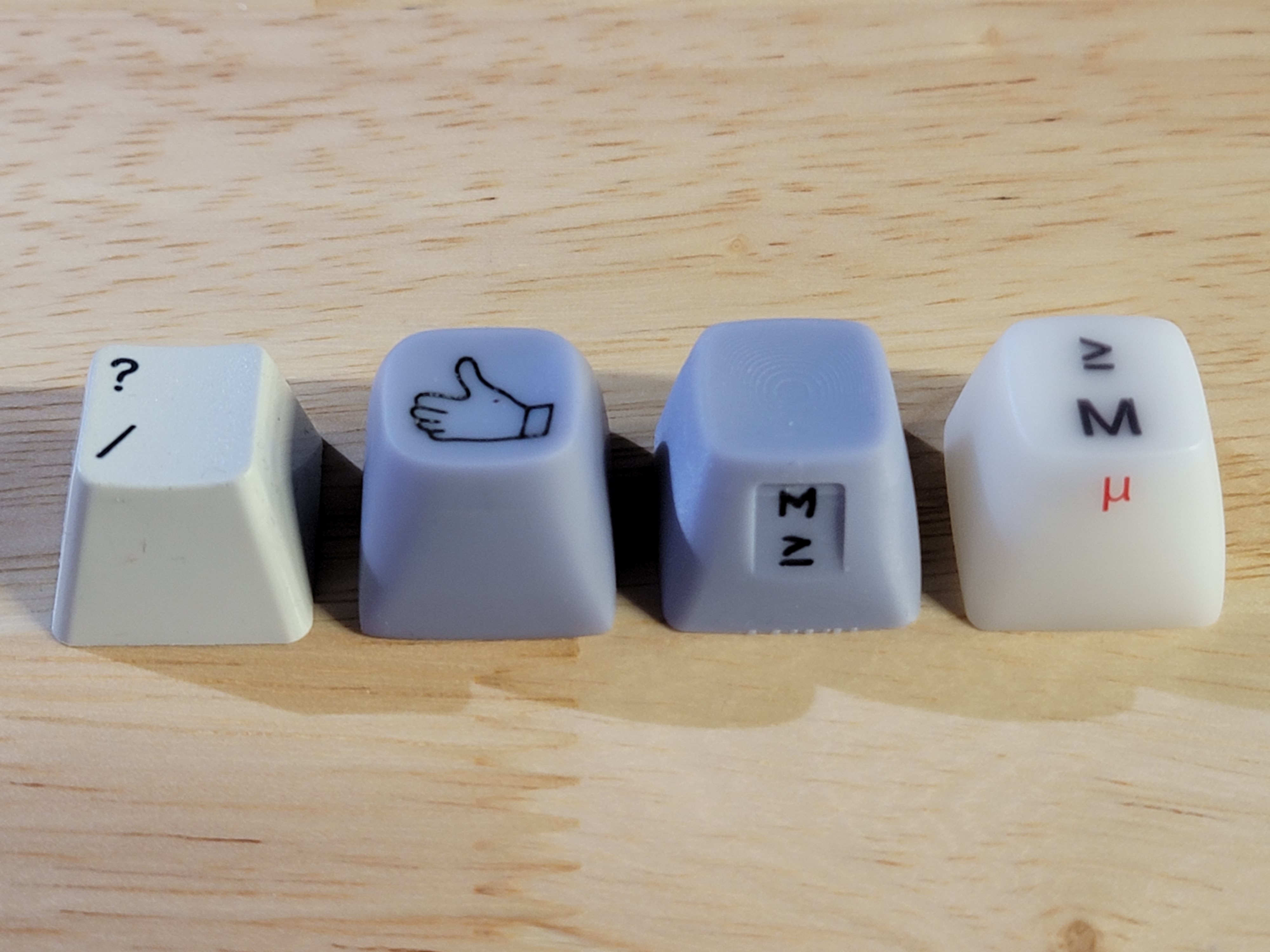

Thanks for the shout-out vyquad! :D
Great work on your caps btw! I'm still amazed at how well those stems came out.
I plan on making a larger build log post in the Workshop about this topic in the next couple weeks. So, I suppose this is kind of a teaser trailer ;)
From left to right:
  • OG Model M/F keycap
  • My first infill test on a resin print with black CA glue (lesson learned: don't use CA glue for infill...)
  • Profile test with Sharpie legend. I quickly printed a set of alphas like this just to try out for a while to make sure I was happy with the dish shape. Okay, so I may have printed several sets until I was happy with the shape... This was printed at a bit too high of a layer height (0.05 mm I think).
  • Proof of concept of a "Triple Shot" keycap using the same type of UV resin as the print itself.
Muirium wrote: 26 Jan 2022, 10:28 Wonder if the 👍 is ⚡️ engraved?
For the 👍 and ≥M, the caps were printed with little voids for the legends. The 👍 legend was filled with black CA glue, then sanded a bit. This didn't turn out super well. For the ≥M, I used the same UV resin as the print itself with pigment added. I poured a little resin into the voids, then put clear tape over the uncured resin to shape it. I cured it by shining a UV laser through the tape. After removing the tape, a little sanding cleaned it up pretty quickly. I meant for the main legend to be black, but I definitely didn't add enough pigment to the resin, so grey it is. Other than the color issue, I'm pretty happy with the results.
I thought about CNC milling the legends, but I think the prints came out well enough when printed at 0.02 mm or so. Also, I'm way too lazy to do the tool-pathing for ≥107 different legends.
