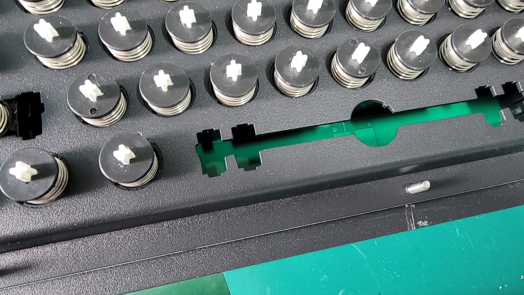

I bought two round 1 boards. I thought the round 2 prototype was hideous, but these renders are starting to grow on me. Depending on how much I like the round 1 board and after seeing an actual production round 2 board, I may buy one round 2 board, still have not decided yet.

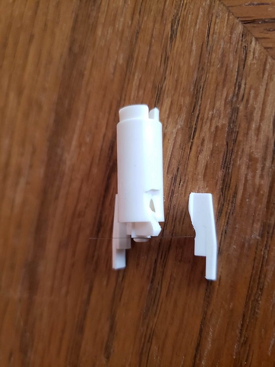

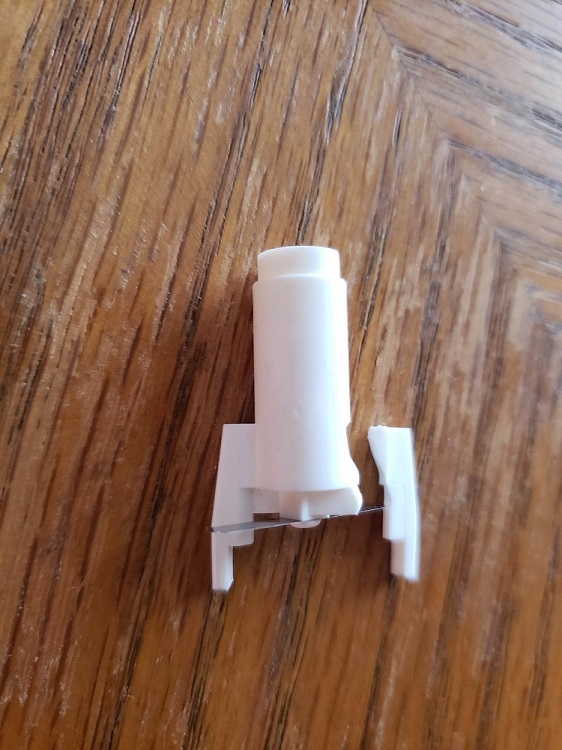

@Ellipse. Are the R1 switch stem legs prone to breakage during shipping or from mounting keycaps with too much force? It's rare but I've seen the legs break off during shipping and noticed the compact R1 stems have less material to reinforce the stem legs (less material relative to IBM stems).

Mods: This needs a NSFW tagtron wrote: 15 Feb 2023, 17:50 @Ellipse. Are the R1 switch stem legs prone to breakage during shipping or from mounting keycaps with too much force? It's rare but I've seen the legs break off during shipping and noticed the compact R1 stems have less material to reinforce the stem legs (less material relative to IBM stems).

@JP! I didn’t mean for the post to come off as inflammatory, the stem legs are easy to fix with super glue. I’m just curious if the stem leg breakage I've experienced is primarily due to old/brittle plastic or a potential issue with shipping any beamspring keyboard.JP! wrote: 15 Feb 2023, 18:19Mods: This needs a NSFW tagtron wrote: 15 Feb 2023, 17:50 @Ellipse. Are the R1 switch stem legs prone to breakage during shipping or from mounting keycaps with too much force? It's rare but I've seen the legs break off during shipping and noticed the compact R1 stems have less material to reinforce the stem legs (less material relative to IBM stems).![]()

Ignore me. It was just in jest. Normally for this level of gore it's best to a have a "viewer discretion is advised" disclaimer. I'm sure the 40+ year old plastic isn't as robust as it once was but my thoughts are for this sort of damage to occur that either it was not packaged adequately, was abused in transit, or combination of both.

Yes, I know of at least one example where a leg ("beam barrel part B" - the white color plastic part) broke off in shipping while installed in a module, so it can definitely happen to both original and reproduction beam spring keyboards. I show this particular example in the beam spring setup video posted some weeks ago.
The roughness of shipping in recent years is one main reason why each beam spring keyboard is getting free modules as part of the mini first aid kit for beam spring keyboards, plus I replace broken modules under the limited warranty as described on the product page.

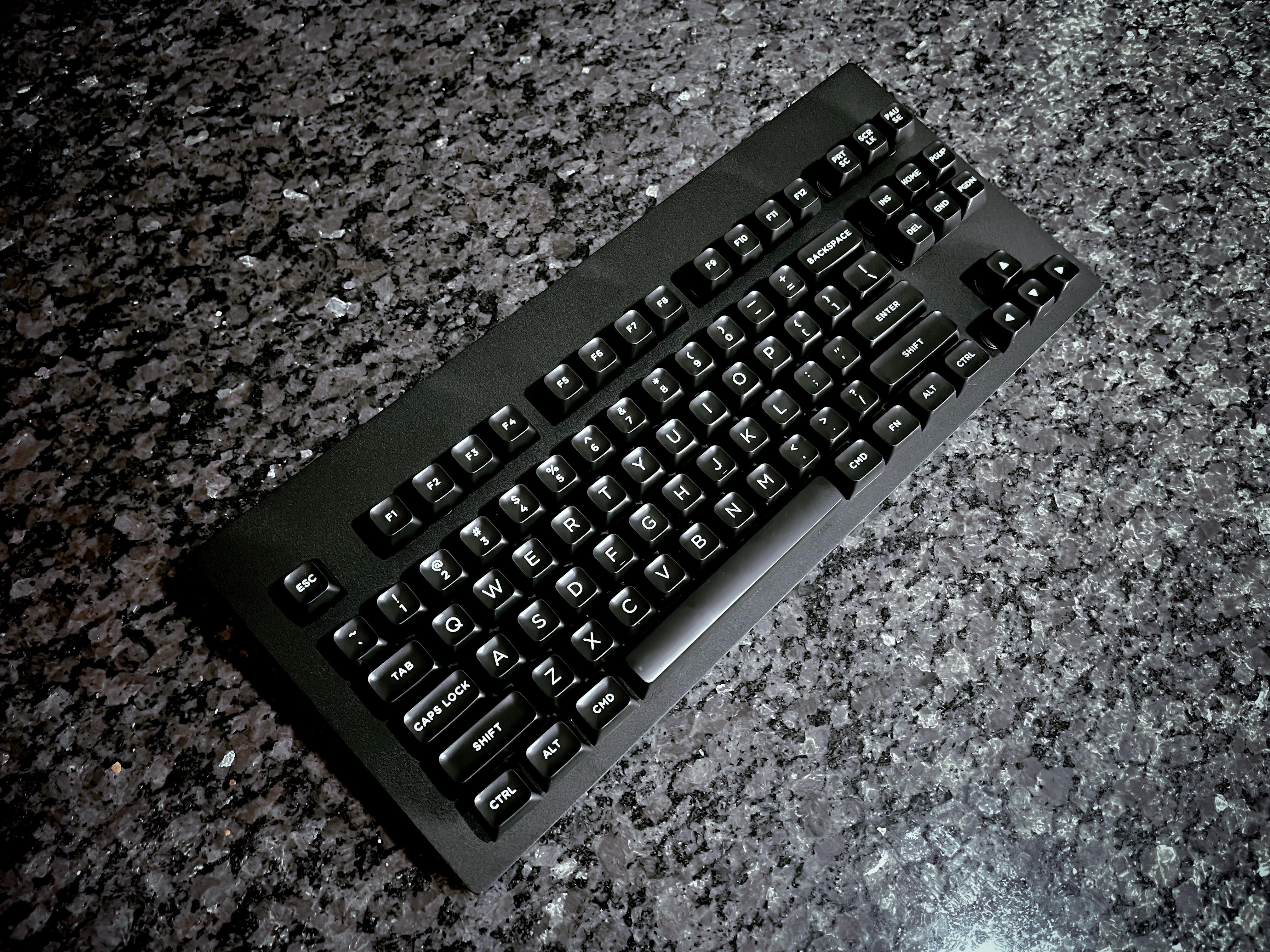

The custom double shot PBT set with all black keycaps and white text came out nicely - this is the finalized production set (the prior set had additional sample keys not part of the set, as noted earlier):
This set is available separately in the shop for other MX keyboards as it is a standard Cherry MX compatible set.

I'd love to know that as well.
Also, is that an existing profile (which one?) or if it's a new one - have you named it?
Ellipse
As noted earlier the keys are a custom profile not in line with any standard MX keycap profile. As shown in the photos the keys are quite flat relative to each other but do vary slightly in row height, from about 9.5 to 11.5mm from what I can see. So I guess they would be called very slightly sculpted? You can see the relative key heights in these photos of the keys installed on a new beam round 1 board:
