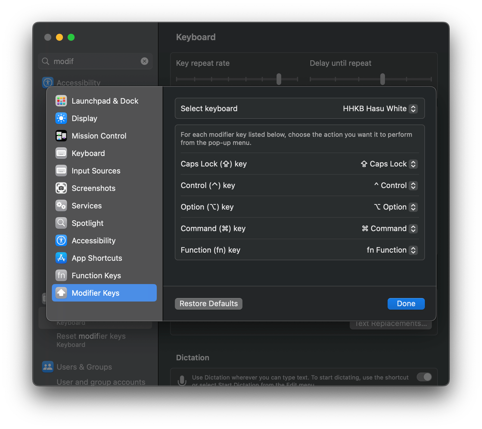

Edit:

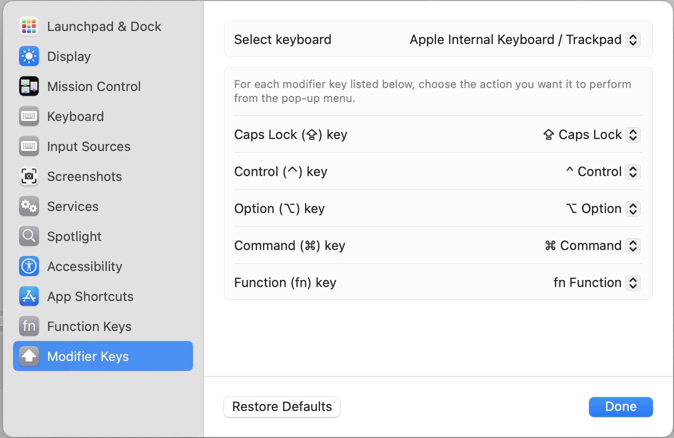

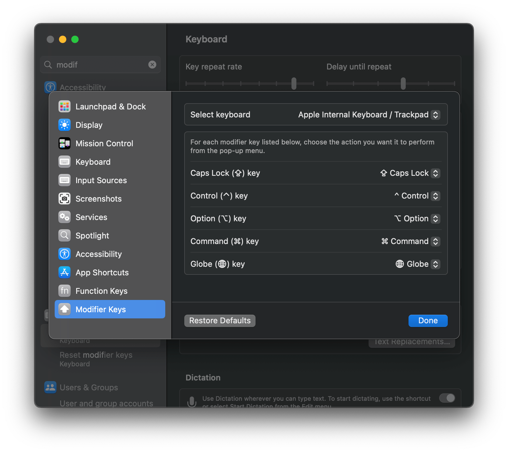

Actually, I forgot about the keyboard Modifier Keys setting in System Preferences. It used to look like this:
And now it looks like this:
System Preferences > Modifier Keys > MacBook Air.png (270.16 KiB) Viewed 10401 times
Okay, so how about a third party keyboard?
System Preferences > Modifier Keys > HHKB.png (268.31 KiB) Viewed 10401 times
Oh hey, Fn's there! But wasn't it supposed to be 🌐? :roll:

Yes, use them if you like. All of them contain other keyboard names, though, as I don’t have one of yours. ;)
A small correction: Apple renamed System Preferences to Settings on the Mac. I used the old name out of habit.
And a small tip: by far the easiest way to find the Modifier Keys section in Settings now is to do a text search for it. They really messed up the whole app’s design!

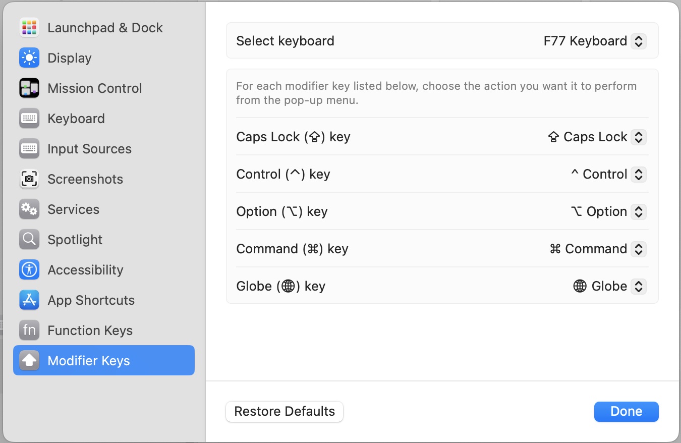

On my 2019 Macbook Pro's preferences panel for modifiers, the internal keyboard shows a fn key and my F77 shows a globe key. I did not expect this and I would like to know what scancode is interpreted as the globe key on the Mac. I do run Karabiner so maybe that intervenes in what modifier keys the OS thinks I have?
Internal keyboard, 2019 Macbook Pro:
F77 keyboard, VIAL firmware:
Edit: Arkku, above, explained my observations. My Macbook keyboard does not have a globe legend, MacOS knows this, and presents it as fn in the UI. Karabiner presents my F77 as a new-style keyboard, so it gets the globe icon. I still would like to know how to teach my F77 firmware to actually send the globe.

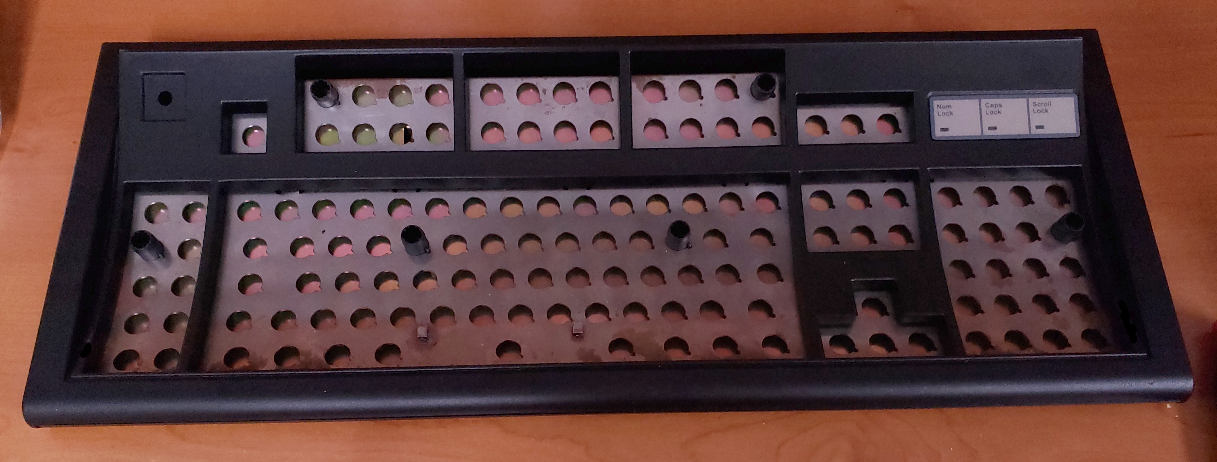

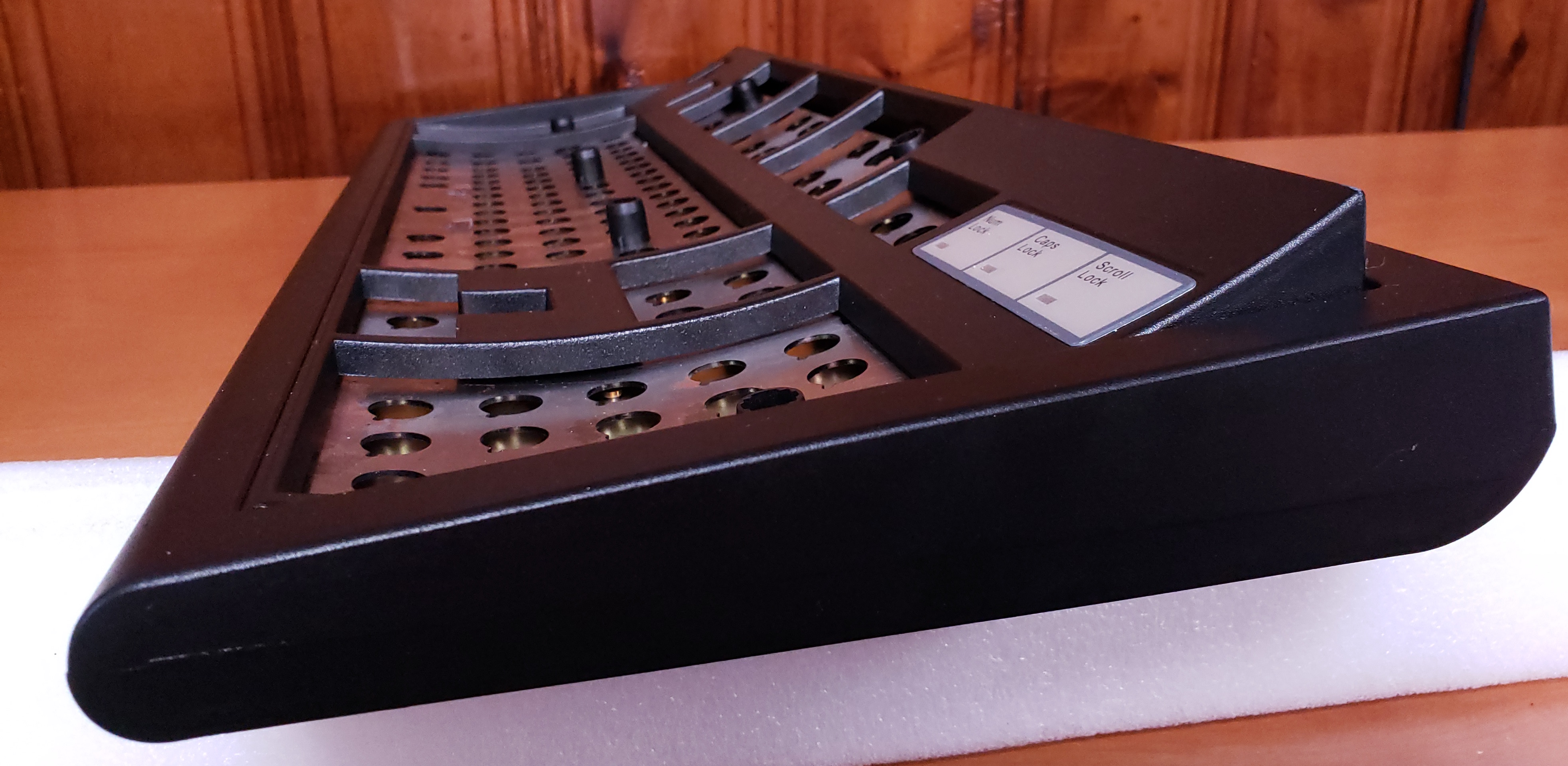

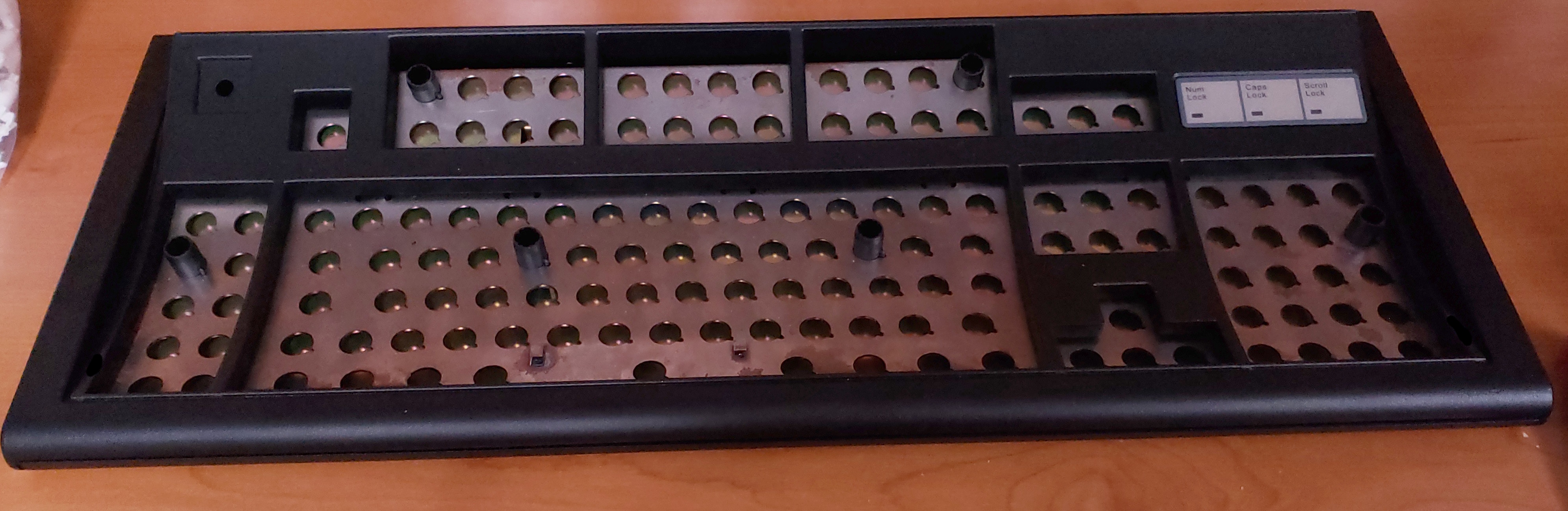

Rejected case samples:

Ellipse
19 Apr 2023, 02:41

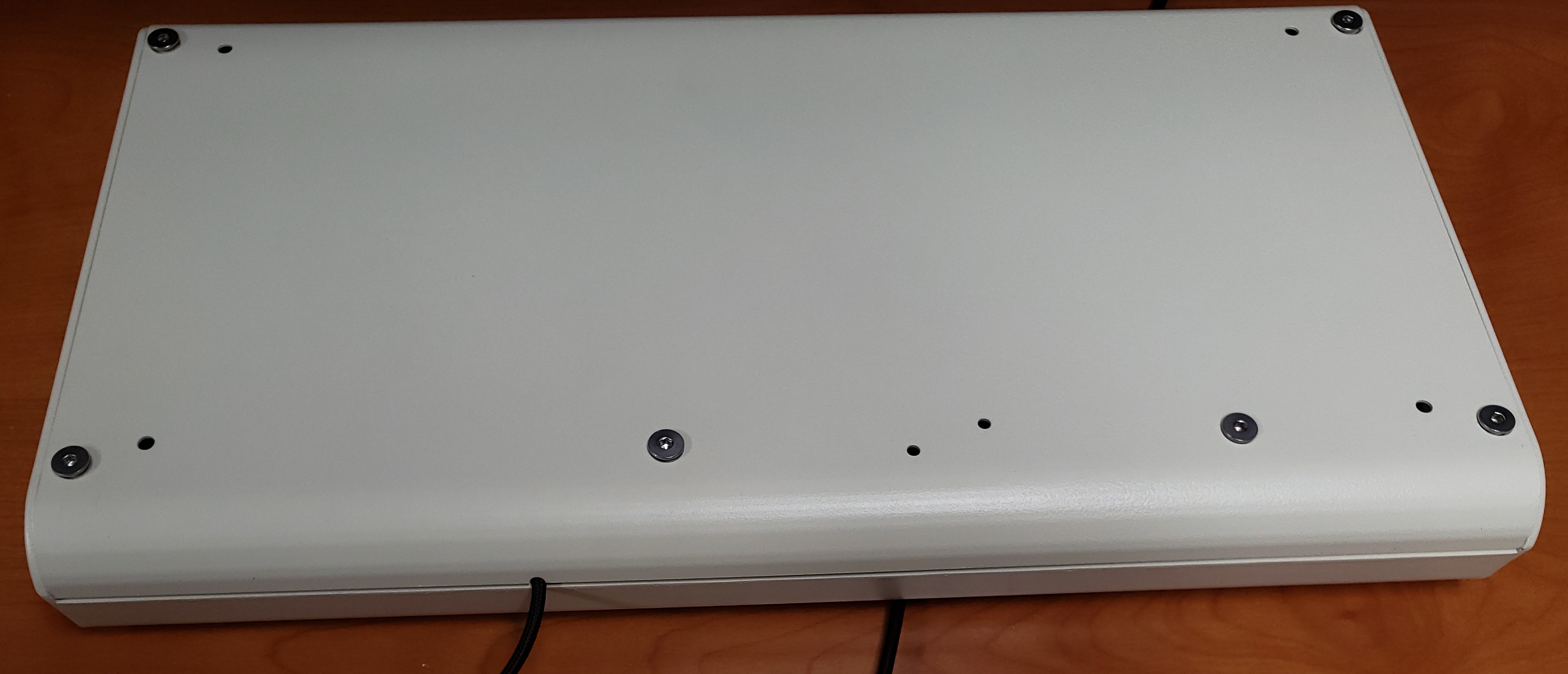

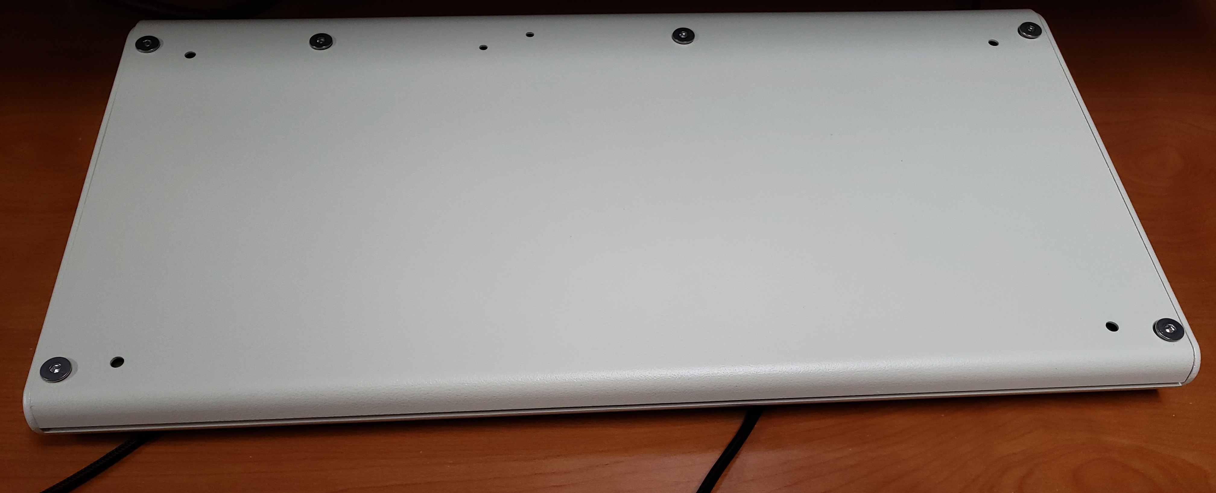

Here are some photos of the rejected F122 case. Inside are the bottom and top inner assemblies. The factory did not properly drill the internal holes to attach the bottom inner assembly, so that is why the inner assembly looks too sunken in the photos (it is loose and not properly installed). Also the LED overlay is a rejected sample (incorrect color).
You can see the rust on the steel top inner assembly plate as the plate was not powdercoated, so it starts to rust quite quickly. When I was restoring a late 1930s/early 1940s metal case clock a few years back (including removing the old paint finish), the bare clock case would develop a later of rust within minutes (!) of air exposure. Drying the water off the clock and coating the clock case with oil helped slow this down so I could spray paint the case.

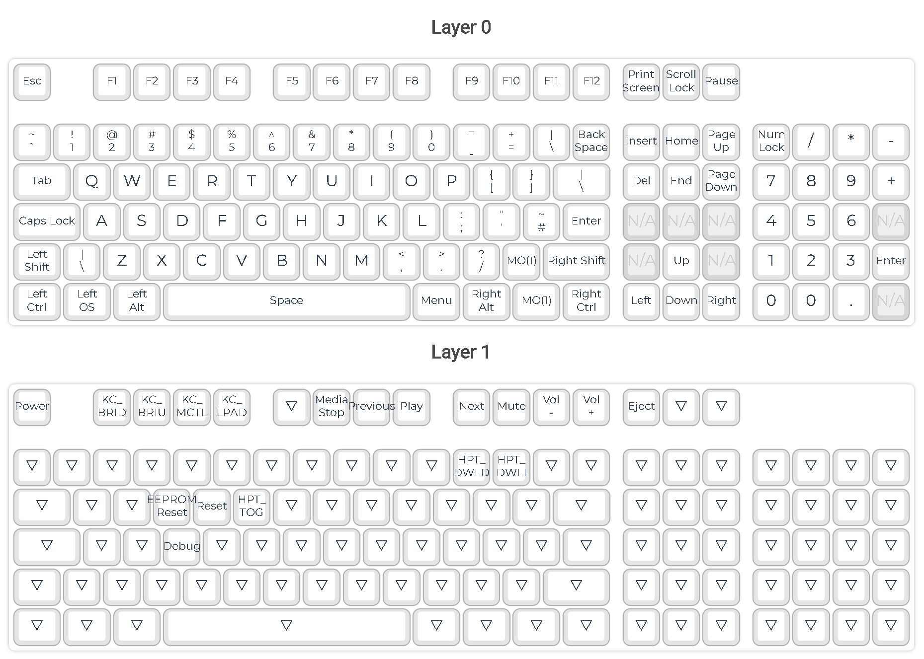

As an update pandrew has updated the QMK beta site to add the F104 and FSSK.
Please review the proposed F104 factory programming. I hope to start mailing out the Round 1 F104/FSSK boards Thursday/Friday of this week.
F104.zip
(706 Bytes) Downloaded 277 times
StrangerCoug
20 Apr 2023, 04:12
IMO I think having the menu key to the left of the RAlt key instead of in between RAlt and RCtrl is a bit weird, but that's probably me being used to keyboards that aren't programmable in hardware. If you anticipate a lot of us not needing/wanting the menu key, then it's probably fine.
StrangerCoug
20 Apr 2023, 17:49
StrangerCoug wrote: 20 Apr 2023, 04:12 IMO I think having the menu key to the left of the RAlt key instead of in between RAlt and RCtrl is a bit weird, but that's probably me being used to keyboards that aren't programmable in hardware. If you anticipate a lot of us not needing/wanting the menu key, then it's probably fine.
Actually, come to think of it, is MO(1) the Fn key? If so, then that might be more useful in actual practice than a menu key (since the menu key typically does the same thing as the right mouse button).
