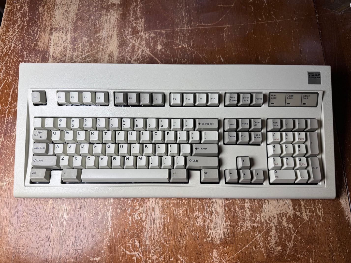

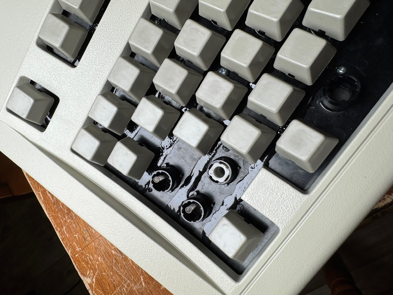

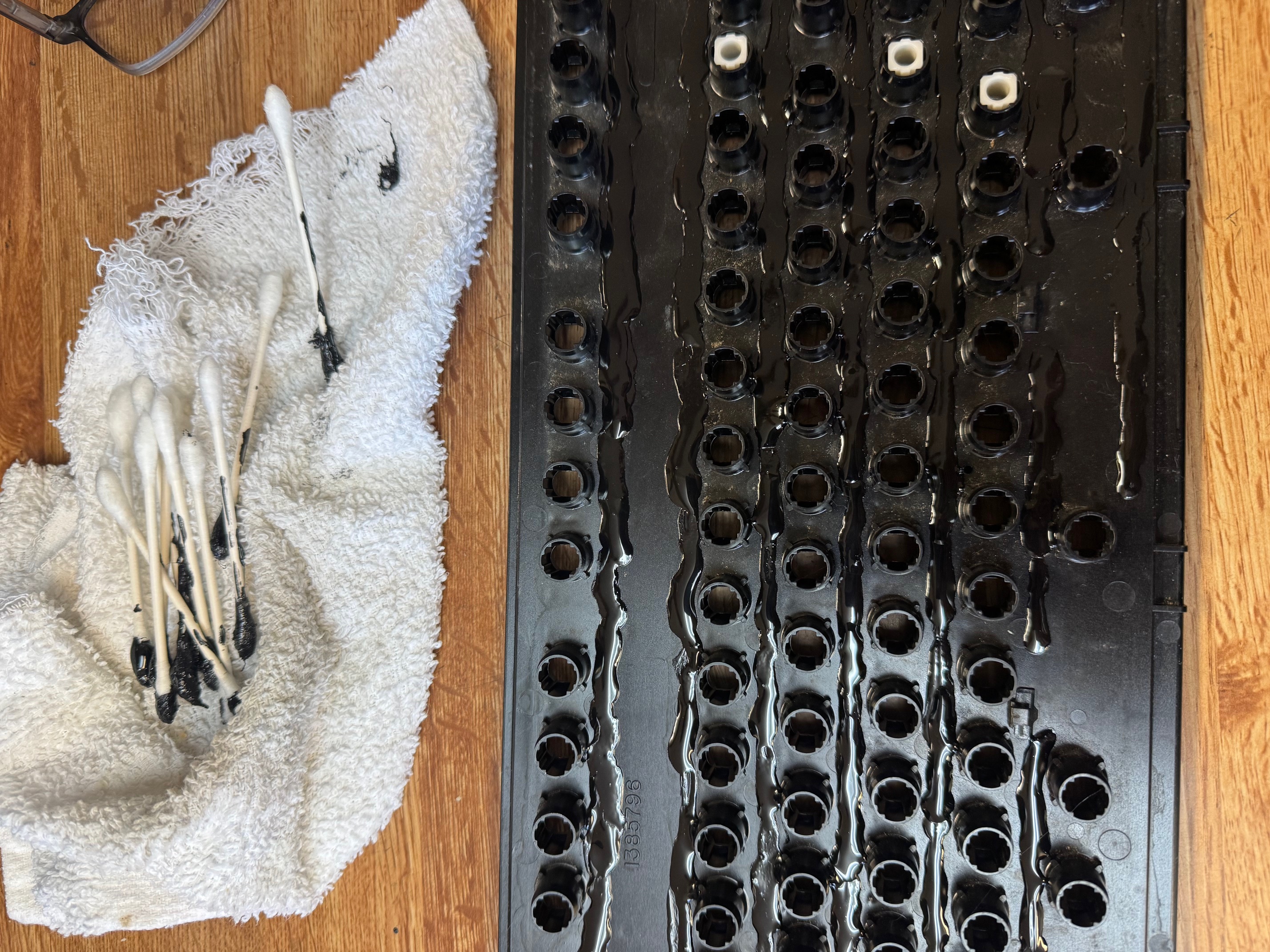

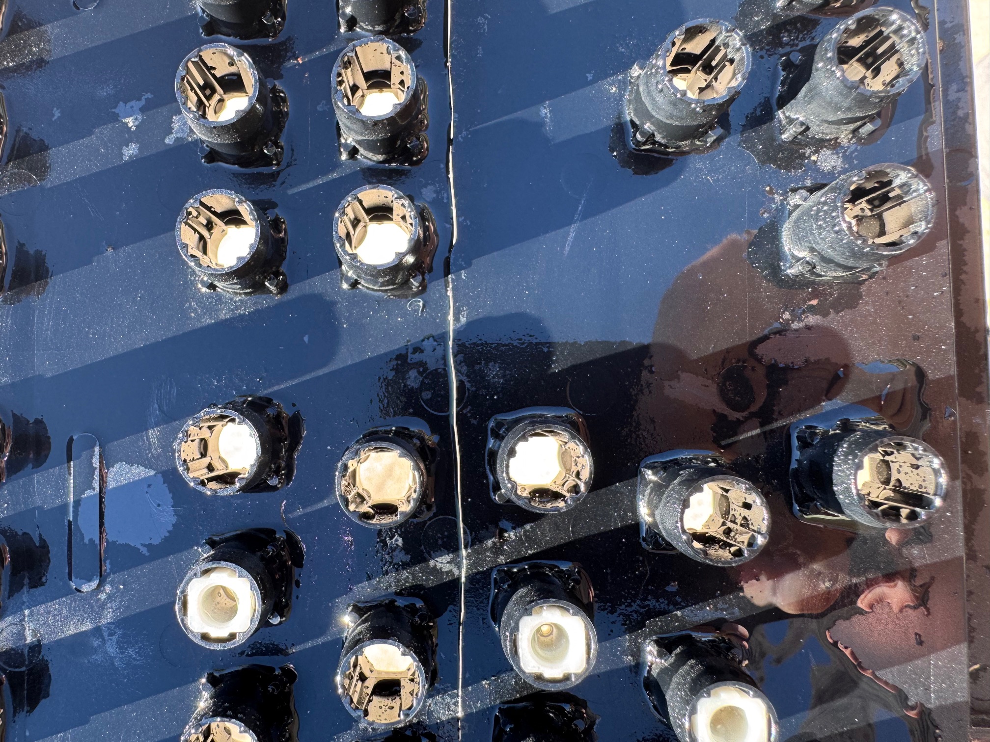

Attempted a repair on a cracked barrel plate with ABS glue and it worked out better than I thought it would.
Put it on heavy with a Q-tip and let it cure for a week before I did a screw mod. I had a major break in the center
and hair line cracks running down each channel. This barrel plate is rare because it has the wire guides on the
numpad so I wanted to come up with a way to save it. Very happy with the results.
