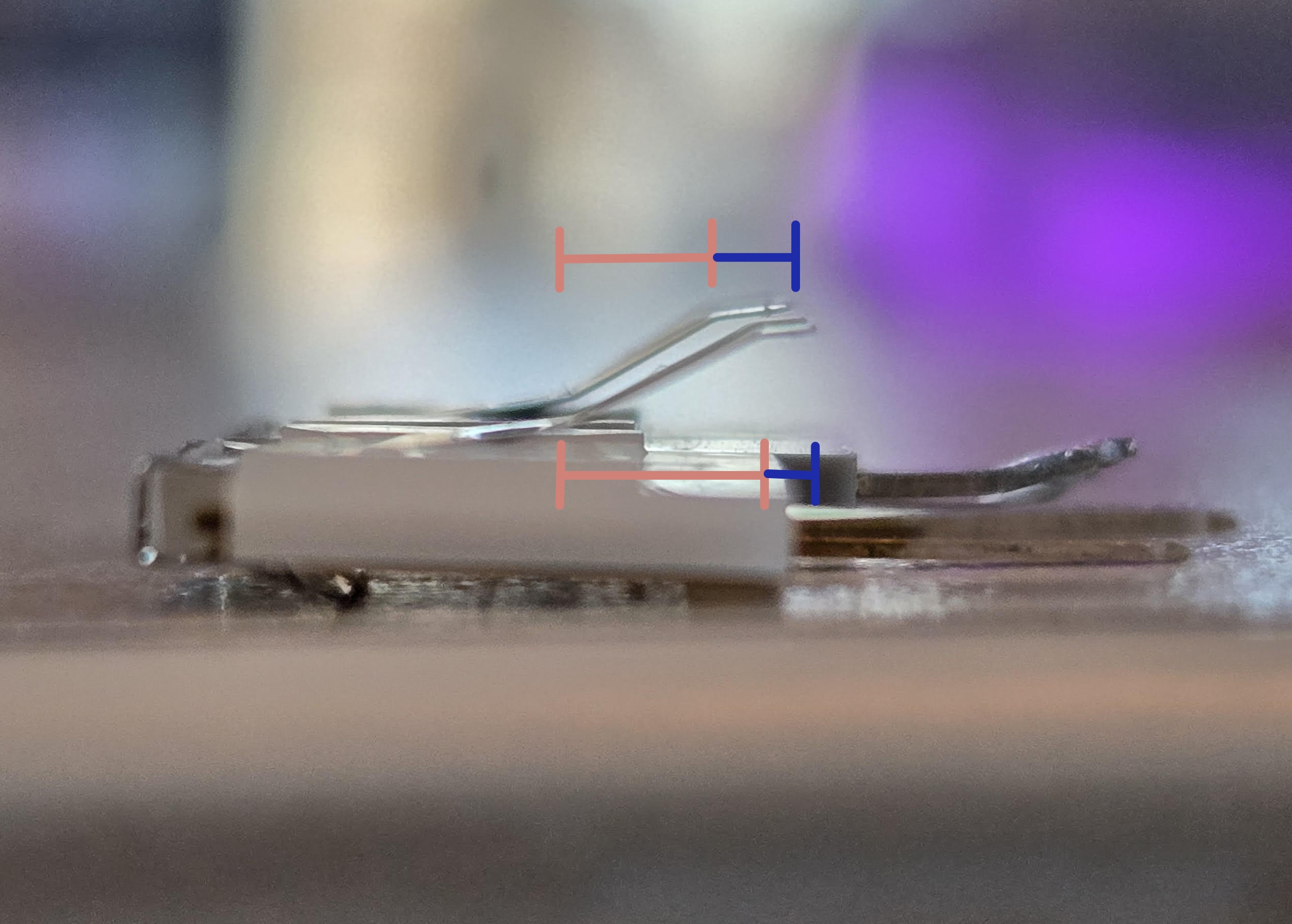

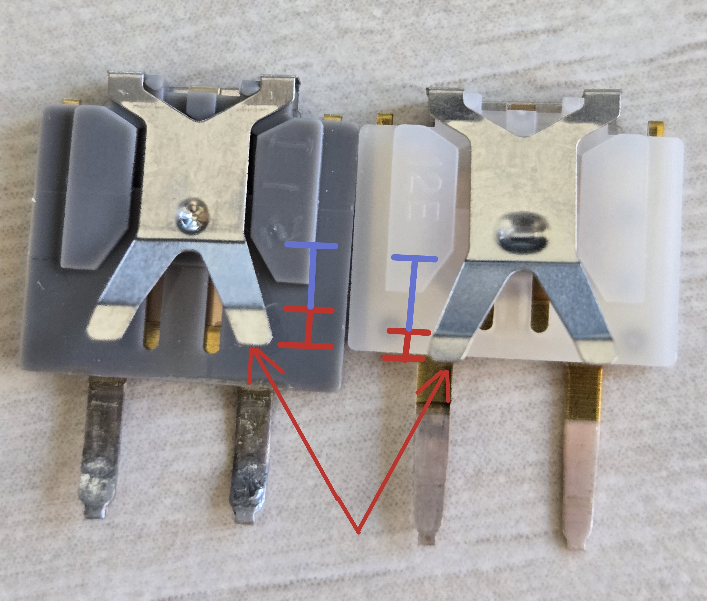

long grey switch plate from SKCM undamped cream on the left, short white switchplate from
NOS SKCM White Pine on the right
long grey switch plate in back, short white switch plate in front.
from these images you can clearly see that the second fold in the actuator leaf spring came later in the newer switch plate. This results in the older actuator having longer "feet", and the newer one having a longer "legs". I don't have the tools to test, but i'd estimate the difference is between .3 mm and .5 mm. The total vertical and depth displacement remain roughly the same.
This should result in the force curve of the first switch reaching its local maximum peak force first, since the slider passes the legs earlier. Indeed, if we look at the force curves HaaTa measured for SKCL Green (older) and SKCL Yellow (newer) Alps, we can see exactly this:
In this graph we see the green switch peaking about .3mm earlier, which aligns with the observed difference in leg length. We also see that the force drop is lower in the yellow alps, but that can be explained by a higher spring rate in the coil spring.
