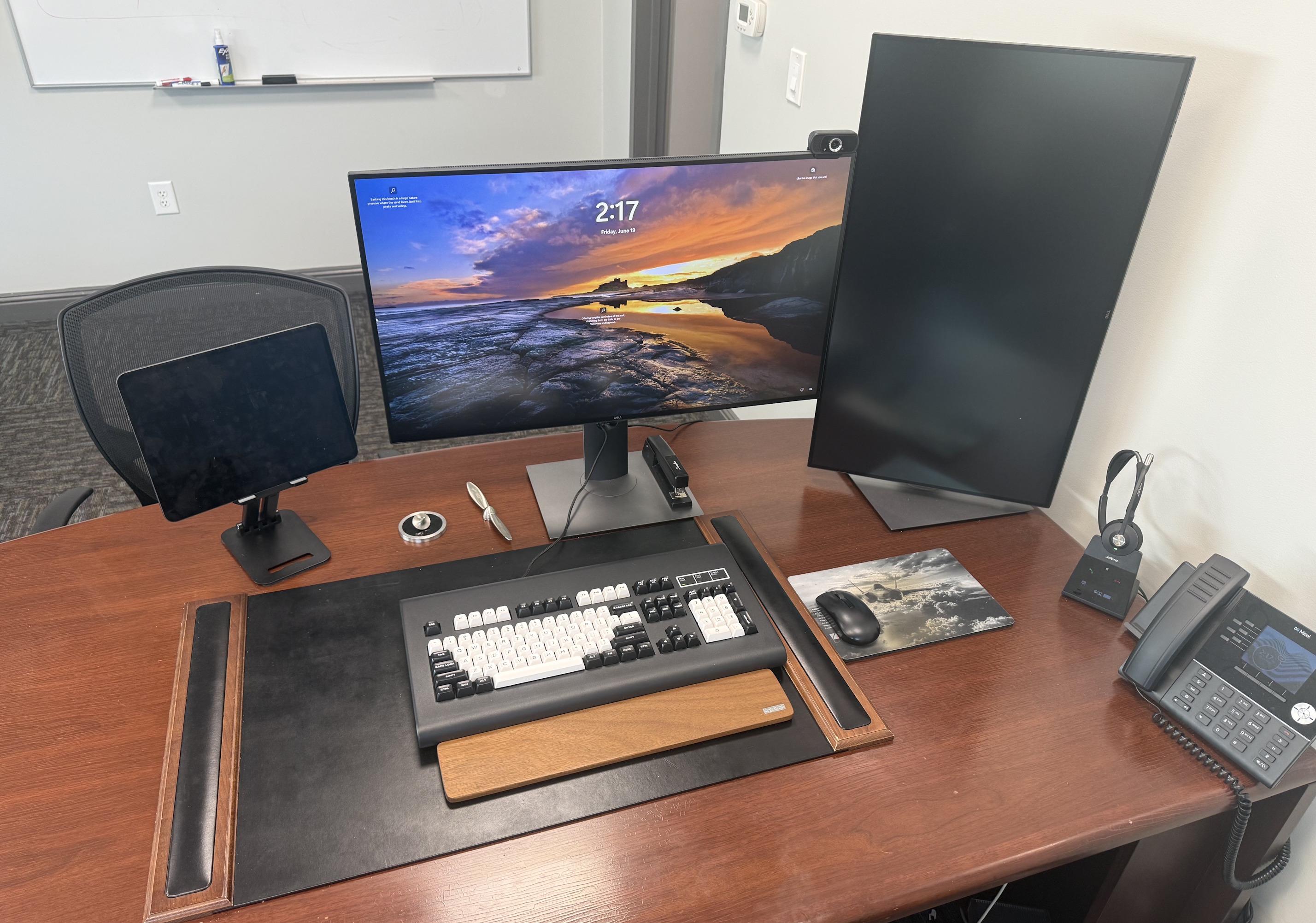

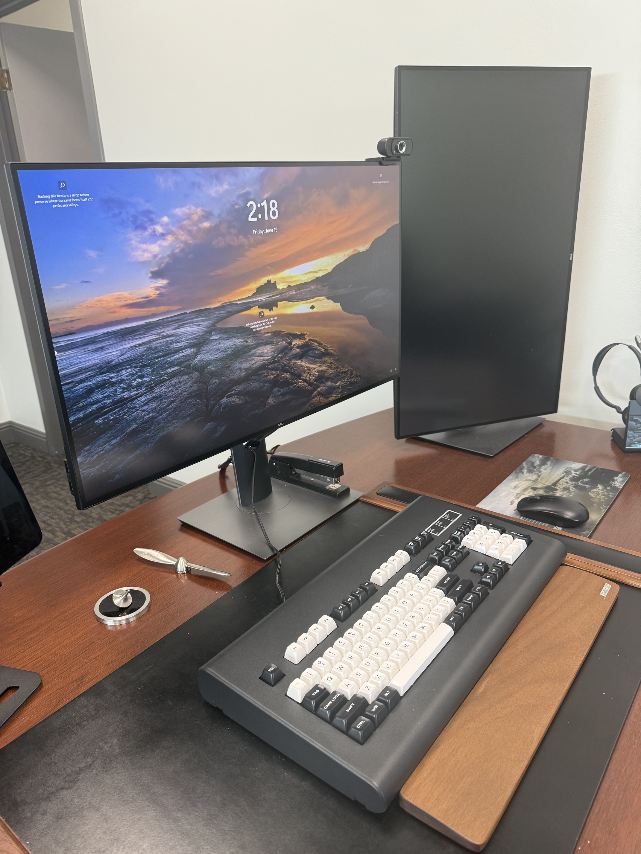

Ellipse
Yesterday, 00:27
Sharing with permission a nice Round 2 B104 with black case in an office! Always nice to have a dry erase board in your office!
