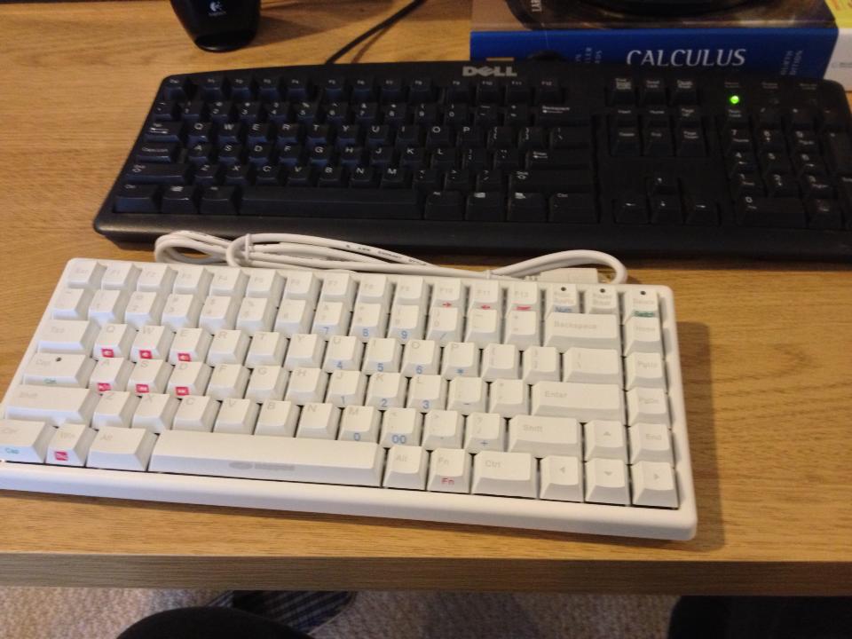

A friend of mine has been looking into getting a mechanical keyboard, the noppoo choc mini white more specifically. We talked about different types of cherries and I think he was going to get the blacks or reds, but I was able to tell him how each of them feel and he decided to go for the blues for the clicky and better tactile feedback.
The more you know
