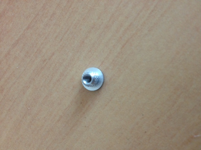

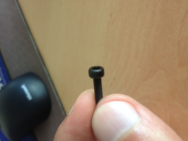

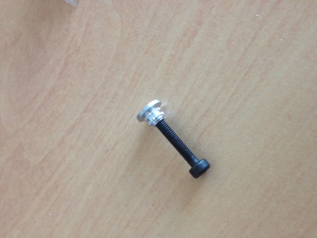

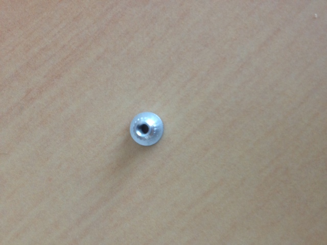

Found something interesting in RC parts store and bought some for my custom keyboard:
photo 1.JPG (88.64 KiB) Viewed 6235 times
photo 2.JPG (86.13 KiB) Viewed 6235 times
This is a M3 nut, the height of the nut is 4mm and the exterior diameter is 4mm, this type on nuts can be inserted in the bottom plate and should give a nice flush look, no more nasty hex nuts. These are made from aluminum and work great on wood, and in theory should work nice also in acrylic. I will make some tests on an acrylic plate I have.

12 Jun 2014, 11:12
it would be great if they could be found in M2.5. Can you take a picture of the head?
For the wood case I believe I've found the perfect solution (M2 wood nuts !!!), this one seems very nice for aluminum cases and probably acrylic too.

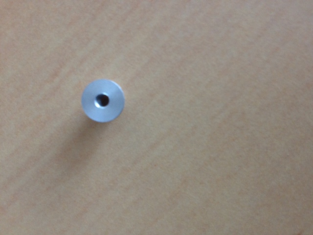

DanielT
12 Jun 2014, 11:28
Hope this is what you wanted to see:
photo 3.JPG (73.49 KiB) Viewed 6225 times

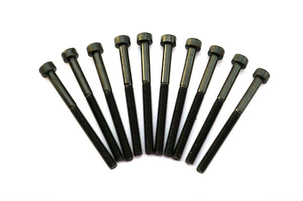

This type of screws/bolts come also in the M2.5 flavour the exact size is M2.5x27.6 mm but only half of the bolt has a thread:
The nut is actually a wood nut, and they have it also in M2.5 and M2 flavors. And I liked this design better than the classic one with retaining claws like this:

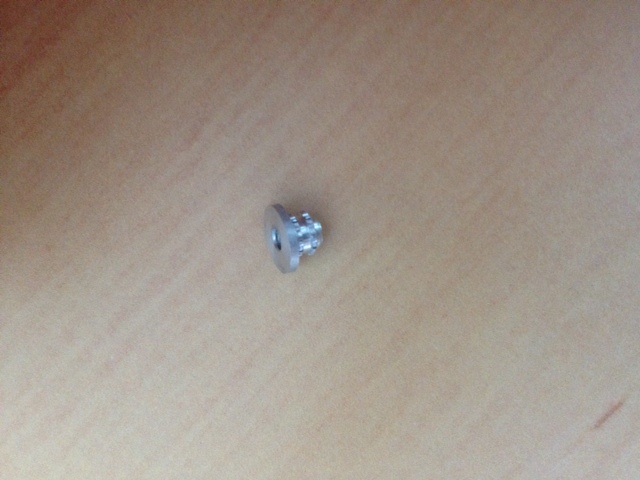

-[°_°]-
12 Jun 2014, 11:32
sorry, I wasn't clear. I mean the nut head, not the screw head. I'll post pictures of the wood nuts later, they are really nice.
-[°_°]-
12 Jun 2014, 11:49
there you go
these goes inside the middle layers. No screws on the top of the keyboard, just very small (2M) screws to the bottom to hold the bottom plate.

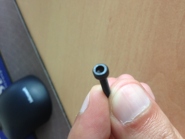

DanielT
12 Jun 2014, 12:02
Oooo, these are nice, really nice.
I made some photos of the nut, hope are clear enough:
-[°_°]-
12 Jun 2014, 12:04
oh, they are holed. I kinda wished they where flat
DanielT
12 Jun 2014, 12:17
That would have been perfect, a flat bottom would give a clean riveted look, but I'm happy I found even this, here I don't find easy stuff like that :(
