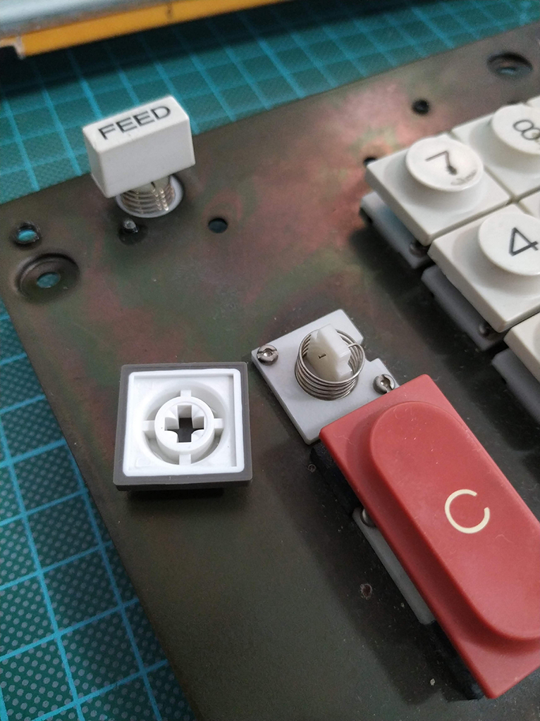

from some old calculator thing i found in the trash:

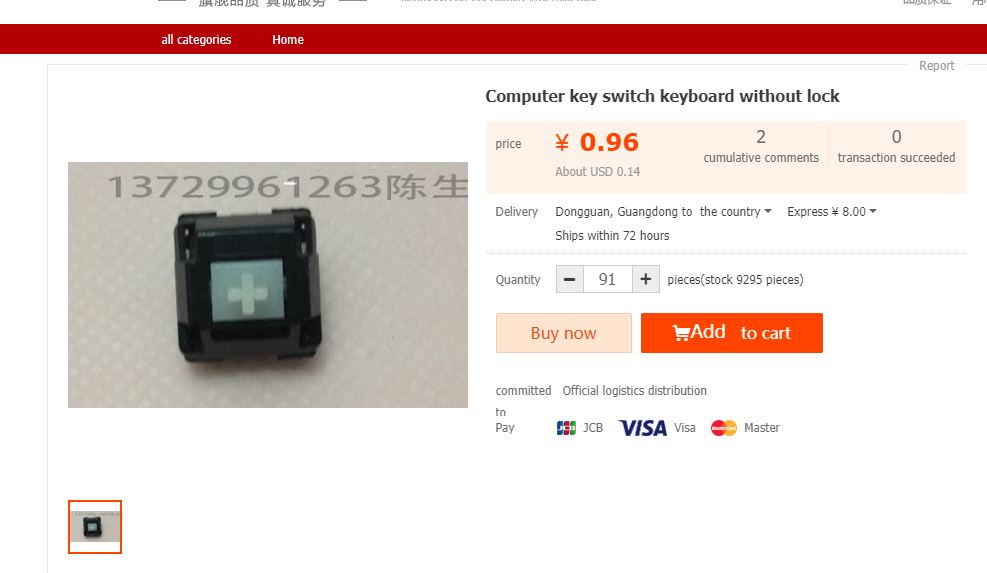

What are these?
They look like blue Alps to me, but then they don't. I'm no expert on identifying different Alps switches, but the blue Alps should have a slit, right?
source:
https://www.aliexpress.com/item/33056367437.html
Lbibass
22 Sep 2019, 22:24
ollir wrote: 22 Sep 2019, 21:37 Image
What are these?
source:
FD and the folded metal pin for one of the contacts means it is an alps clone.
And you hit it on the head with the lacking slits.
22 Sep 2019, 23:12
IIRC they are grey Alps (simplified). The lighting just makes them look blue. These pop up from time to time for this reason ;) .

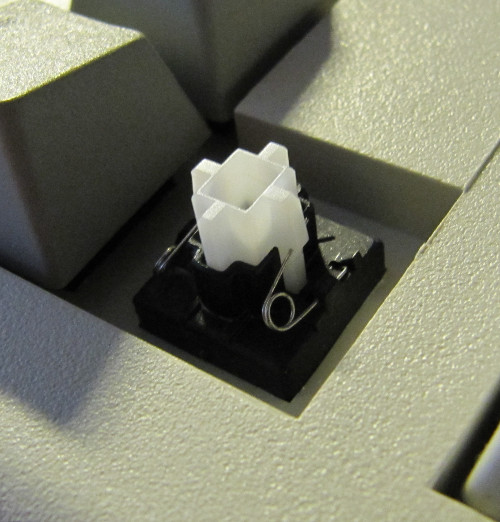

Image Could anyone tell me what these switches are? They sit on a nokia / ICL keyboard if that helps!
14 Oct 2019, 08:41
So you are that guy bidding on that ICL keyboard I am looking at, huh? I had been hoping that it would go under the radar...
They are called Ericsson switches. The keyboards were made in Bräkne-Hoby at a factory first owned by Facit, then bought by Ericsson Data. It merged into Nokia Data which was later purchased by ICL. ICL was later absorbed into Fujitsu.
In that stabiliser arrangement, one of the switches is a dummy.
